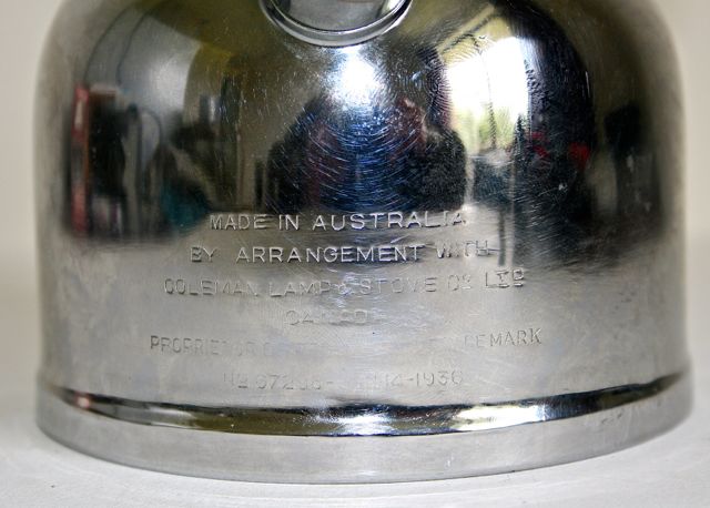

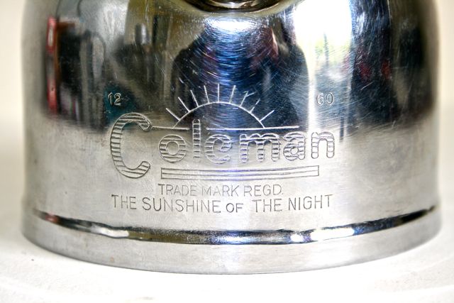

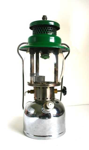

    I saw this one on the eBay and had to buy it because it represents the last or near last Australian made Coleman lantern (as far as I can tell) - I haven't uncovered a later date stamping than 12/60 on an Australian Coleman.
    The funny thing was it was advertised as 10/60 and it wasn't until it arrived that I realised it was 12/60.

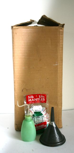

    It came in an original box with some accessories.

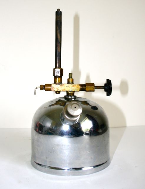

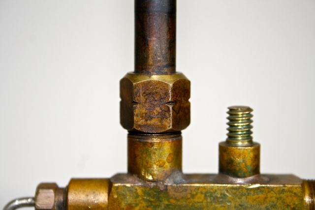

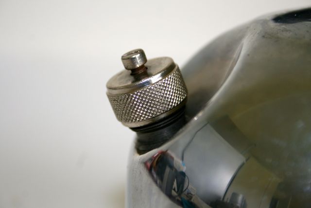

    Note the locking nut for the generator (it is normal thread, not left-hand thread).

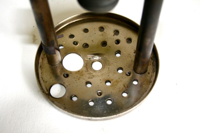

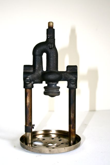

    Now there is something interesting about the baseplate. Normally an Aussie 249 had a manufactured recessed dimple in the baseplate to allow the special shaped nut to lock the baseplate and frame in place (see this example, 16th photo down : Coleman 249 Scout, 1957, Made in Australia
    The baseplate on this lantern was once flat and has had a concave shape made after manufacture.
    The hole for the generator may also have been enlarged after manufacture.
    I'm wondering whether this might not be from an Aussie Coleman 242, and made to fit a 249 as Coleman used up the last of its stock before closing down production in Australia.
    Note, too, the 5 small dimples in the baseplate to fit the support collar in the correct position. I've not seen these on any of my other Colemans.

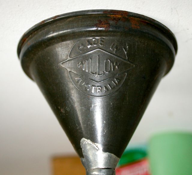

    An Australian made funnel.
    If members could check through their 1960 Aussie Coleman 249s and 242s to see what their baseplates look like, I would appreciate it.

    The green plastic spirit bottle that came with the lantern is very similar to the current Austramax spirit bottle (they are excellent!).

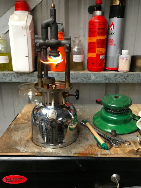

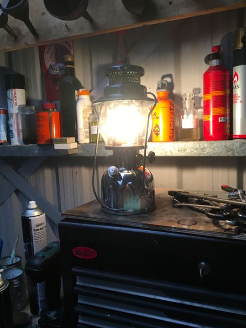

    It was a pretty easy fettle. I replaced the generator with a cleaned up old one (and now have the one that was on it soaking in acetone).
    I also had to add some graphite packing to the control spindle/packing nut.
    Testing.
    Fitted with a "Shields" mantle and up and running.

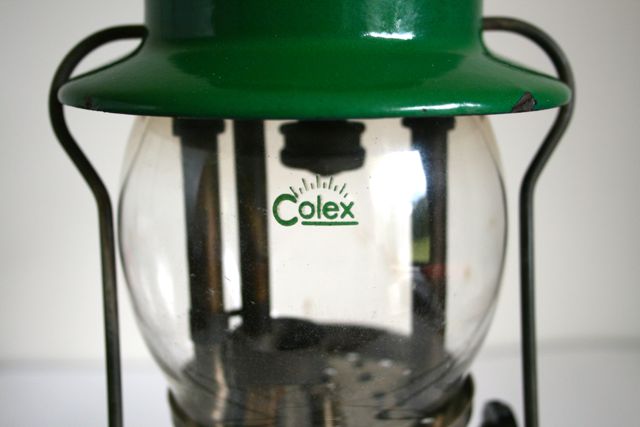

    Tony, you were very lucky to find such a good-looking and complete set. The Colex globe lettering still looks new! This is one for the books.

    Any trick to the locking nut on the generator?
    I cannot budge it, even after soaking in kroil and heating it up.
  10. ROBBO55
    4,335
    @giri
    Giri, it should just screw off.
  11. phaedrus42
    phaedrus42 Subscriber
    2,056
    Be careful when loosening the jamb nut that you do not bend the top of the fount. Best to clamp the valve body.
  12. giri
    Jun 27, 2017
    17
    Yes, unfortunately I've already bent the top of the fount.
    No holes produced though when moving the valve back to vertical.
    I'll remove the valve and keep working at it.
    Old Coleman Parts has a reproduction generator nut...worse comes to worse I'll cut it off.
    Thanks everyone

    These dimples are also seen on my 247 made in Canada from 1948.
  16. Alexandre Freddi Brazil
    Apr 13, 2025
    18
    Brazil
    My 1951 Canada made too.
