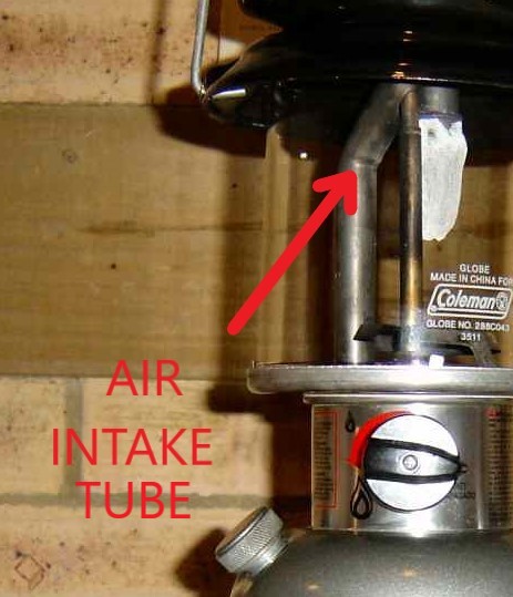

  9. Henry Plews
    3,073
    The flame blows itself out because there's no flame to hold it against the burner. Simply use less pressure.
  10. Michael D. United Kingdom
    Feb 23, 2023
    5
    UK
    Ahh, I suppose that I knew that really - to be honest no - I have taken the lamp apart including removing the whole of the burner and air tube - but I can't swear that I've looked up it for blockages - time to get the tools out again an be more thorough this time. :)
    Thanks for the photo.
    Michael
