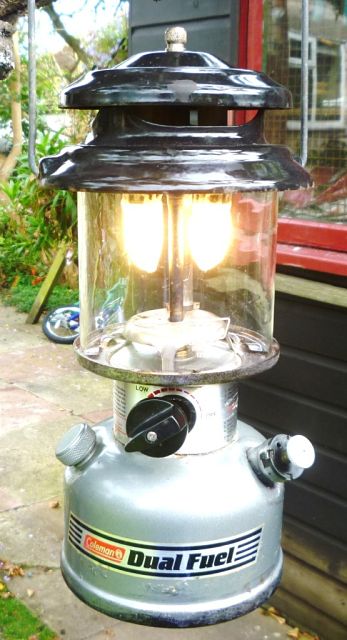

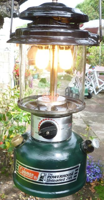

    Thanks David and John, Yep see it now. I guessed that may be the answer, but found that matches did not burn too well as they seemed a bit short of oxygen to keep going. Anyway, going out to the shed now to flash them up. Thanks again - Steve.
  5. Shed-Man R.I.P.
    1,032
    Thanks guys, got them going; pics to show it. Learnt a lot in the strip-down and rebuild process. Found that the assembly of control cock to cleaning needle was very fiddley; having to hold the two together, whilst lining up the generator in the air-tube and then tightening the union nut and hold-down nut. Any tips on this operation? Steve.
