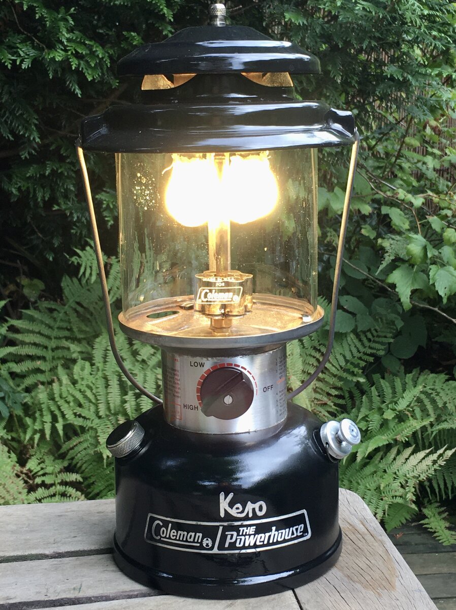

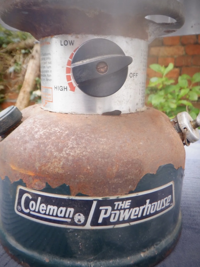

    Candidate was an angler’s well-used example, reeking of pump petrol.
    Surface rust and nothing deeper, but after rust removal, stripping the remains of the dark green livery (decal carefully peeled off for re-use) and a priming coat I added a black vent from a scrap 295 and re-painted the tank in gloss black.
    The generator was already paraffin-friendly in having twin brass coils, unlike the 295’s.

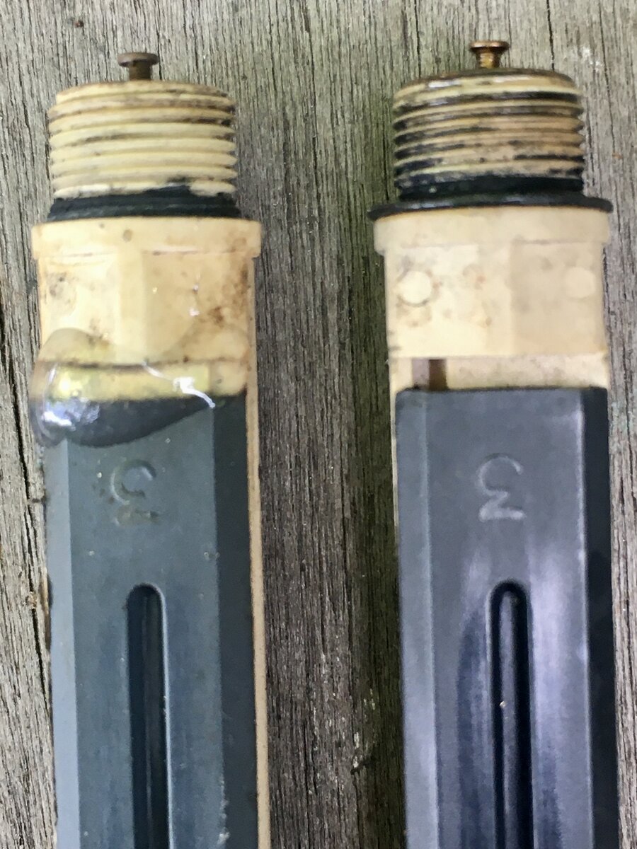

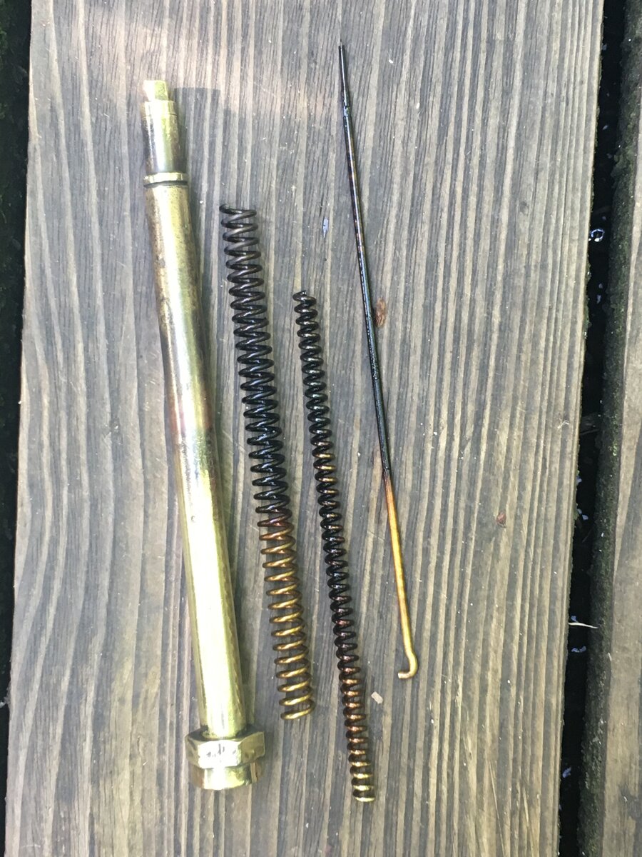

    The jet tip though was a stock 0.009 inch orifice. I had a spare jet marked ‘C’ (from a Coleman 335 I think) with a 0.008 inch orifice, so I used that as a more suitable jet for burning paraffin.

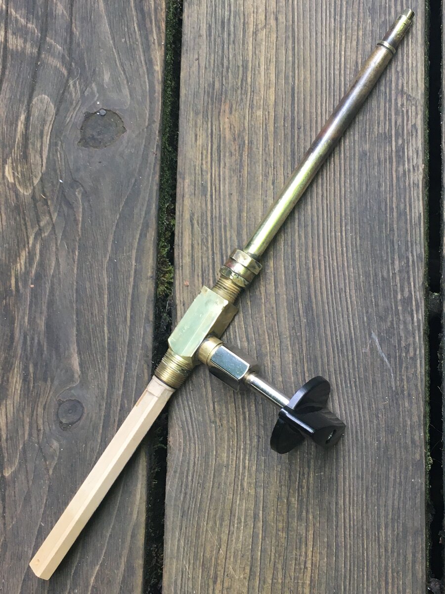

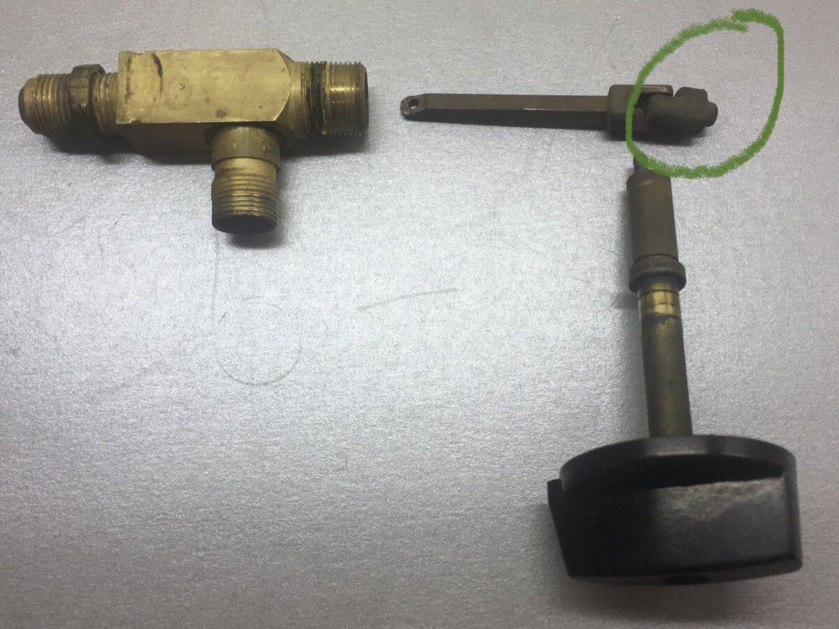

    With no use for the air inlet on the fuel pickup, there to give the air feed for ‘easy start’ on Coleman fuel, I blocked it up with a strip of brass and epoxy - doctored pickup on the left alongside the usual configuration.

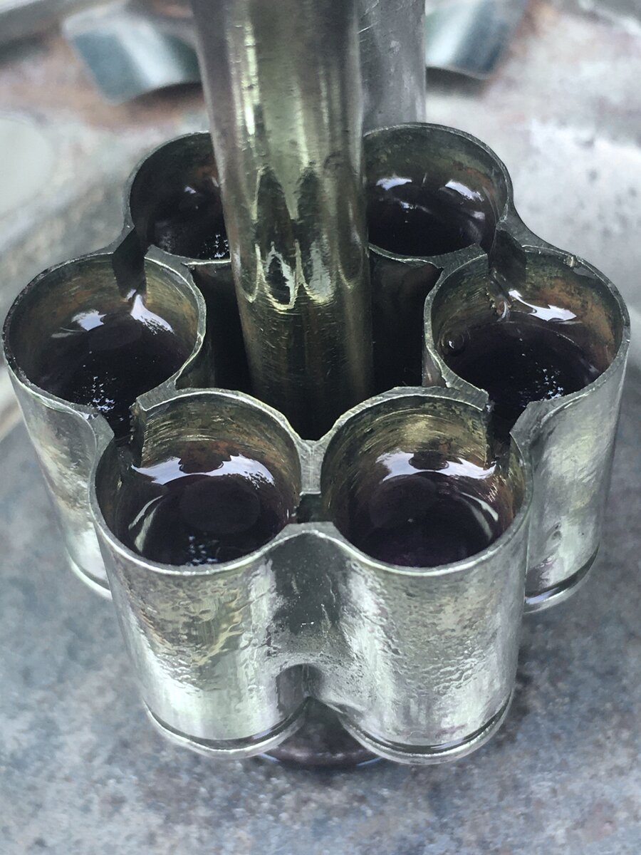

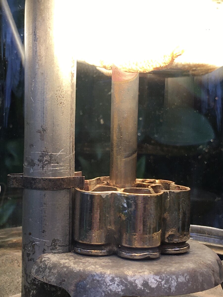

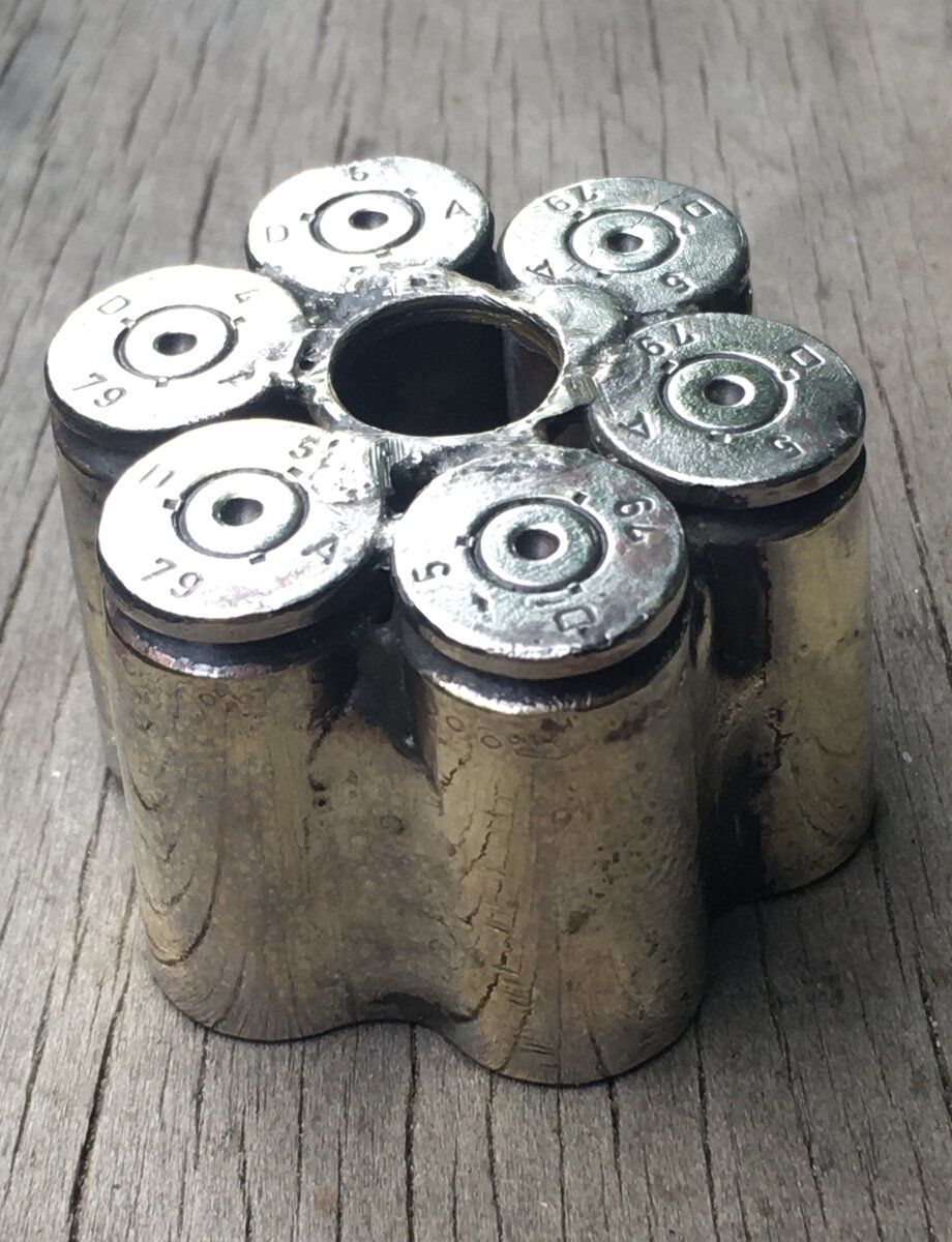

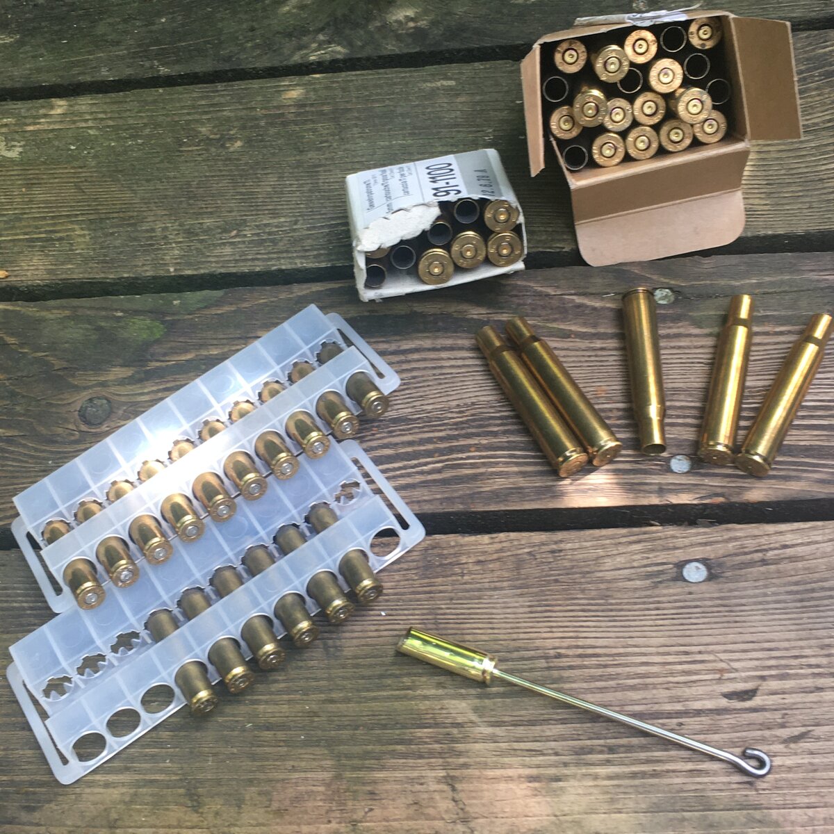

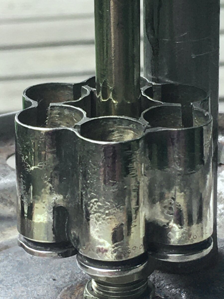

    Of course, a priming cup was now needed, another project for my stock of spent cartridge cases.
    Silbrazed together and nickel plated.
    Slots cut to ‘cascade’ priming meths from one to another when filled at one.

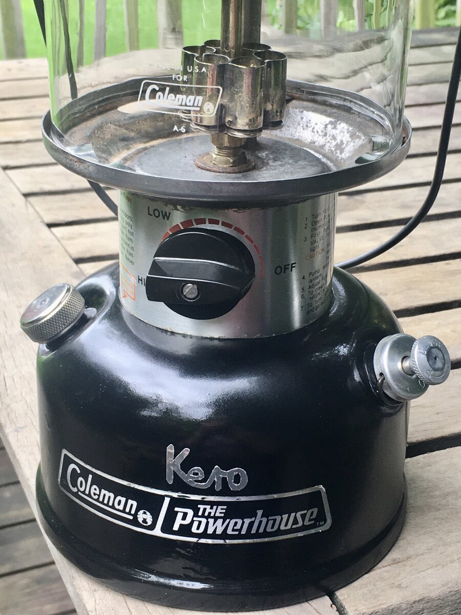

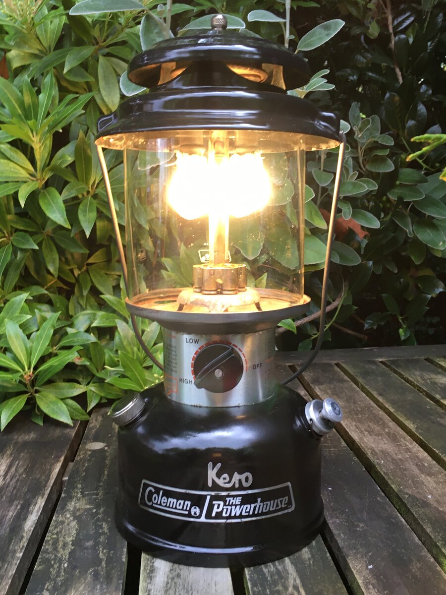

    To remind me of the fuel, I added the ‘Kero’ script - ‘Paraffin’ would have been more of a challenge to fabricate!

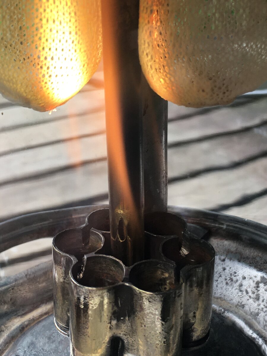

    Priming.
    Ignition.
    It burns strongly and the lantern’s facility to dial down the brightness is retained.

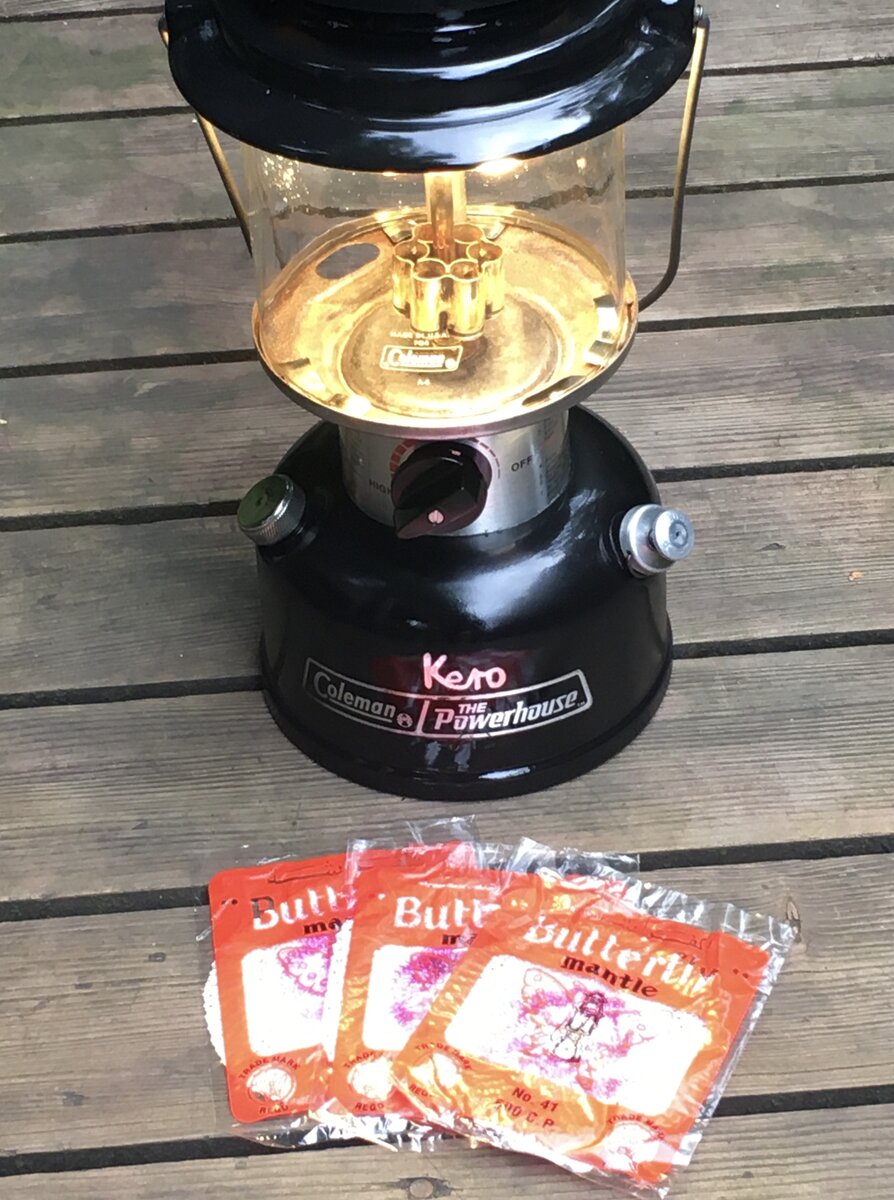

    I nearly forgot … another concession to the new fuel, bigger mantles than the Coleman 21 stock ones. The Chinese Butterfly mantles (350/500cp rated) work well.

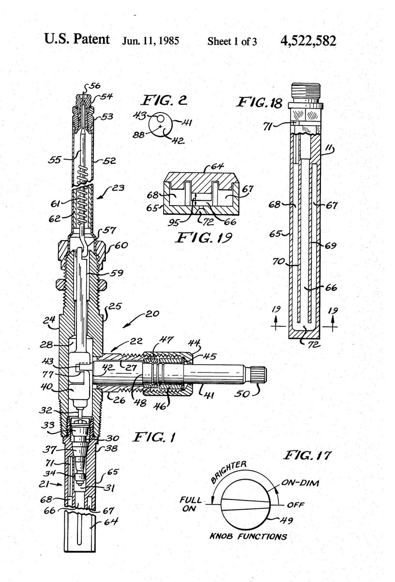

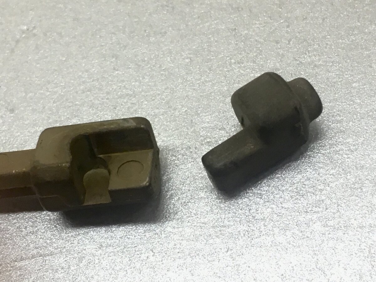

    I realise that in my haste to try the lantern on paraffin I didn’t replace the heat shield and its retaining clip. The shield’s meant to prevent overheating of the plasic component numbered 40 in the patent drawing and the shrader valve it operates …
    … this
    I replaced the heat shield and clip, which usefully prevents the spirit cup from destroying the mantles if the lantern were to be upended. I’ve also reduced the height of the spirit cup to still create a capacity more than sufficient to prime the lantern.
