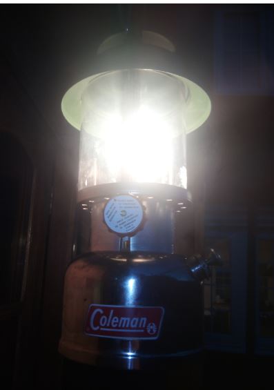

  30. Garry Hallam United Kingdom
    Jul 4, 2020
    13
    Manchester uk
    Wow thanks Alex for the fully detailed lighting steps. I followed your advice and soaked the diaphram in oil to revive it. I gave 6 pump strokes and filled the cup with meths to preheat as David advised it lit like a dream after that. Thanks fo much for steering me in the right direction. I have included a photo
