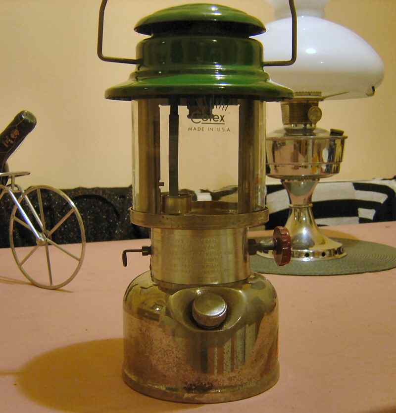

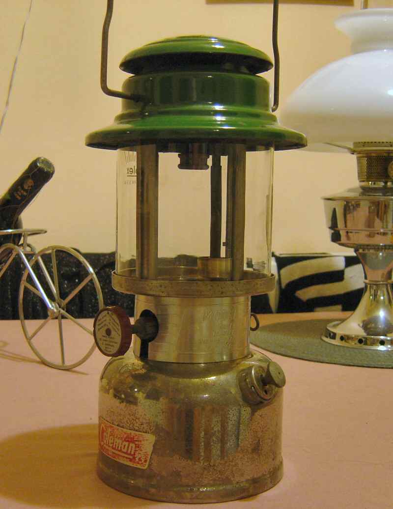

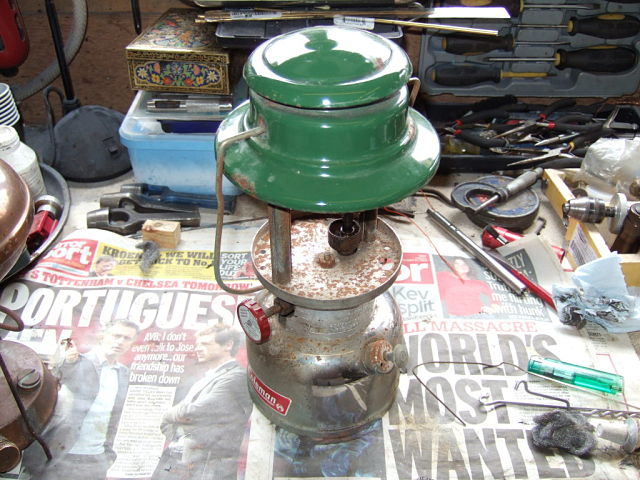

    A couple of pictures after my cleanup...
    As you can see the chrome on the tank is quite pitted, but the rest of the lamp is in very good condition.

    If it runs, then looks don't matter. Mine's running a treat again tonight despite the dodgy check valve, but because of the safety on these only air comes back out the pump tube. :thumbup: Interesting to see the markings on your glass, I thought that "Colex" was made in England as stated on mine, but yours is made in USA. :-k

    Yes it's printed in a different place and in a different colour too, I also notice mine doesn't have a number...

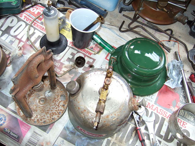

    Jeff & i are having a swap & i'm sending him a 339 like yours , they do seem to work really well 8) :thumbup:
    Stared out like this......
    Now like this........
    Stu :D :thumbup:

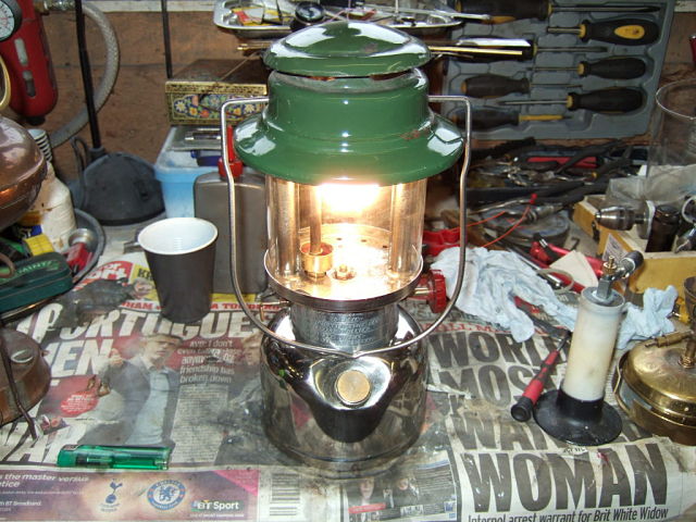

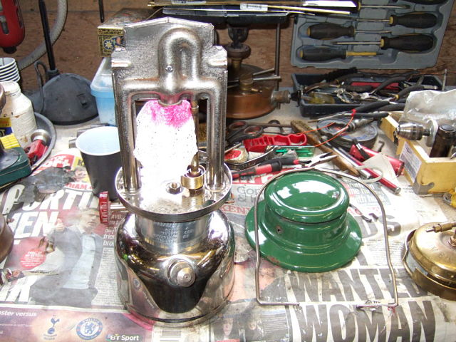

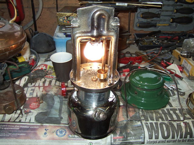

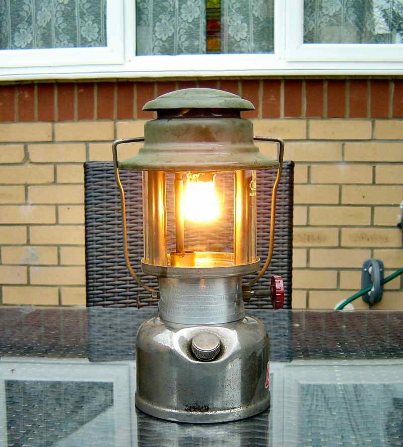

    It works...
    It took a lot more work than I was initially expecting as the first attempt was a complete failure which turned out to be no fuel getting through.
    The vapouriser was completely clogged up and removing the cleaning needle and two springs resulted in the springs loosing their shape as they had softened with the heat and were stuck pretty fast. In they end I had to partly rewind them on a correctly sized drill shaft...
    Still it gave me the chance to completely remove all the carbon so at least I know it's starting out carbon free and possibly as good as new.
    I have to say it makes quite a satisfying sound when it's running, very different to all my other lamps...

    I really like the shape and proportions of this lamp so was pleased to get it running...
    I'm not sure why my hood took on that milky appearance after it heated up, it just seems to brush off and is a nice shiny green underneath. :-k
