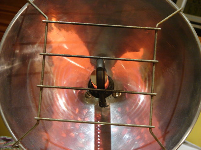

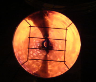

    Here are a few images of a Coleman (Canada) December 1935 Hot Ray Heater.
    The original ceramic Radiant, a Coleman name, did not survive Australia Post's gentle handling.

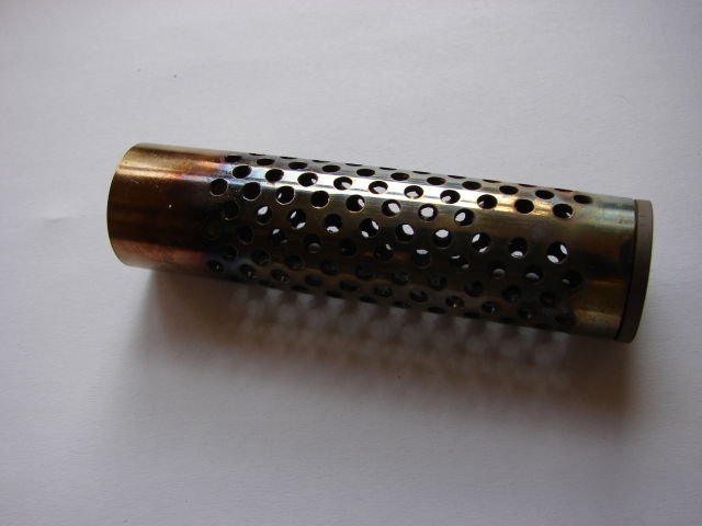

    This is one I made of 316 1 inch 16 Ga tube which fits without having to bore out the inside of the tube! The number of holes around the circumference is different mine has 20 the original 18. It is easier (quicker) to get 20 than 18 divisions on a dividing head.
    The most time spent was de-burring the inside of the holes. Stainless steel is known for creating a nasty burr on the exit when drilling.
  2. David Shouksmith
    Pity we can't see the part you made - sounds quite a job! Maybe the image you posted twice showed a view of it.
    Well done getting it running again, though... :thumbup:
  3. Jones the lamp
    Jones the lamp Subscriber
    Jan 3, 2012
    98
    Narrabeen, New South Wales, Australia
    Sorry for the stuff up with the images, senior moment, can will give close-ups of part asap

    Attached is an image of the mantle/radiant 1381443560-DSC01426_opt.jpg
  9. Flygt
    Nov 8, 2012
    175
    Thanks for posting about this variation of Model 480 HotRay. Nice work fettling the new mantle.
