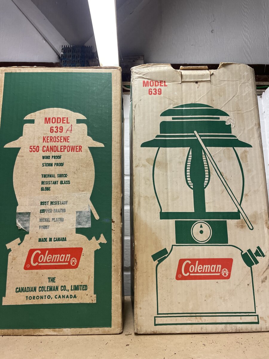

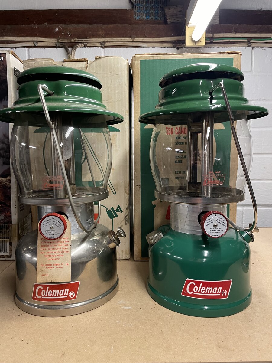

    I don’t understand why Coleman would go to the trouble of handwriting ‘A’ on the 639 boxes if there wasn’t some key difference? The bail is longer on the ‘A’ but that’s about it, externally.
    P.S. yes I know the colour is different on these 2 :lol:

    According to @Mackburner in the Pressure Lamp Catalogue, the Coleman 639 has a nickel plated globe cage and the 639A has a cadmium plated globe cage.

    @Tony Press , how can you distinguish between nickel and cadmium?
    11,050
    I know not...
  5. Fireexit1 United Kingdom
    3,524
    I do know that cadmium inside your body is really not clever..
  6. MYN
    For nickel-plated parts, most of you guys would be somewhat familiar with its usual colour. Cadmium plating can come in a greater variety of hues and difficult to pinpoint what is typical.
    For a steel globe cage, cadmium plating would offer better corrosion protection than nickel plating.
    Cadmium offers galvanic protection to steel/iron whereas nickel doesn't.
    Should there be minute spots and areas where the plating is compromised/missing, the underlying steel would remain largely rust-free if cadmium is used. If the plating is nickel, the steel/iron will quickly corrode in preference to the nickel.

    On close inspection, I do believe there is a visual difference, one that likely won’t show well in photos. The frame of the 639 is a lighter shade of grey with a more uniform colour. The ‘A’, along with the ‘B’, are a darker more metallic, almost polished steel looking colour. Pretty sure you could visually spot the difference between an ‘A’ and a standard 639 based on this.
