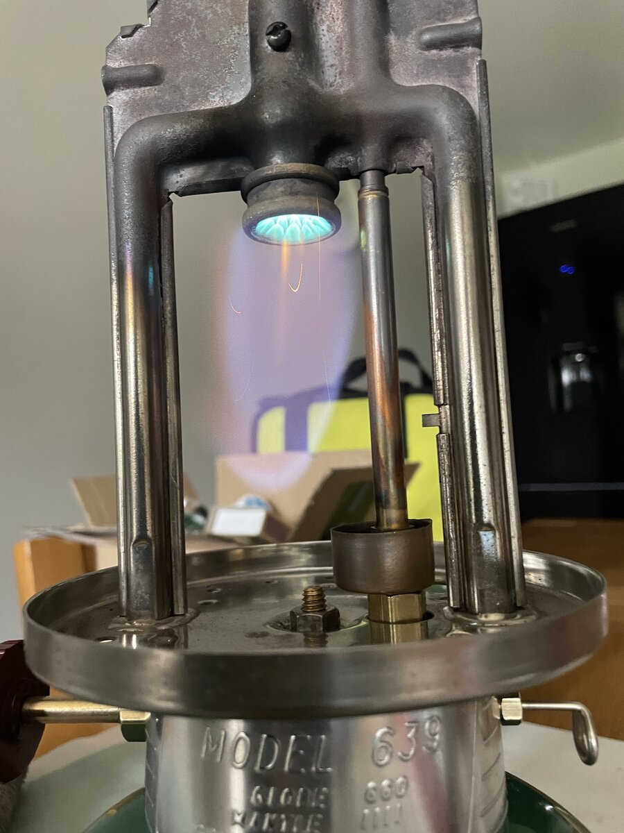

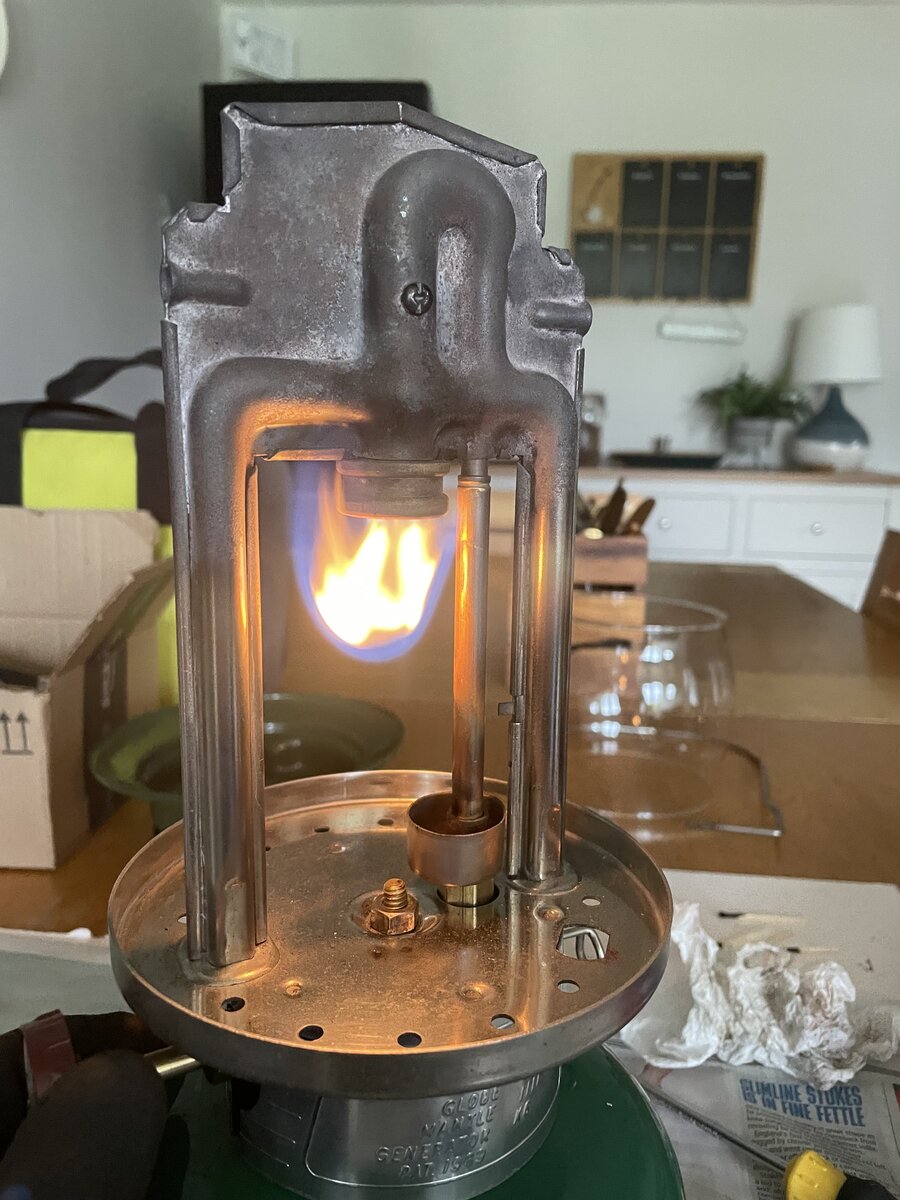

  8. Wolfie United Kingdom
    Nov 9, 2023
    24
    UK

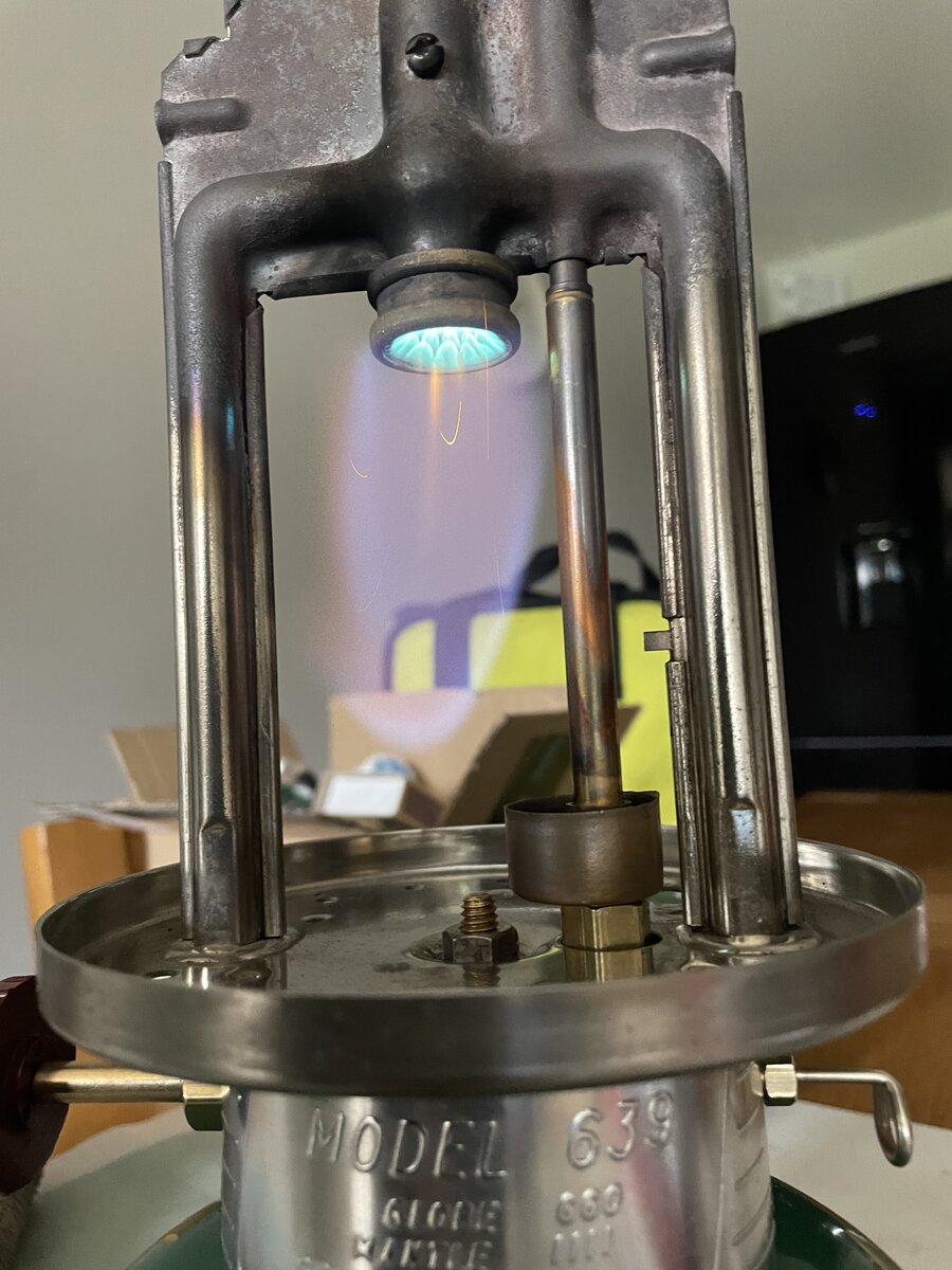

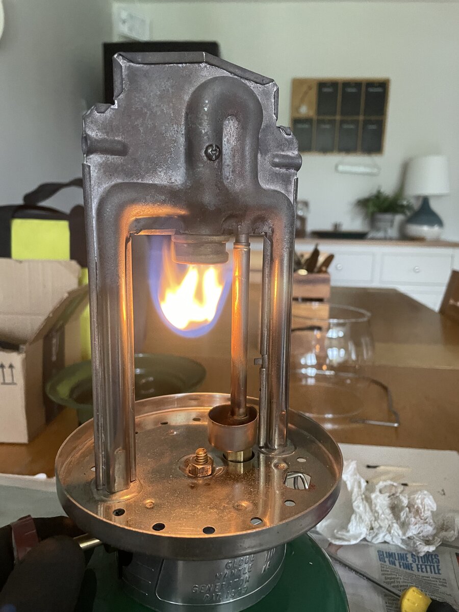

    The tank has about half a litre in it and as per the photos the first photo is ten pumps and the other is twenty five pumps.

  10. Kgam1020 United States
    Aug 30, 2021
    26
    Massachusetts, USA
    How is the burner screen? Is it in good condition? Gas tip tight on the generator? Your second picture looks good to me. Has a nice blue flame.

    You could do a 70/30 mix of kero/white gas. Or a percentage close to that. The picture you posted above, doing a naked burn. The lantern looks to be burning great. Nice strong blue flame. But it doesn't burn right once you tie on a mantle?
  16. Wolfie United Kingdom
    Nov 9, 2023
    24
    UK
    Yes that’s correct
    It burns as in the photos but when a mantle is tied on it burns outside the mantle.

  17. JonD
    JonD Subscriber
    Apr 15, 2014
    1,008
    Hertfordshire, England
    Your flame picture without a mantle shows clear yellow streaks which should not be there. That excess fuel is what is burning outside your mantle.
    You might mess with the fuel mix or you can fix the real problem which is the generator.

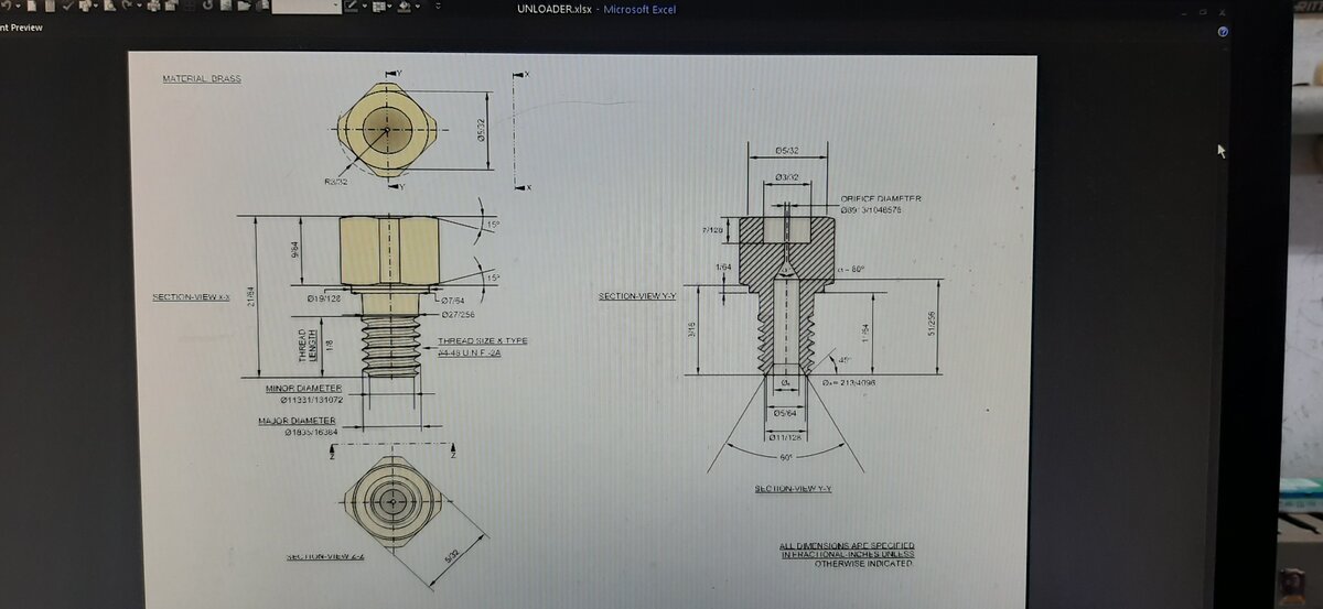

  25. Jacob van Pareen South Africa
    May 9, 2023
    214
    South Africa
    Myn,
    How did you make a jet with exactly the correct size?
  26. MYN
    @Jacob van Pareen
    That was a lengthy, tedious and a real pain-in-the-as@# project for me.
    At that time, I did not have any spare jets that would fit a Coleman. All I had was the existing, very worn, 73-year old jet as reference. Therefore, I had to basically start from scratch. I did not know what Coleman used for the exact dimensions for the jet. So, I made some meticulous measurements of the worn jet and some 'guesstimates' on what the workable figures could be. I had to literally put all those 'imaginative' figures down on paper and came up with an 'illustration' on my PC. I did not do it with CAD tools(don't have any) but by hand/mouse/keyboard using whatever drawing tools available on Microsoft Excel 2007. Therefore, I wouldn't actually call it a real drawing but rather an illustration of dimensions of a 'homemade jet':-
    With the above illustration, I visited a local machine shop. It does not have the proper toolings or equipment for such miniaturized item. (No mini-lathes. No micro drill bits. No imperial dies).
    Whatever available in the shop were huge machines for much larger parts. I had already bought some 5/32" square brass stock. Whatever the heck...I just bit the bullet and persuaded the machinist to get on with it making whatever was on the above illustration. Imagine the level of difficulty churning that out on a huge lathe. The chuck was simply too big to hold a 5/32 square bar stock...
    The subsequent 'behind-the-scenes' work was 'brutal and near unthinkable':mrgreen:](*,)for both the machinist and myself.

  28. MYN
    I bought some 0.2mm micro drill bits(Dormer) for the job. They are pretty expensive and not exactly available from your regular hardware store. I ordered them through RS Components. Initially, I had a couple that broke off without even completing the hole. What a shame and frustration.
    The jet on a Colemam 237 has a 0.0085" orifice(0.2159mm diam.). I suppose the 0.2mm drill bit would make a hole that's a tad bit larger than its nominal diametre...so, pretty much would suffice for the job.
    The shop's lathe chuck had a diametre exceeding a foot.(that'd give you an impression of its size and the awkwardness when the job was in progress). Another smaller chuck had to be clamped on to the larger chuck in order that the 5/32" brass stock could be held.

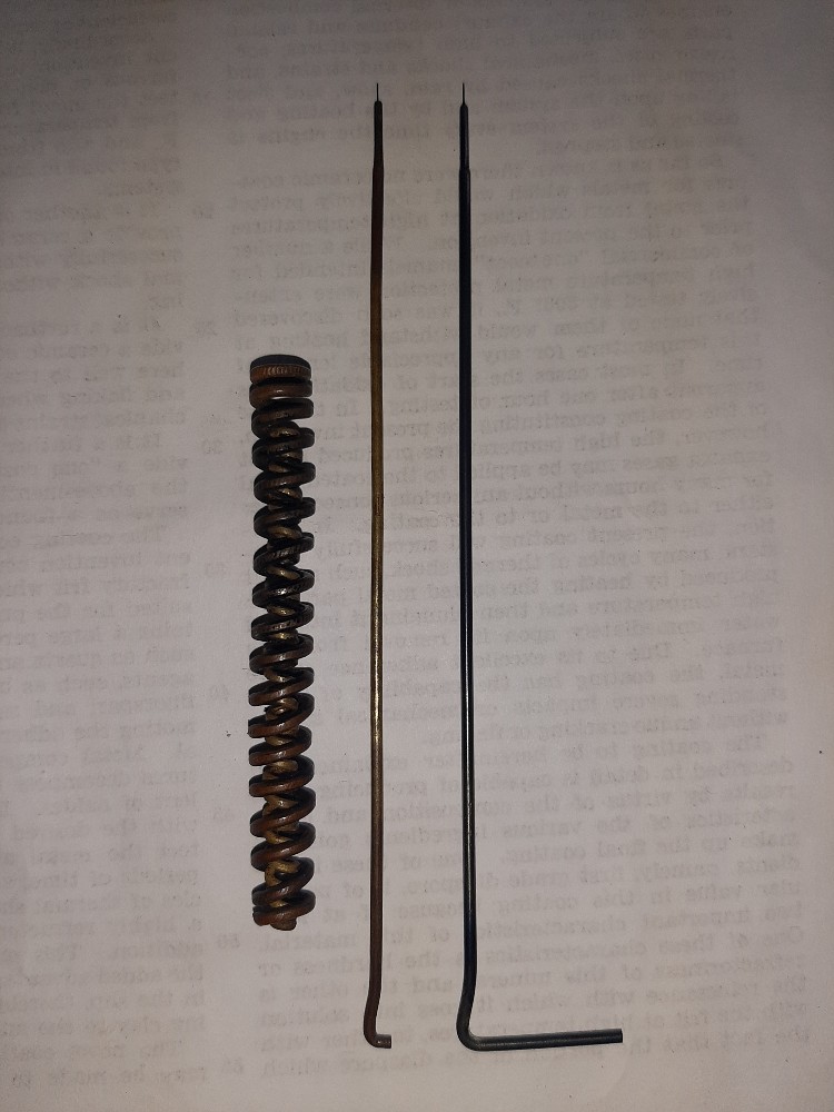

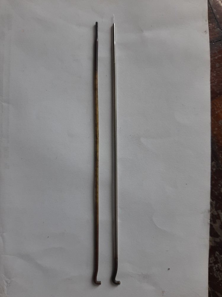

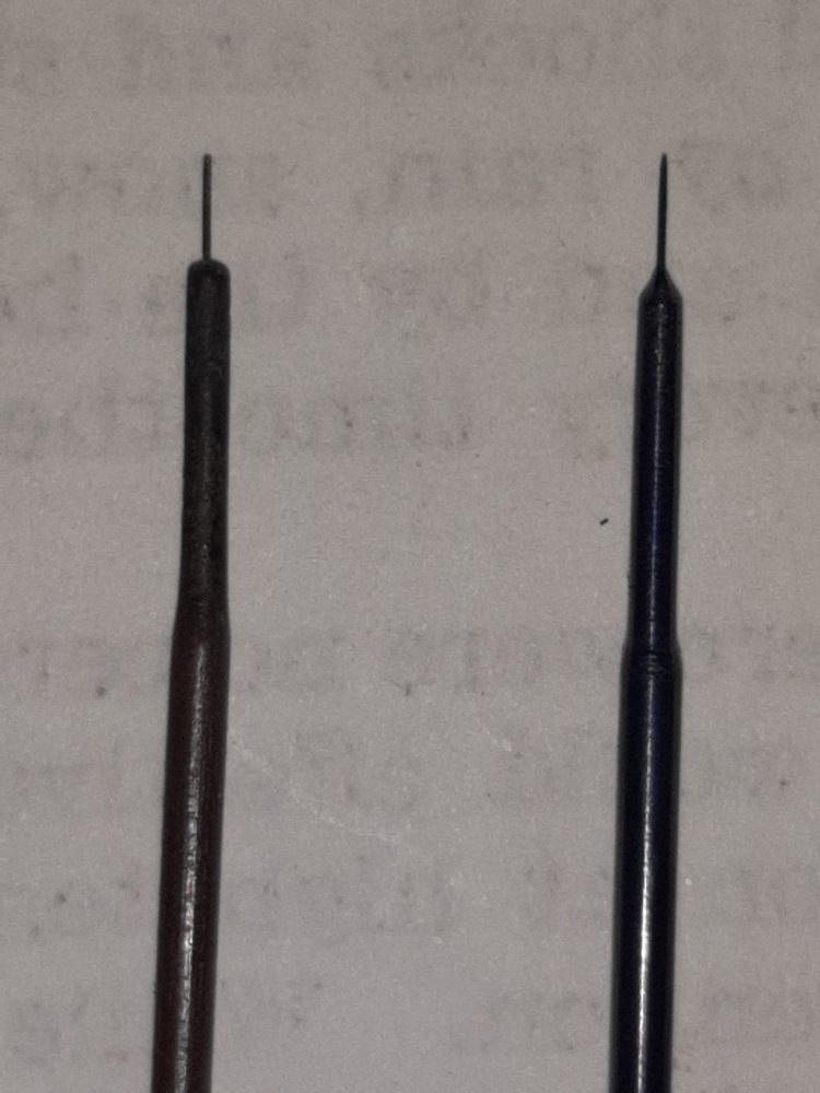

    Anyway, making the jet was only part of the story.
    You probably would not believe how I actually made a new cleaning needle/rod for that Coleman.
    Well, it was equally crazy: it was laboriously ground with some basic power tools from a single piece of 1/16" inconel weld-filler rod. There was no crimping, no piano wires, no guitar strings, no acupuncture needles and last but not least, no joints involved.(That was only because I can't find any with the right size at that time).
    Here are some pictures. Left: original. Right: homemade:-
    Note: The original pricker wire had eventually broken off during use(2nd picture).
