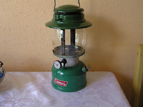

    The above is the lantern as it arrived today, the first query I have is I have not got the manufacturers recommended lighting procedure/instructions, i would like to know how much pressure is required IE how many stroke of the pump is required to bring it up to full pressure on a full tank. And can the lantern be fully pressurised and then the regulator opened up after it has been preheated, or is it semi pressurised and then the regulator wheel opened and then brought up to pressure in the same way as a Tilley or Bialladin etc.

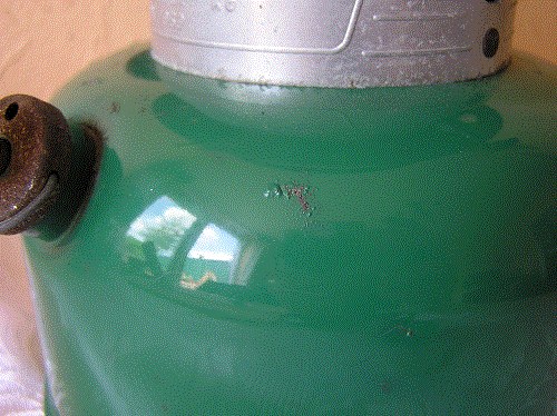

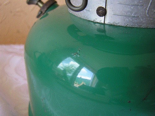

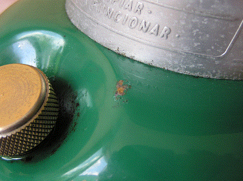

    The second question I have, in the pics above even though the lantern is in quite good condition, there are a couple of small rust spots in the paint as shown in the above pics, I was wondering what is the best colour match for the paint, as I am considering repainting the tank, not just to make it a shelf queen, but being as the tank is made of steel I want to stop it getting worse and to protect the tank so it will last for ever, ps I forgot to mention this lantern is date stamped 73 so it is 40 years old

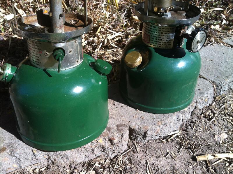

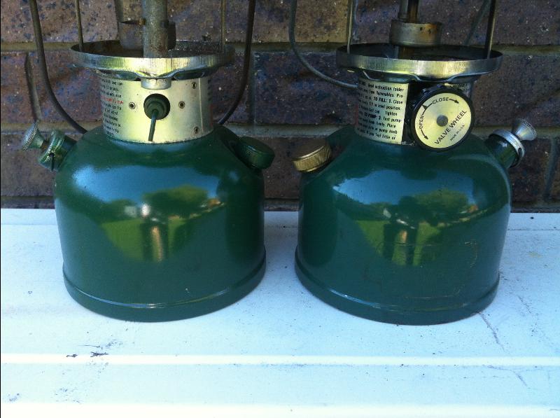

    Mr Optimus, A bit late but I took the pics today of my 201s for you to compare paints. The 201 on the left was scratched/bubbling/rusting so I cleaned and repainted with the Rustoleum Universal Hunter Green. I needed to reseal it as it was my camp lantern (until I discovered 249s, and stole the globes from the 201s for 'em). The 201 on the right as far as I know has original paint. A shade different in color, but close enough for a working lantern.
    If you find a better off the shelf match, let us know. Look forward to seeing how it turns out for you.
    Antony
    PS almost ashamed of cage condition in those pics. Really should clean them up. But they have been very well used.

    Best thing to do on the fount is to bead blast it clean of rust and use a good primer prior to painting, something the factory neglected. The rusty spots can fail, especially if they are over a stamped letter or some irregularity

    Rustoleum do a good combined rust killer & primer (black) and Kurust is also great for exterior rust.

    Honestly I would keep the lantern original the rust spots are not too bad looks like it's in great condition

    i would leave as is.looks fine to me. put some metal polish or car wax on fount,it should protect it.nice lantern!
