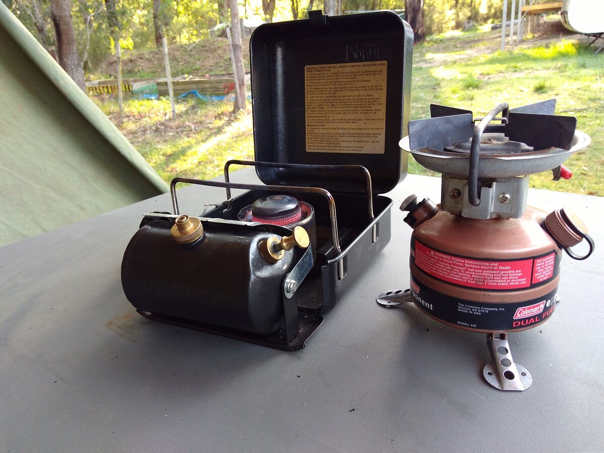

    as far as using petrol in a dual fuel. I have used petrol in an Optimus and Coleman single burner stove for years with no issue. the Coleman in my estimation has consumed at least 200 litres and still burns well. the instruction say the prefernce is Coleman fuel, (petrol without the additives or Shellite) I have only have pulled the vaporiser apart once to give it a clean
