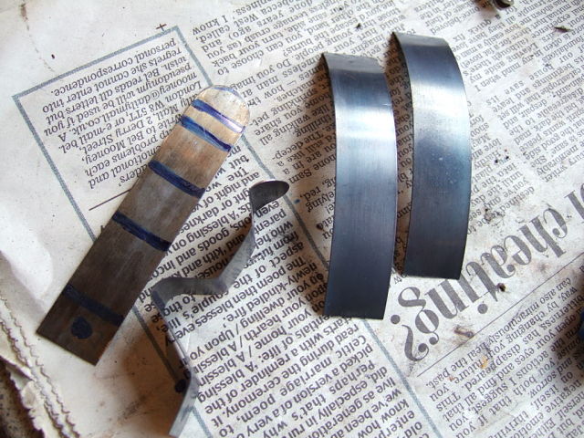

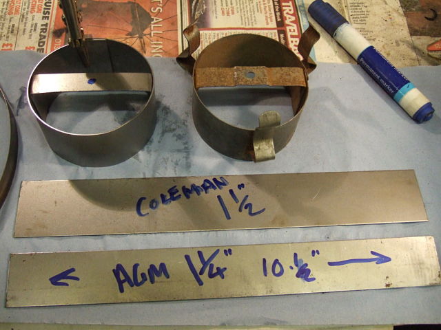

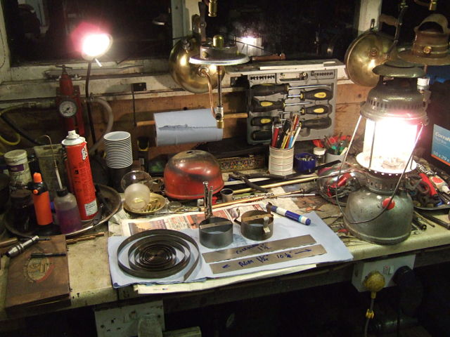

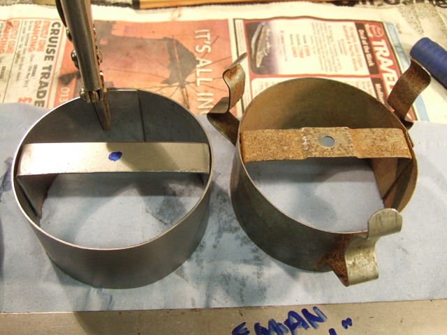

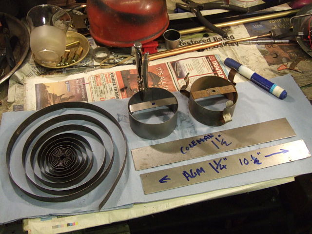

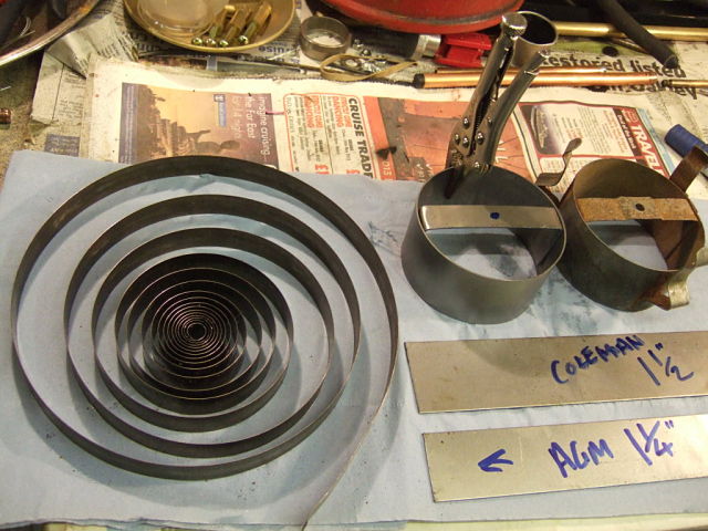

    I said i'd have a go at making a globe support for it [-o< , so after scrounging some sheet steel at my local metal merchants they cut it up for me into the correct size 8) :thumbup: & i have formed one up ready to spot weld together :D :thumbup:
    I have some old clock spring steel to fabricate the three sprung support clips which will also be spot welded on :D :thumbup:
    Here's where i am so far :D :thumbup: ....
    The workbench tonight :D :thumbup:
    Here are the parts so far formed into the Coleman type :D :thumbup:
    Will post some more pic's when i get further along :D :thumbup:
    Best regards Stu :D :thumbup: .

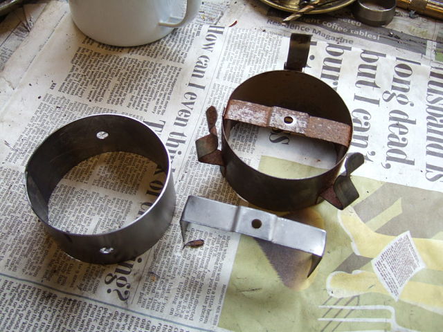

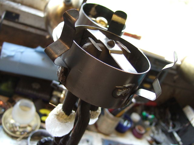

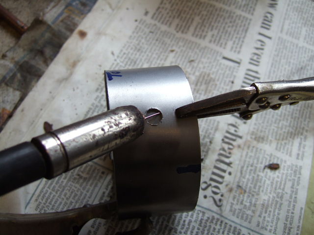

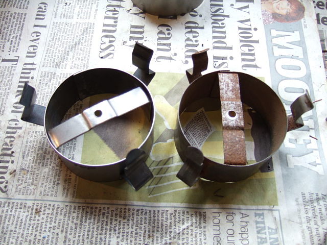

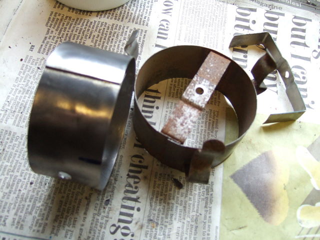

    I have been working on the Coleman globe carrier for my CQ :D :thumbup: also in the hope of finding a globe to fit on to it as well [-o< & have completed the first trial one :D :thumbup:
    The steel ring was clamped & silver soldered together :D & the central support was bent to shape incorparating the slight raised center to fit onto an original burner head :D :thumbup:
    The cross piece was spot welded into place :D

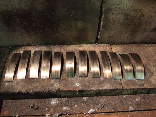

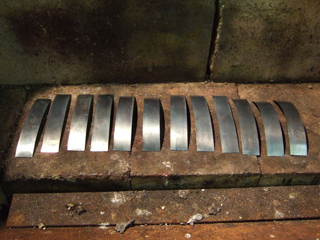

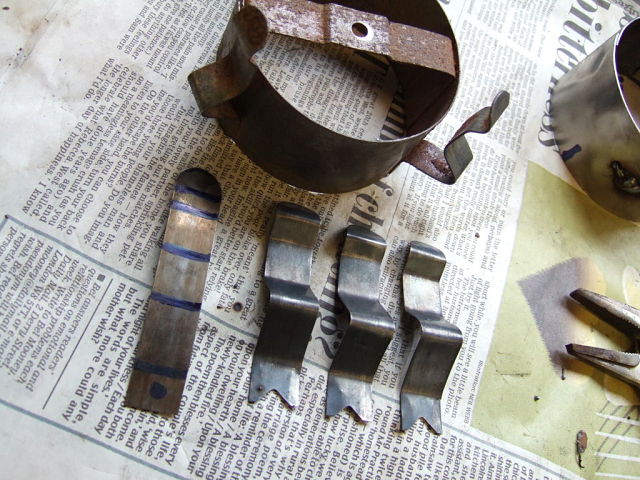

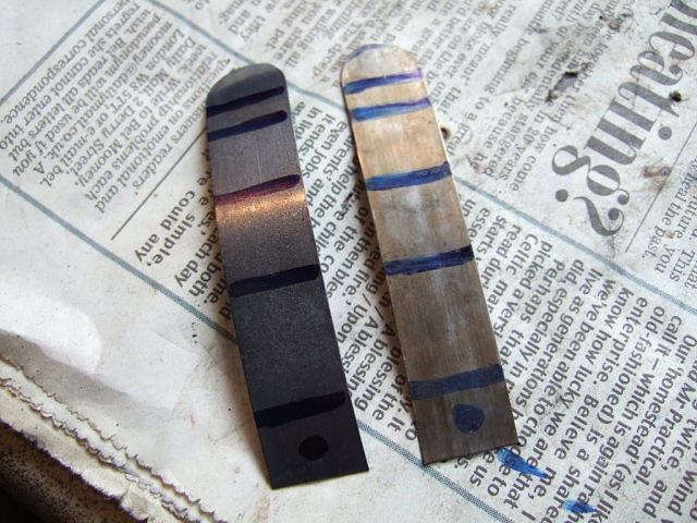

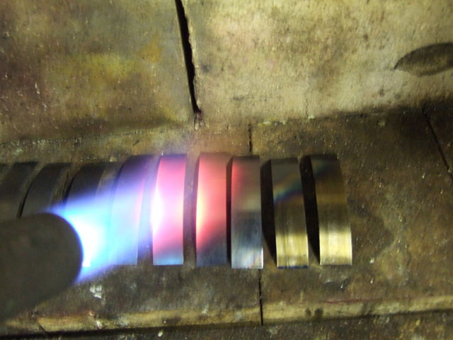

    Next job was to cut the old clock spring steel for the sprung globe holders , these were then layed out on the hearth & tempered by heating to dull red with a propane torch , this makes the steel less prone to fracture when bent into the correct shape :D :thumbup:
    Tempering with the torch :shock:
    Note the change in colour , nice & even [-o<
    The top of each spring was ground to give a nice rounded tip like the originals then bent into shape after marking the fold lines from a master :thumbup:
    On the first three i ground a notch out which is where they were spot welded on to the steel ring :D :thumbup:

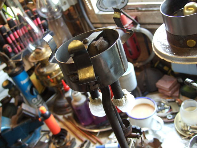

    Then the springs are welded on :D :thumbup:
    & here's the finished support trial fitted just needs a bit of a tidy & i'm there :D :thumbup:
