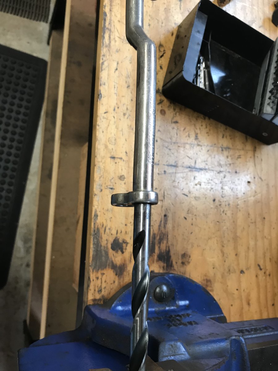

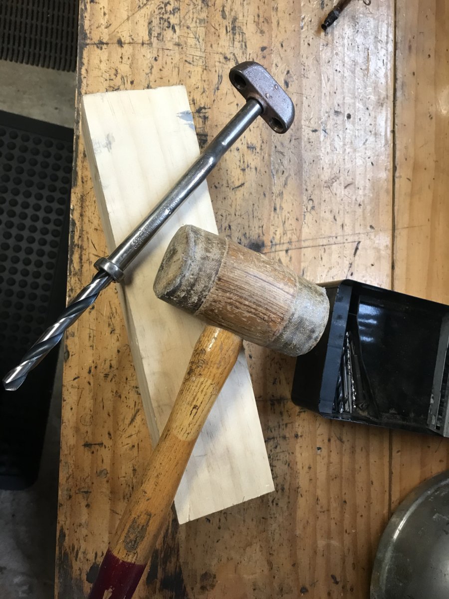

    Further the air intake tube was bent. By using a snug fitting drill bit as a mandrill the bend and any dents were removed using the judicious tapping from a wooden mallet.

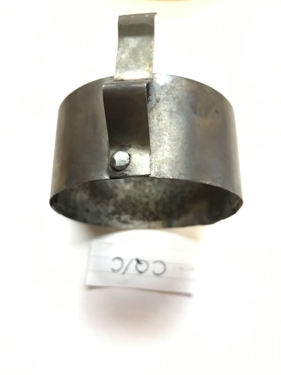

    This lamp has been fitted with the “Universal” shade holder. During transit from America, 2 of the shade holder’s fingers had been broken off.
    Two rivets were lathed from large iron nails and the detached fingers were resecured by using and peening the rivets to fix the fingers back onto the shade holder.

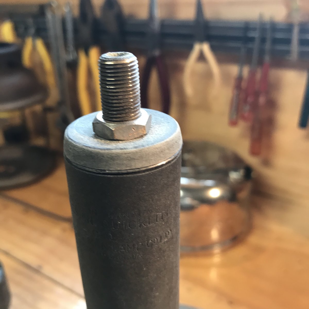

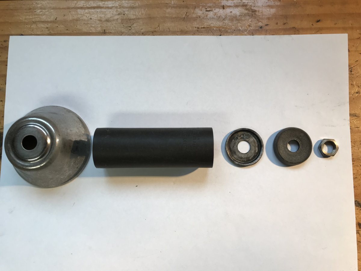

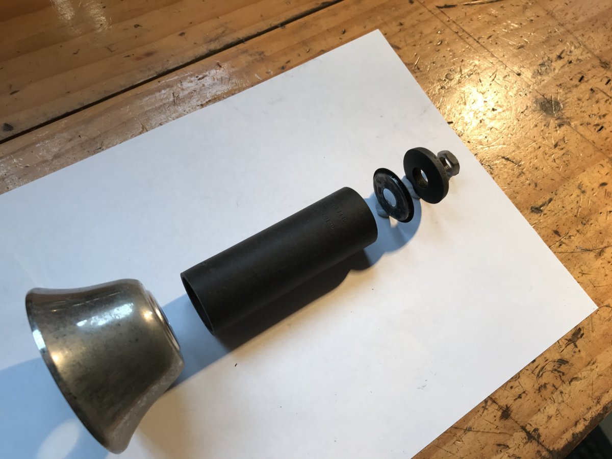

    The black fibre handle was removed and the components cleaned.
    The fibre handle is secured by a nut. In autumn 1928 the CQ/Cs’s nut had been changed to a threaded sleeve and the nut omitted.
    (Reference #03)
    The fibre handle is embossed with the following:

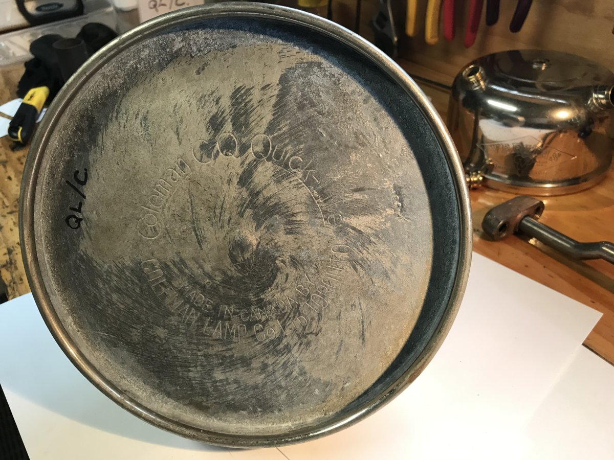

    The fount was first cleaned with oven cleaner then polished with Mother’s Mag Cleaner.
    The base of the fount is embossed as shown:

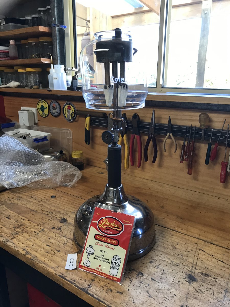

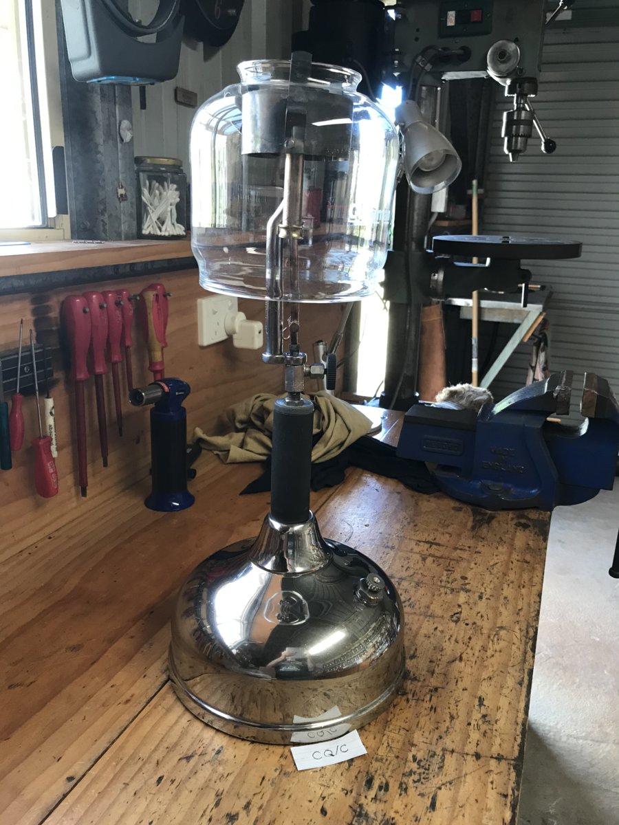

    The finished lamp fitter with a reproduction Coleman glass globe.
    I used Peerless 2C-HG mantles. The fount was fueled with Shellite fuel.

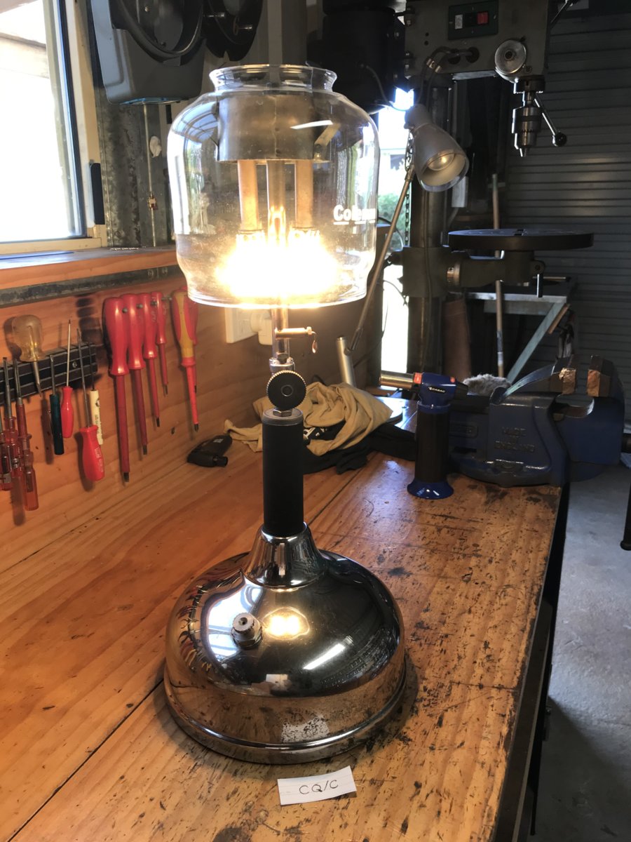

    The “Money Shot”.
    Summary
    The CQ/C lamp detailed here was one of my easier fettles. It was very easy to light and produces a pleasing amount of light.

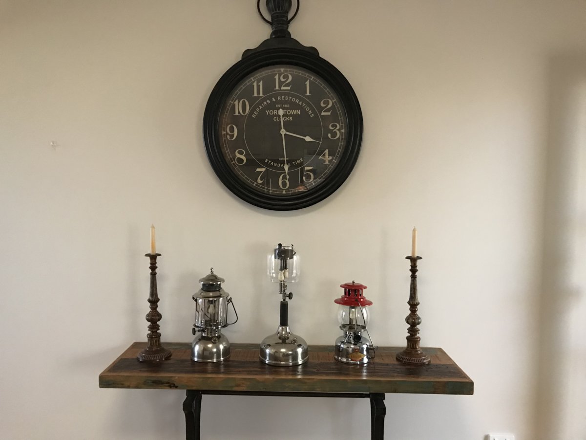

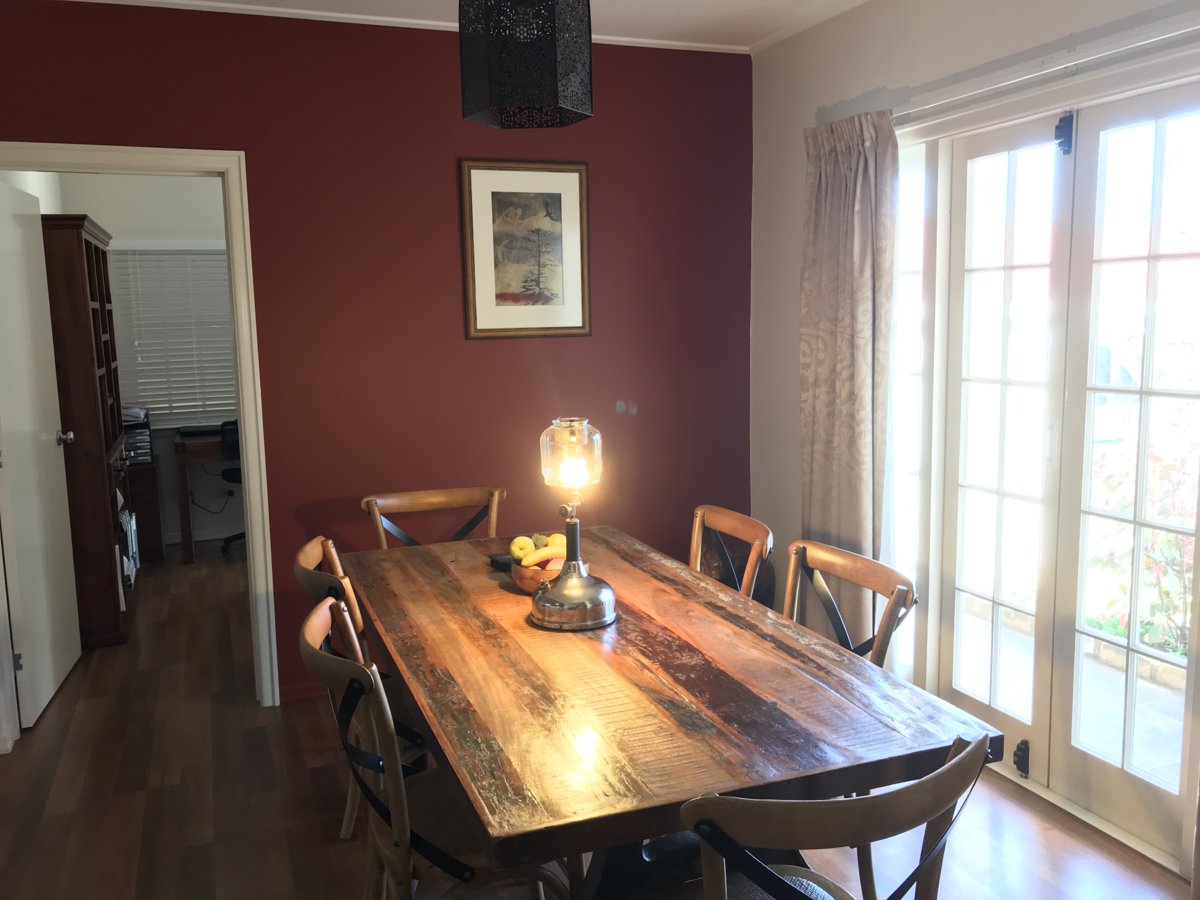

    The Coleman CQ/C now resides, in the kitchen, between an Akron 103G and a Veritas Superb.
    With all that assembled candle power, I just had to add 2 more candle power ..... :lol:

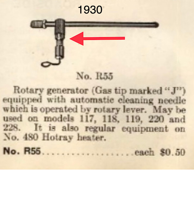

    When did the R-55 generator come into production?
    I’ve seen various discussions about when it was fitted as standard to certain lamps and lanterns (eg Coleman 427) but I’ve not nailed an accurate date for its start.

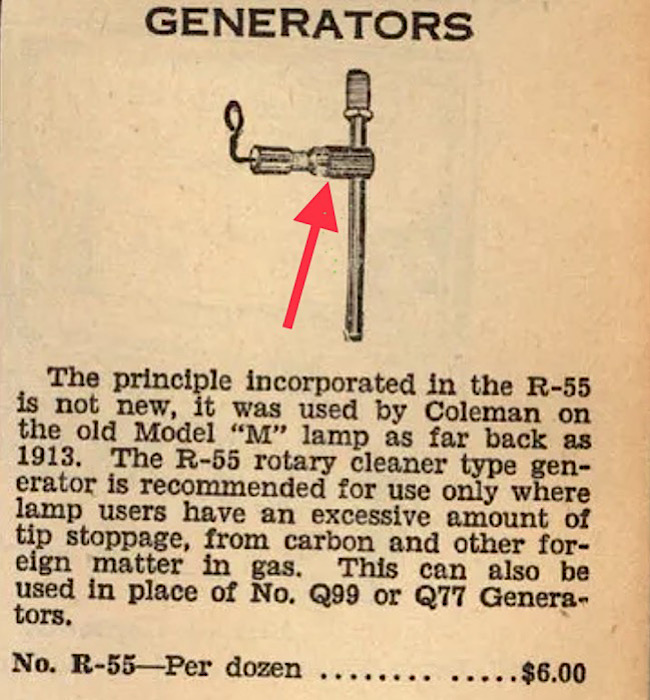

  15. coleman54
    Jul 21, 2020
    272
    Oklahoma, USA

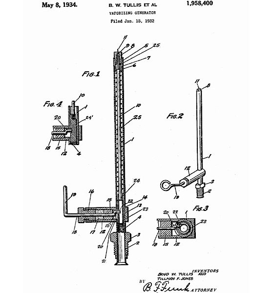

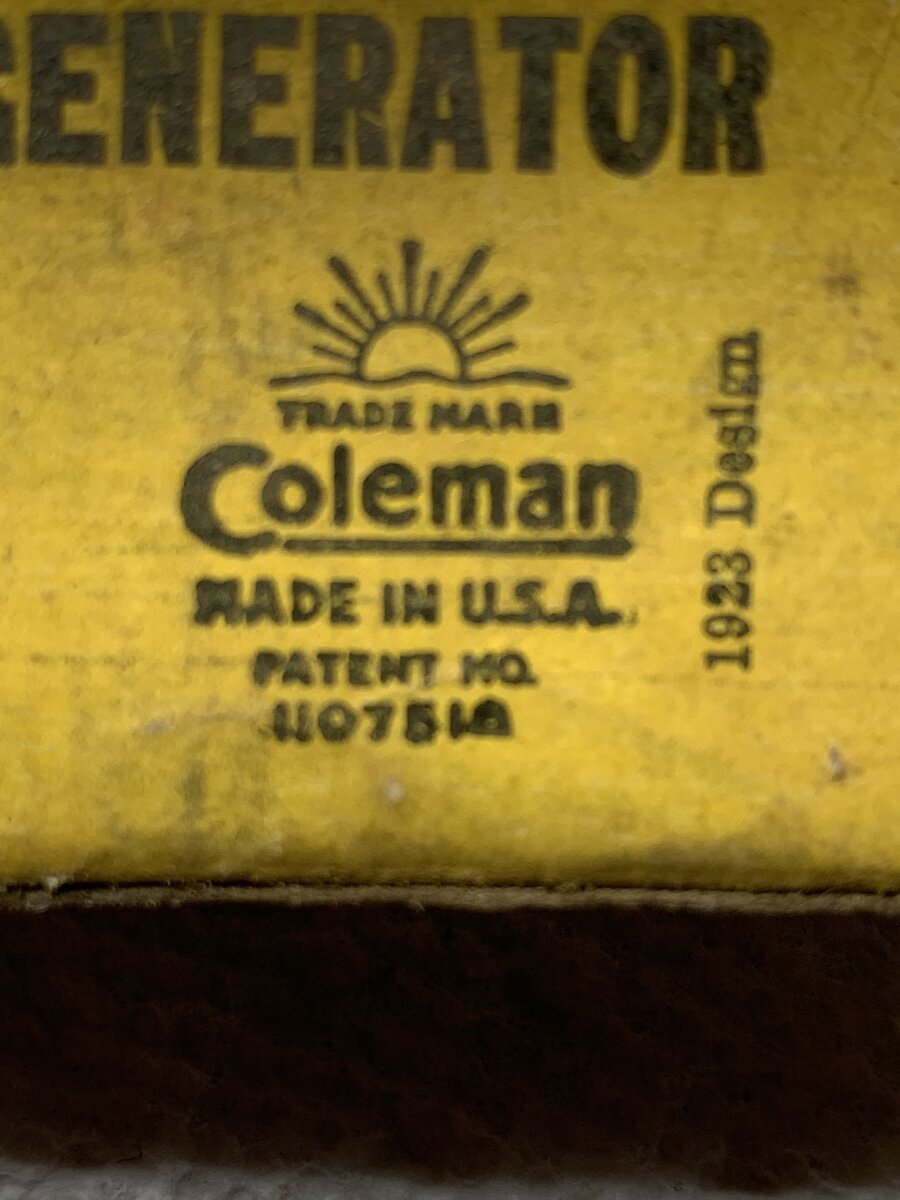

    Hi @Tony Press , the Coleman R55 started showing up in 1929. Some early packaging states a “1923 design”, no patent was applied for until January 1932 and was granted in 1934.
  16. coleman54
    Jul 21, 2020
    272
    Oklahoma, USA
    The first design coincidentally is similar to AGM, the second design that was patented is not, the third design has an enlarged barrel for more room for carbon build up and fuel capacity.
    If you look up the patent listed on the box that states the generator is of a 1923 design you will find it is a mantle patent that has nothing to do with this product
