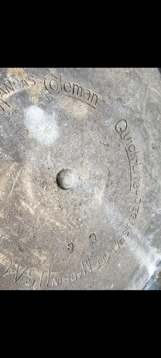

    Why did Coleman originally make CQ with a hex nut in early years ,then later just solid nub on bottom?
    When I get my CQ I bought for parts( I'd like to build one with 2 lamps - combine with best working/ visually best parts- to one best unit...

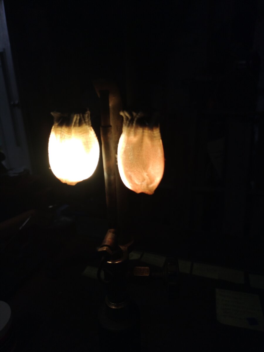

    Well, took it all apart blew everything out again to make sure I didn't miss something looked really good in with flashlight everywhere (clean the mating surfaces up and got the leak to stop)but left mantle Burns bright ,right mantle is only about a quarter of the way lit?(When I turn the valve off on the left side the typical little fireball is there for a few seconds but not on the right that eventually goes away just like on lanterns)
    If I don't have enough fuel in this tank will that do it?
  23. My29cq329
    My29cq329 United States Subscriber
    Mar 10, 2024
    48
    Ne Ohio
    Here's what burning looks like( left good,right not good)

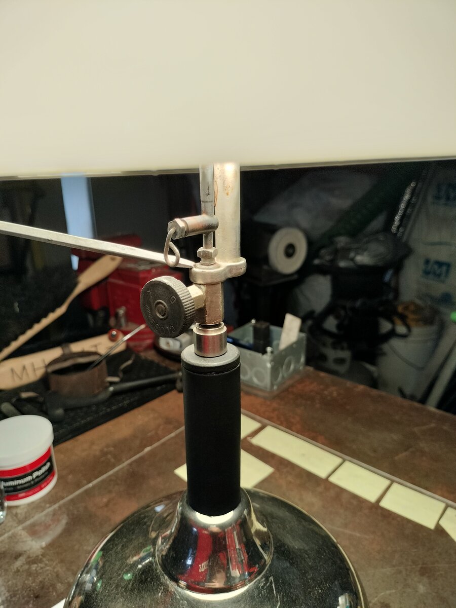

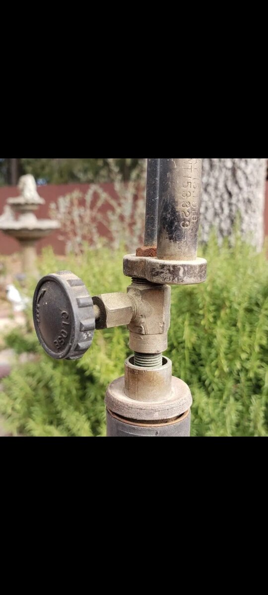

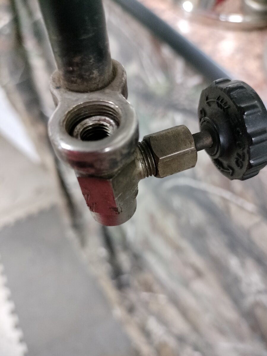

    I figured out what was doing it and I'll attach pictures to show someone else that may run into this.
    The female threads on top of valve was missing the inner part that raises generator up into burner hole( without this part my generator was barely up inside hole)
    I swapped pieces out to one that had this extra bit to raise it up and burning perfect!
  25. My29cq329
    Mar 10, 2024
    48
    Ne Ohio
    The screw driver shows small collar installed and other one not there( I'm not sure if this small screw in collar was always there and the one that is in my picture that doesn't have it was removed at some point and never re installed or what?)
