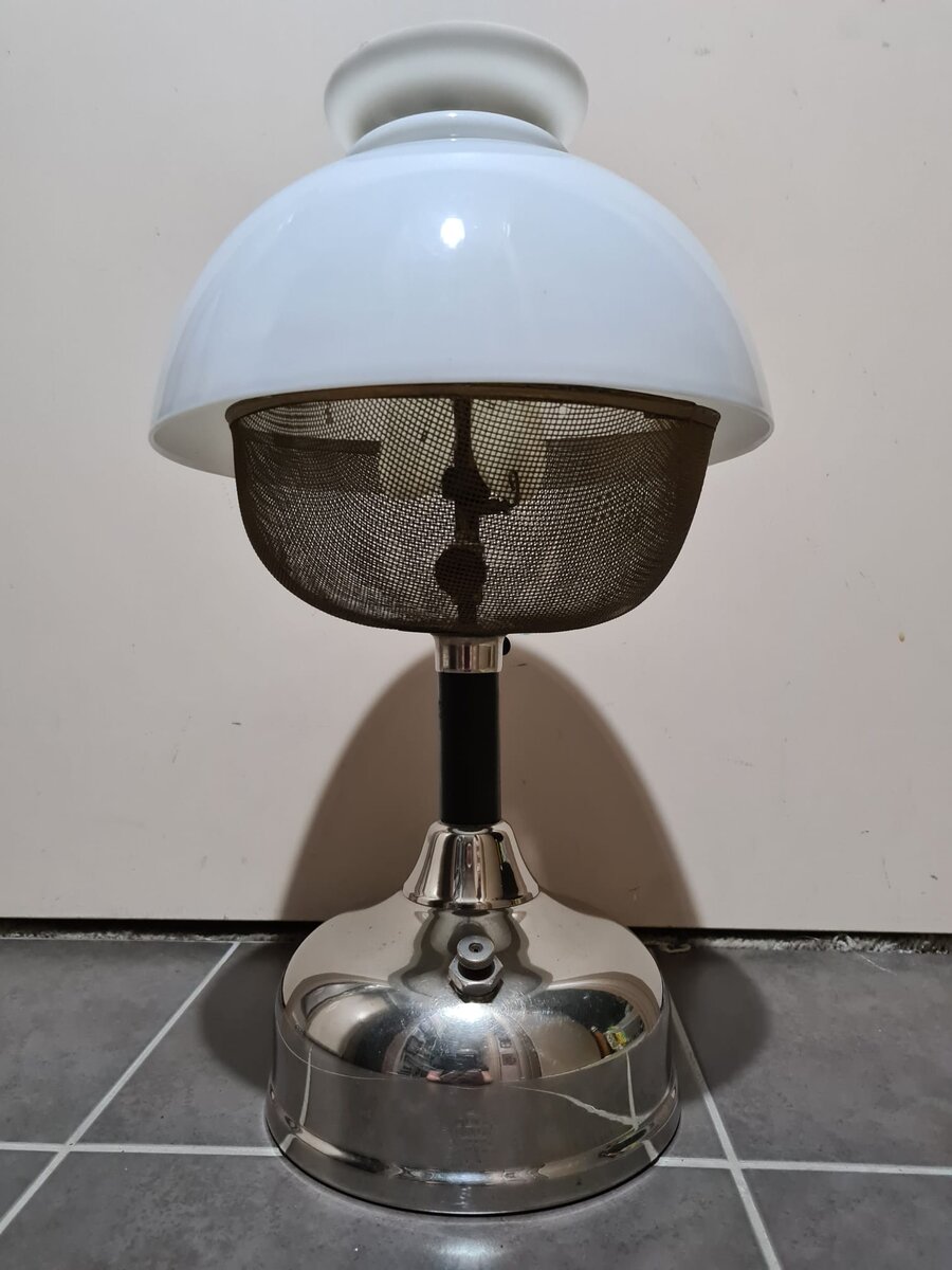

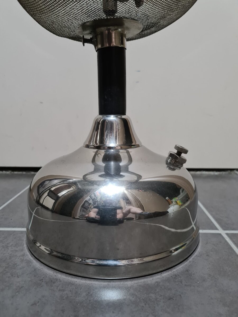

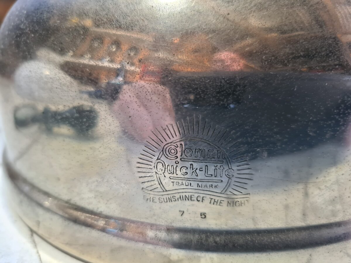

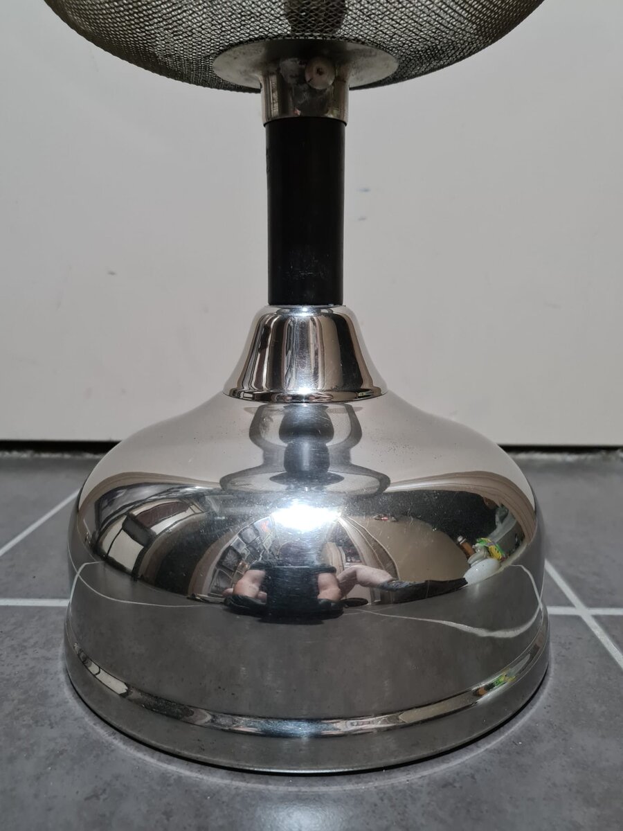

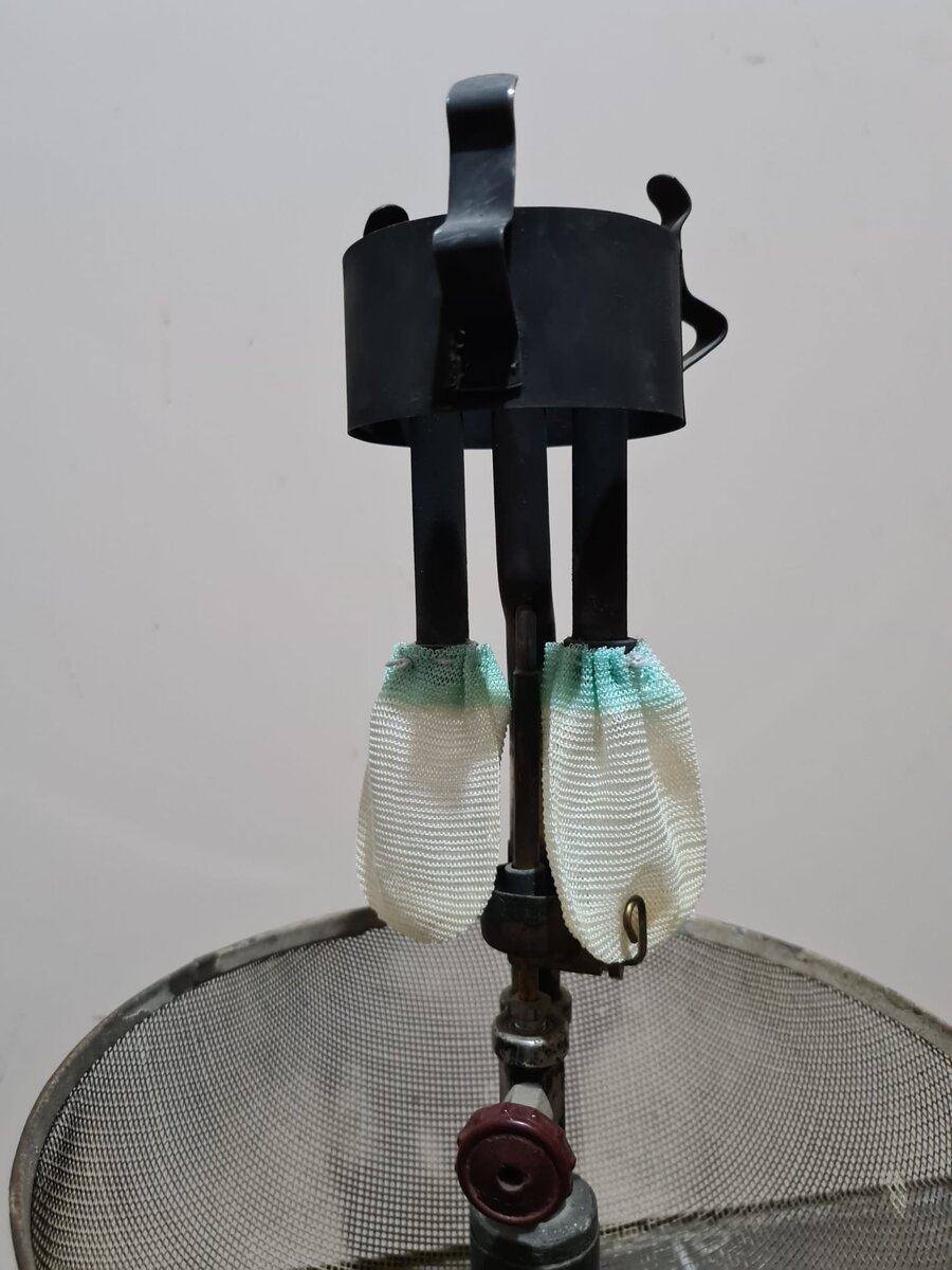

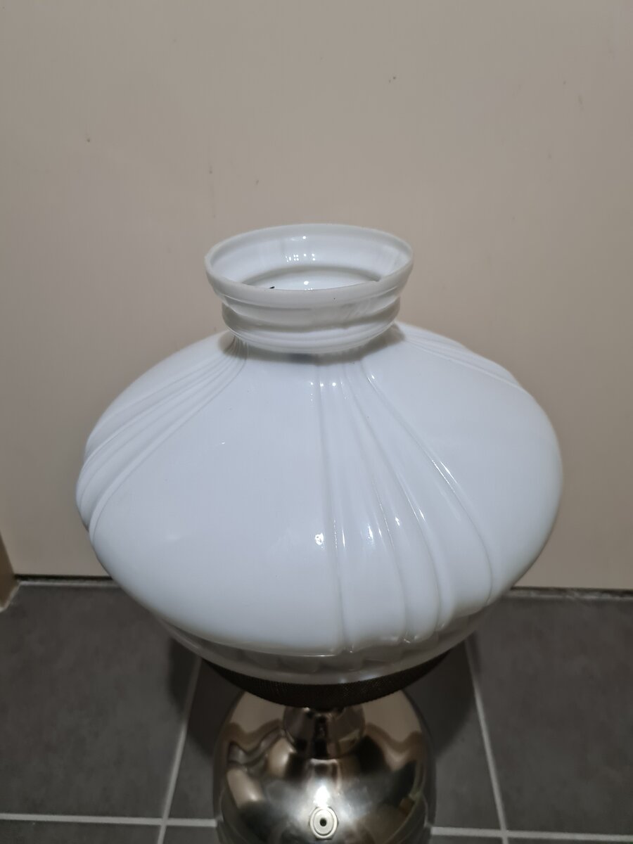

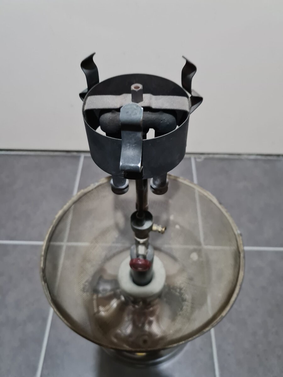

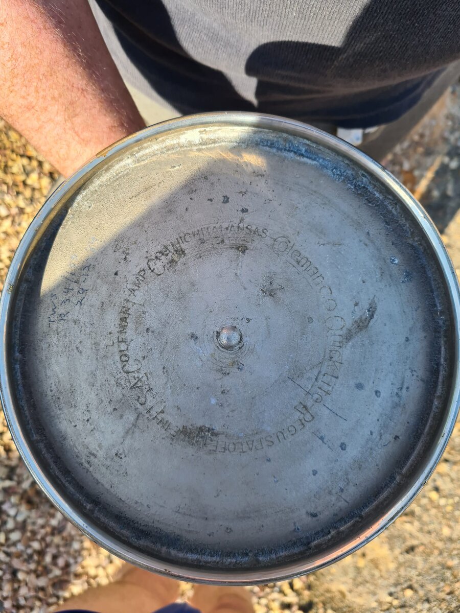

    Hello all, this is the only Coleman lamp that I've in my collection, I just couldn't say no to this lovely table lamp, yes I know the shade isn't correct, but that's how it came to me, if you are interested here is the link explaining why I only have one Coleman.
    Did I Really Say I Wouldn't Collect Any Coleman Lamps?
    So here are some photos as found then some photos with just a hand polish and two mantels added for looks.
    CQ Table Lamp May 1927 1.jpg CQ Table Lamp May 1927 2.jpg CQ Table Lamp May 1927 4.jpg CQ Table Lamp May 1927 8.jpg CQ Table Lamp May 1927 10.jpg CQ Table Lamp May 1927 11.jpg CQ Table Lamp May 1927 12.jpg CQ Table Lamp May 1927 13.jpg CQ Table Lamp May 1927 14.jpg CQ Table Lamp May 1927 15.jpg CQ Table Lamp May 1927 16.jpg CQ Table Lamp May 1927 17.jpg CQ Table Lamp May 1927 18.jpg CQ Table Lamp May 1927 19.jpg CQ Table Lamp May 1927 20.jpg CQ Table Lamp May 1927 21.jpg CQ Table Lamp May 1927 22.jpg CQ Table Lamp May 1927 23.jpg CQ Table Lamp May 1927 24.jpg CQ Table Lamp May 1927 25.jpg CQ Table Lamp May 1927 26.jpg
    Thanks for looking.

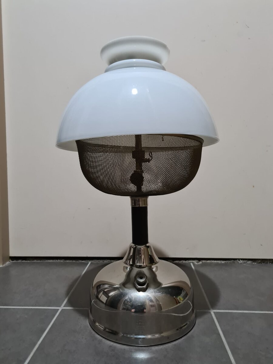

  5. Buggerlugs

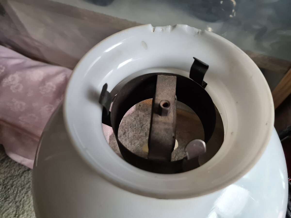

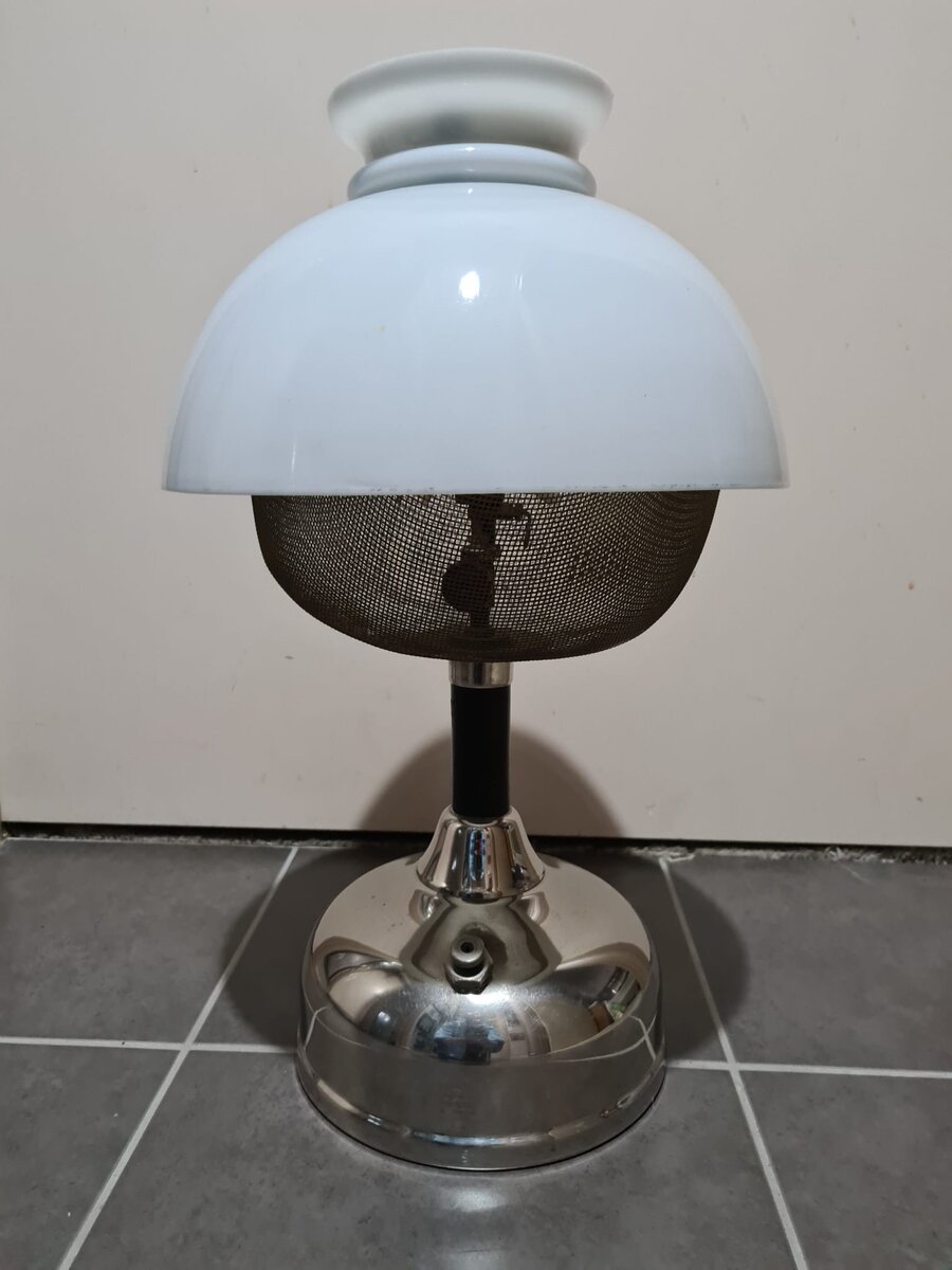

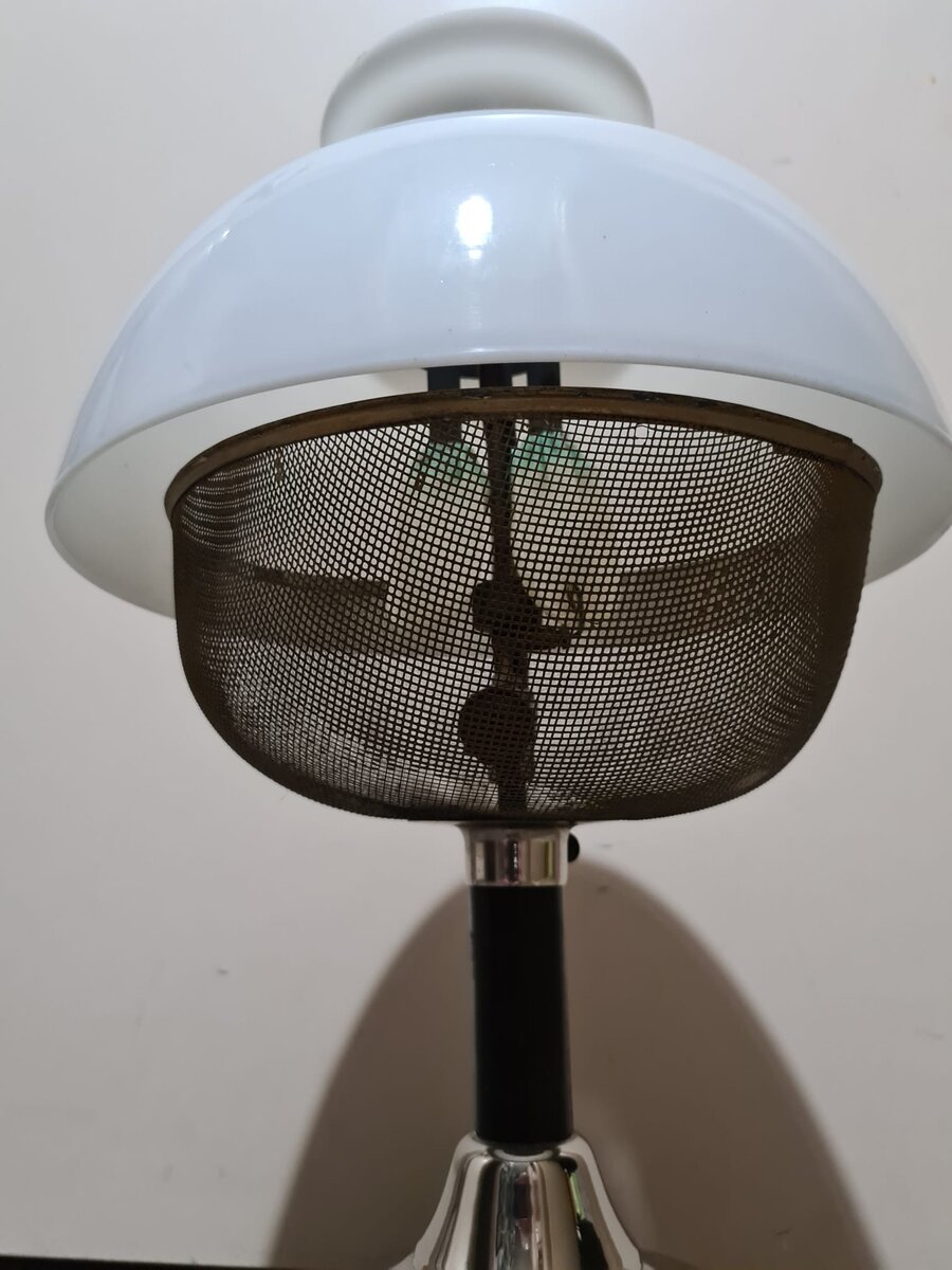

    Thanks for all the comments.

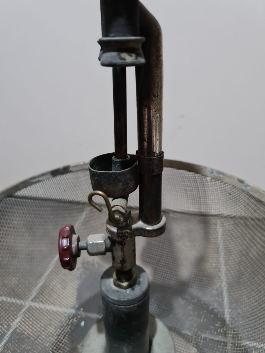

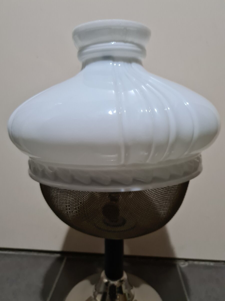

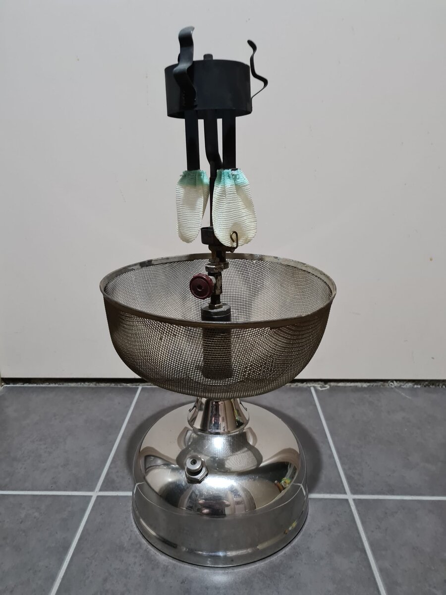

    I managed to get the shade to fit properly looks better now.
    My lamp has been fitted with the later R55 generator with its onboard pricker and preheater cup, not the original Q99 type with the loop which required a pre-burn with two matches.
    The control wheel has also been replaced as the original would have been a fibre type, thanks to this Forum and from Forum members I've learnt this information.
    Here are some more photos.
    20220427_113530.jpg CQ Table Lamp May 1927 28.jpg CQ Table Lamp May 1927 29.jpg
    Thanks.

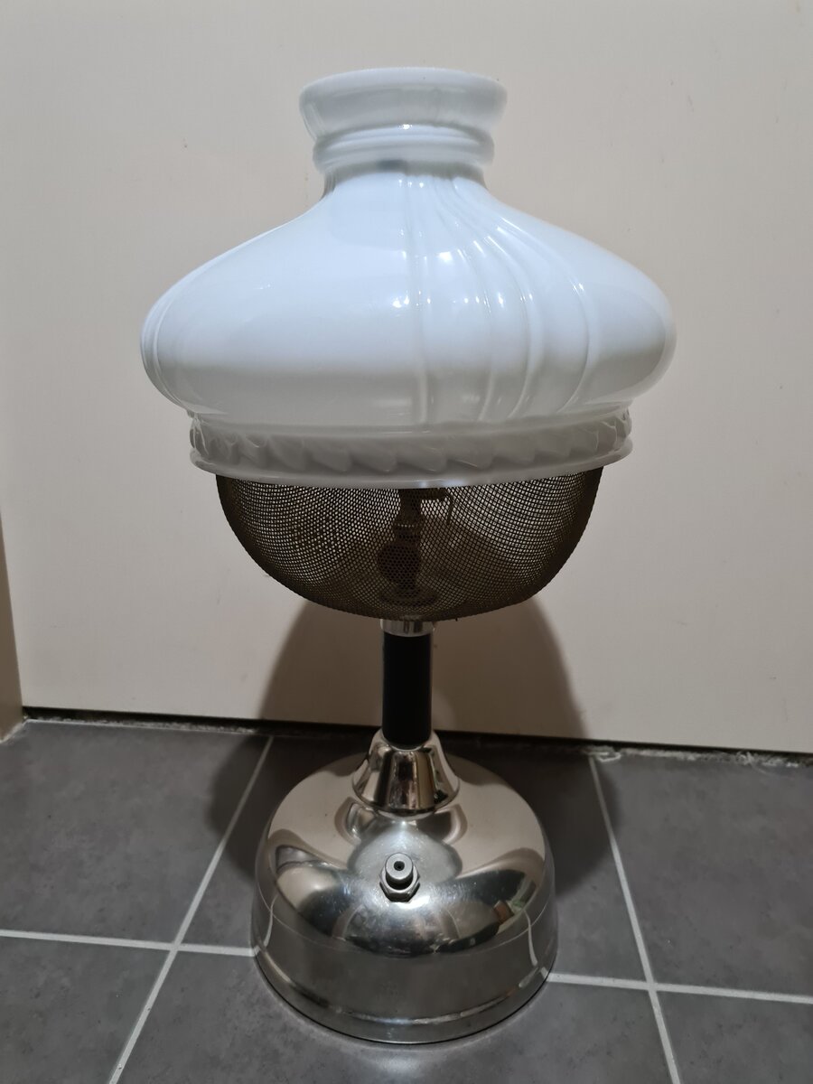

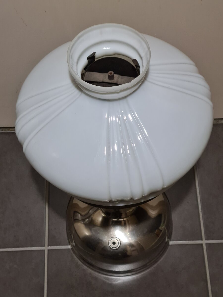

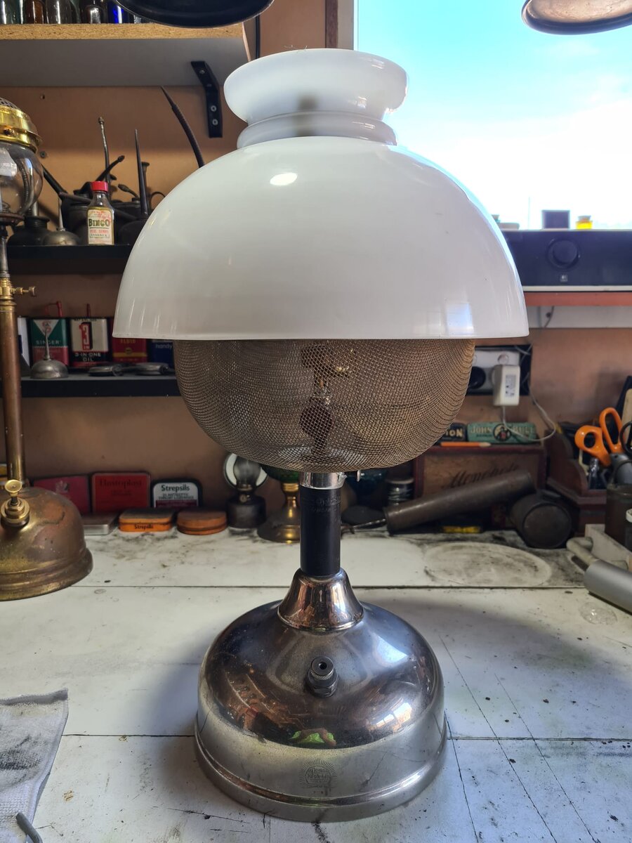

    Hello again and of course out of nowhere look what pops up?
    20220427_211819.jpg 20220427_211846.jpg 20220427_211554.jpg 20220427_211541.jpg
    Wow what a difference a shade makes.

    Fantastic ! :thumbup:
    It looks like there’s less chance now of big moths getting past the edge of the shade too !

    On the subject of the control knob as to fibre v bakelite, the Coleman Products book says that the Bakelite wheel with 12 ridges was introduced on the CQ lamp “approximately 1926”.
    I note that the bakelite wheel on this lamp is a reddish colour. I can’t say whether it’s original to the lamp or not.

    It fits perfectly not even a mozzie (mosquito) as we call them.

    @Buggerlugs beautiful CQ. Looks sharp with the protect-a-lite and the Famous shade really sets it off nicely.
    As far as the valve wheel goes in the US Coleman would retain the fiber wheel up to 1928 and then start transitioning to the black bakelite mid 28 sometime. Your red wheel is a mystery, but tells a part of the lamps long life story... If only it could talk :) I suppose hissing through it's burner tubes is talk enough :content:
