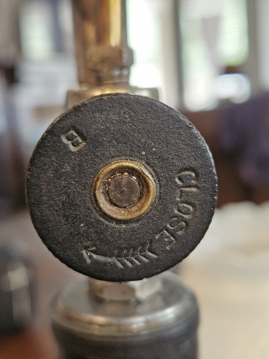

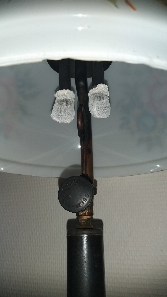

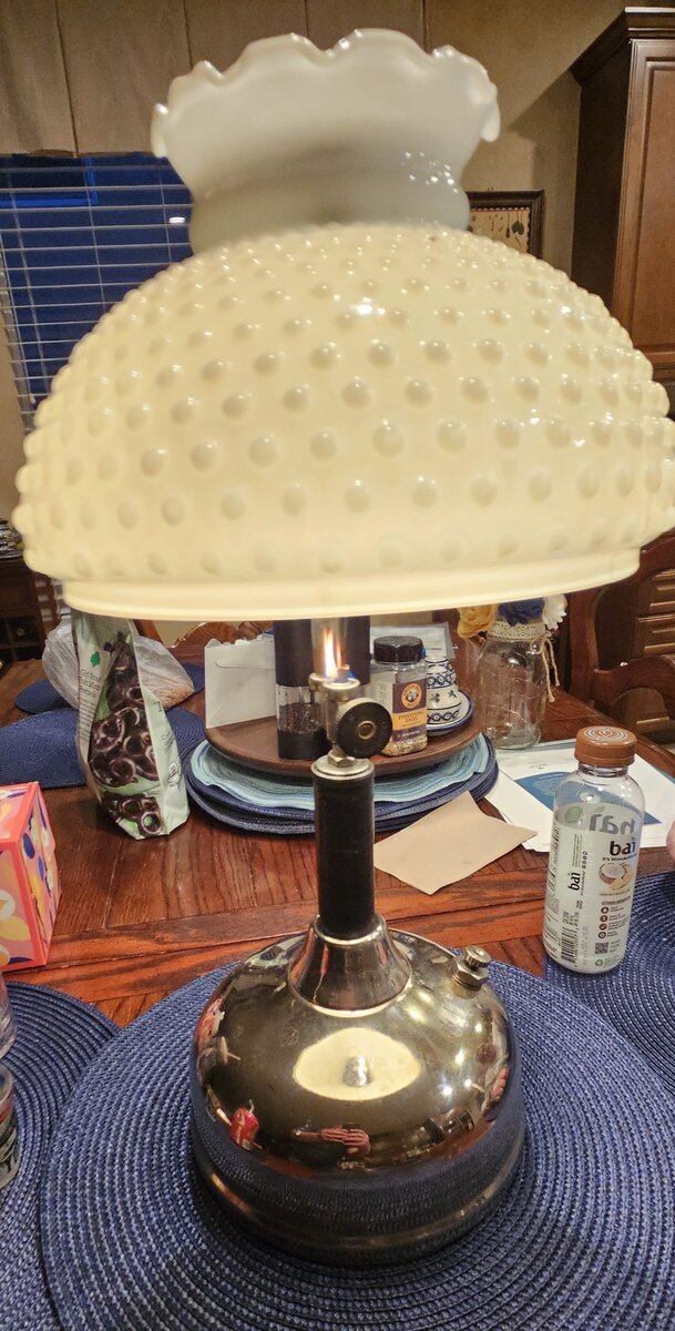

    Been awhile since I last posted. Here is a Coleman CQ Table Lamp dated 1923 that I just finished restoring. 101 years old and still works! Just needed a good cleaning. Took forever to clean the fount. Lit her up and found that the #21 mantles I used are likely too small. Can anyone tell me what the correct mantl size is for this particular model? 20240425_194203.jpg 20240425_123731.jpg 20240425_123238.jpg

    A lovely lamp which appears to be working well, the shade is beautiful too!
    I believe the 21 is the correct size mantle, are you experiencing issues with those currently fitted?
    Regards, Jeremy

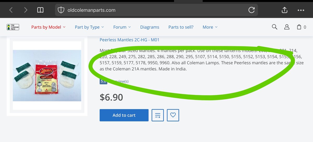

    Peerless 2C-HG is the same size as the Coleman 21, see attached screenshot taken from Old Coleman Parts.
    Regards, Jeremy
