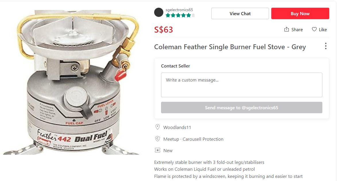

    @MYN The irony recently is I found local sellers here offering Coleman DualFuel stoves and the other coleman stoves. They do state clearly in their listings that the stoves would run on gasoline and coleman fuel. Naturally I asked about where then should I get the fuel if I were to get the stoves (no plans to get any stoves).
    They couldn't answer my query, instead, link me up to some google search page selling the fuel can filling adapter. Another tells me will take 3 to 4 weeks shipment from abroad. I refuse to buy in into this rubbish. How can someone sell stuff without the essentials, fuel, for the use? Seems to me like an online white van scam.
