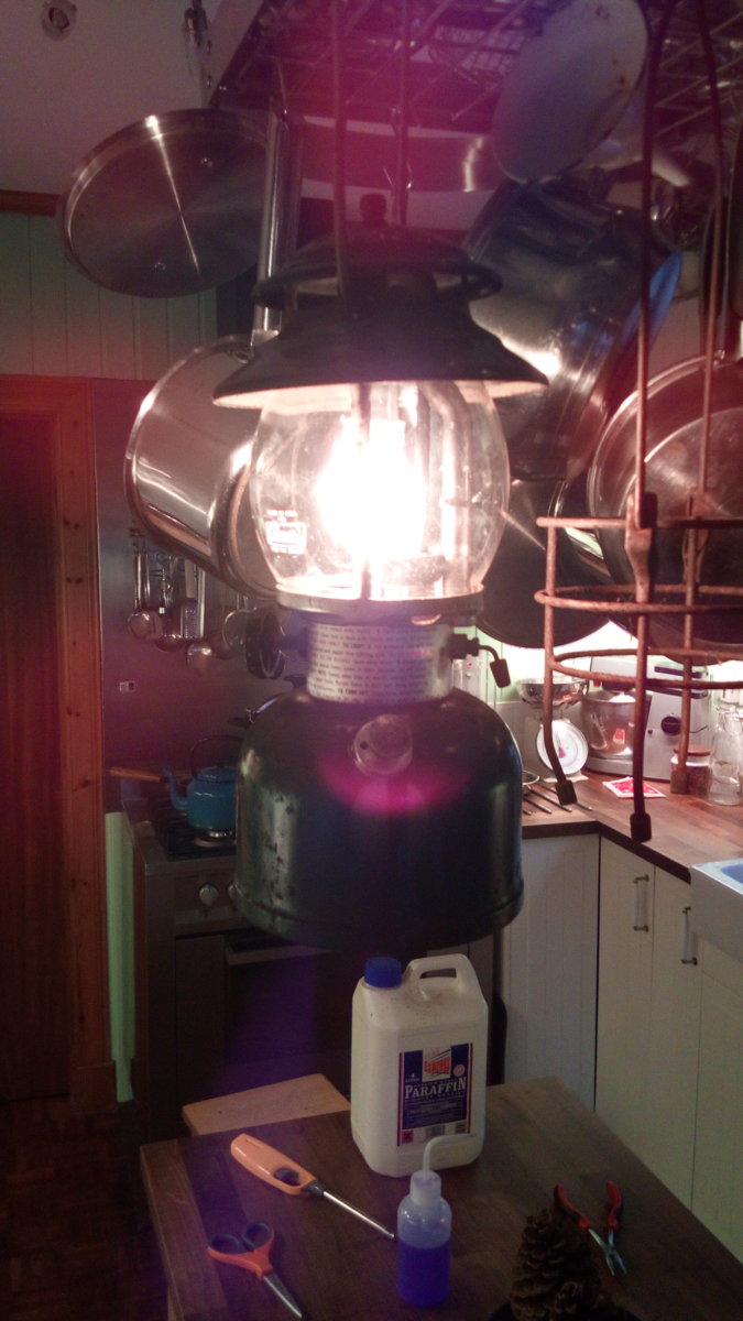

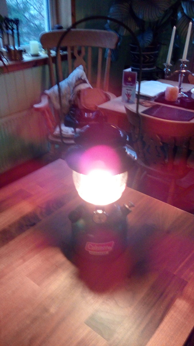

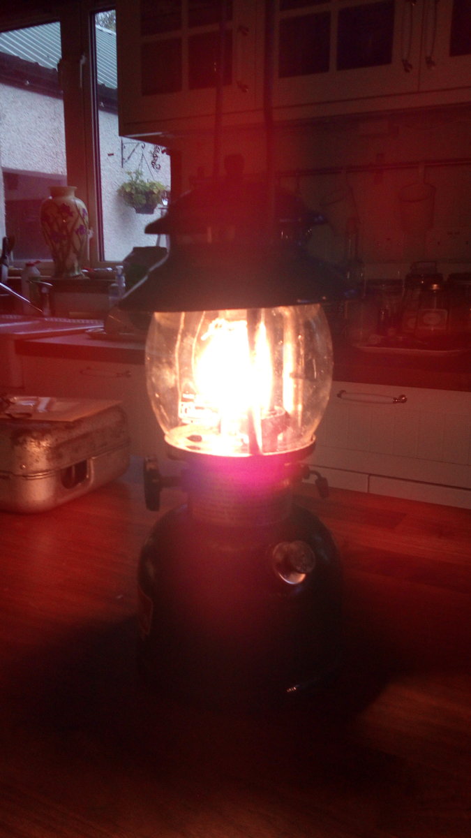

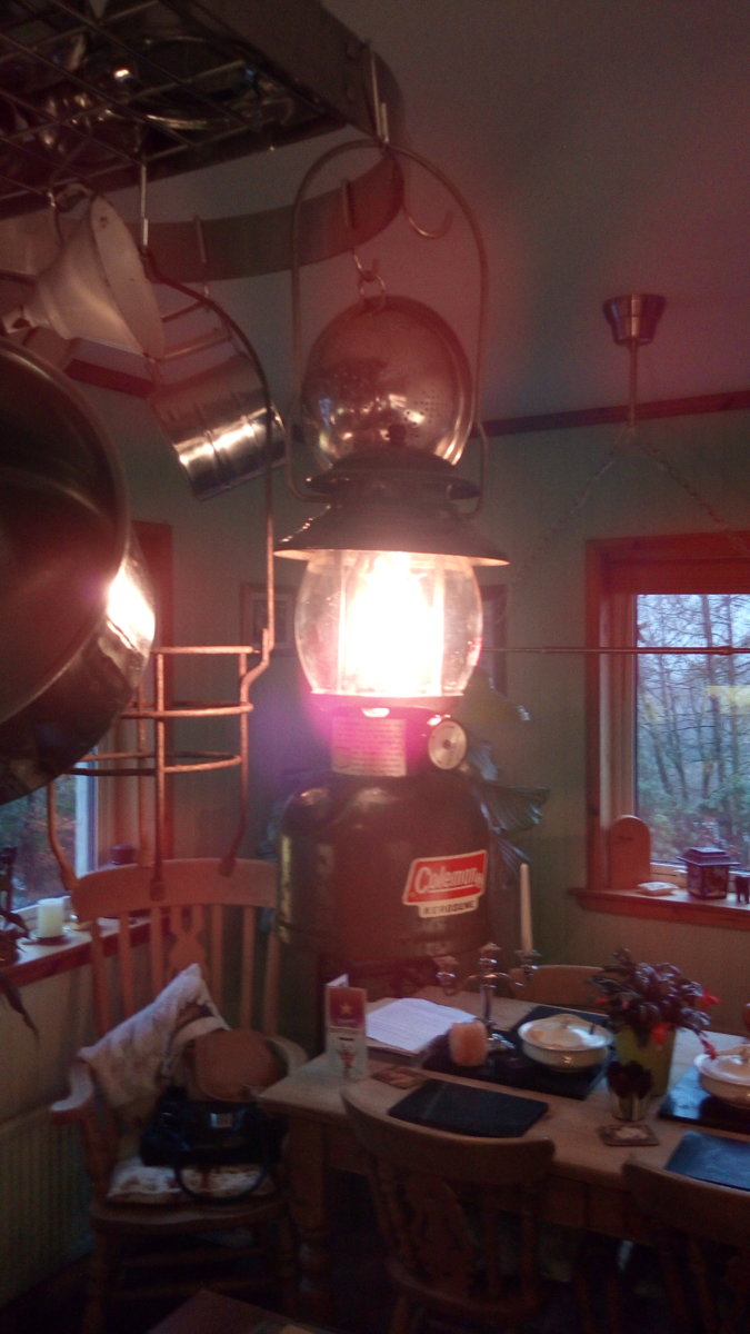

    I received the lantern a while back but didn't have time to do much with it. The pump washer has spent the last couple of nights in oil to get it functioning, but now that's fixed, I fitted a butterfly No41 mantle, primed it, pumped it and after a minute or so I lit it. Holy cow is it bright! It has to be the brightest lantern I've got (OK, I haven't got many so I have no baseline to judge) and you can't look at the lit mantle without getting spots in your eyes!
    I'm not sure the pricker mechanism is working properly as it goes round and round, but as it stands I'm more than happy! Here's a few photos...
    So happy with this lamp!
  22. phaedrus42
    phaedrus42 Subscriber
    2,056
    The pricker or cleaning lever does rotate all the way round on Colemans. After the kerosene 201, 339 and 639 models of the 1970s I think Coleman's materials and build quality deteriorated markedly with the next model, the 214. You have one of the last of the good ones!
  23. David Shouksmith
    If it goes round and round without any noticeable effect, it's not working. Otherwise, as Phil says, that's how it's meant to operate - the bend, or sometimes, crank in the handle is the clue. Logically, it's easier and quicker to just keep turning the knob rather than turning it one way and then having to quickly flick it back in the reverse direction - there's less chance of extinguishing the lantern with continuous rotation.
    As an aside, Bialaddin/Vapalux use both types of pricker control so don't be surprised if some of them rotate continuously too...
  24. ColinG United Kingdom
    4,816
    Thanks Phil. I left it on for a bit of a test while I got some food, made tea etc and it started to get a bit dull so I messed with the pricker lever and hey presto it's now even brighter than it was before! How bright can this bloody thing go? Anyway, it's obviously working fine,and the Butterfly mantles are the dog's dangly bits. Which reminds me, did you get the needles yet?
    And thanks David, that answers another question as the Vapalux goes round and round just the same. I haven't lit that yet but I was told it worked so I'll have to give that a go as well now.
    All I want now is some decent snow and a power-cut or two and I'll be happy as Larry reading my new mushroom book :-)
