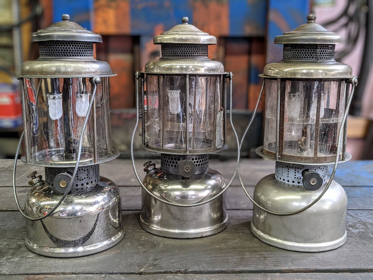

    @Tyler Lezotte I usually clock them 90 degrees (left or right of the filler) or 180 degrees from the filler. 180 degrees seems to be the most popular in the mid 20s from my many examples :thumbup: also keep your valve centered in the collar.
    A couple I did this past week
    16,661
