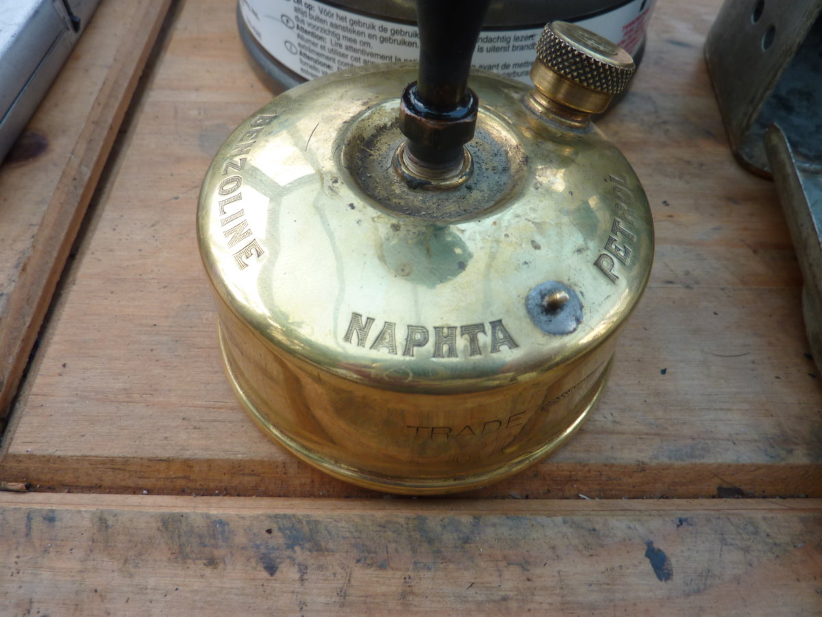

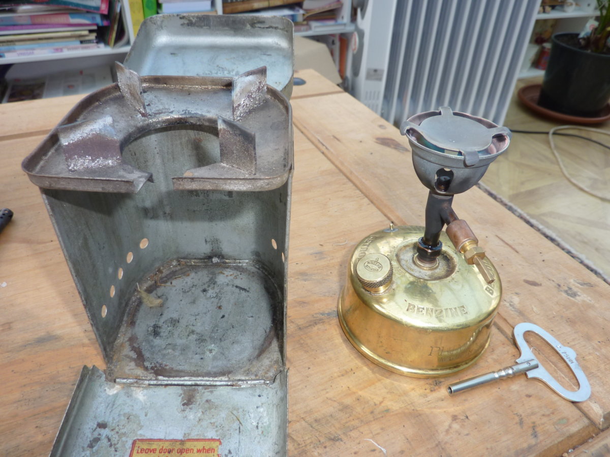

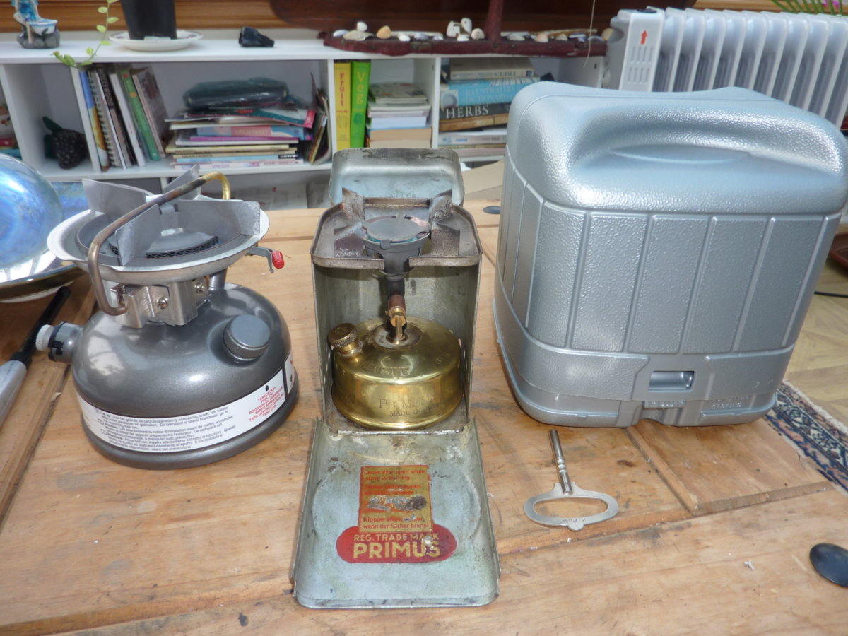

    My apologies for showing a stove on the lamp forum but somebody did ask to see it.
    A primus 71 stove made from 1930 until the 1970s so must be plenty around, this is a very early one with the flat filler cap, the fuel types engraved on the tank and no safety valve.
    Middle photo shows the primus with its modern equivalent the coleman, a good stove but look at the difference in size
    Last photo--- just how do you spell naphta?
