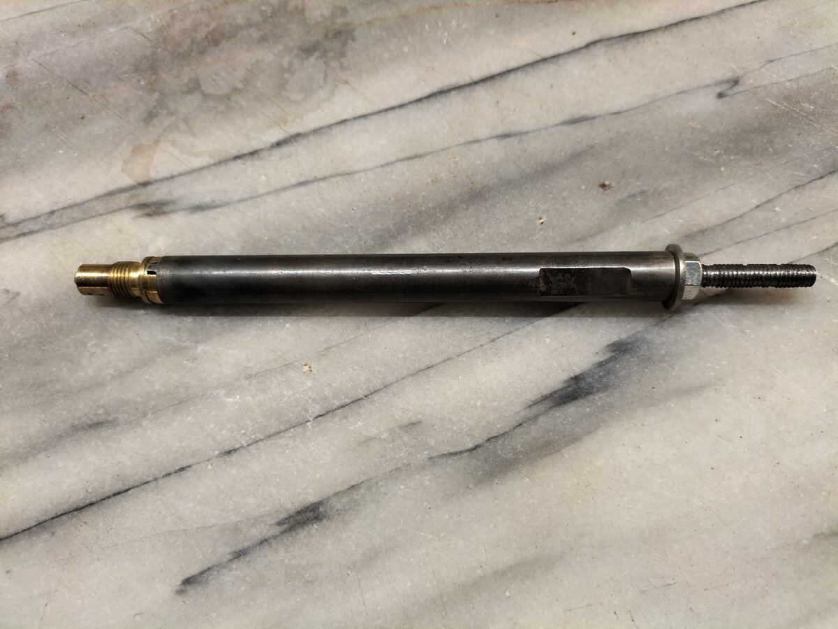

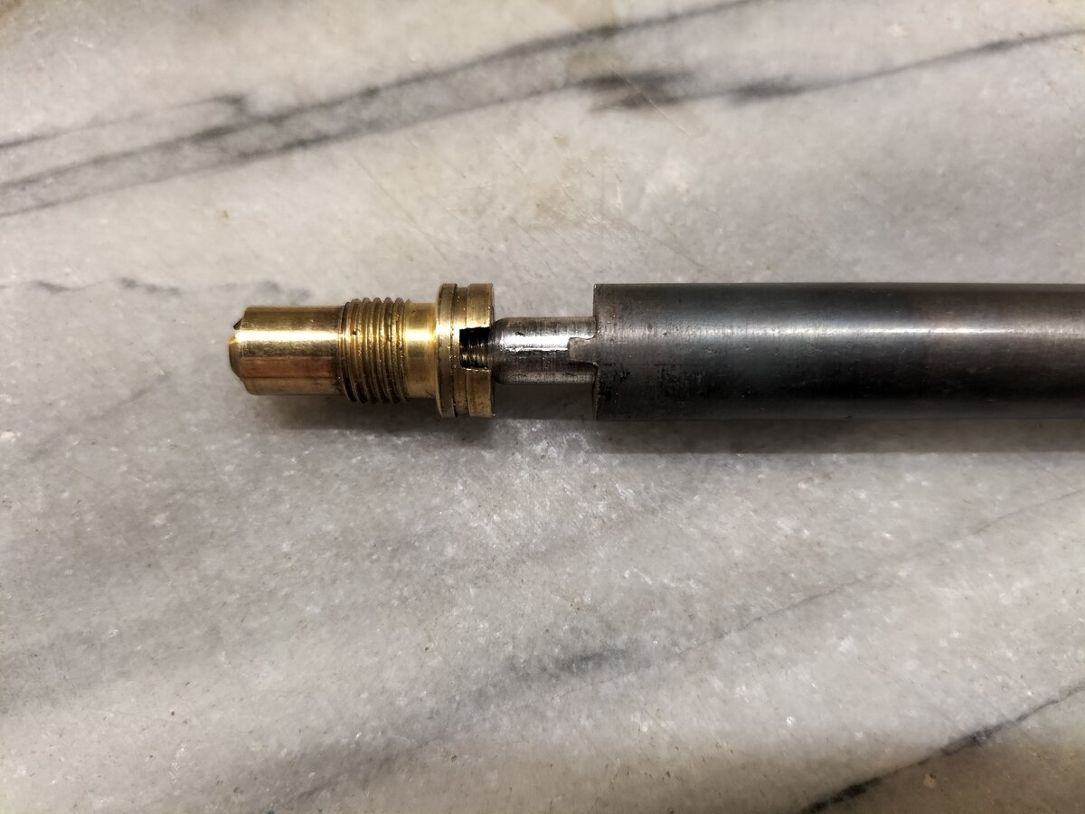

    This is my case hardening compound I created from a recipe I found online. It's basically charcoal - 90% and sodium bicarbonate - 10% crushed and mixed to a granular texture.
    Inside the tube is the main steel component with the compound packed in around it.
    I now need to either have a bonfire in the garden or light our wood burning stove to cook it for an hour or two but it's so bloody hot and humid here in Scotland I don't really want to! I'm not sure I can reach the temperatures required but I'll have a go.

    You should end up with a nice colour case hardened finish with that method. You could just heat up the tip with a blowtorch and dip the cherry red metal into the compound for or five times and then quench it at the end.
  4. ColinG United Kingdom
    4,816
    Exactly what I did and here's the result...
    I'm waiting for a new check valve to arrive before I reassemble the 220 and get it working again.

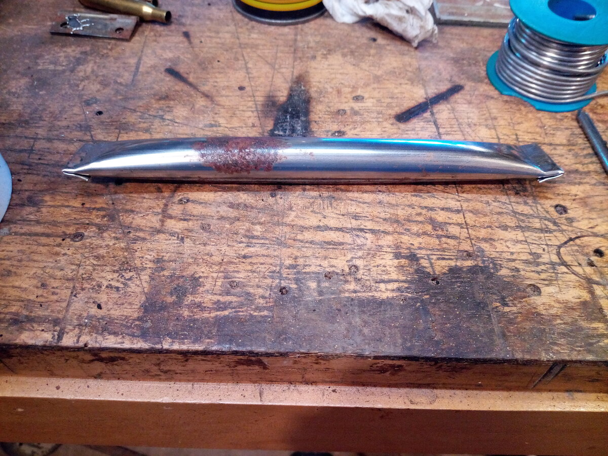

    Here's what's left of the tube..

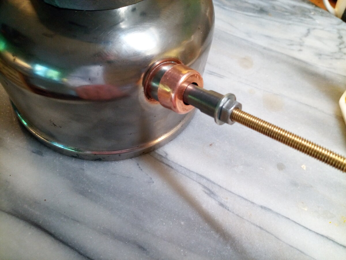

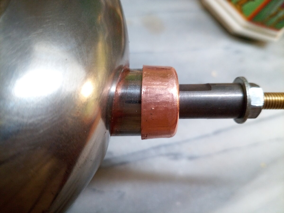

    As @ROBBO55 commented, there needs to be a method of holding the tool in line with the pump tube. He mentioned a plastic sleeve but I couldn't find what I was looking for so I improvised with a copper end cap - again! These things are blooming useful I have to say! It was a little too small so I relieved it with a metal bar and a hammer and then cut it down a little. With a 12mm hole it now fits on the pump tube snugly and supports the CV tool as it does it's job!
    I think that's it now, I just have to be patient and wait for the check valve to come so I can try it out.
    I suppose I could have bought a tool and saved myself the effort but where's the fun in that!
    P.S. The tool shaft spent roughly 3 hours in the fire work-hardening at roughly 1100°C or at least, thats what wood fires reach when burning hardwood.

    @ColinG you shouldn't have a problem removing CV's from now on. Nice work :clap::clap::clap:

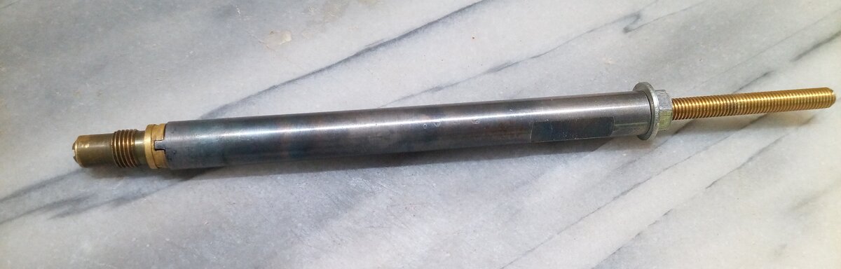

    ** Update **
    My original check valve removal tool was made for the old style version so I needed make a new central rod for the new, smaller style CV with a 3/16 32tpi thread.
    The first problem was... finding the right type of 3/16 32tpi thread as there are 3 at least: NF #10 32, 3/16 32 ME and BSF 3/16. What I ended up with (purely through random luck) was a BSF 3/16 die... but thank goodness, it fitted!
    I used it the moment I'd finished and it performed perfectly.

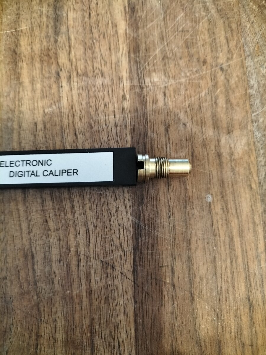

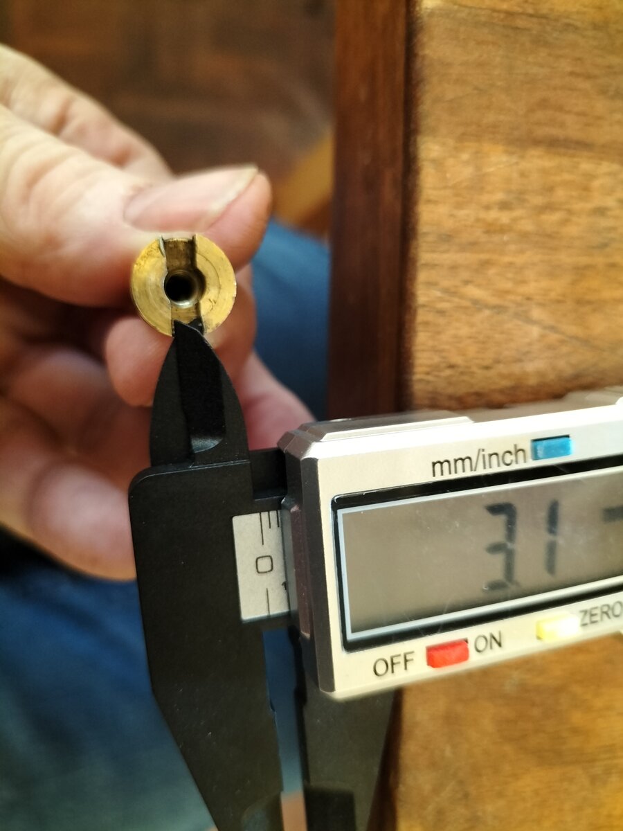

    This is an old discussion, but I hope someone from experienced people will read my questions. :content: As I understand the internal thread of the valve: BSF 3/16-32 (Coleman 226A700E) Correct? The diameter of the valve head is about 12mm, what is the width and depth of the groove on the valve?
  12. ColinG United Kingdom
    4,816
    The BSF 3/16 x 32 thread is very close but maybe not perfect. The BSF has a Witworth tooth profile of 55° but the National Fine 3/16“ has a 60° profile which i believe will fit better. I had to use the grub screws on the die stock to tighten down the thread i was cutting. This cut a slightly smaller overall diamater thread which probably confirms my suspicions. If you have a choice, I would suggest you use use the NF 3/16" 32.
    The width/depth of the groove is 3.1mm wide x 2.6mm deep as far as I can judge.
