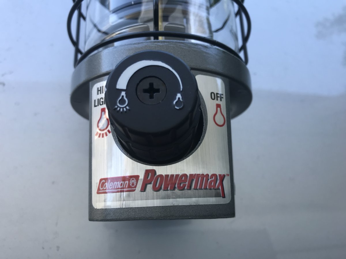

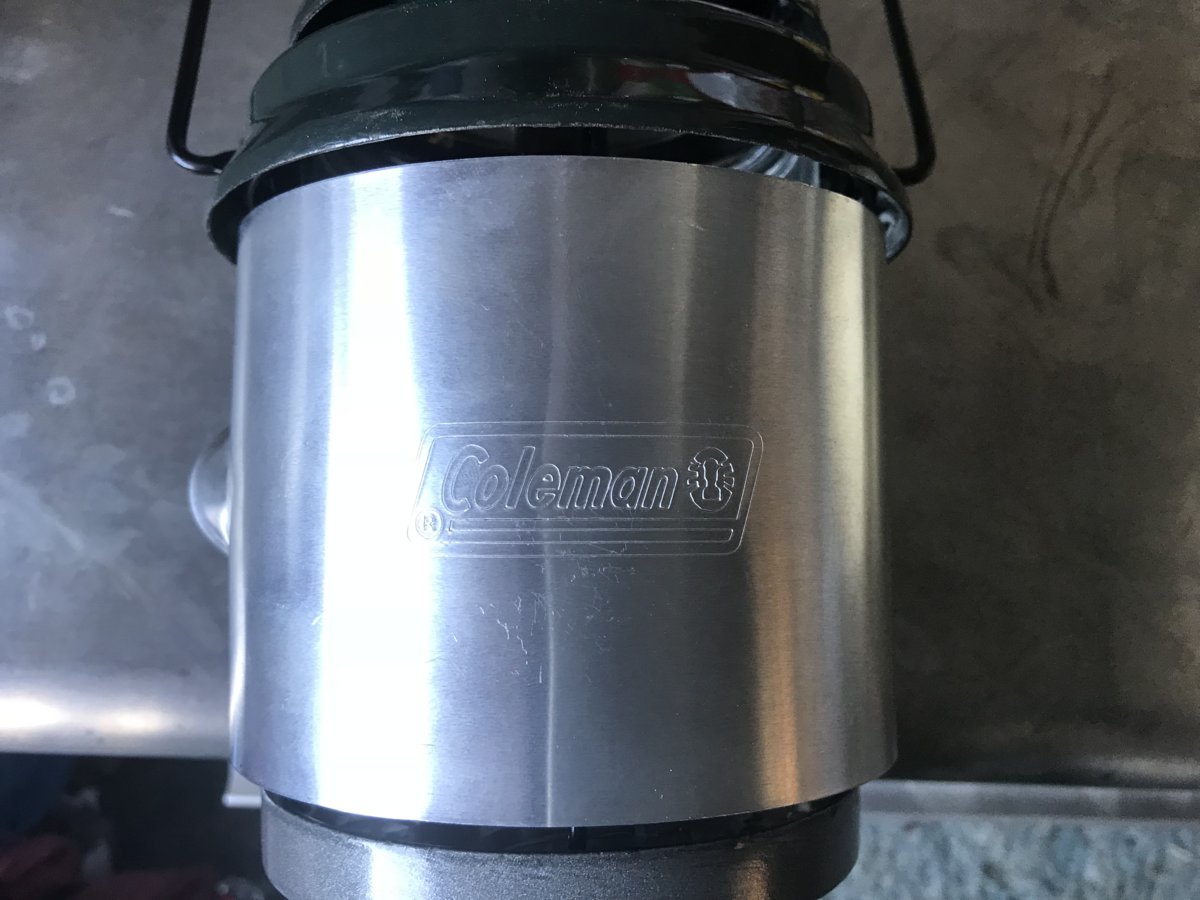

    Hi there,

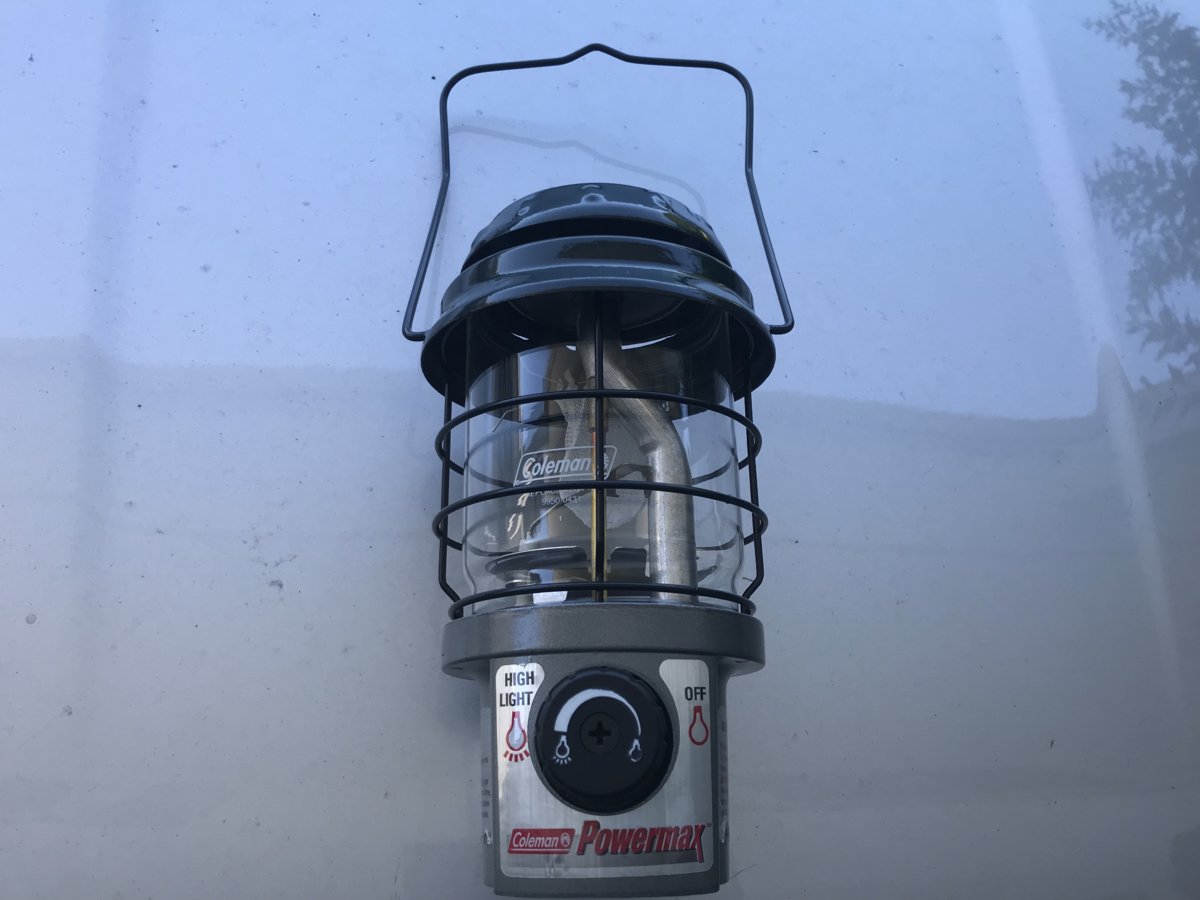

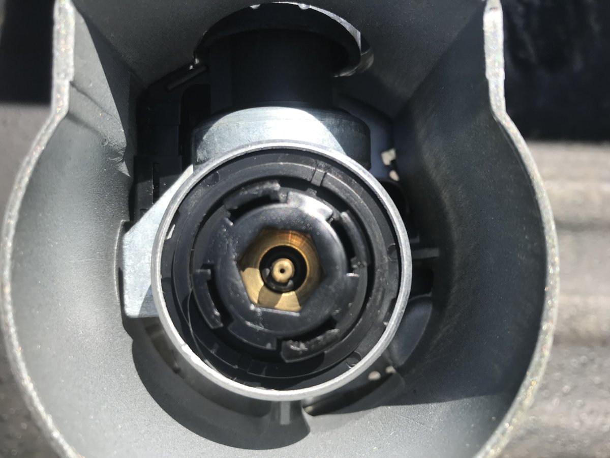

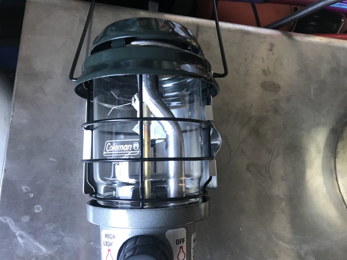

    I have acquired a Coleman PowerMax lantern in very good shape. As you can already guess by the description this lantern is designed to use the PowerMax fuel canister. This lantern also have a very nice reflector which works quite well indeed.
    4911C5ED-1773-4F92-BAD9-D3E4977A1FDA.jpeg E577C629-9D80-4EAB-8144-520EFCC0EF50.jpeg EA755BB9-AD9D-4A40-938B-4F5760BACEC0.jpeg 249D9ED4-C933-4BF7-BA85-05DC5A42FBED.jpeg

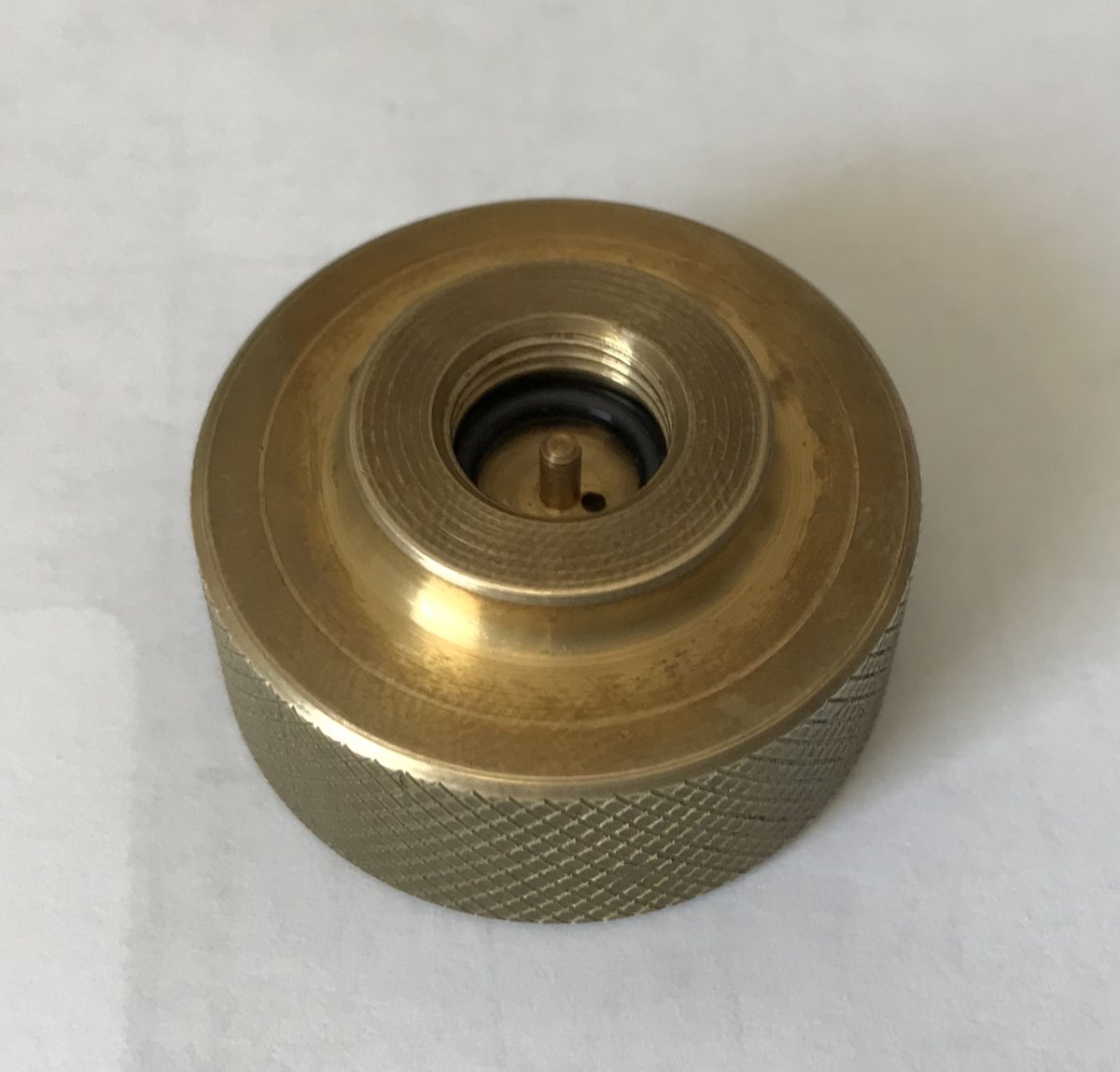

    I found a very nice PowerMax adapter on the bay.
    E916FE95-ADAB-41F8-880D-4332CE639706.jpeg 32EE9905-6E60-4CC1-9CB6-706B92E46131.jpeg

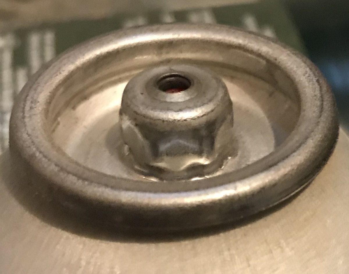

    I have a few PowerMax fuel canisters which seam to be in good shape for now. As can be seen the top of the PowerMax fuel canister is the same as the top of the adapter.

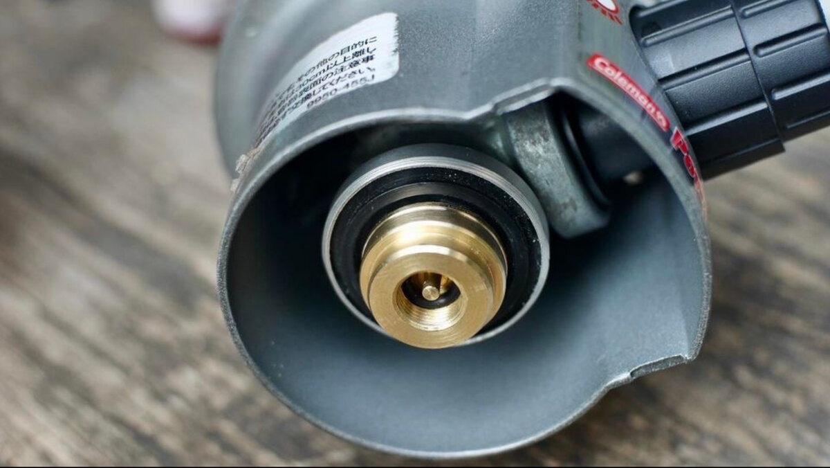

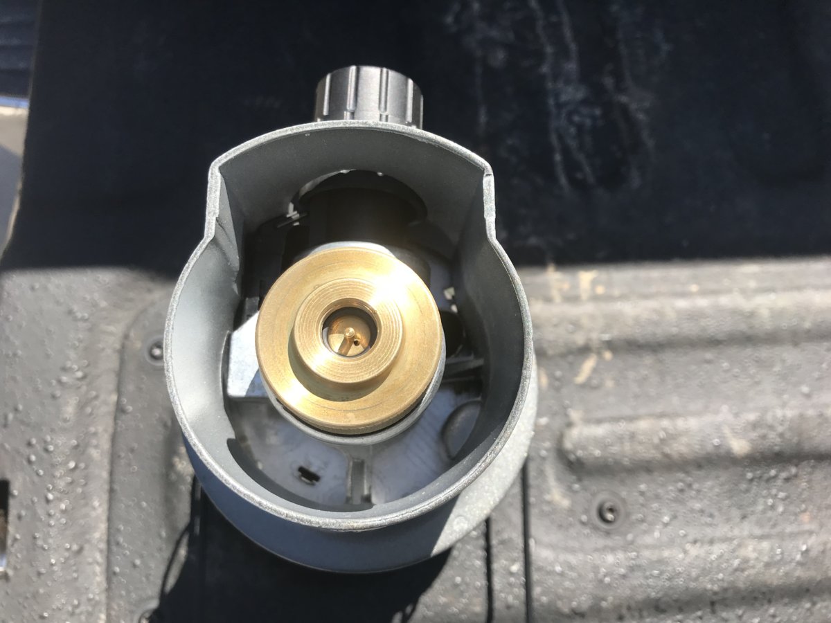

    Here is a picture of where the PowerMax fuel canister attaches to the lantern. Once the canister is attached just turn it 1/4 turn clockwise the fuel canister is secured.

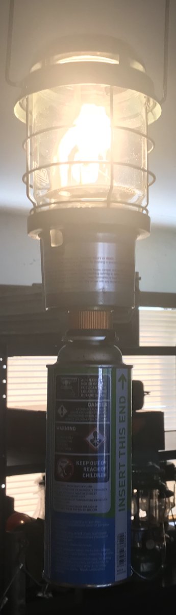

    Here you can see the adapter in place and secured. With this adapter one can now run this lantern on modern fuel canisters. With an adapter this lantern will also run on butane and propane/LPG.
    For safety sake I replaced the Lantern O-Ring to keep the fuel canisters from leaking.

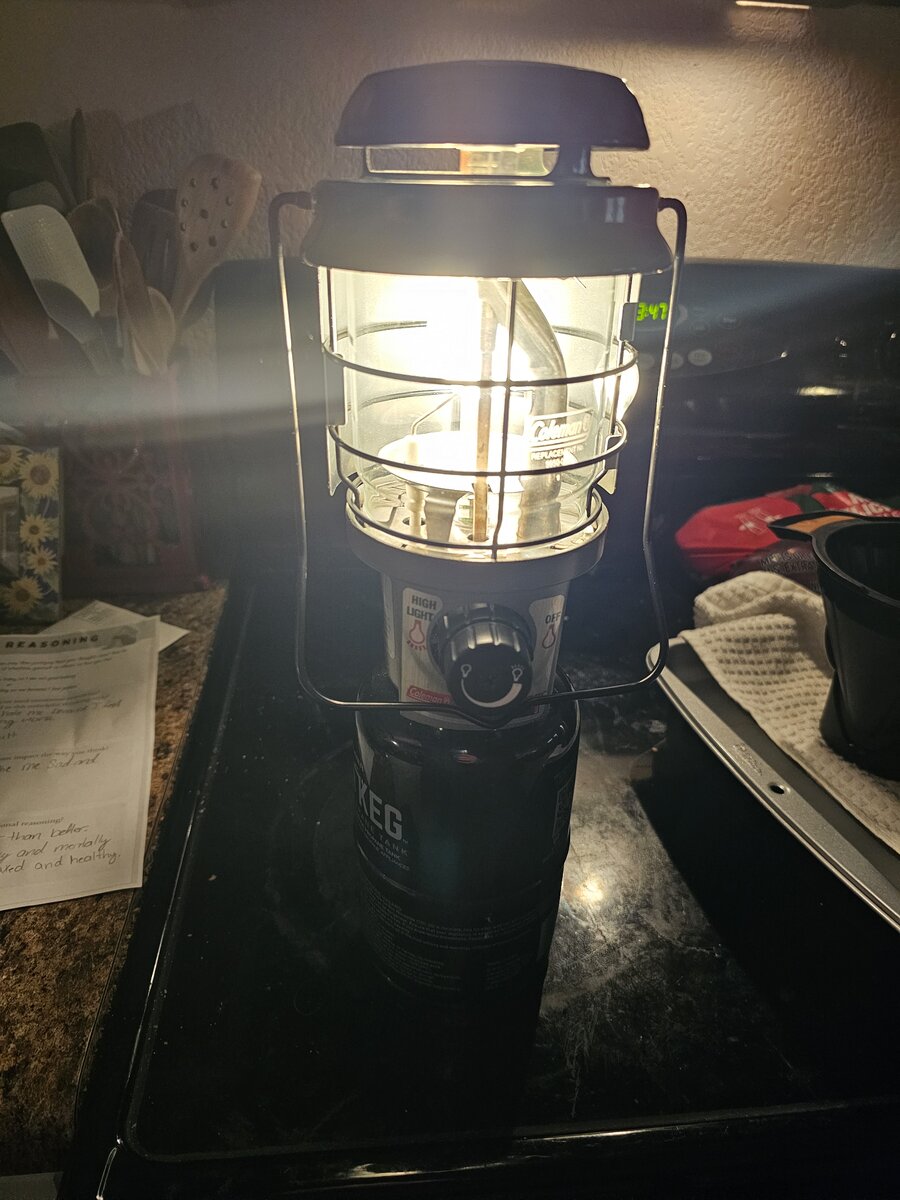

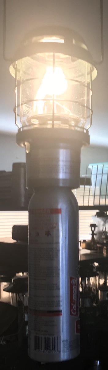

    Here is the lantern up and running on several different fuel canisters including the PowerMax lantern.
    E2D565EC-FA1B-4ECA-975C-06843C296515.jpeg AB3BA035-E9E7-4834-80AD-9B0BE69C12EC.jpeg 9C767FD9-9EB1-4277-B6DE-5D969F0F7A75.jpeg F39849EE-8E28-42E7-B760-E1CE773BC062.jpeg
    This lantern runs great on all of the above fuel canisters.

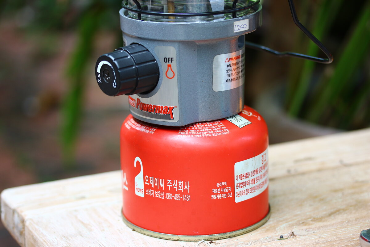

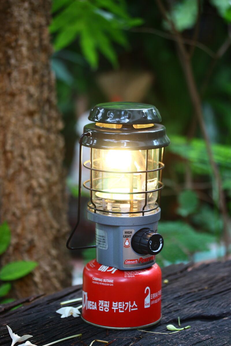

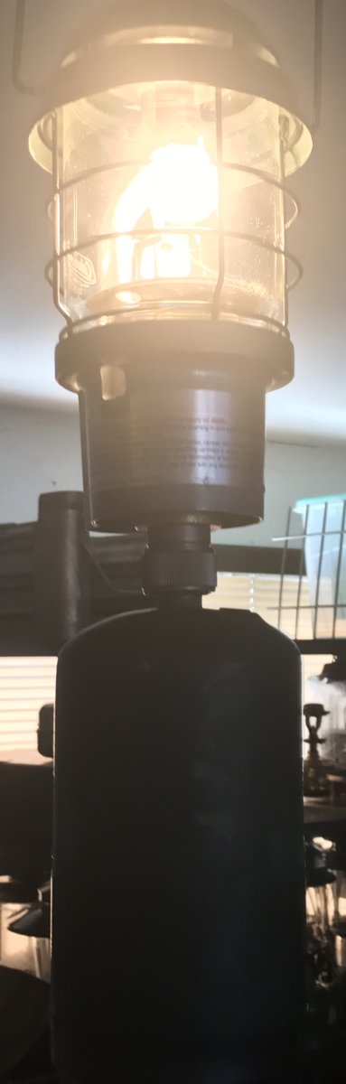

    8D0671CF-EB34-4E63-A9F8-86EFDEECD67E.jpeg 0B4434E8-04D5-4B8A-AFC1-492B7A68D256.jpeg Finally, I made it to work with lindal gas canister
  13. ColinG United Kingdom
    4,816
    That is very neat indeed. Well-done.

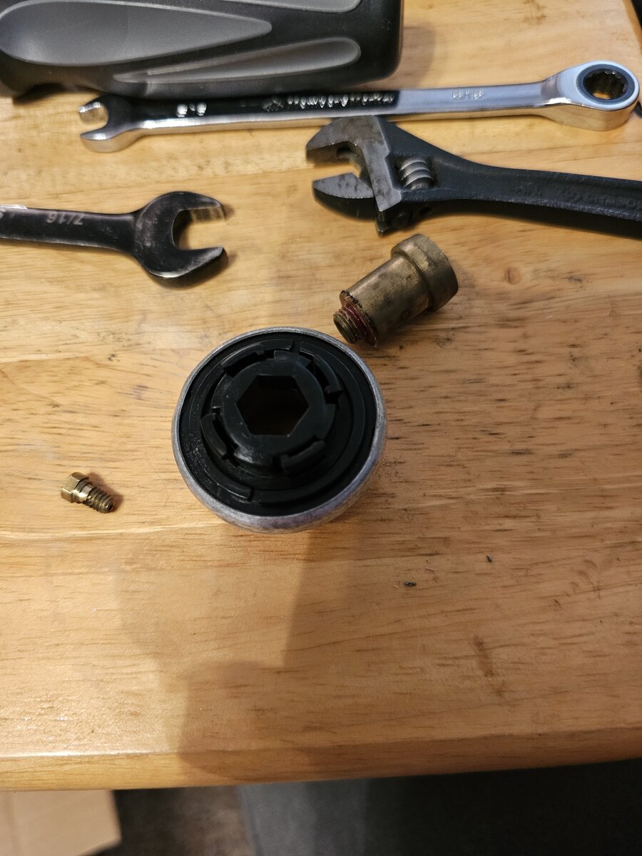

    @tik362 Do you make this adapter? How can I get one here in the States?

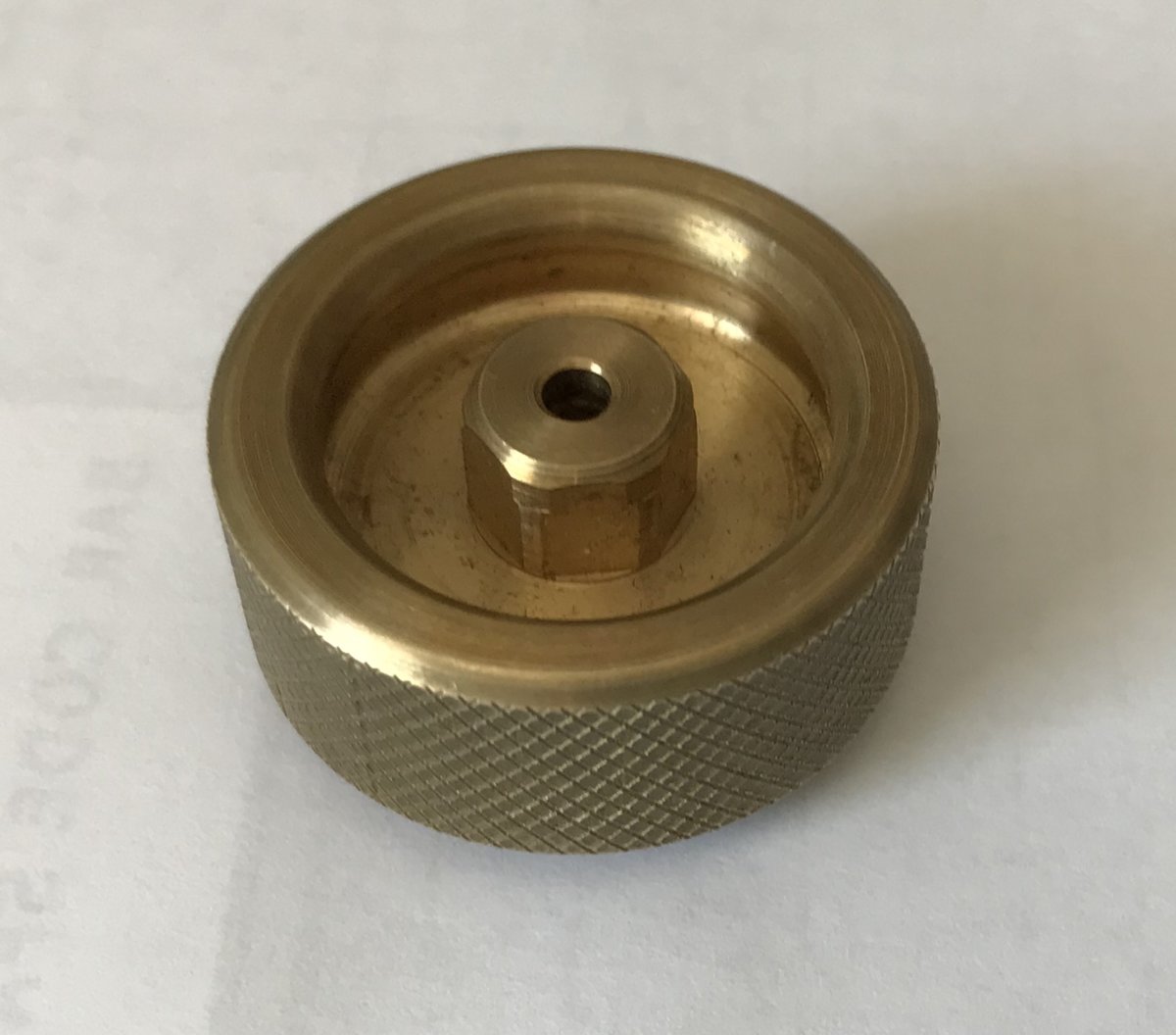

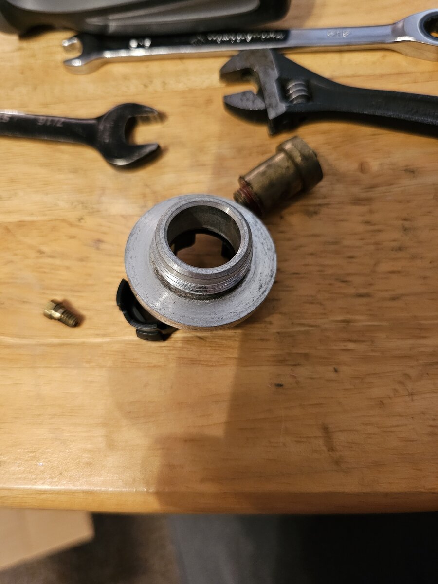

  19. tik362 Thailand
    Jul 12, 2019
    9
    Thailand
    I made the adapter and service to people in local country. The lantern needs to be modified in order to install the adapter firmly.
  20. Joshua Harrington United States
    Jun 5, 2024
    5
    Decatur, TX

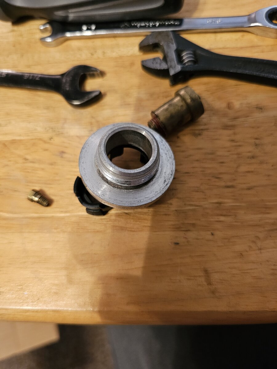

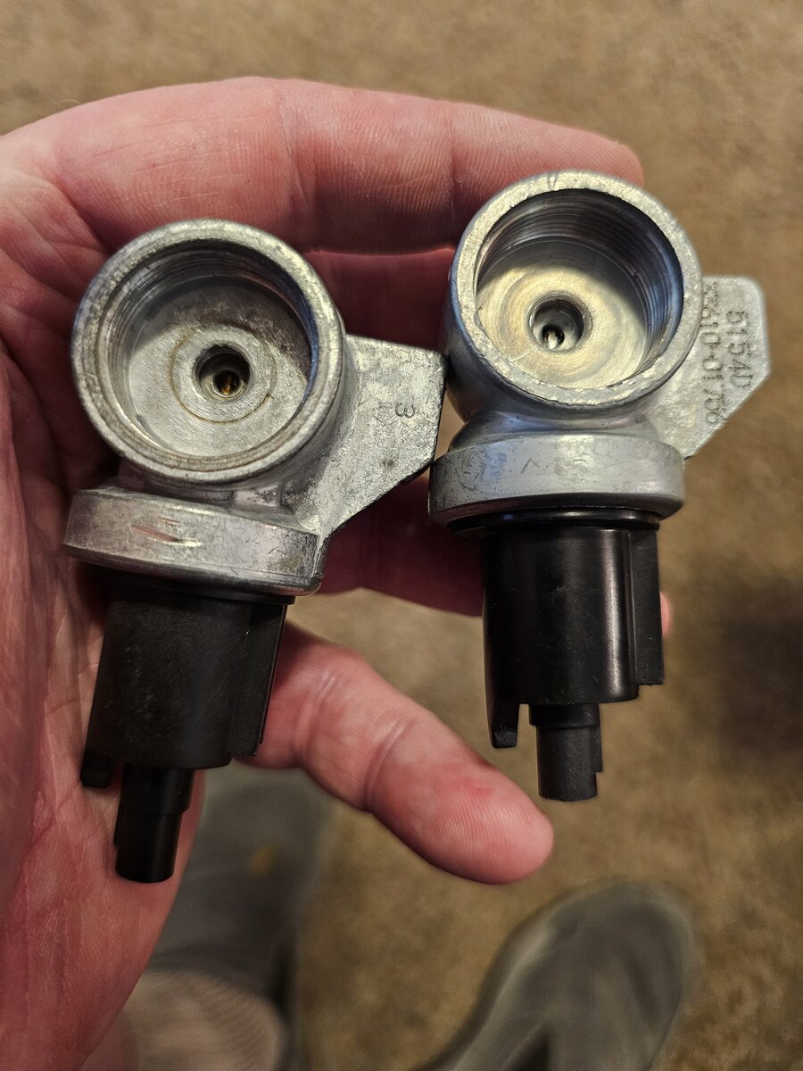

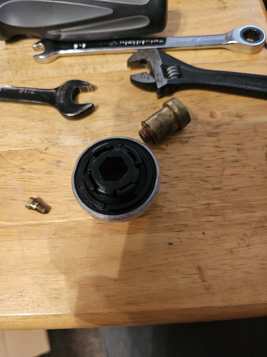

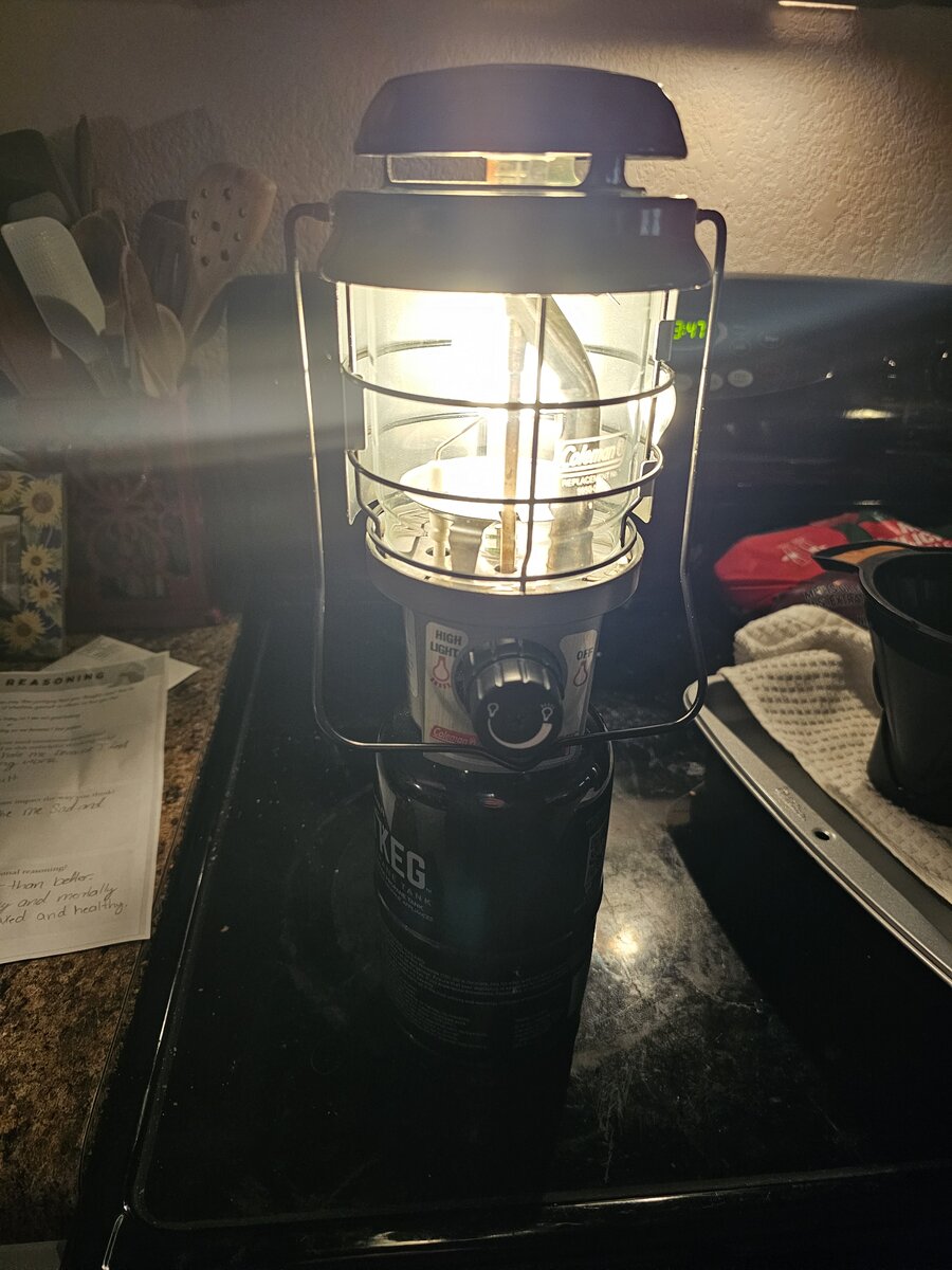

    I figured out that if you put the valve in a vice that you can just unscrew the Powermax connector from the lantern valve and now I can screw a 1 pound propane bottle into the valve like normal

    This is the adapter I made
  22. Joshua Harrington United States
    Jun 5, 2024
    5
    Decatur, TX
    That's very nice! I'd love to know how you did it so that I can convert a Powermax stove to work off those canisters on your lantern.
