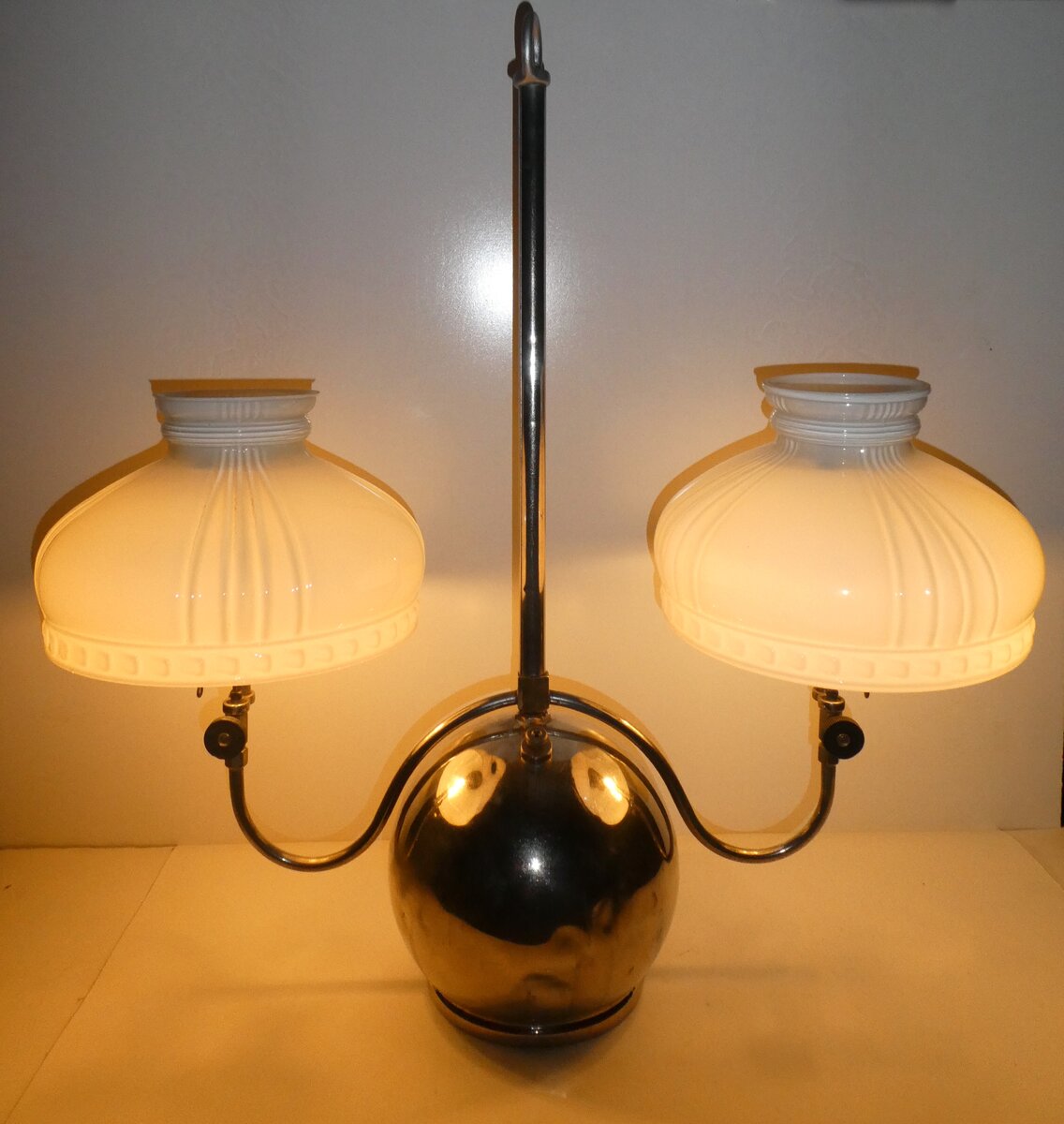

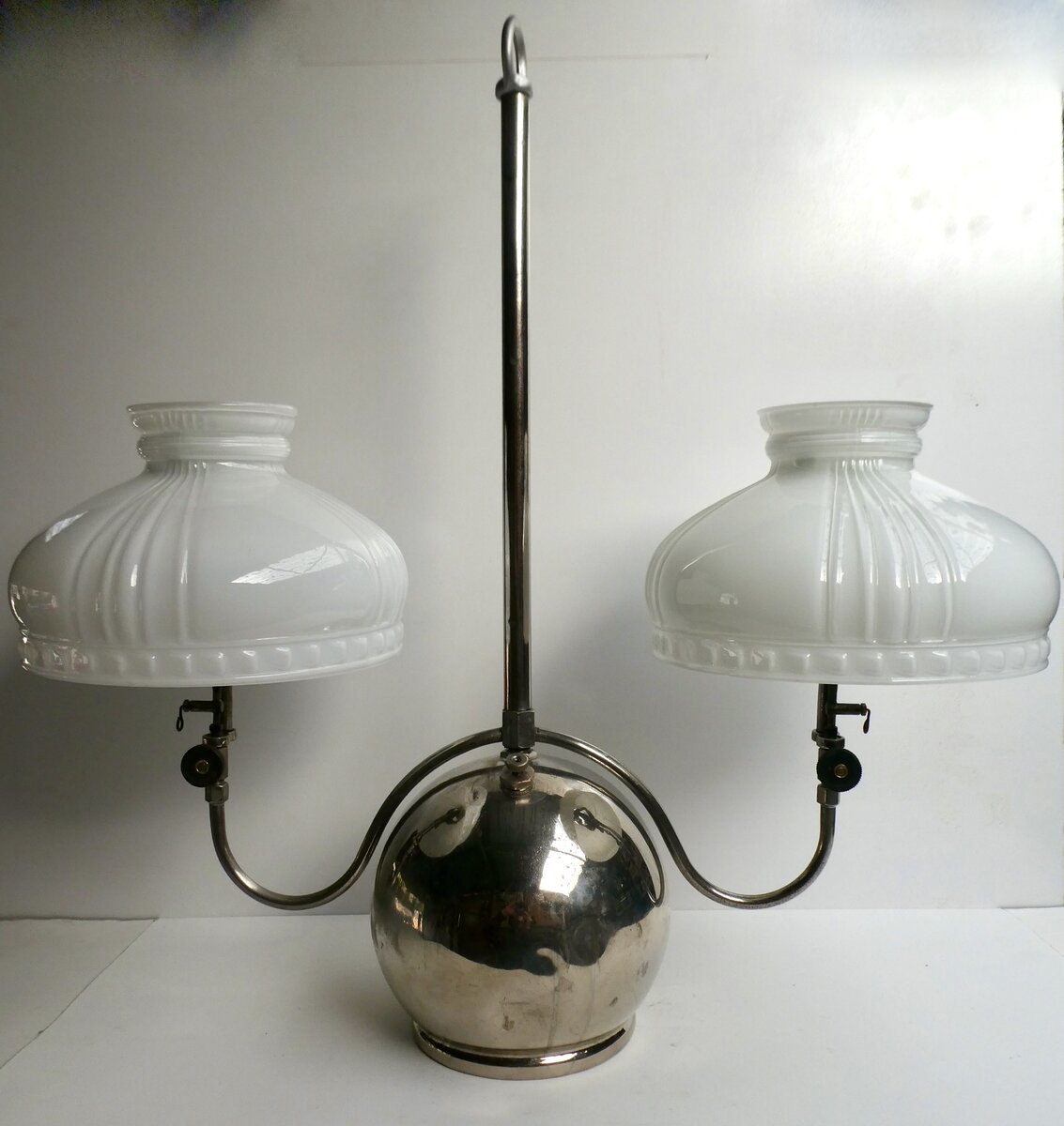

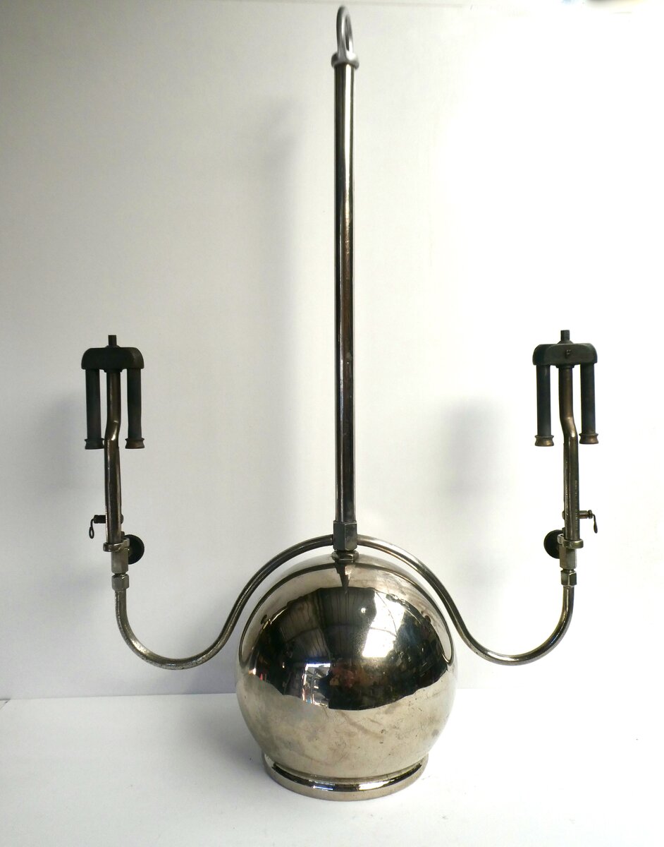

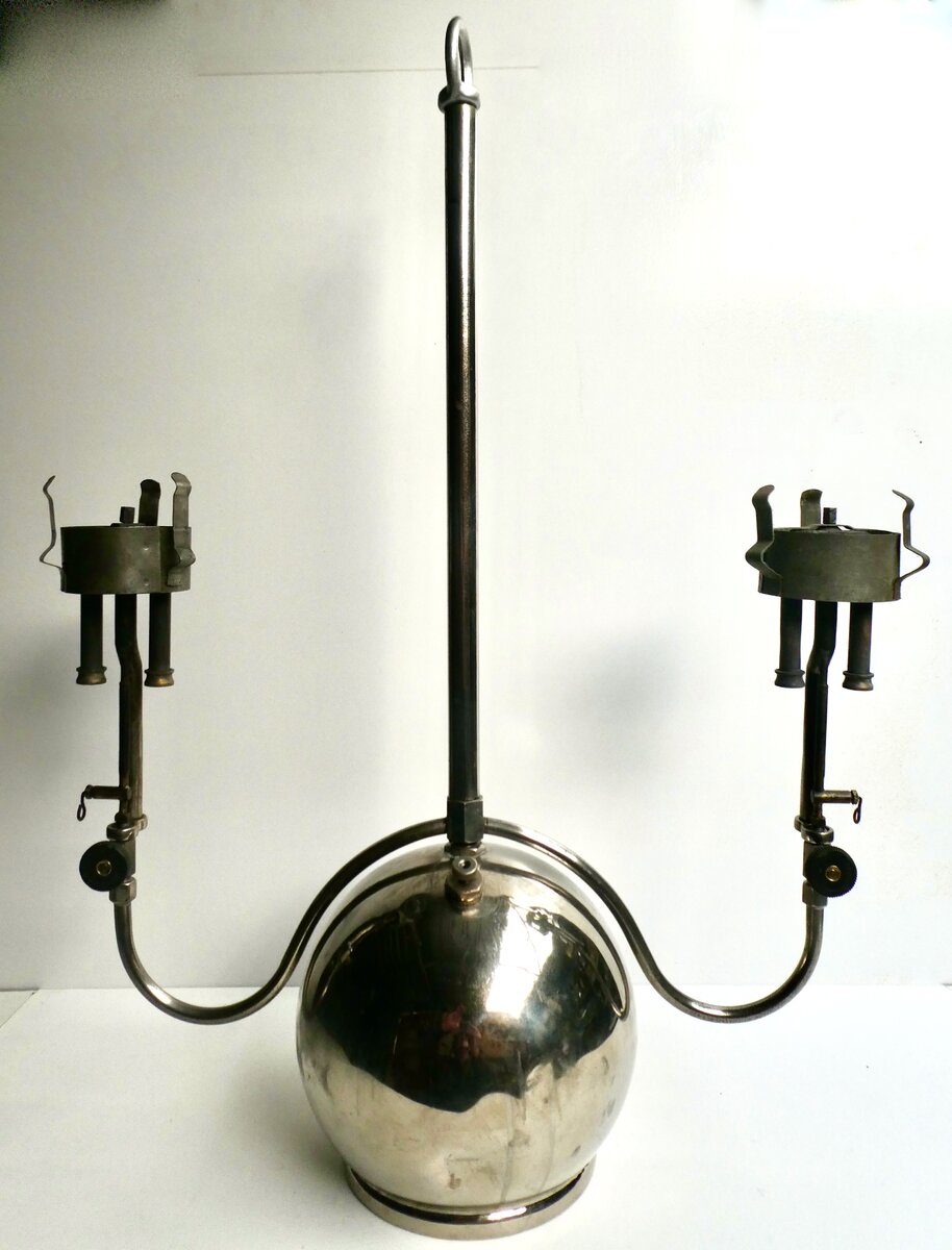

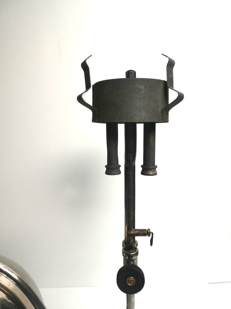

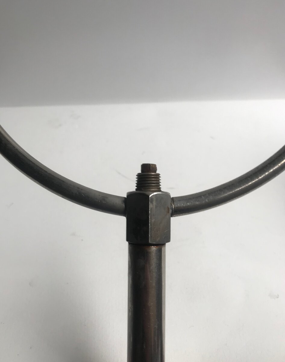

    This is my Coleman PQ, restored with all the parts it came with (excepting the filler cap seal and the Coleman shades).
    The lamp was found in Australia.

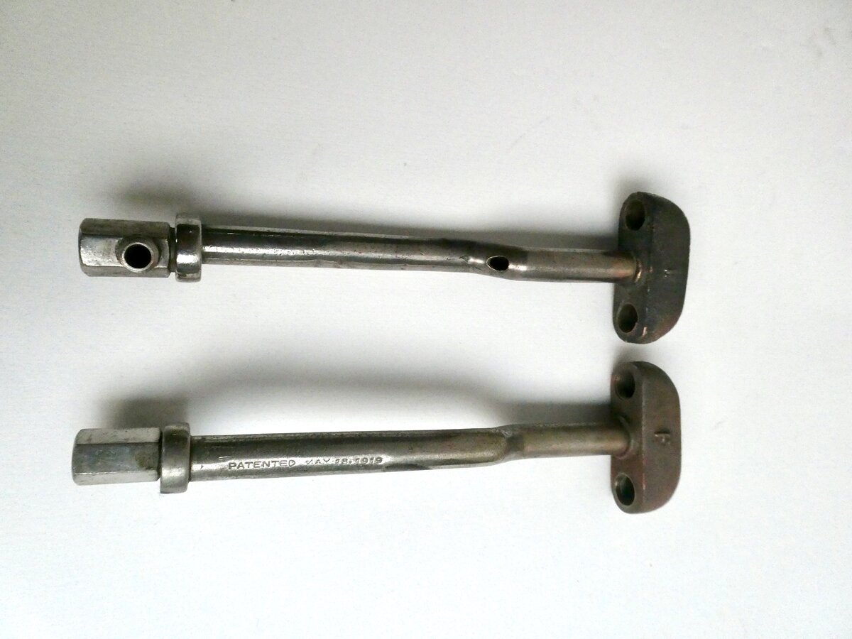

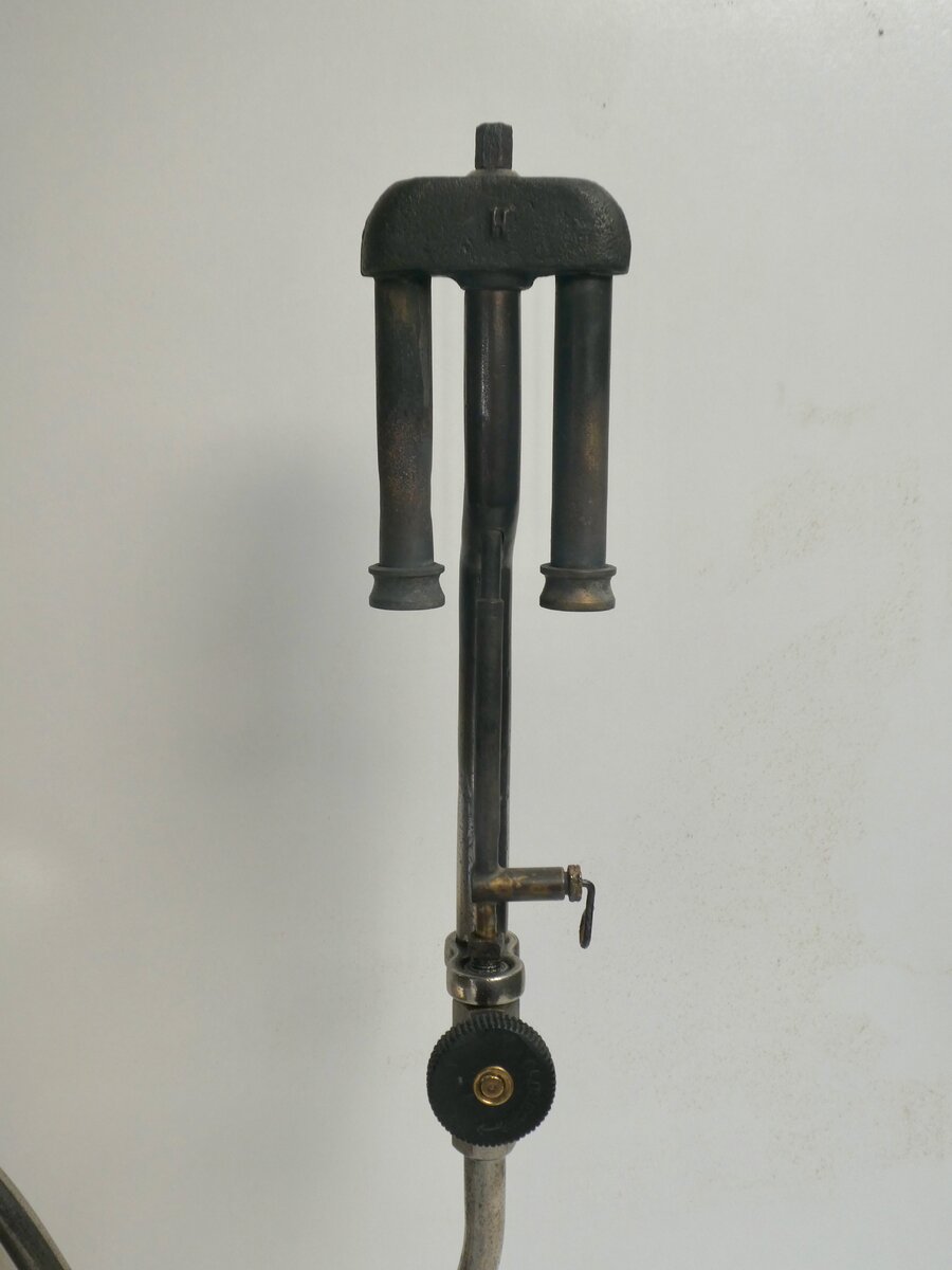

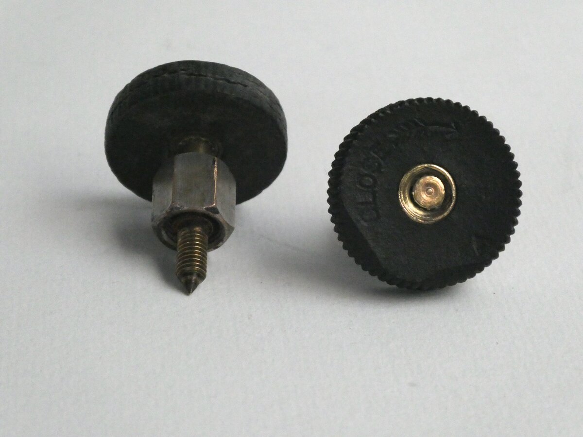

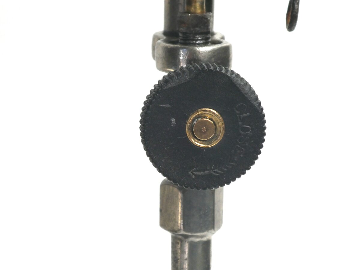

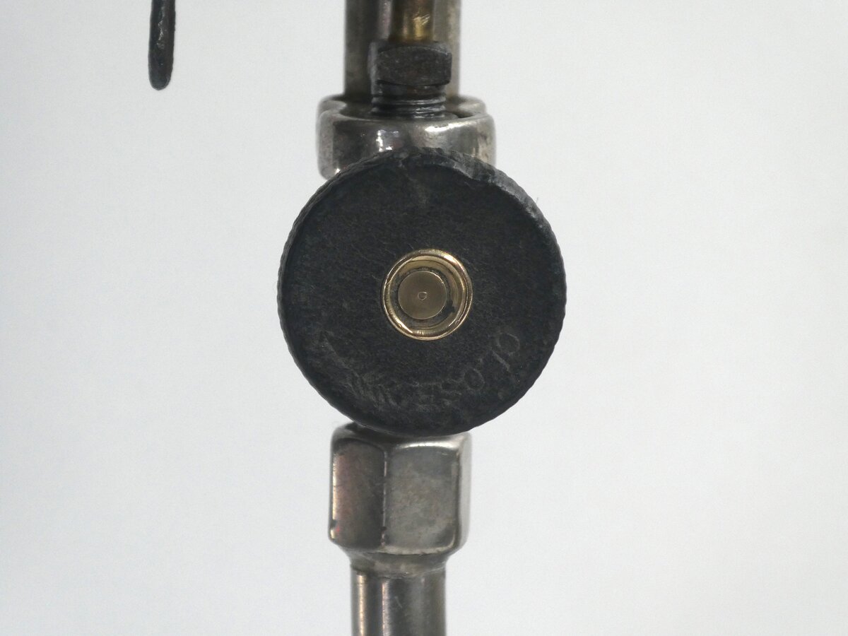

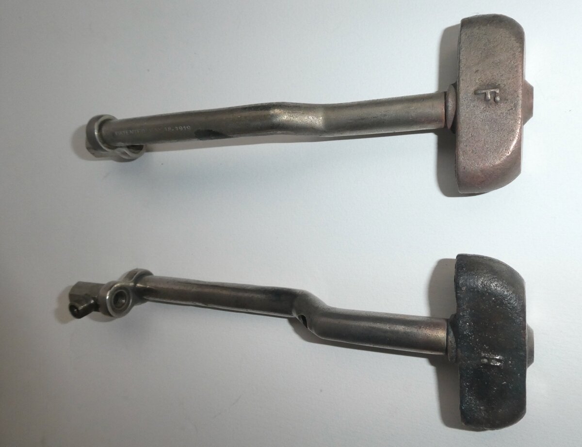

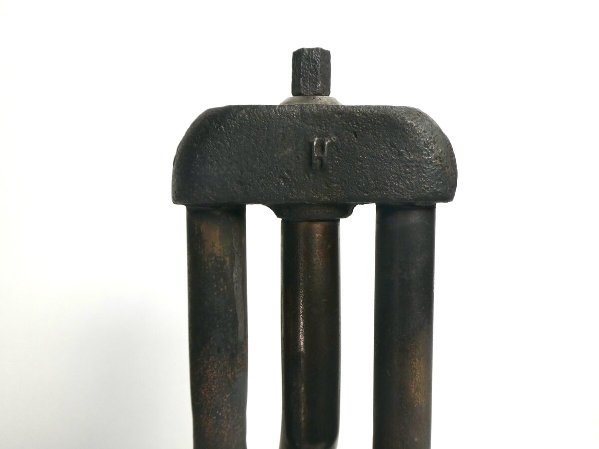

    Each control wheel is marked "Close ---> A"
    One cast burner with "F"; the other with "H".

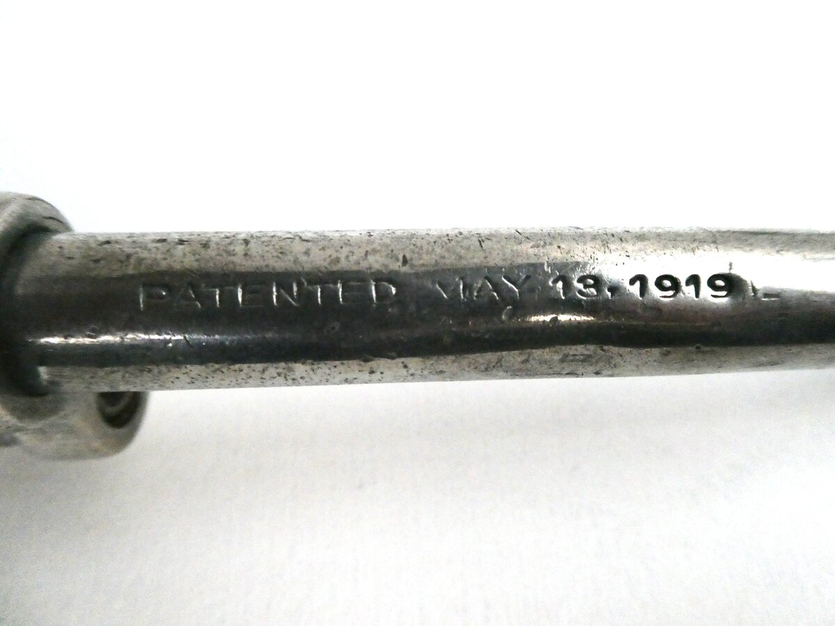

    "Patent May 13, 1919"

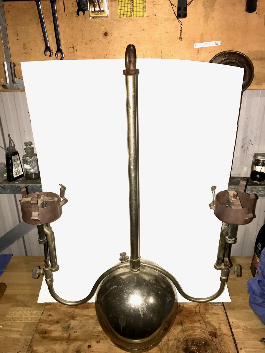

    The tank is not stamped.
    As it came.
    The Fettle:
    The inside of the tank was cleaned with citric acid solution and the steel bottom of the tank was treated with "Evaporust".

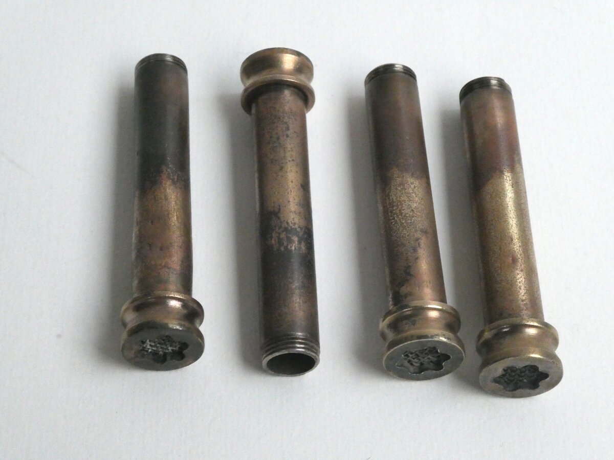

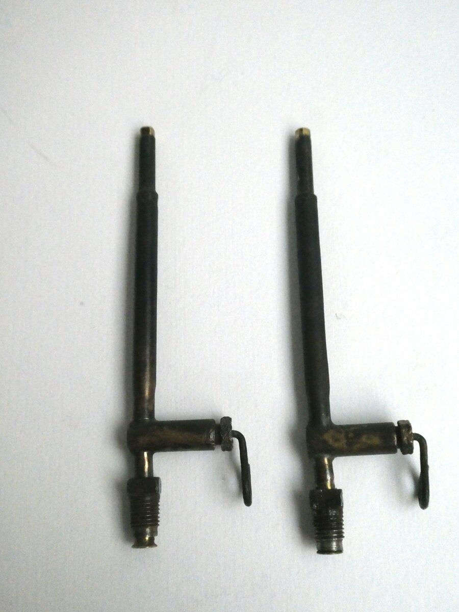

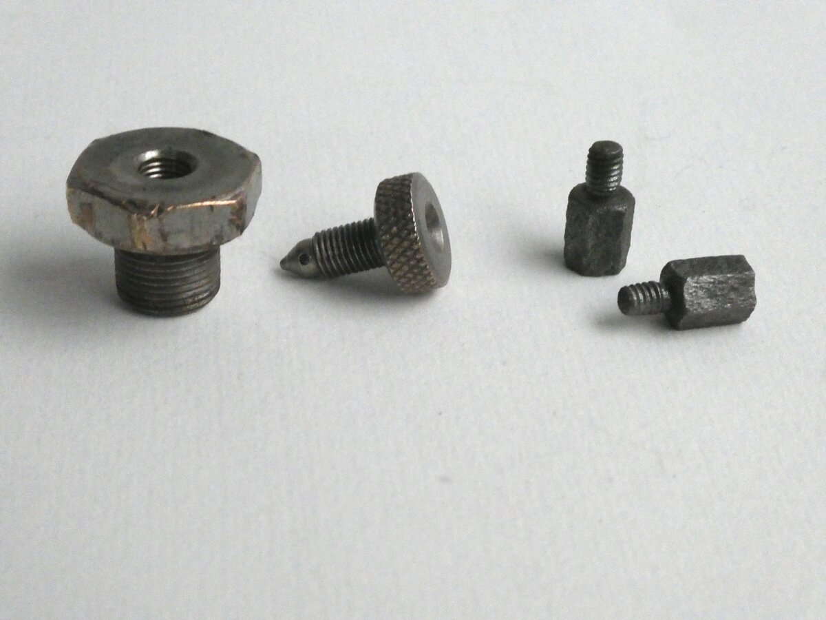

    The R55 generators were cleaned and given a soak in acetone.

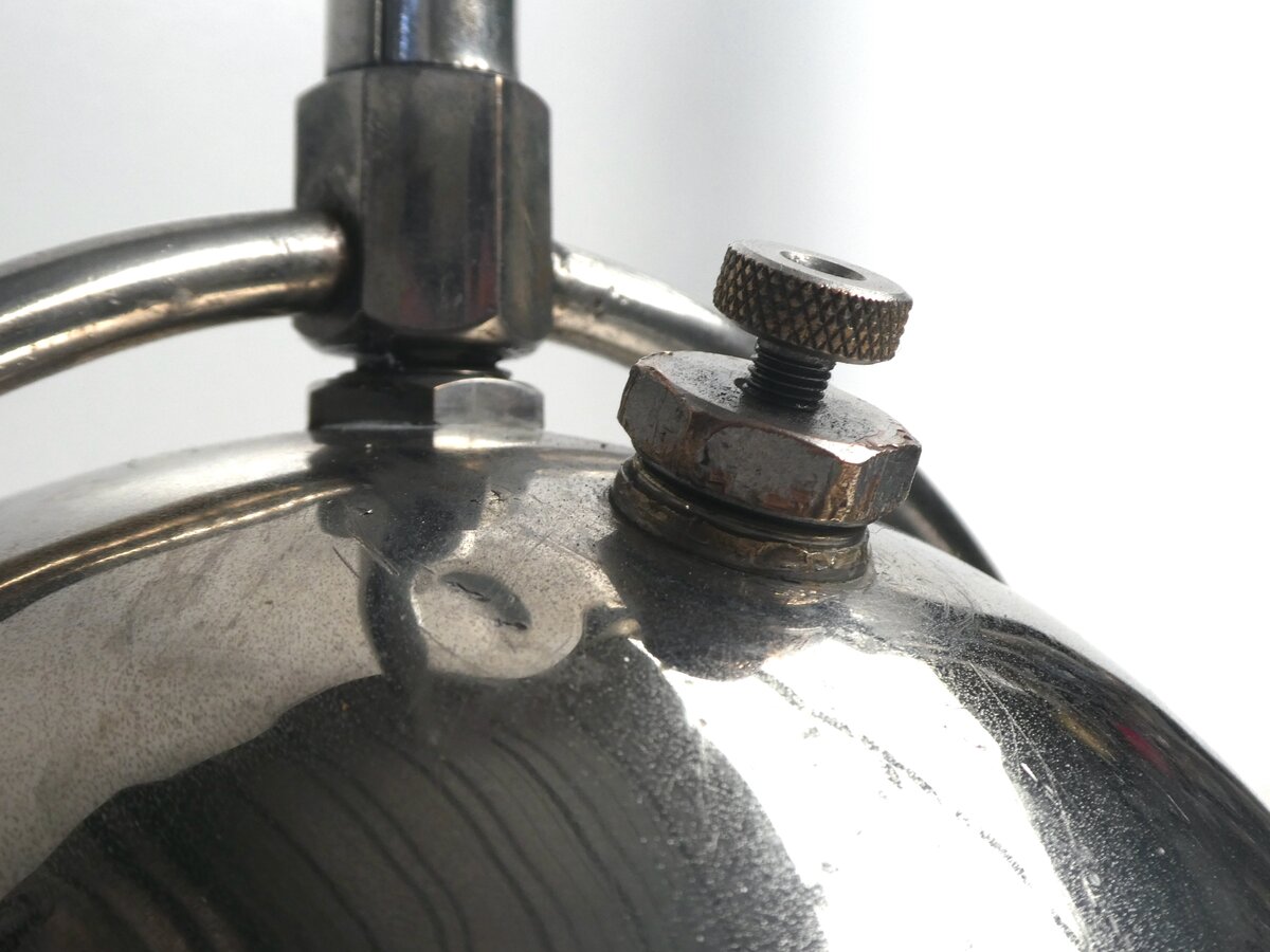

    The lead washer on the filler cap was replaced with Viton.

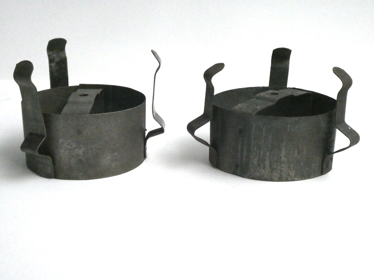

    The shade holders were first de-rusted by electrolysis, then treated in "Evaporust".
    The control wheels were cleaned then treated with car wax.
    The nickel was in reasonable condition, with some staining a small amount of nickel loss. The nickel was polished with Autosol.

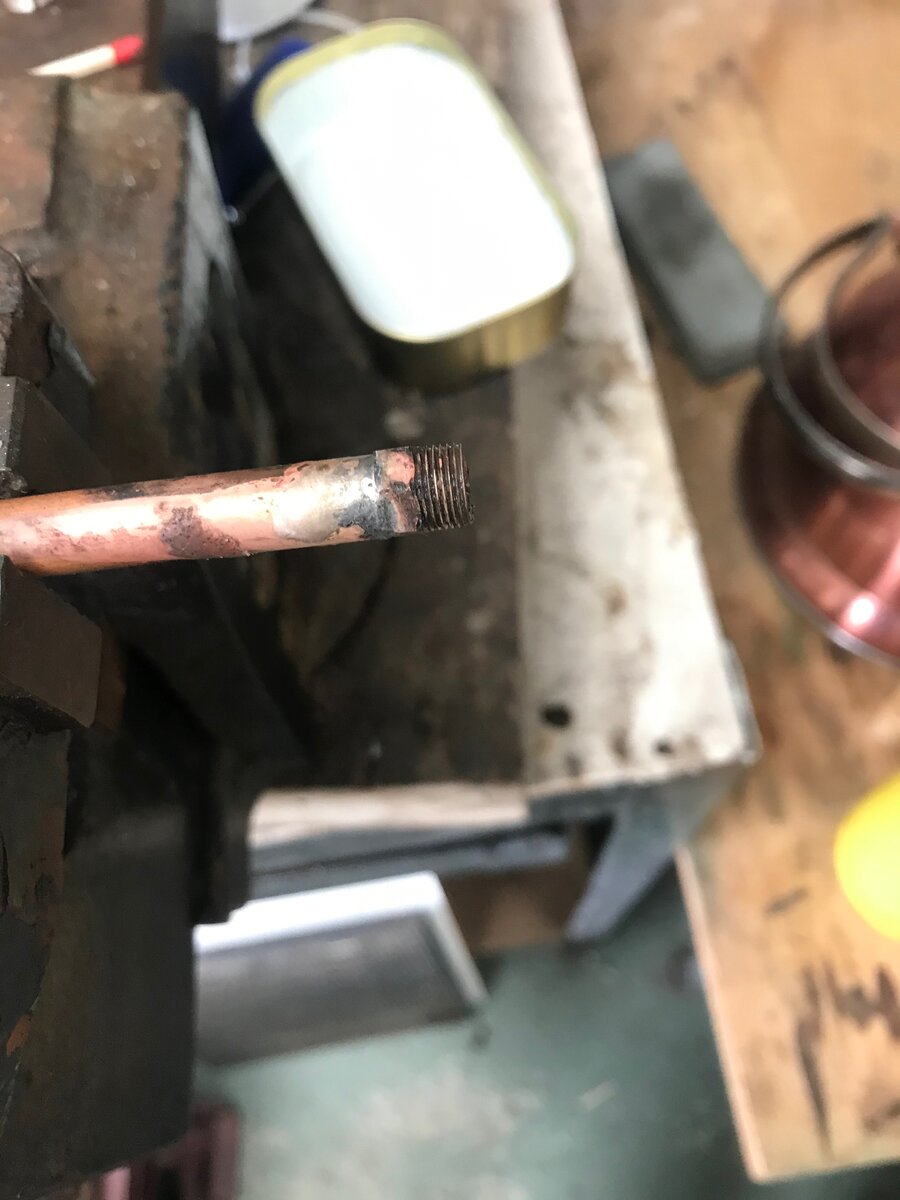

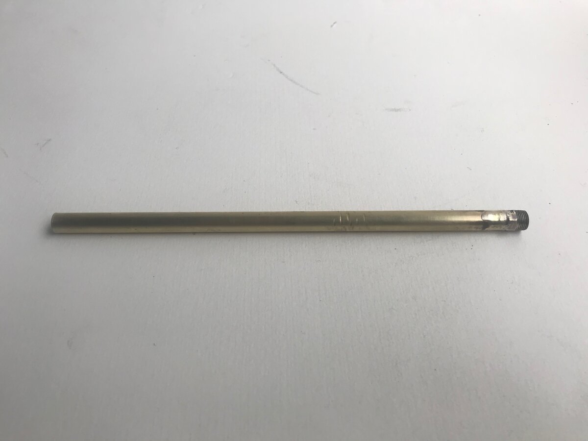

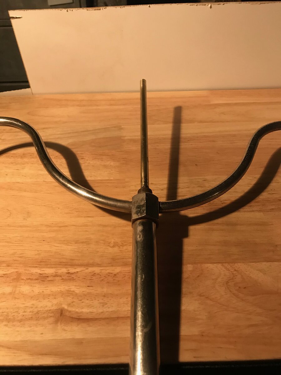

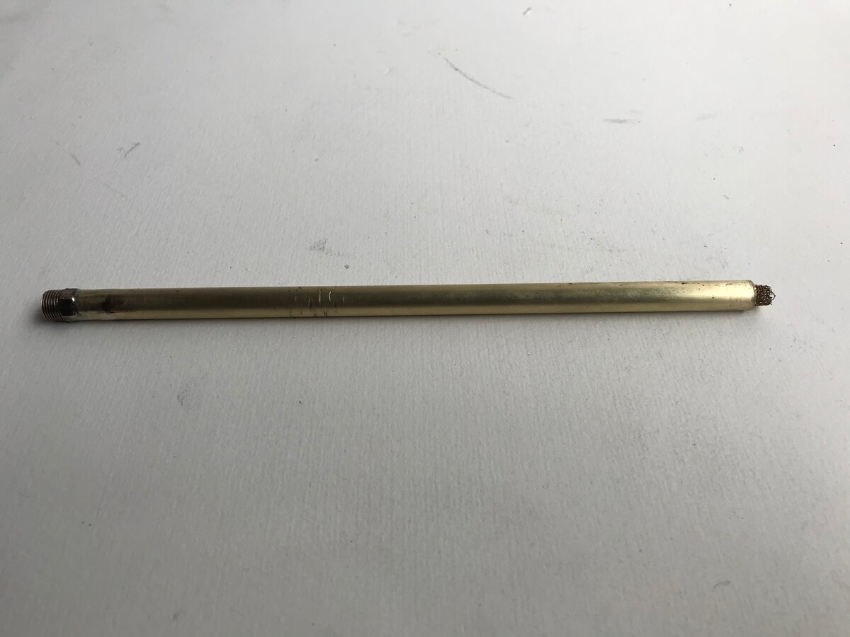

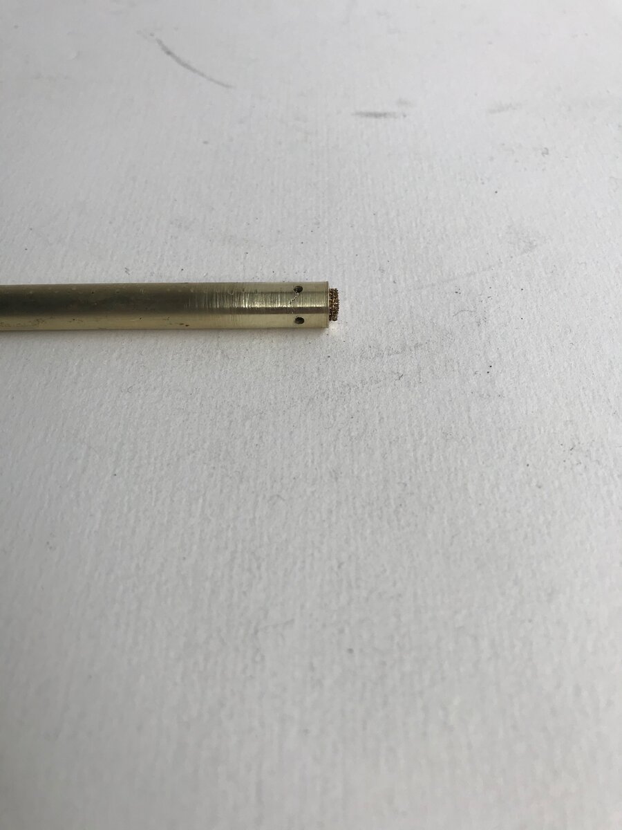

    The fuel pick up

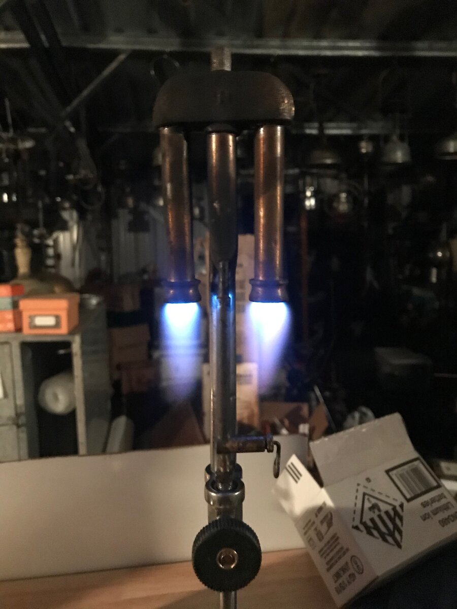

    When I first went to light the lamp I got very good 'hissing' through each of the generators... but no fuel.
    I took the hanger and arms off the tank and discovered that there was not a fuel pick-up tube on the lamp.
    So I silbrazed a 8mm diameter tube to the fitting nut.

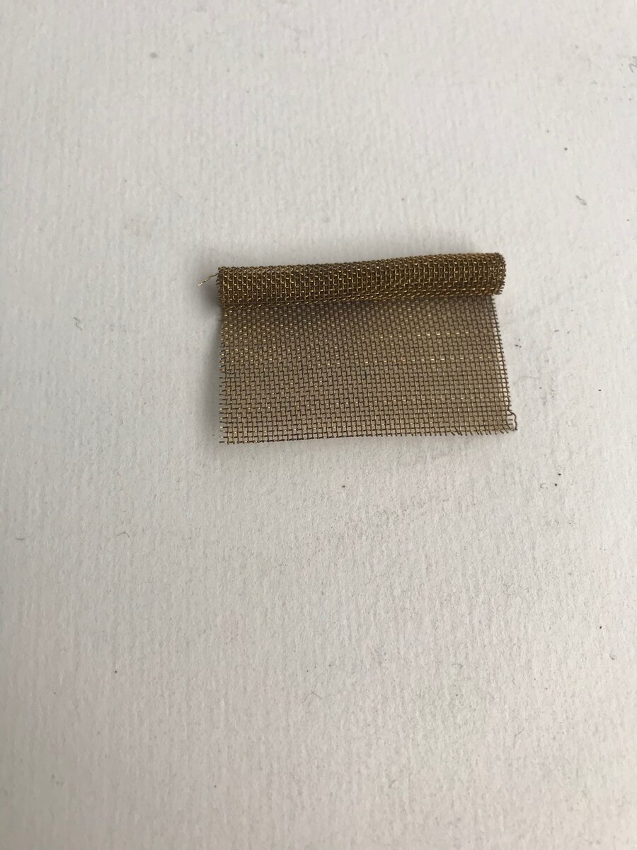

    I cut the tube to the correct length and fitted brass gauze to the lower end, and drilled 4 1mm holes in the bottom of the tube to aid fuel flow.

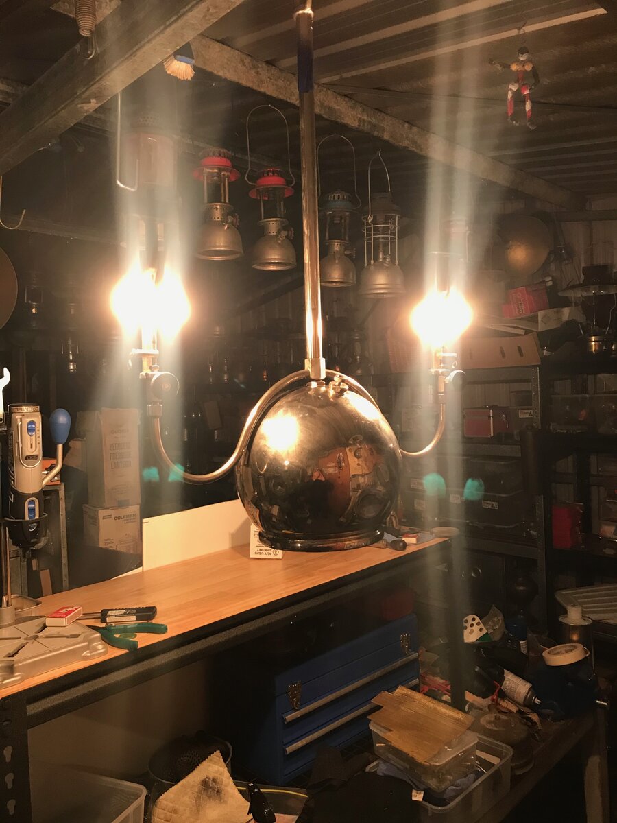

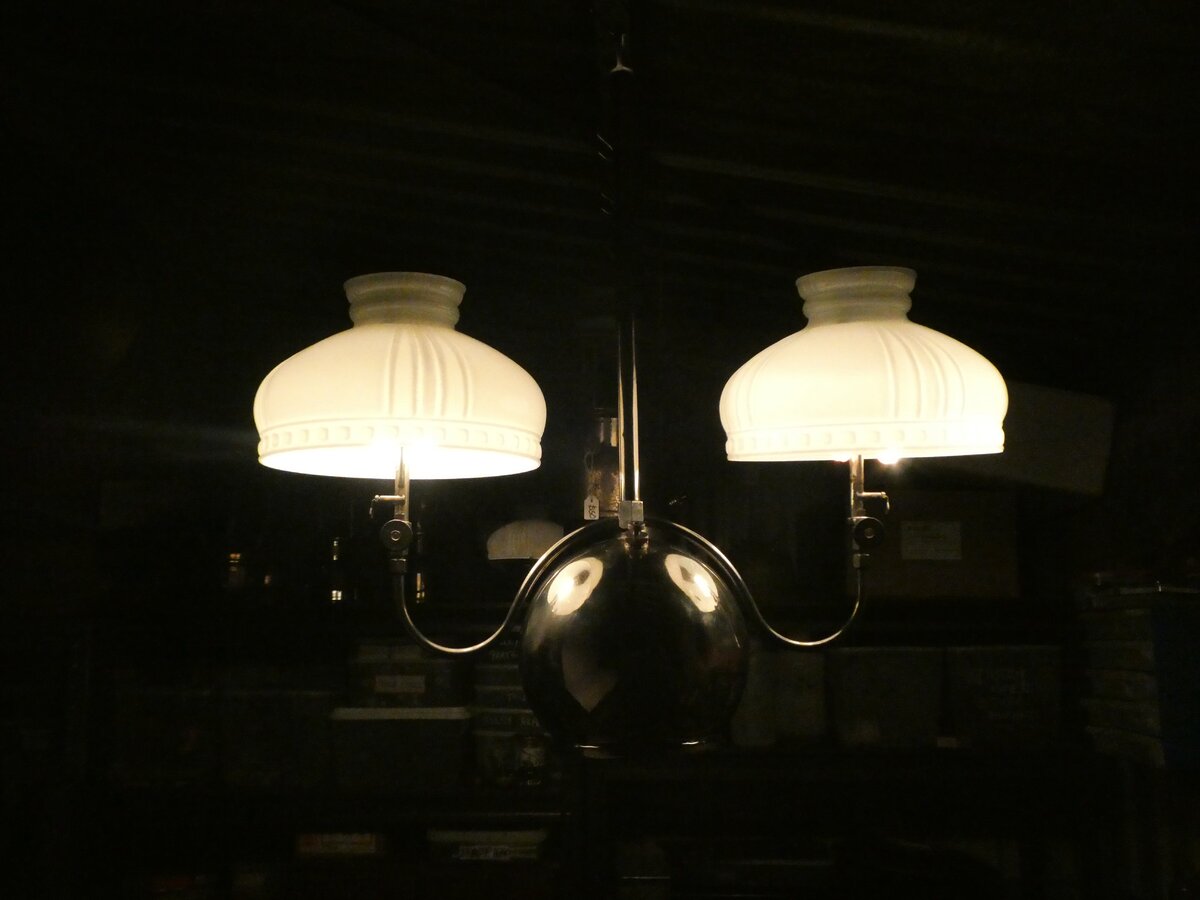

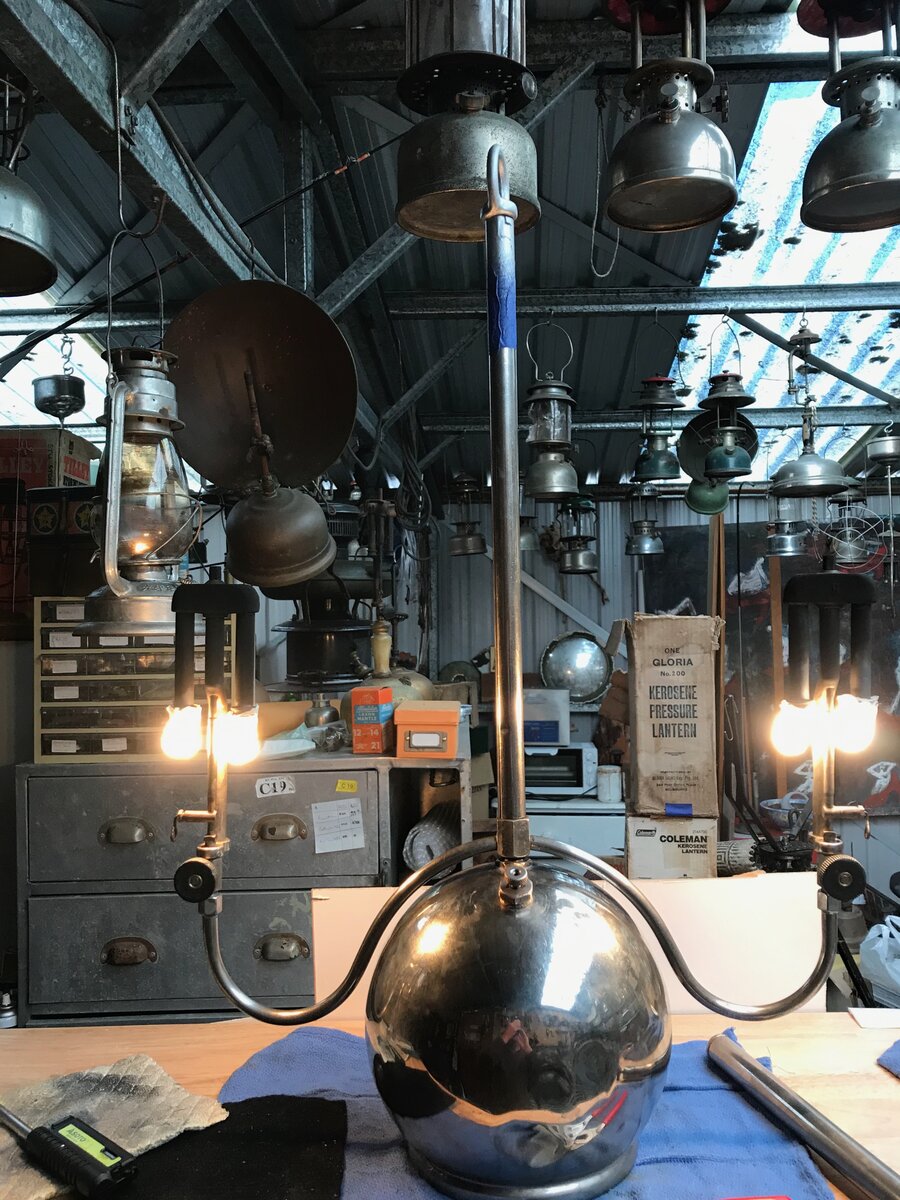

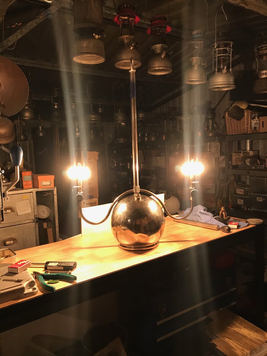

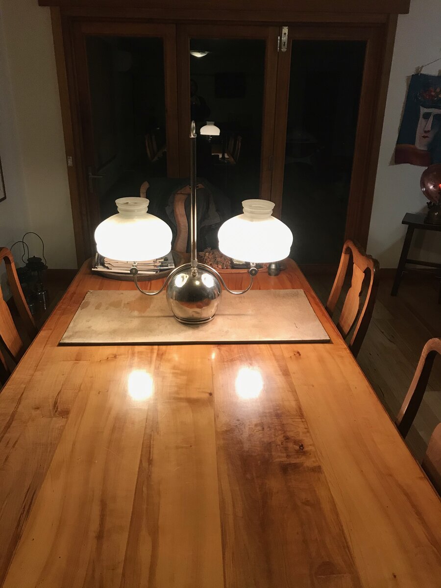

    Getting it going (this time with fuel pickup):
    This really is a beauty.

    A wonderfull restoration there Tony that would look good beside mine hanging up high ..Bob

    Beautiful! Congrats! :clap: I like the old Colemans a lot (but only have 3) as they are so simple and reliable. The R55 generators are later I believe? They are pretty handy!

    WOW - stunning lamp and beautiful restoration. Are the shades repro or original? Either way they are also very nice!
    Cheers Peter
  6. Tony Press
    @peterthevet
    The shades are either Coleman originals or Coleman copies made in Australia many years ago from a Coleman mould.
    I am awaiting confirmation from someone who is an expert on these matters, but Covid-19 has intervened.
    Edit: Note that the two shades are not identical. I have three shades of this pattern and they are all slightly different from each other.

    Based on the very thin/delicate bottom rim they are most likely original. Regardless they suit the lamp perfectly.
