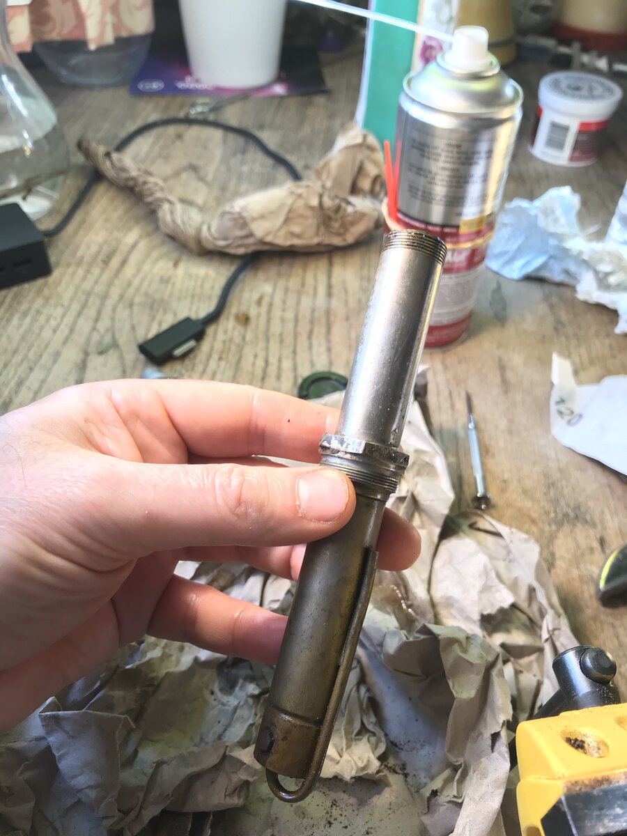

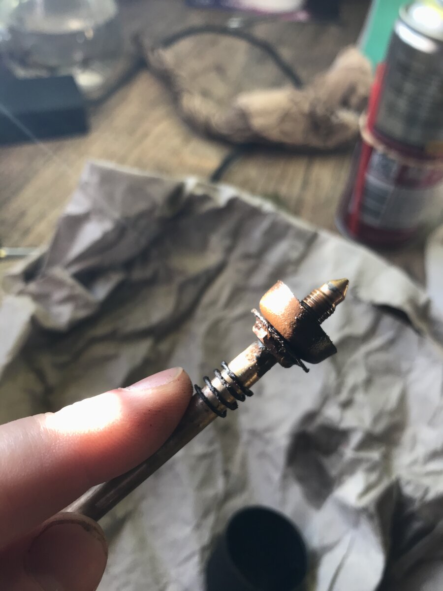

    so I cleaned the pump rod by boiling in dilute citric acid for 10 min and installed a new pump leather. And with that I could ascertain there was no air going through the NRV valve.
    The ball at the bottom of the tube would not move when pushed down with a wooden skewer, so I managed to unscrew the valve off the tank (Surprisingly it came off quite easily), and boiled that as well in dilute citric acid. Now the ball moves but fails to spring back up and it appears to be stuck ‘down’ with only a tiny bit of air going through the valve even when plunging very hard. So I removed the hex brass screw at the bottom and I’m boiling the valve again for 1 hour. Should that fail, is it worth taking the whole thing apart to take a closer look? How do I remove the lower section of the pump. The whole thing seems soldered in position....:-k:?::-&

  10. Henry Plews
    3,050
    Progress is progress even a problem is not completely solved.
    When in situ, pressured air from the tank will push the ball back up to were it seats and hold in the pressure.
    With the pump out in the open air, i.e. no resistance, operating it should be child's play.
    If further boiling doesn't seem to be having a positive effect, it may be time for different tactics.
    I can't see how it would be possible but perhaps there's something other than varnish-like fuel residue which is restricting the free passage of air, I'm thinking a very small piece of old pump leather.
    Because of the tight bend in the tube which comes from the bottom of the pump, it could be difficult to get a wire though from the open end to see if you can dislodge any obstruction. It may be worth a try though.
    A good hard blast of compressed air may also work if this option is available.

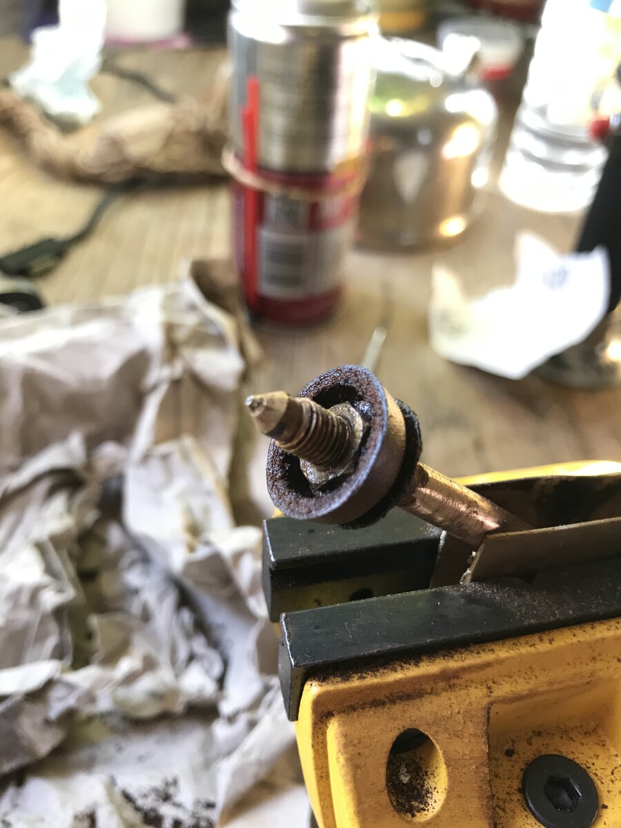

    Thanks Henry and George. I’ll try with a wire then. Also this happened whilst pumping.....is the last bit of that brass screw supposed to have come loose, revealing the steel rod inside? It was all in one piece when I started...! :shock::doh:
  13. Henry Plews
    3,050
    Err, no but don't let it worry you, it's old, these things happen. Make sure both parts are clean and solder them back together.

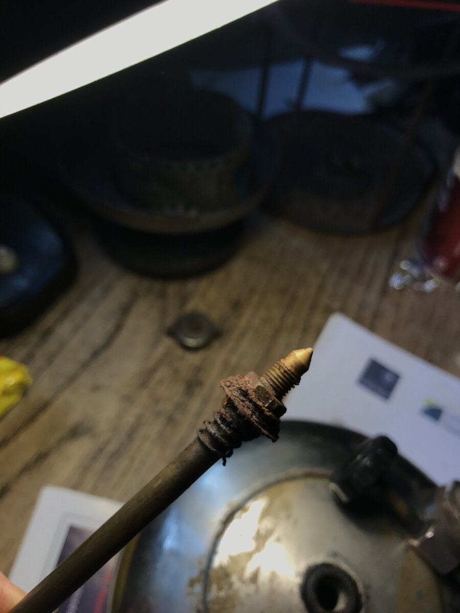

  28. Alex74
    Oct 13, 2019
    516
    Faringdon, Oxon
    Myn, that sounds like a degreasing procedure taken from an organic chemistry lab manual! Good stuff. I use methanol too to dry pieces at the end....
    anyway, there is definitely progress. The room temp lye soak was ineffective although just some air was going through, so I repeated it with hot lye for 30 min and that did it. Air was now pumping through freely. There was never a sign of the little ball in the gunk that came out of the side hole upon pumping. Then I pumped Holts carburettor cleaner through and more gunk came out with a satisfying ‘plop’
    Now the pump works a treat but when installed in the tank, it fails to retain air in (the piston pushes upwards after only a few strokes). I’m starting to fear there never was a check ball in there in the first place. I’m pretty sure I didn’t lose it as I was careful at each step. Can it be replaced?
    one more issue. The fuel valve which Santa fixed for me, seemed clogged too (I can’t blow air through it with the control cock open). Would lye work, or perhaps a acupuncture needle?
    But alas, progress this weekend! :lol::thumbup:
