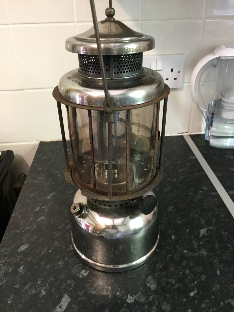

    I have been doing a bit of reading on this lamp I found for a few quid, no glass or mantles but apart from that and a nice green hue, it looks complete.
    The tank is brass rather than a steel one and the hood is marked Coleman Toronto Canada. Can you give me any ideas as to an accurate date? Or how to do so?
    I intend to fettle it up and presume the place for Mica is still Fred Kuntz?
    Any pointers would be useful. Things are soaking in Plus gas at the moment prior to attempting to get it apart.
    How does the tube to the mantles come off, the generator has a nut?
    Thanks Nick
    Here you go @Tony Press I have a feeling it's the latter of the two?

  5. Tony Press
    11,053
    @Nick Powell
    They come apart the same way.
    Take the vapouriser (generator) off first (unscrew the square nut at the bottom; lift the generator up then out).
    Then get your spanner to the figure 8 nut on the burner and cage (I said "generator" in my post above when I meant burner).

  8. Nick Powell
    Aug 20, 2011
    79
    I notice the gbnerator on mine is straight i.e. No loop is this original, a later replacement? Does it work as well as one with the loop?
    Nick
  9. Tony Press
    11,053
    @Nick Powell
    The generator you have is one that has an internal cleaning needle; whereas the generator with the loop has no cleaning needle. They both work fine as long as they aren't clogged with old dirty fuel.
    My Canadian LQ 327 came with a generator like yours. It wasn't working too efficiently so I have it soaking in acetone. I swapped it.
  10. Nick Powell
    Aug 20, 2011
    79
    It's in bits now! Looking more carefully I am pretty sure it's a nickel plated version so maybe not as old as I thought.
    Looking inside the generator it's all nice shiny brass so it may be ok.
    Graphite seal in the control wheel is knackered, and airtube is all carboned up outside so I would assume the inside is the same so a citric acid bath is in order.
  11. Nick Powell
    Aug 20, 2011
    79
    Should the ball bearing in the filler/ check valve be sprung loaded?
  12. Carlsson
    3,963
    No, it's loose.
    If you shake the filler lid, it should rattle.
    It's seated by the air pressure inside the tank once you start to pump, and doesn't normally make a perfect seal.
    (It's just for the pump action. The real sealing is of course done by seating the knurled pump seat after pumping.)

  16. Nick Powell
    Aug 20, 2011
    79
    Brilliant thank you gents @Lundo007 @Carlsson my ball is rattling nicely!
    Now trying to get the crud out of the tank!

  28. Chris of the North
    Chris of the North Subscriber
    Aug 30, 2014
    11
    The loop generator I think for the Kerosene model and the straight one for the gas (petrol) version. The straight one can be cleaned and is easy to repair, the loop is a devil when it get clogged.
    If you have compressed air and a propane plumbers flame then you and do the following:
    Remove the gas tip, put the generator in a metal vice and heat the generator red hot, use the compressed air to clean out the inside of the generator.
    Note when doing this a HUGE FLAME will exit the generator so make sure you are far from anything flammable. This burns off all carbon inside the generator and it might salvage this loop generators, if not you'll need to source a new one (if the solvent doesn't work).
  29. Mackburner
    No the coil is the original for this lantern. The R55 you have was introduced in about 1929 for the 220/228 models and as a replacement for the Q99 coil in Quick-Lites. Both are for gasoline there is no kero generator for them. There is a kero version of the QL327 but it is the burner not the generator that is modified. These lanterns were, with one exception, always nickel plated. The exception is the range was sold in France finished in polished and lacquered brass and gold paint but that is a regional thing not a date indicator. They are rare things and were never sold in the UK, only France and possibly Belgium. ::Neil::
  30. Carlsson
    3,963
    And I would also add that the Q99 (loop generator) doesn't really come clean with the heat and compressed air method.
    That usually works well for removing coke when you have an open generator/vapouriser.
    But the Q99 is stuffed with an asbestos string, and it doesn't really allow you to blow compressed air through it.
    But I have read somewhere a tutorial how to clean these with chemicals, which possibly could help a little.
    I think it was carburettor cleaner, or something like that.
    It is probably just to search the Coleman Collector's Forum.
