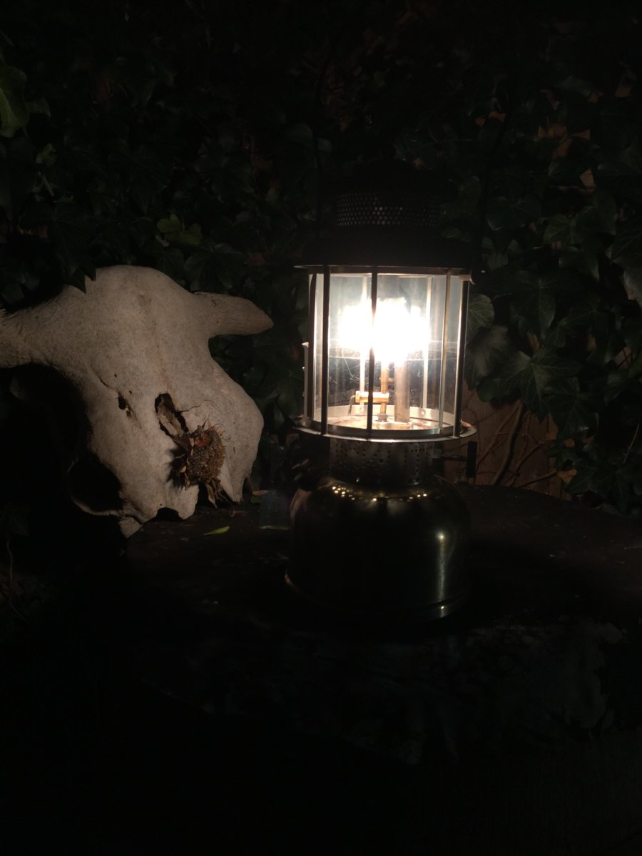

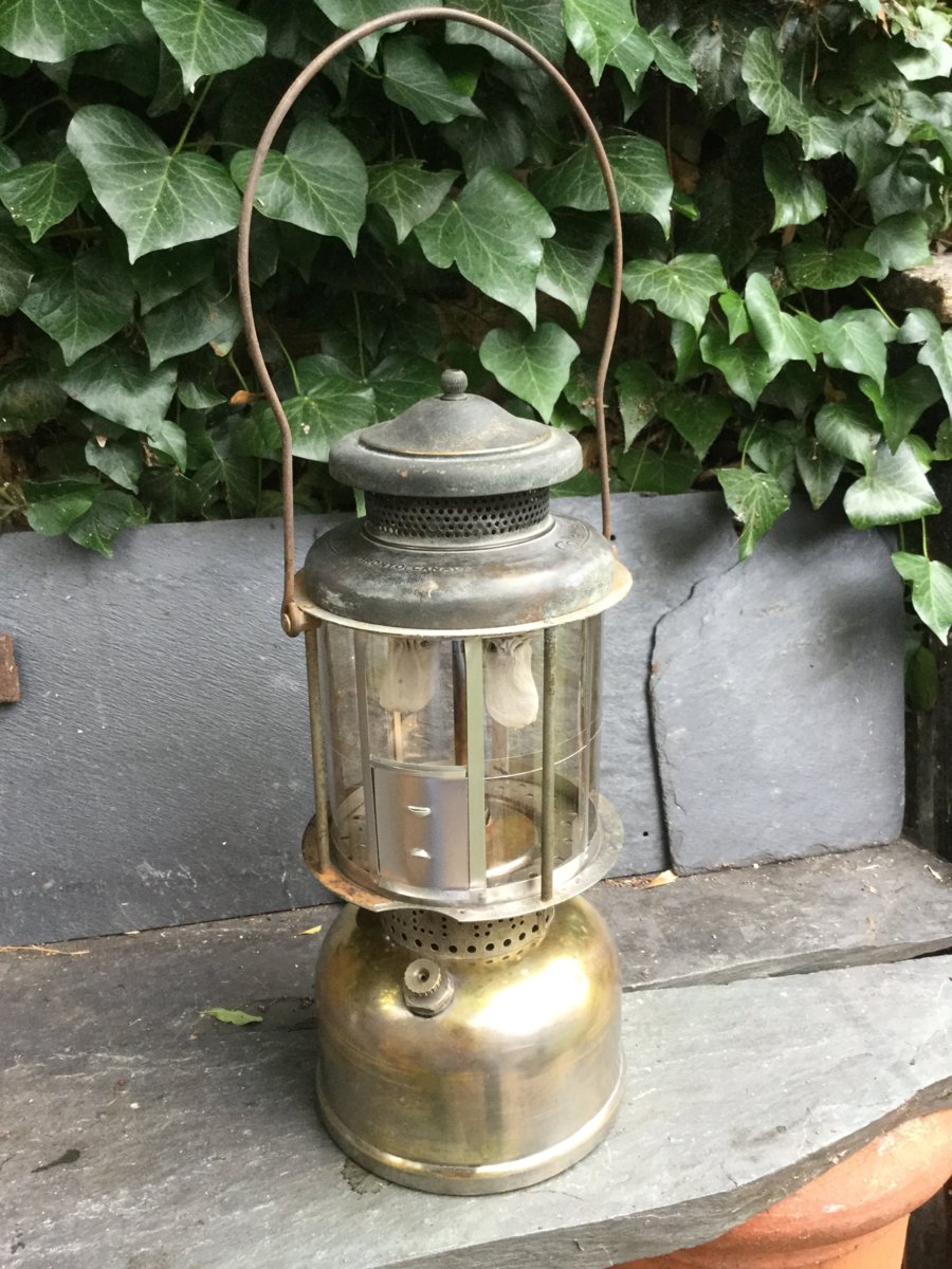

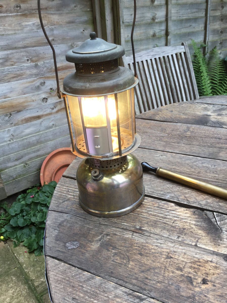

    IMG_1912.JPG The Fred Kuntz globe arrived today and looks great I did not want to go for an over restored look but it's loads better than when I found it and it works!
  3. Nick Powell
    Aug 20, 2011
    79
    11,092
    Excellent!
    A very fine, straightforward lantern.
    I'm glad you've got it running.
    Best regards

    @MG the globe looks great but worked out rather more expensive than I thought with import tax at nearly £15 so be aware of that when ordering.
    Only took a couple of weeks to arrive Fred Is very efficient.
    I am going to strip it down again as I think I have a leak between the riser tube and tank. It gives a good light. Lighting it can be a bit exciting to say the least!
    Cheers Nick
