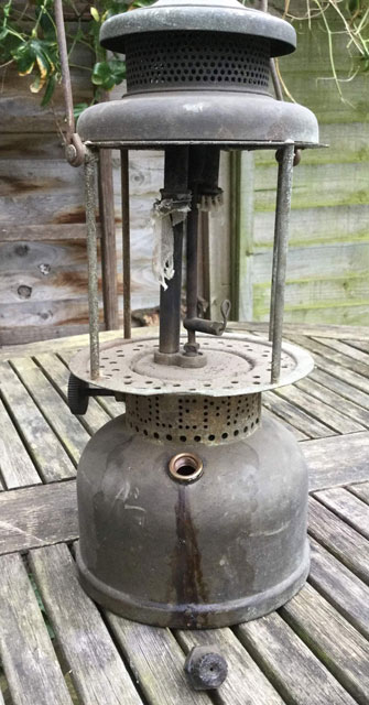

    Hi all
    Does the above lamp have a number so that I can look at it in the reference gallery?
    It does not seem to have a pump is that right or is it missing pardon my ignorance!
    Cheers Nick
    16,652
    Hello Nick, photographs will help us to assist you and there are several models of Coleman QLs..
  3. Carlsson
    3,963
    As Jeff says. It can be many models, so a picture would help.
    If it is a table lamp, and use an external pump, it might be found in the "CQ-section".
    Equivalent lantern could be out of the 327-series seen here.
  4. Nick Powell
    Aug 20, 2011
    79
    Here is a picture it looks to be made of brass and has the Coleman name and made in Toronto on the shade.
    Cheers Nick
  5. Carlsson
    3,963
    Nick, that's the lanterns of the 327 series I posted a link of above.
    Check this out.
    You will see which are Canadian made.
    You can't get a better lantern. You just need to get a pump for it. They are often sold on eBay. You might also look out for a Q99 generator if you want a more original type.

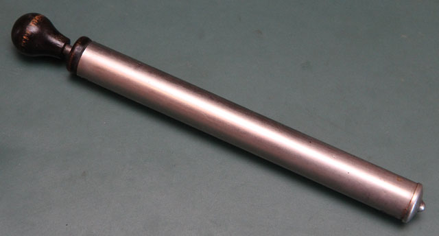

    Is the pump a separate item that fits onto the filler cap then?
    I was not sure if it needed one as its a Coleman fuel lamp?
    Thinking of Optimus 8 stoves.
    Nick
  7. Carlsson
    3,963
    Yes the pump is a separate item.
    There's an indentation in the screw on the filler cap where you fit the pump.
    The screw is opened a bit, the pump attached and then it's just to pump.
    After that the screw is shut.
    The filler lid has a check ball built in, but it does not absolutely seal off the pressure, hence the screw which has a conical seat against the lid and pressure from the tank.
    Here's a Coleman pump:

    There's always one pump like this, and often a few more, to be found at eBay.
    That's the beauty with practically all Coleman products! :lol:
  10. David Shouksmith
    It's probably worth noting that there are short pumps for the Coleman irons and longer ones for the lanterns. The pumps intended for irons work on the lanterns but you have to pump twice as many times for the same tank pressure...

    I think I may have located one of the longer ones on eBay in Nebraska USA I have to see if the postage will put the price up to high for me. This one looks the same as Christers photo.they don't seem easy find in the UK. Is the glass available or are the mica one from the USA the only answer now?
