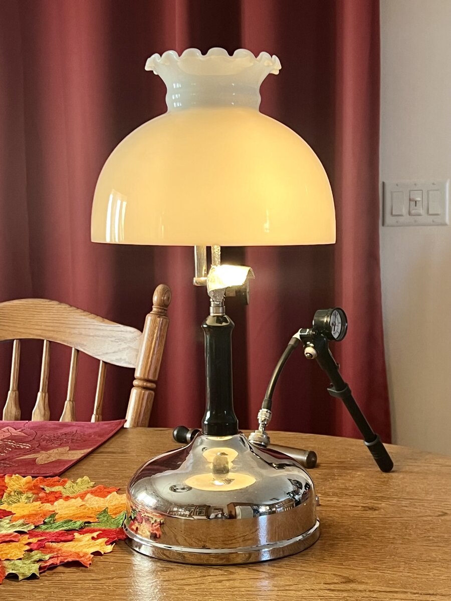

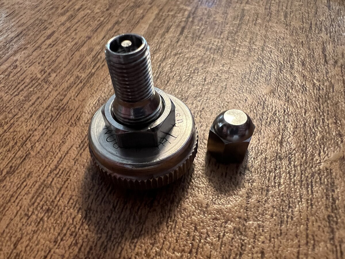

    IMG_9911.jpeg I modified a Schraeder valve to pressurize the fount; i am currently using a Harley Davidson suspension pump with a built in gauge to monitor tank pressure. IMG_9909.jpeg

    That adaption does the job.
    Your lamp may work with either fuel and the link below shows one my topics and there is relevant information shown there about using paraffin / kerosene in a Coleman lamp which is fitted with an R-55 vapouriser / generator.
