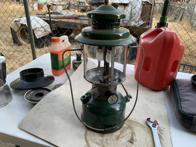

    This is my rusted piece and looking for a solid piece, I don’t care if has chips
    Came with a 220 ventilator instead of the 228 70FAD69F-9C7E-48EC-881C-F853FA72290C.jpeg

    Monkey wrench for life

    @Pancholoco1911 Nice, looks in good condition. I do like a big hat, it will be great once you get the ventilator for her.

    Lol, I have the dedicated wrenches but they are never available at the operation table, only that one is on hand every time I’m working on my lanterns

    @Alex Smith this is my third big hat (228c, 228E and this one missing the ventilator) I have a bunch of 220’s but I’m getting rid of them and keeping only the big hats
