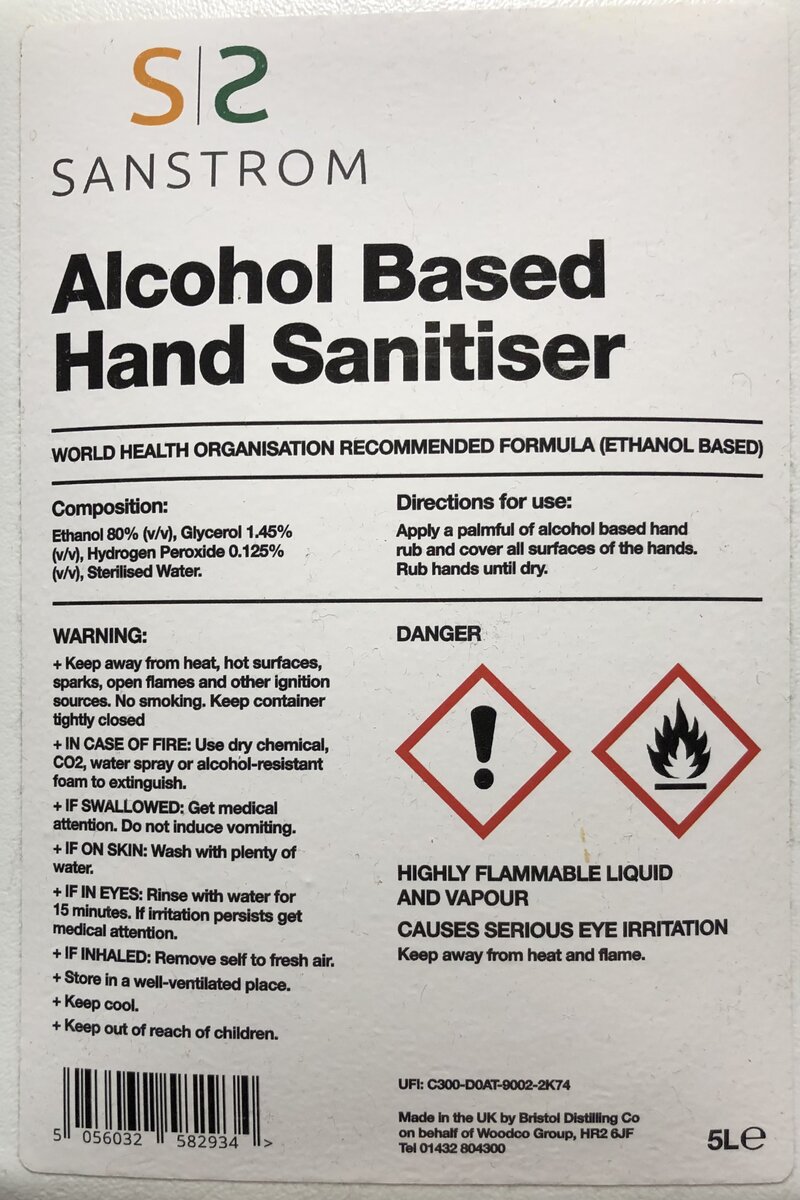

  6. podbros
    3,999
    There may be alcohol based hand washes available with high ethanol content?
    i use one for preheating but not sure if that makes it ok to run a lamp or stove?
  7. gkpllantern
    gkpllantern Japan Subscriber
    Aug 16, 2011
    73
    Chiba, Japan
    @podbros
    Thank you for your interesting comment.
    Here in Japan, most hand sanitizers are indeed ethanol-based, typically containing around 60–80% ethanol. However, they are formulated for medical use, not as fuel. In addition to ethanol and water, they often contain additives such as glycerin (as a moisturizer), fragrances, thickeners, or other stabilizing agents.
    While such products may work for preheating, I would be cautious about using them as the main fuel in a pressure alcohol lamp or stove. The additives can cause incomplete combustion, soot formation, clogging of the jet, or residue inside the vaporizer. Also, the ethanol concentration is usually lower than what is ideal for clean and efficient combustion in pressure appliances.
    For proper operation, high-purity ethanol (around 95% or higher) without additives would be much more suitable.
    So although hand sanitizer may burn, it is not necessarily appropriate as a primary fuel for a pressure appliance.
    I would be very interested to hear what type of alcohol fuel is easily available in your country — is it mostly ethanol-based, or methanol-based?
    Br,
    Shinzo
  8. podbros
    3,999
    @gkpllantern
    Hi Shinzo
    you are very welcome but i thought that would be the case regarding its unsuitability
    i will take a screenshot of the label for your perusal
    best wishes,
    pb
  9. gkpllantern
    Aug 16, 2011
    73
    Chiba, Japan
    @podbros
    Thank you very much for sharing the photo — it’s much appreciated.
    From the composition shown, it appears to follow the WHO hand sanitiser formula. While perfectly suitable for disinfection purposes, this type of mixture would not be ideal as a fuel for pressure lamps or stoves.
    The relatively high water content would lower combustion efficiency, and the glycerol in particular could lead to carbon deposits and jet blockage in pressure appliances.
    So although it is ethanol-based, it would unfortunately be unsuitable for use as fuel in our lamps or stoves.
    May I also ask — in the UK, is the fuel alcohol that is readily available primarily ethanol-based?
    Br,
    Shinzo

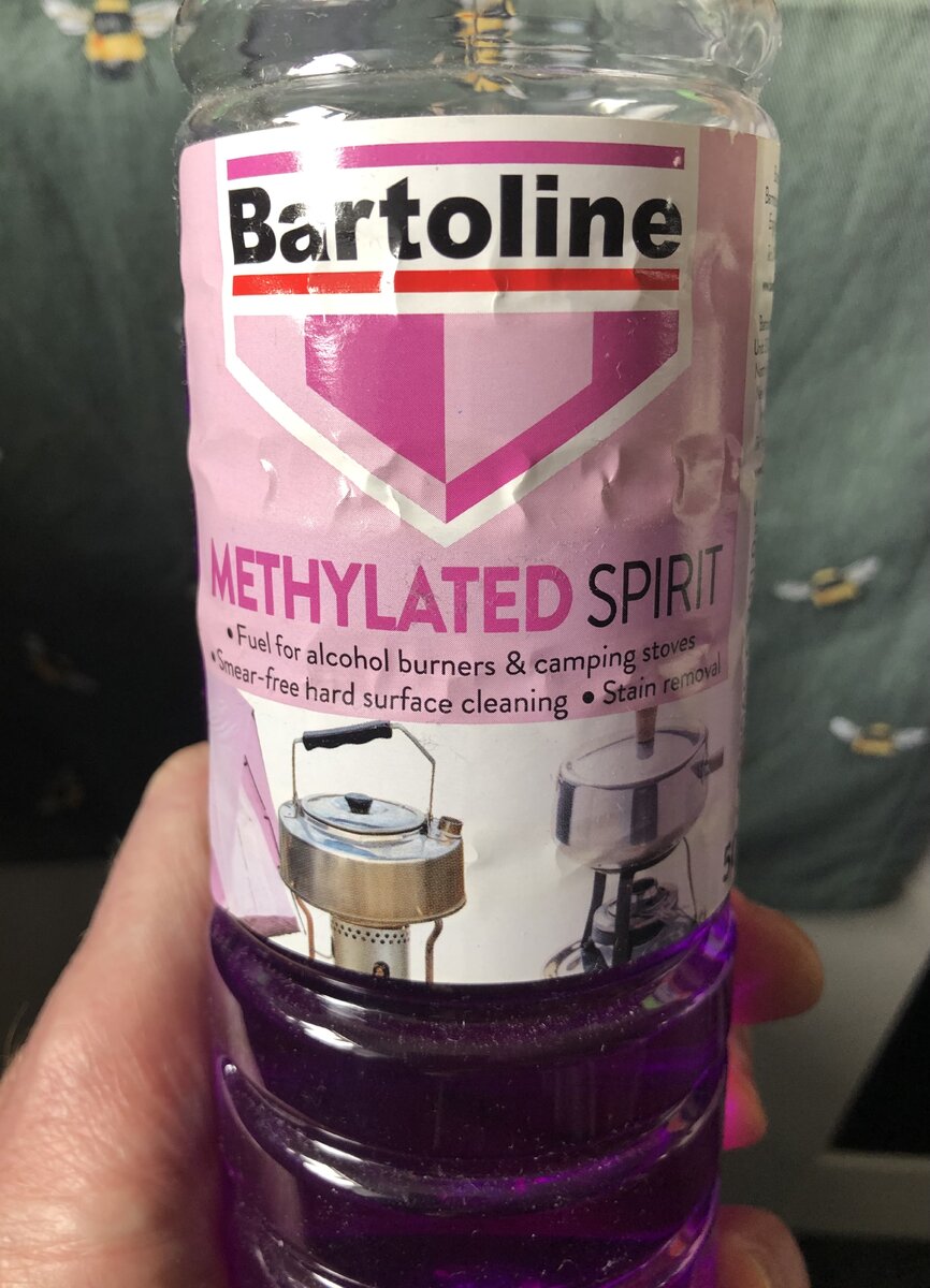

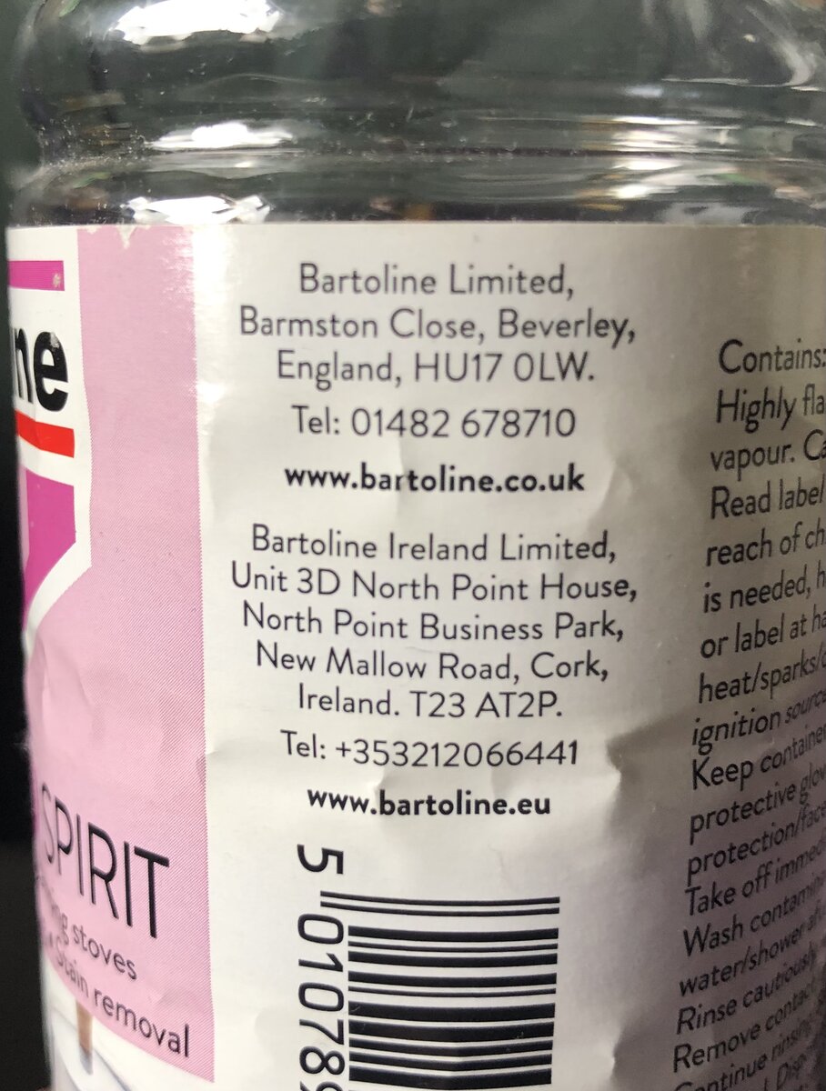

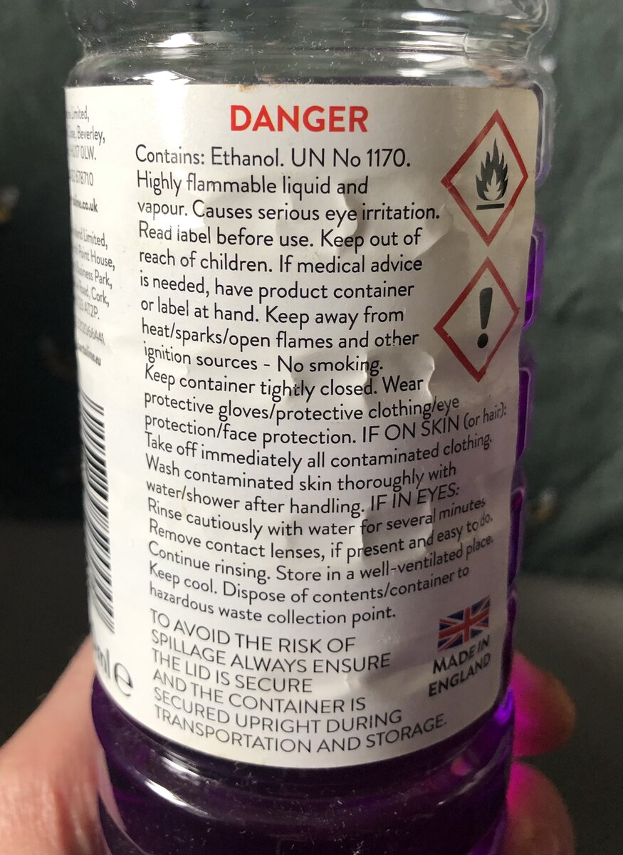

  10. podbros
    3,999
    @gkpllantern
    Thanks Shinzo,
    Im not sure about all brands of ‘meths’ and what other ingredients this one contains, but this one does contain Ethanol
    here are some details for your consideration
    thanks
    pb
  11. gkpllantern
    Aug 16, 2011
    73
    Chiba, Japan
    @podbros
    Thank you very much for the information and for taking the time to share the label details.
    At least in the case of this product, it appears to be ethanol-based.
    As you may know, the UN number is assigned according to the principal component for transport classification. UN1170 refers to ethanol, which suggests that this product is primarily ethanol rather than methanol.
    There may well be some variation between brands in terms of denaturing agents or minor components, but it seems likely that fuel alcohol in the UK is generally ethanol-based.
    This is very helpful for my research — I truly appreciate it.
    Best regards,
