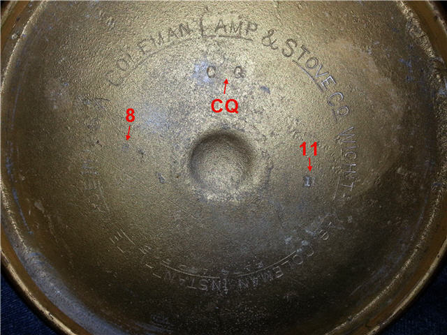

    I was winning bidder at an estate auction for an industrial looking pressure lamp made by Coleman, which I have since found to be an early model CQ table lamp (if I understand the dating format, it is November 1928). I didn't know anything about it at the time of auction, I just liked the look, and thought it would make a great display piece.
    A friend had some old Coleman 21A mantles, and old camp fuel which we used in an attempt to test lamp. The lamp actually lit up, not very brightly, but it worked.
    I was astonished to say the least.
    I hope I haven't gotten the bug, but I have decided to try restoring the lamp for optimal operation and to as close to original look as I can. Would anyone have a parts diagram, and suggestions on locating parts for this specific model?
    I have found some good general instructions on how to disassemble a pressure lamp, but not this model in particular. Any suggestions on how to do so on this model as well as advice on must replace parts during rebuild, would be greatly appreciated.

    Your lamp is not a CQ., Coleman used up old stock base plates on some of those ribbed tanks, your lamp is probably a 118-A, check out the link below.
    http://0flo.com/index.php?threads/4197

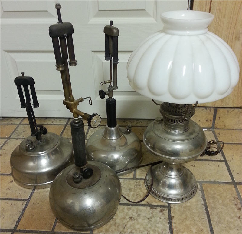

    Well I was successful, of course it went right to my maximum bid allowance. This is what I went for;
    And on a table with totally unrelated items were some GPA's, choice of items, I couldn't resist putting in a lowball bid. Uhh, I was only bidder, so I took them all. So look what all I brought home.
    And this;
    The CQ lamp had some raggedy mantles and clean fuel so I fired that puppy up, and it fired up, I mean fired up, cause I tried to light it like my 118A lights. Fire extinguisher blew mantles off real neatly... Will pre-heat properly next time. From info I can find, it is 1917~1919. I'll post on it after I do some further investigation and cleanup.
    The lamp with the Air-O-Lite fount is a Franken Lamp. If anyone can tell what the different components come from, I would appreciate knowing.
    The last one is also a Franken Lamp. The fount is a Pitner (Tagged 17063 on bottom) that is in pretty rough shape, and the burner assembly looks to be from a CQ, this may be worth messing with later.
    My thanks again to Neighbor Al for the lamp shade holder. With that I now have all the parts for my 118A lamp, which I still have not finished reassembling after cleanup.
    I tend to ramble on. Wether talking or typing.
    Are these posts too long?
    Jerry

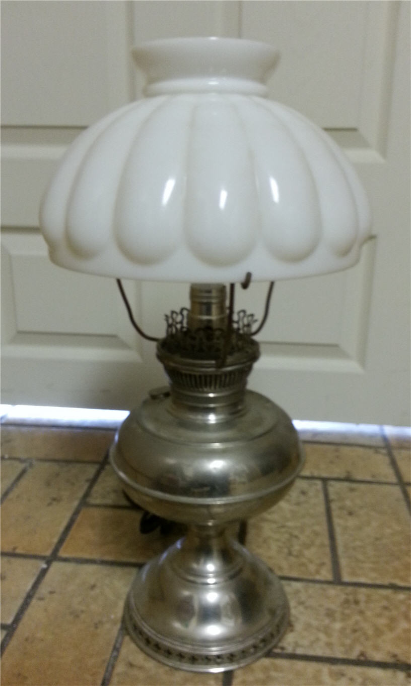

    The lamp at the front has burner arrangement off a 220 by the look of it , & no doubt someone will let you know what the others are although the oil lamp with the shade is possibly an Aladdin of some sort maybe an 10/11 or earlier :-k
    The pump looks like one of Jeff's later Amish ones :D
    Stu :D :thumbup:

    the oil lamp should be a kind of a Rayo (made by Bradley & Hubbard in around 1905). I've got the same thingy here and it's quite bright, but develops a horrible heat & thirst. No mantle lamp, has a simple flame spreader and matador type cylinder, like shown in this post. Bradley & Hubbard also made the founts for the early Aladdin Lamps in the US, so similarities are not accidental.
    BR, Martin

    Well done Martin :D :thumbup: , not too far away then :doh: although i think this ones been electromicated :doh: :roll:
    Stu :D :thumbup:

    Take the valve and burner unit off the Pitner tank and shove them on the turban fount. A Q burner on a model AA is what the factory conversions looked like. All it then needs is the bell cover to make it a complete AQ conversion. ::Neil::

    BTW: The valve attached to the Pitner fount was kind of loose, so I took it off and found this;
    Thread of valve and fount must not have been even close. Wonder what they thought they were doing forcing it on like that.
    Jerry
  19. Mackburner
    OK so you might need a new valve for a CQ. Should be easy enough since Coleman made a few million of them. ::Neil::
