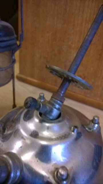

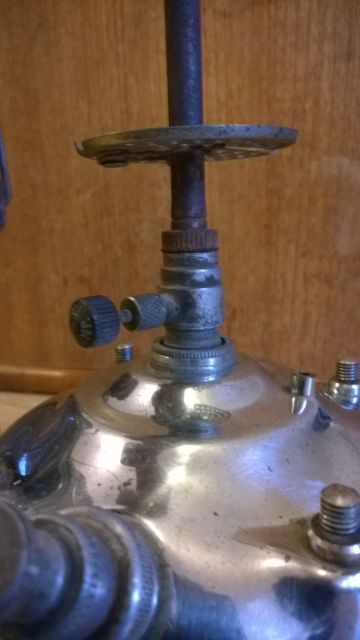

    Hi Guys,
    I really hope the wise and knowledgeable on here can help me out?!
    Dads Lamp. I first met it back in 1975 when I was 10! The hisss still takes me back to the Rhodesian outback by lake kariba, trying to fish and being plagued by moths the size of small Bats.
    The Lamp dates back further than that though. Dad worked for the Rhodesia and Nayasaland Government, He was issued with his lamp circa 1959?-1960? but he may not of had in new. At the bottom edge is their stamp, RNG. Basically Dad nicked it when he left!
    in 1963 it returned with Dad to the UK, But was taken Back to Africa in 1970, then Returned again to the UK in 1980's . I took possession of the lamp when I moved onto a boat in the late 1990's. It was for a long while my primary source of light and often heat! Life changed and I got married and moved to Terra Firma, later I moved to Spain and took the lamp with me. 10 Years later in 2010 again the lamp found it's way back home. Life has changed again and I have bought another boat, out came the lamp :D/
    She is clearly a Guardsman, still there is the insect shield! a stamp on her underside is 4580A? Does that mean anything?
    Other markings are RFT, They are Dads initials! Tilley England is there with an Owl between the two words.
    But.... I think her life is now over [-o<
    Pardon by terminology, the silver tank has coming out the top a long rod with a tap for adjusting fuel flow.
    This whole rod/tap assembly lifts up and down in to and out the tank? It can not be full removed. Is it fixable and are there any professional restoration folk out there?
    Thanks in anticipation with any information you can help with. Oly

  5. GAVIN W United Kingdom
    Feb 2, 2014
    117
    Bedford UK

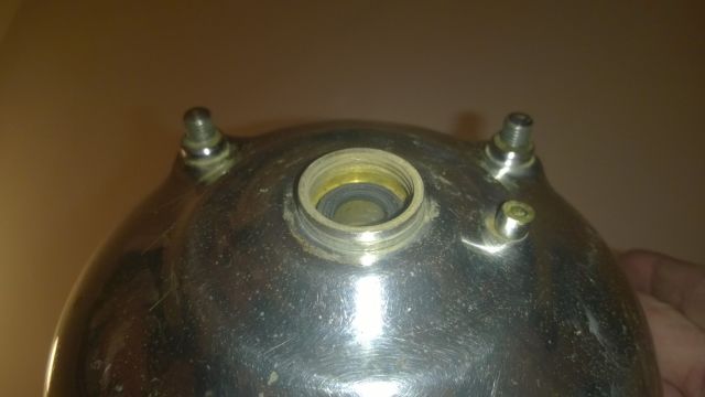

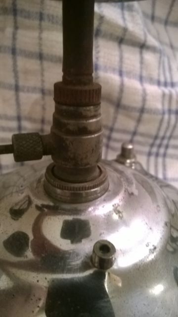

    What is causing the confusion, is what is the hole in the top of the tank like? There should be a fixed thread for the tube part to screw into, all is not lost!!!

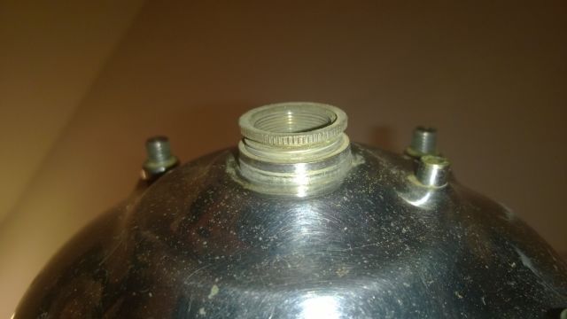

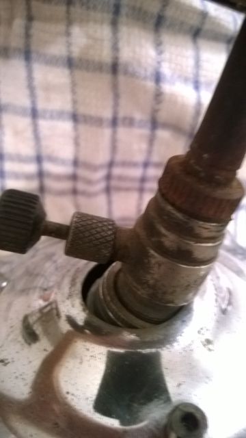

  6. 666oly
    Jan 17, 2016
    11
    Thanks Guys,

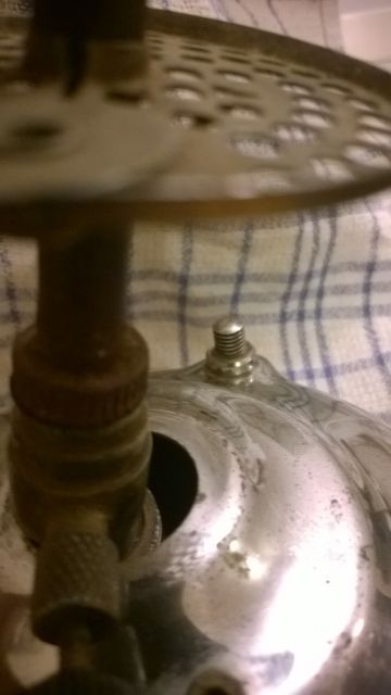

    Here, these pics may help?
    Can't see any threads, that is the strange thing, I do not understand ( unless they are welded in place before the tank is constructed and the weld has broken? ) how the assembly is supposed to be held firm?
    Oly 1453049219-WP_20160117_007_opt.jpg 1453049229-WP_20160117_008_opt.jpg 1453049238-WP_20160117_009_opt.jpg

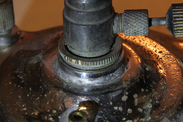

  7. Carlsson
    3,960
    You may be able to solder that part. I have atleast one Guardsman where this has been done, so apparently this part might come loose in some cases.
    Or perhaps the earlier ones, like the one I show below, actually had a visible soldering there from the factory?
    Either way, I think you should be able to fix yours in that way.

  9. GAVIN W United Kingdom
    Feb 2, 2014
    117
    Bedford UK
    I think that it was originally a "compression joint" assembled before the base of the tank was fitted. No reason why it cannot be soldered as shown, as you stated it is "The Lamp".
  10. podbros
    3,999
    Hi Oly,
    If you compare you pic and the one Christer has posted you will see that the solder joint on your picture has failed, the vapouriser threads are only really visible when dismantled?...
    ...Look at Christer's close up, you'll be able to see that the long vapouriser tube screws into a knurled sleeve?..
    ...This in turn screws into the threaded insert soldered to the Fount; that's the part which has come adrift, but because it's all still assembled it's hard to make out?
    ...Don't worry, the people on here won't be fazed by a job like this and will want to help you get your lamp up and running! Great history to it!.. :)
  11. JonD
    JonD Subscriber
    Apr 15, 2014
    1,006
    Hertfordshire, England
    Agree 100% that this tank has to be fixed or the main value of the lamp is gone.
    The solder repair is quite trivial but it does need the parts below the control cock to be separated.
    The knurled ring is what has parted company from the tank. Now it is probably stuck fast to the control valve assembly. It has to be released without causing damage and that will likely need soaking in penetrating oil, perhaps some heat, and very gentle treatment. Dont grab it in a vice without protection from scoring. There is nothing that can fix it once it's been "graunched".
    Graunching is permanent - always.
    If the tank joint has been broken it is likely to be very stuck. Some heavy handed effort to unscrew the control cock broke the tank soldering before unscrewing was possible. A good challenge here but it should be quite possible to fix it as new.
    Best wishes for success.
  12. Carlsson
    3,960
    From what is possible to see in the gallery it looks like also other 1950-54 year versions have the same soldering I show above on mine from that same period.
    Later ones, like Oly's here, just seem to have the press fitting. Or atleast not any visible soldering.
    Hopefully it should still be possible to solder it in place.
    As long as the slit isn't too wide, there shouldn't be any problems. And it appears to be allright from the pics.

    wow, you guys have been brilliant. I got home and had a little fettle, she came apart real easy now just need to find a skilled guy who can solder.
