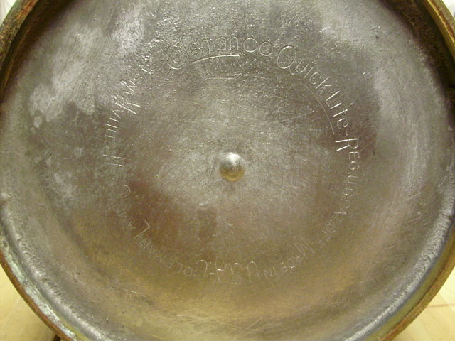

    Hi all, I'd appreciate some help in dating a Coleman CQ that arrived at mia casa today (bought it in France).
    I've looked through the Reference Gallery, but am a bit confused (maybe this lamp was assembled from different donors?). I hope to get this old Lady running again, and will post photo's.
    Short description; the bottom reads Coleman CQ Quick-Lite-Reg.US.PAT.OFF.Made in U.S.A.- Coleman Lamp Co Wichita Kansas. Seems like some founts had a hex nut in the middle? This one has no such. On the handle we find Coleman Quick Lite, Witchita Kansas U.S.A. and a number; 1074249. The burner has "PATENTED MAY 13-1919.

    Are their any numbers stamped on the bottom of the fount?

    No, there are no numbers on the fount, only text. The little I know about these makes me think it is an early one. Possibly the straight generator was a later replacement?

    We really need to see a picture of this lamp because by 1930 there were two different tanks being used with a variety of burner types and some have the "wong" base plate telling you that your Instant-Lite Coleman is a Quick-Lite and vice versa. By that time they are all dated so if your lamp has a stamped base plate then there will be date numbers. These are often faint and can be hard to find but they are there.

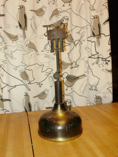

    As promised, a few photo's. I would like to add, the 'vertical toppart' of the burner has an "F" on it, doesn't mean a thing to me, might tell you something!!! :D
    1327520170-P1010029_opt.jpg 1327520187-P1010031_opt.jpg 1327520203-P1010032_opt.jpg
    Best regards,
    Wim
  16. David Shouksmith
    Very clever how you got your budgie to perch on top of it for the photograph... :D
  17. Wim
    Wim Subscriber
    926
    Dendermonde, Belgium
    He's well trained!!! 8) :content:
    Regards,
    Wim
  18. Mackburner
    Interesting picture. I don't think this is your average ordinary CQ. They are always polished nickel plated. Wih that fancy finish it is probably a CQF which is described as "Flemish Brass" finish. There is another, model CQG, which is described as "Antique Gold" finish. Problem here is we actually don't know which is which but I do know they are pretty rare beasts so don't clean that tank any more than you have to. ::Neil::

    Being Flemish my vote goes to "Flemish Brass" Neil! No cleaning will take place other than with a soft, damp cloth 8)
