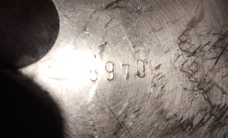

    Hipolito 502, fount stamp 8970:
    Base of fount is stamped 8970:

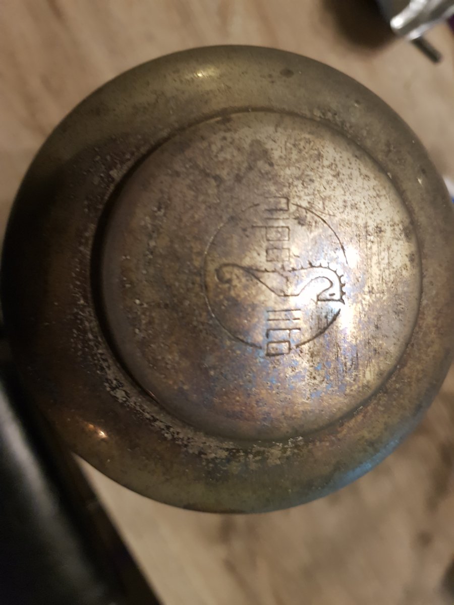

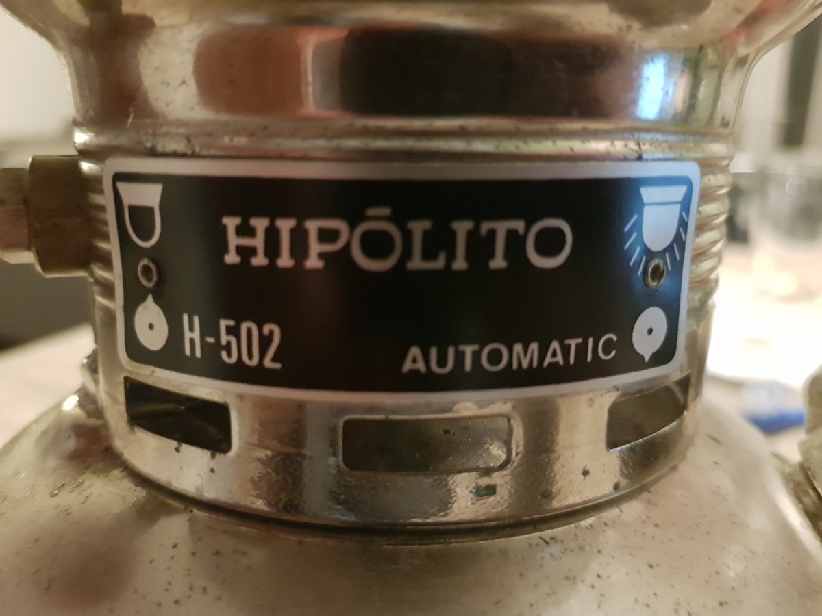

  4. Emiel Netherlands
    Dec 5, 2019
    171
    the Netherlands
    Hi Wim,
    Great idea!
    Best regards,
    Emiel

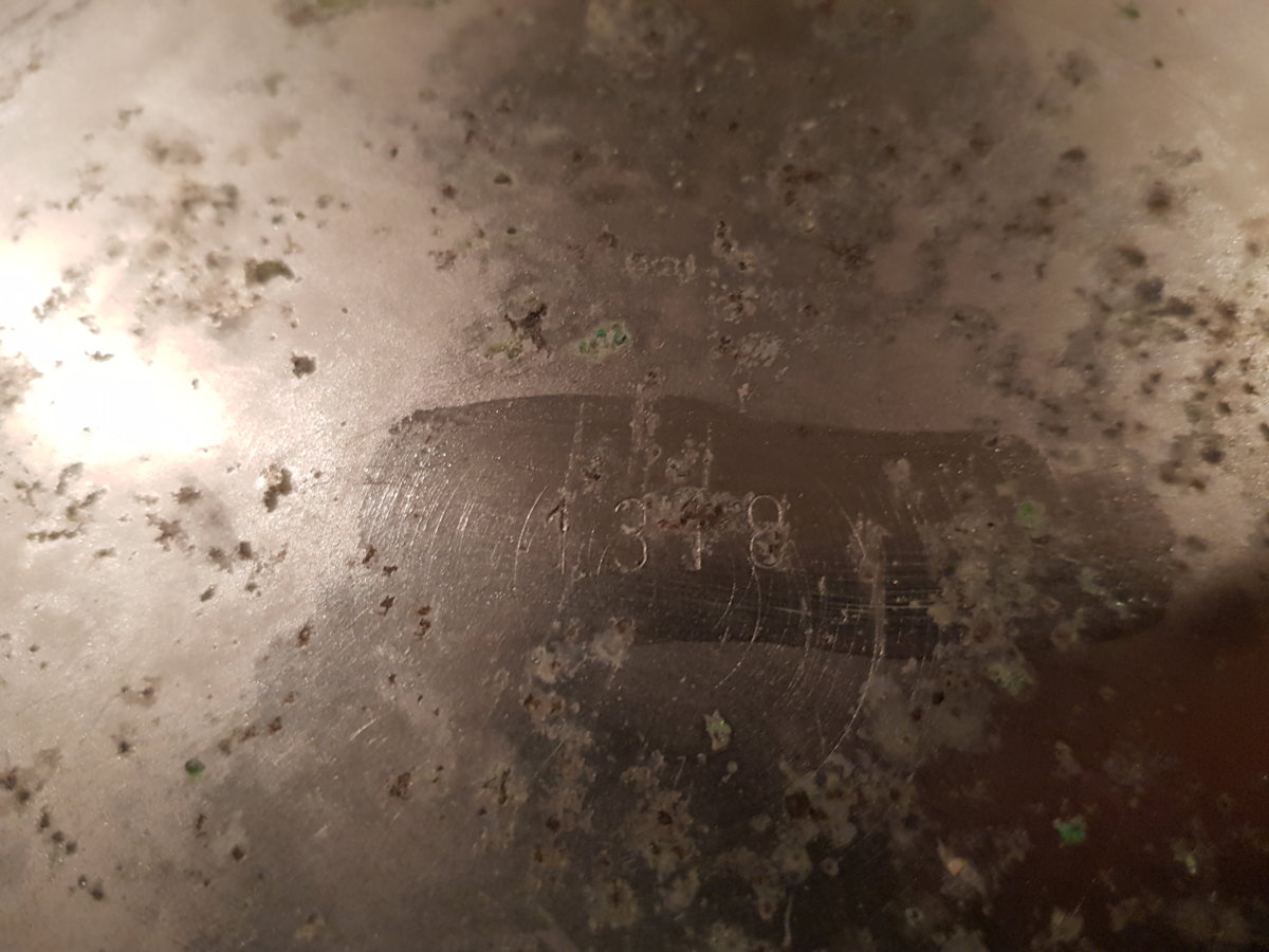

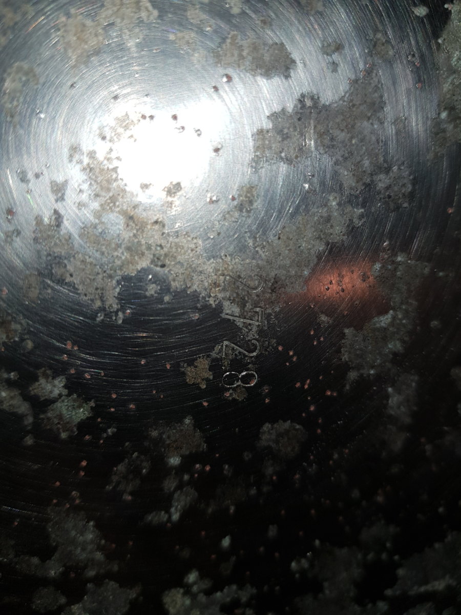

    Stamp in the tank: 1318

    Alex,
    could the 7 be read as a 4? Would be 0468 together?
    Matthias
  6. Alex Smith
    Jun 18, 2019
    974
    Central, UK
    @LatMag49 - I've just been and checked again. You are correct, 0468.

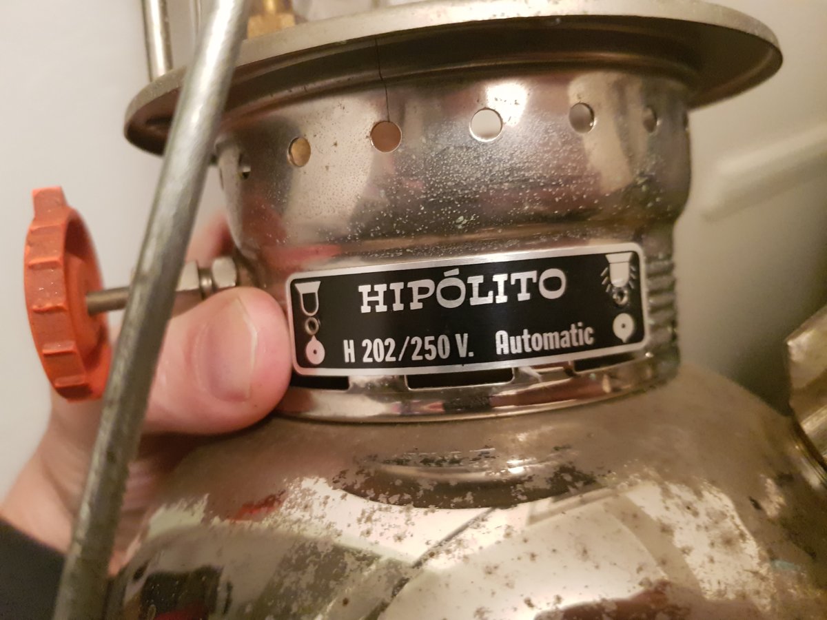

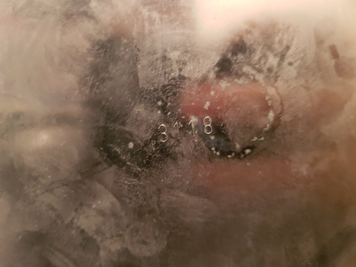

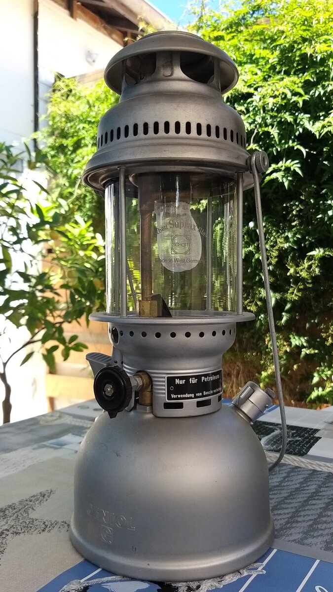

    Hipolito H202 with number 3118

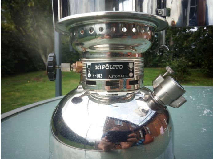

  13. dwillie United States
    Feb 17, 2013
    140
    Wisconsin, USA
    2 H500 Hipolito. 9022, and 9122.
  14. Scotlamp United Kingdom
    Sep 15, 2015
    228
    Kent UK

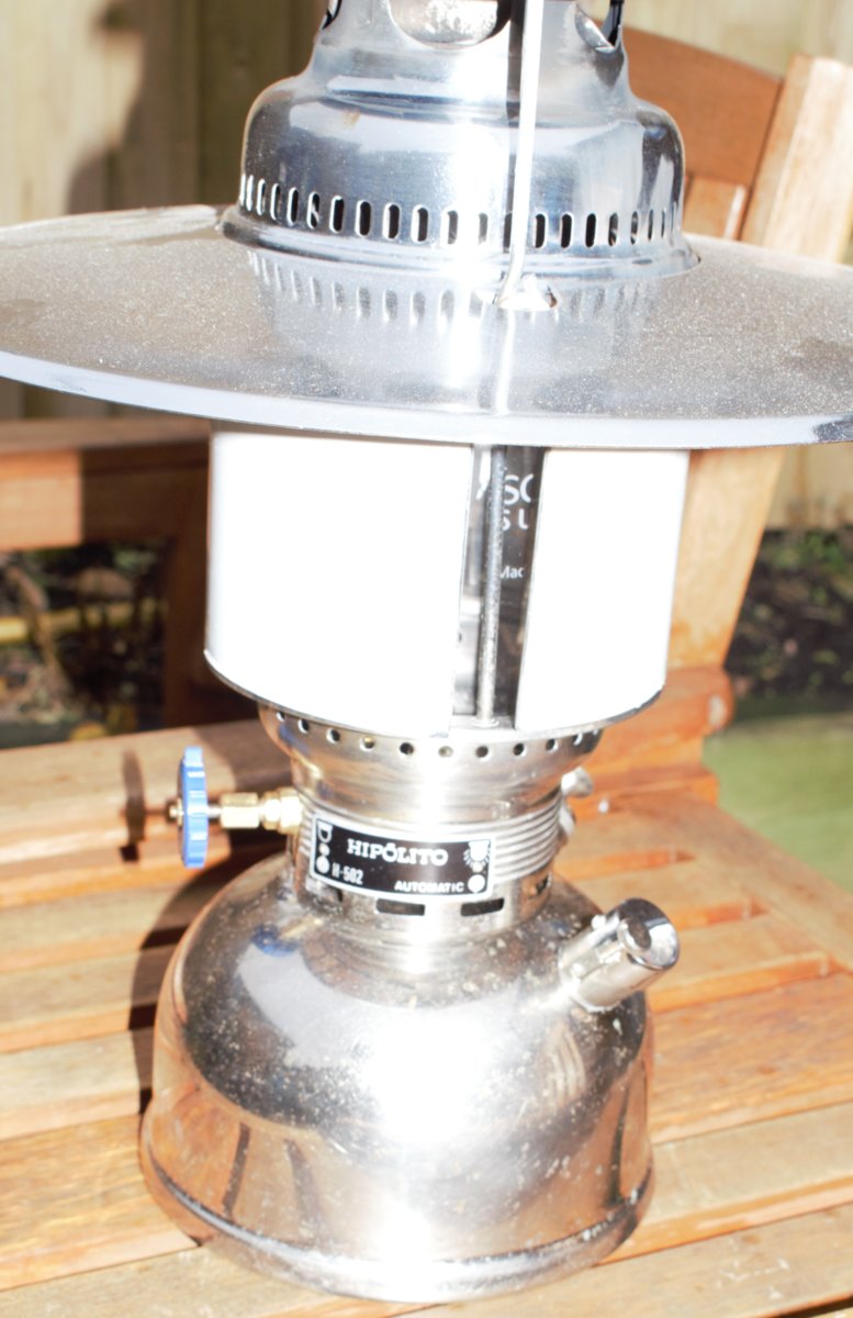

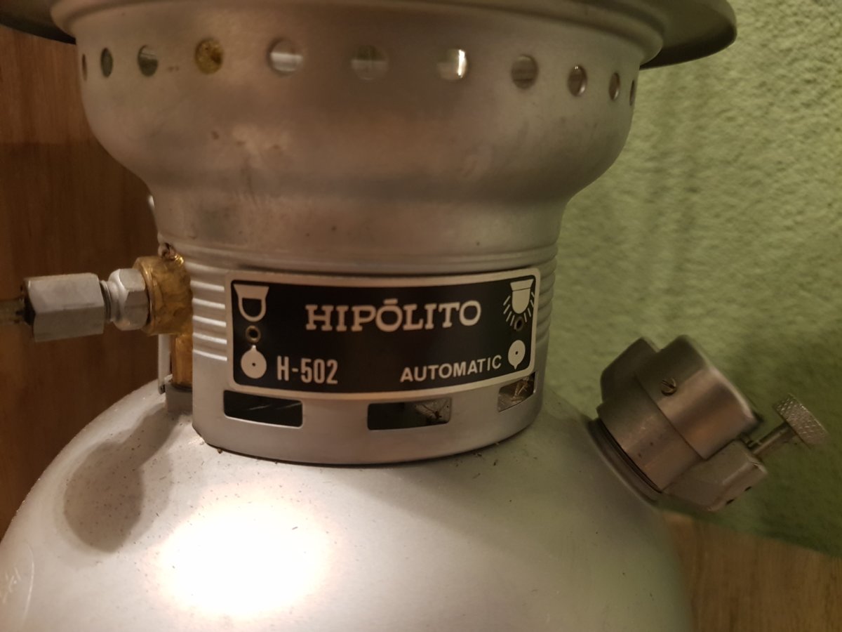

    Hi Good day to you all --Hipolito 502 H auto Number 9320

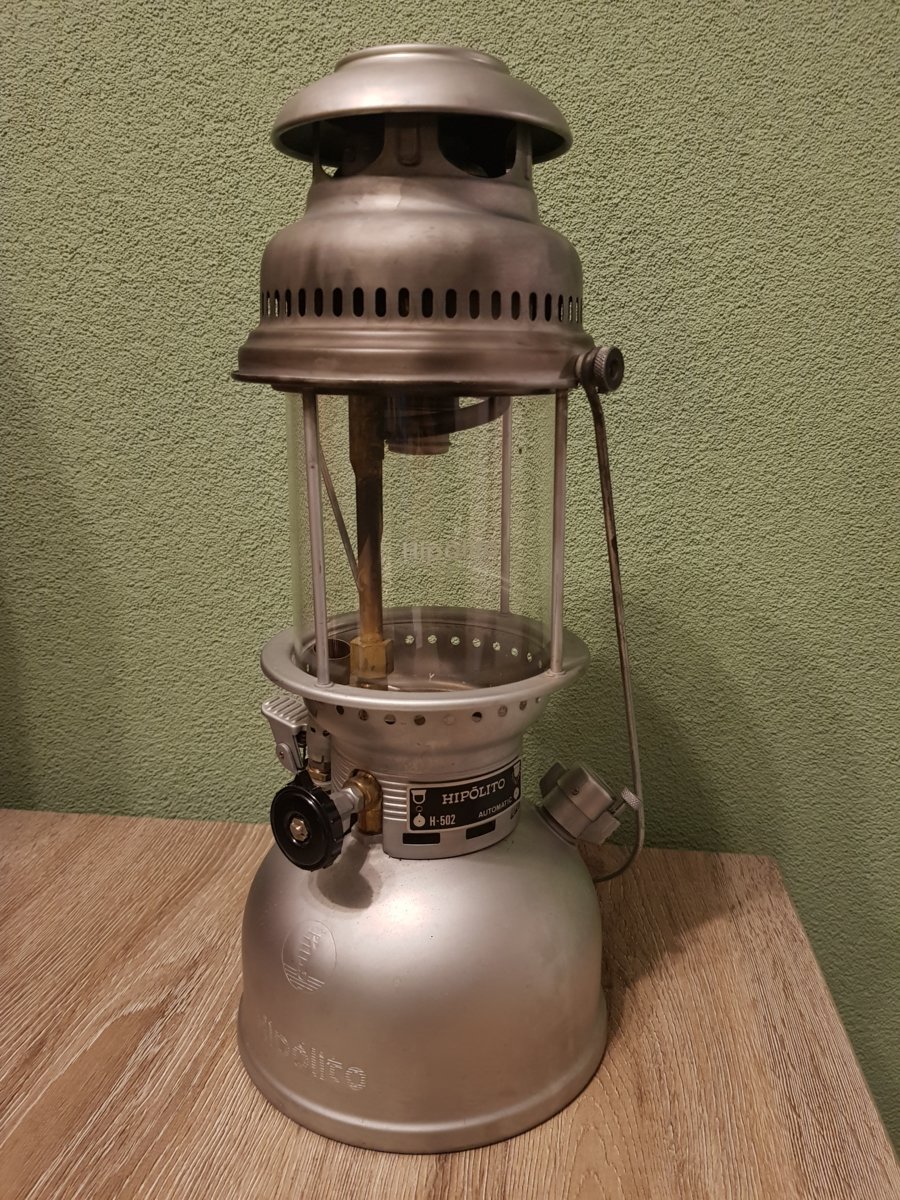

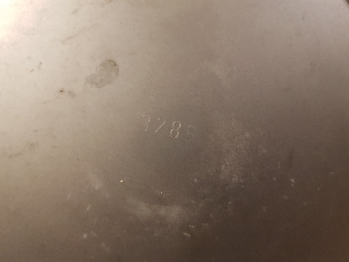

    Added yet another Hipolito to the stack. Number 3288

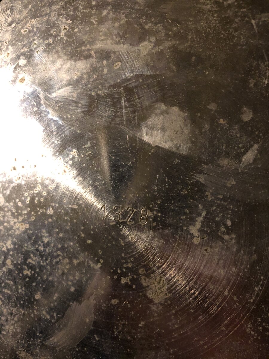

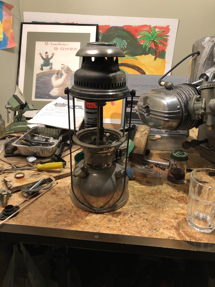

  21. Mike Goldthorpe New Zealand
    Sep 11, 2019
    1
    Auckland, NZ
    C9C8088A-027C-422F-B48D-D23F4EF4D4CE.jpeg My first post! I have just bought a Hipolito here in NZ. Number 1328 7D530316-AAC7-47BB-8FD8-532CD1E06FBD.jpeg

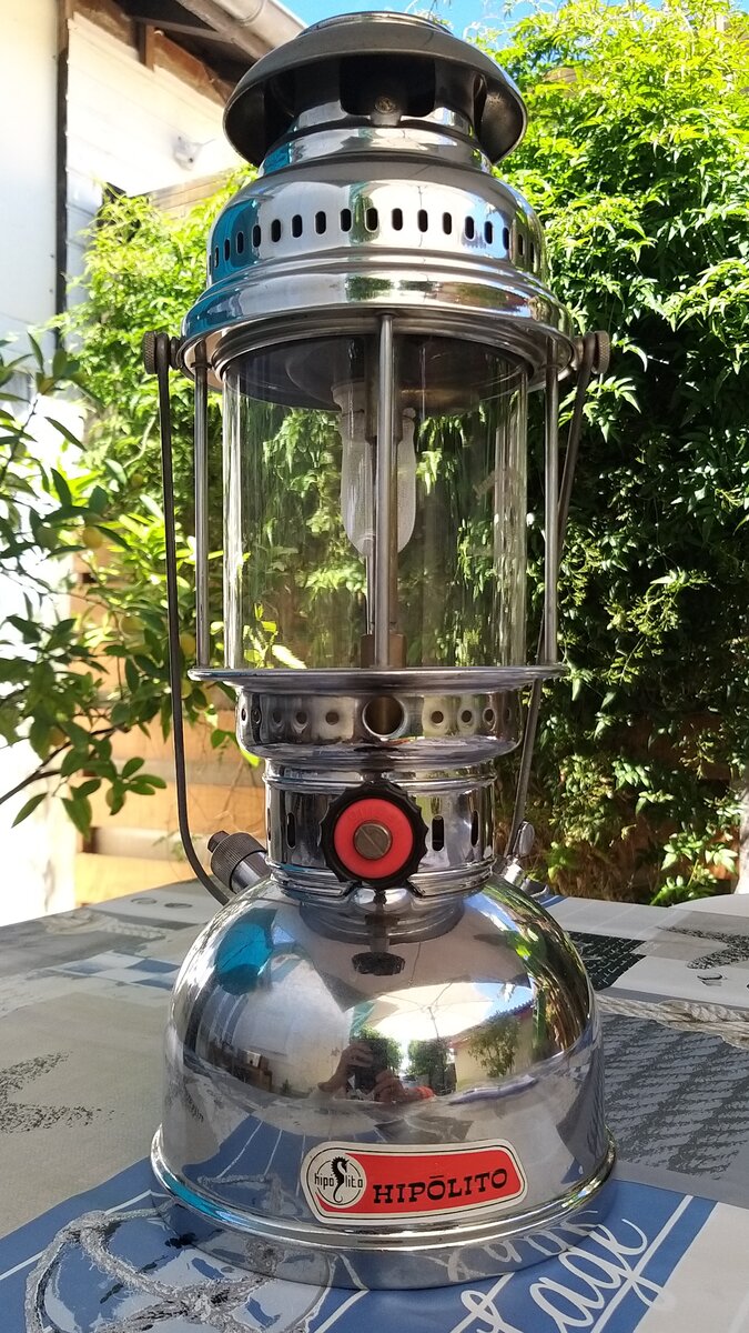

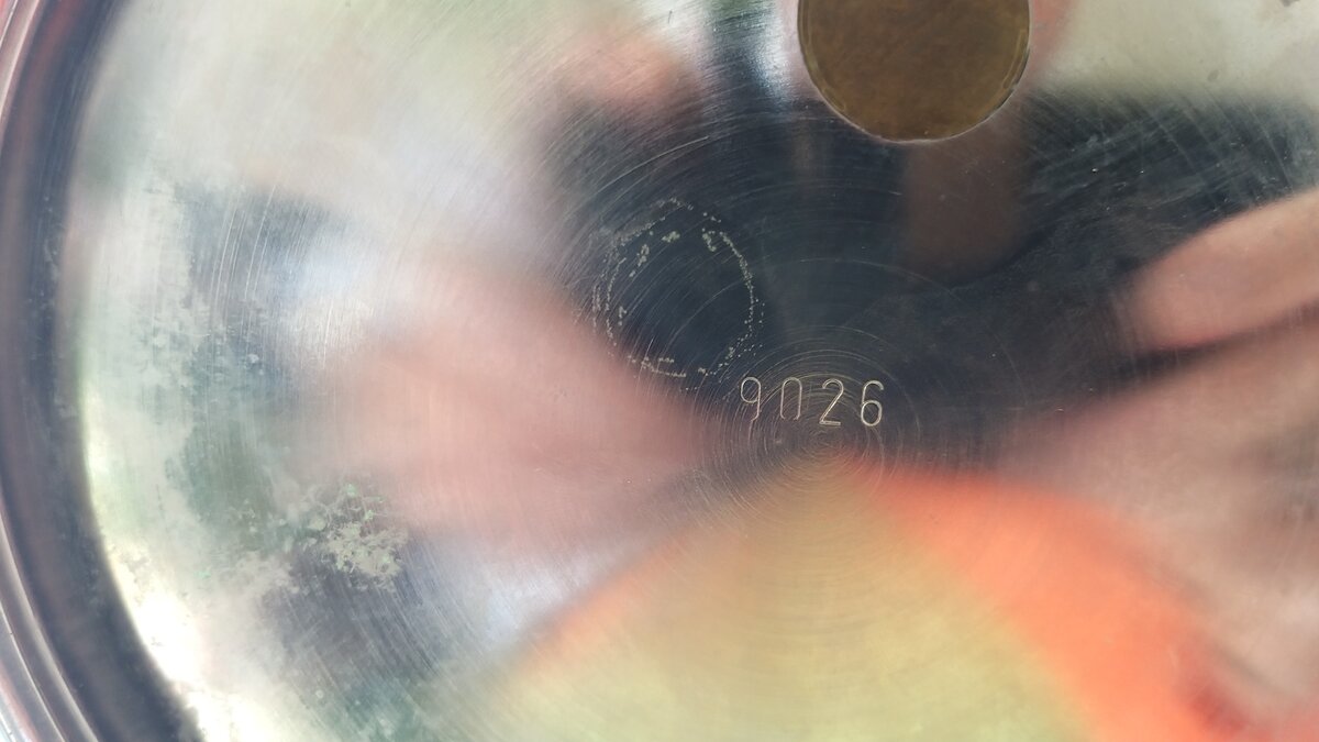

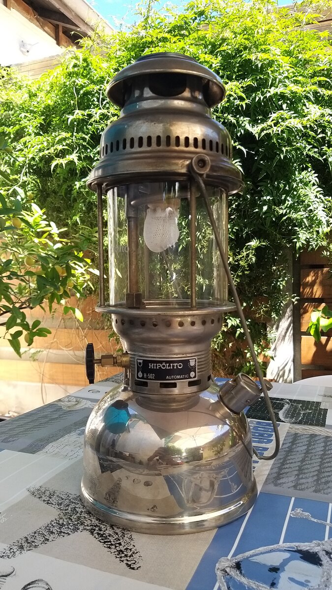

  22. Sellig33
    Sellig33 France Subscriber
    May 15, 2017
    1,049

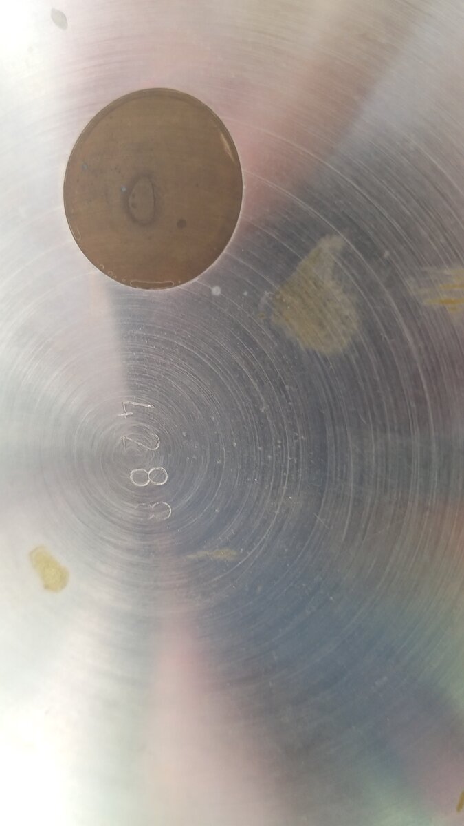

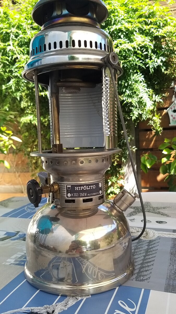

    20200630_122252.jpg 20200630_122358.jpg 20200630_122439.jpg 20200630_122509.jpg 20200630_122603.jpg 20200630_122643.jpg 20200630_122736.jpg
    H502 stamped 9026
    H302 stamped 4288
    350 without
    Géniol stamped 9134
  23. Reinhard
    Reinhard Germany Subscriber
    Oct 15, 2018
    1,085
    Hello collectors,
    I can easily read all 4-digit numbers of the pressure lamps manufactured in Torres Vedras Portugal from 1974 to 1999.
    I noticed that in 1989 and 1991 the numbers were stamped differently.
    However, it does not prevent me from reading out of the year of manufacture and the week in a matter of seconds without any problems. My problem is that I cannot prove it clearly.
    @Alex Smith 0468=1986 week 4
    @LatMag49 1918=1981 week19
    9501=1995 week 01
    @Emiel 3288=1988 week 32
    2728=1982 week 27
    3118=1981 week 31
    @Scotlamp 9320=1993 week 20
    @dwillie 9022=1990 week22
    9122=1991 week 22
    @Michel 9010=1990 week 10
    @Sellig33 9026=1990 week 26
    4288=1988 week 42
    9134=1991 week 34
    @Mike Goldthorpe 1328 =1982 week13
