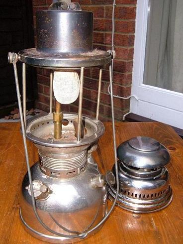

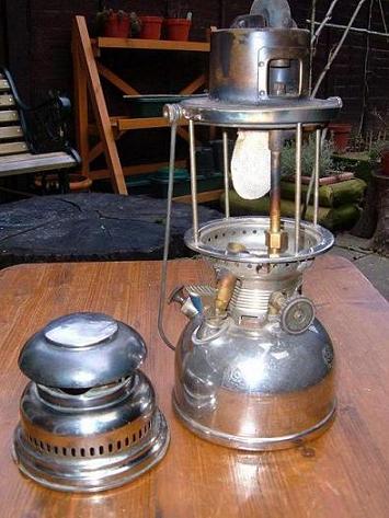

    Hi,
    Could anyone help with dating a petromax lamp that I,ve just aquired.
    It's an 829/500cp super Petromax Rapid.It has a G without the E in the middle of the crest stamp (althogh the glass has the E in the middle,And says Petromax special
    It has 0722 stamped on the bottom. The pump handle is black, as is the control cock wheel. the tank looks to be nickel plated on brass? although I'm not sure how much else is brass.It also says original, made in germany, and regd in a few places.It's in good nick although nickel plate on tank is abit pitted (can it be stripped back to brass or re-plated easily?)Its my next project, best make some room in the shed.

    Hi Michael,
    an image would help.
    Do not care for the logo on the globe - they are still made today with the E&G logo.
    Erik

    Thanks for reply,
    Tried to upload images, and for some reason after only tring one image Im being told that it exeeds the 97.66 kb limit,and one image is 710 kb.... I hate computers.Im probably doing something wrong but I'm not to clued up with technology ... thats probably why im into lamps, good old fashioned lamps.
    I'll try something else out.

  7. Matthias Germany
    23
    Hi Michael,
    i think it could be a 60´s. Then the 0722 on the bottom would say: 07th week, 1962, 2nd day (of the week).
    The pump handle and control wheel became black-brown over the years, new was blue.
    On later lamps from China there is only -Germany- instead of -Made in Germany-
    Mat
  8. Doron Papo
    Doron Papo
    Dec 2, 2010
    263
    looks like a nice original petromax from the 60's
    if you dont have the globe a coleman small cylinder will fit as well.
