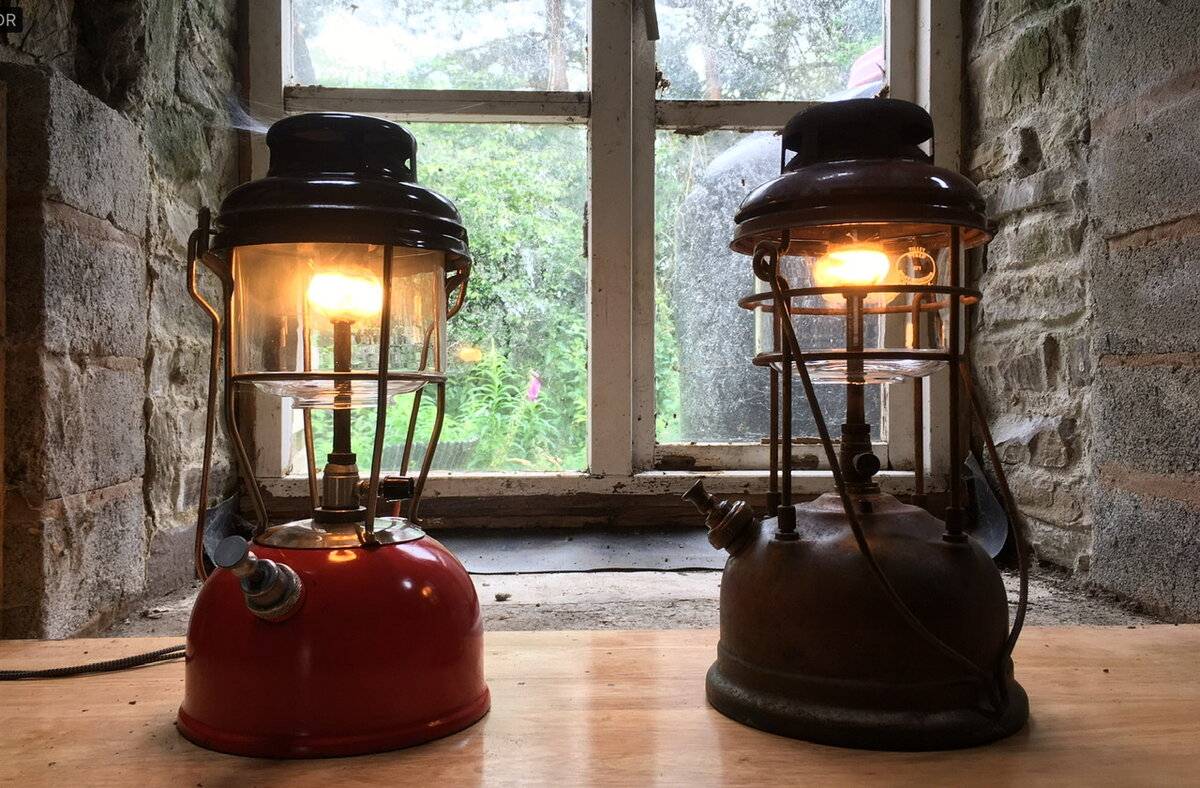

    Not familiar with Vapalux lanterns, I have previously fixed up a couple of Tilley X246Bs (?), (one a barn find, one picked up cheaply) and although I have not yet got it running, my first impressions are that the design and build of the Vapalux seems a little better.

  2. Fireexit1 United Kingdom
    3,539
    Your Tilleys are (red) X246b and an 2nd model X246 (known as the Guardsman)

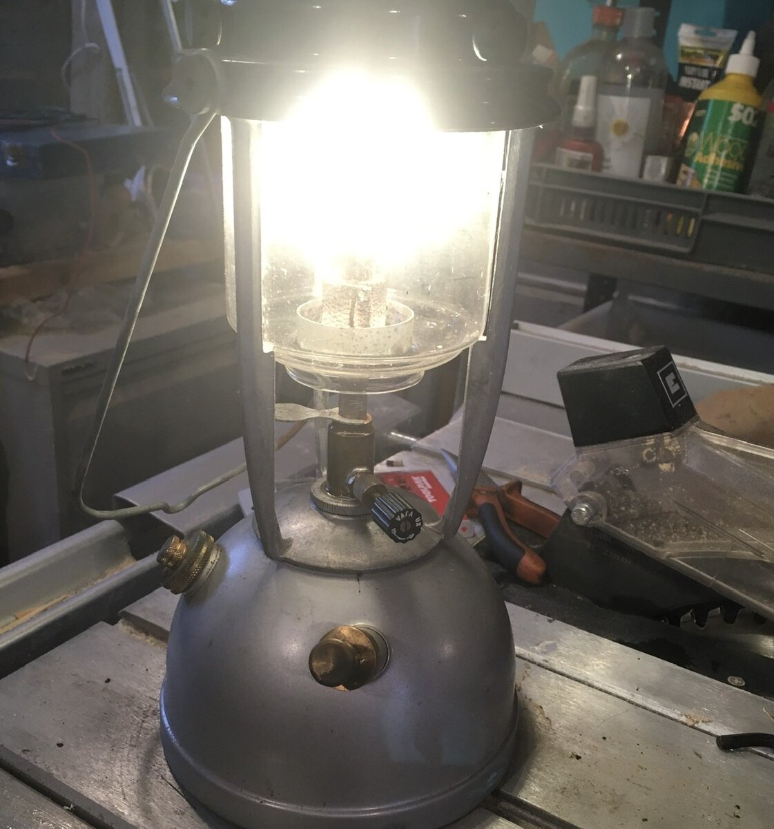

    Had a quick fiddle with my new (to me) Vapalux 320.
    The seals looked OK and despite the mantle looking a bit tatty, I put a bit of new fuel in it and it lit up without difficulty.
    I’ll get a new mantle and some new seals but looks good.
    As far as the finish is concerned, the paint looks original - the lamp came in a slightly soggy box and it looks like a barely used lamp that has spend severL years in a damp shed or garage.

  10. Fireexit1 United Kingdom
    3,539
    Looks like a good one ! - and it is silver now :) - it looked more purple in the earlier picture hence my comment about it being "aftermarket".
    You can see in the picture what looks like a small leak at the bottom of the vapouriser so yes a seal kit will be a worthwhile investment. The brass looks very unworn with no dirt in the knurling so I would guess that it has not seen much use. A real result as it fell into your lap :D/

  13. Lee K O’Ring United Kingdom
    Nov 23, 2021
    18
    UK
    @Fireexit1, eagle eyes on the “leak” and I will check again but I think that the paraffin around the base of the vapouriser may have been left over from when I was playing around with it before lighting it.
    I partially stripped it down and was going to wait for new seals before trying to light it but the lack of any obvious leaks and the nice jet from the vapouriser encouraged me to give it a go.
    Will order a seal kit anyway and new mantles anyway.
    Just plain silver but I guess purple would have been a popular 1970s option if offered!
    Very pleased!

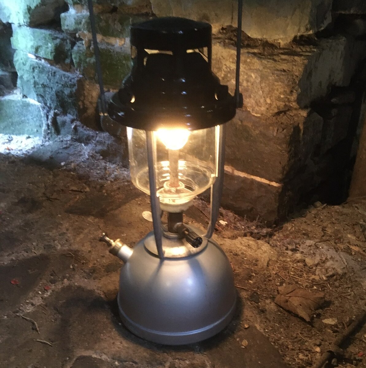

  18. Lee K O’Ring United Kingdom
    Nov 23, 2021
    18
    UK
    Postman delivered a refurb kit from Base Camp for my freebie Vapalux 320 this morning.
    All washers now replaced and new mantle fitted. Also gave it a good clean and filed off some sharp casting on the alloy “cage” and it lit first time with no dramas. :content:
  19. Fireexit1 United Kingdom
    3,539
    Looks splendid and will give you years of service. Hopefully it will be dry tonight so you can test it in the dark.
    Enjoy!
    Chris

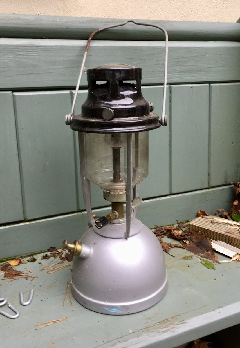

  20. M.Meijer
    608
    Netherlands
    Aha, another festive picture; well done! These 320 models are like Marmite: either you love 'em or you don't. I regard them as one of the most stand-out designs under the pressure lanterns and like it's odd appearance. I do believe the cast alloy frame is a unique
    feature, not used by other makers but shared of course by it's pre-decessor 305, 310 and 315 models. A wonderful addition to your growing collection, Lee!

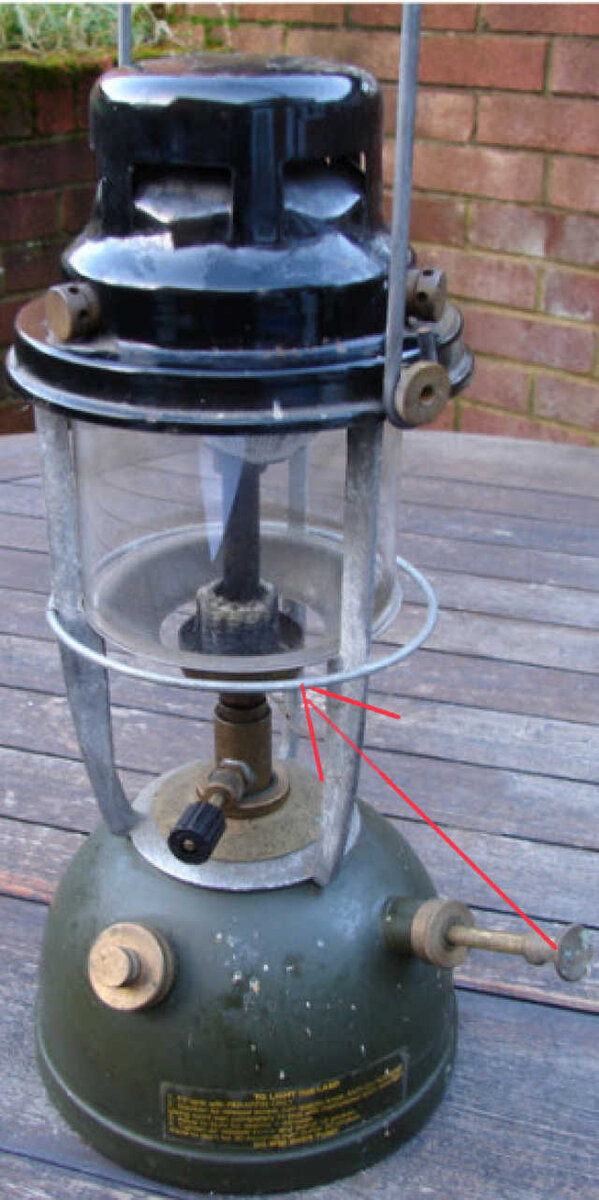

    Can anyone tell me the purpose of the wire circle attached to the frame of the vapalux M320 military model . I see so,E models without the wire and some with . Just something that I love to know and if someone else has the answer
    Thank you
  22. M.Meijer
    608
    Netherlands
    According to Ian Ashton, who collected most of todays knowledge on these lamps, this wire came along with the switch to short cylindrical glass supported by a metal disc, at the end of the nineties. Before that, the glas had this stepped bottomed 'bowl' shape since the introduction of the Bialaddin model 315, resting directly on cast notches in the alloy frame. Through the years W&B sought cheaper ways to produce these lamps, and using strict cylindrical glass was their last modification towards that end. It might have added some measure of protection. but I think this wire was also a design gimmick to take some attention away from this new cheapening.
  23. Jimmy Hayes Ireland
    Aug 5, 2020
    8
    Ireland
    Thank you for your reply and it is appreciated , but I’m still confused to what purpose the wire serves been wrapped around the outside of the lamp frame .been outside surely serves no purpose in protecting the glass or holding it in place as the main frame does this with short glass globe and the stepped globes . I have used the short globes on the standard 320 models and no need for wire around outer frame .
    Still baffles me why and what purpose it’s there for ….
  24. M.Meijer
    608
    Netherlands
    Surely? How else can you protect delicate glass than on the outside? Or do you mean the outside of the frame - which gives the same protection in principle. Sure, it is not like the venereable Tilley Guardsman, but since you are looking for a (possible) reason.... The other possibility I mentioned does not seem to get much merit either. And what are 'short globes'?
    Besides, no-one suggested this wire loop is for using (certain) globes. May I suggest making less of a point of this - not everything in life needs to - or can - be explained. Perhaps it is just a silly stand alone design feature. And, if you will spend time reading up on W&B you will find this tiny company from Halifax packed riddles and questionmarks in about every model they made.
  25. Alby
    Alby Subscriber
    Apr 2, 2018
    337
