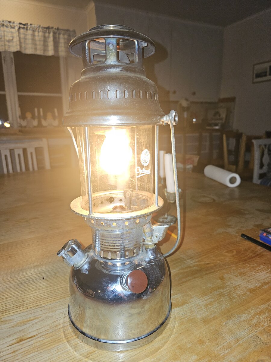

  4. kephart Sweden
    Jul 5, 2026
    26
    Stockholm, Sweden
    Looks good to me, but hard to tell if it is reaching 500cp. 20260808_224206.jpg

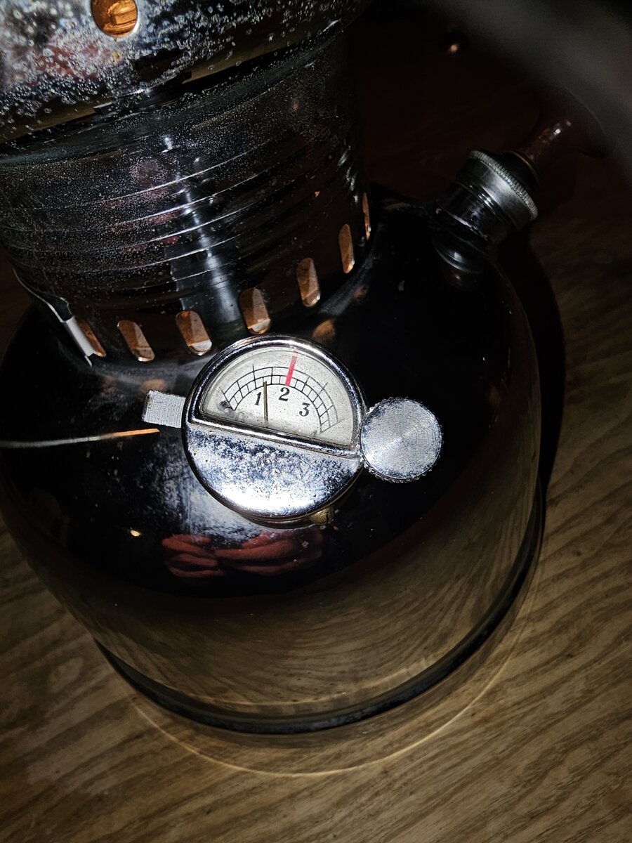

  5. kephart Sweden
    Jul 5, 2026
    26
    Stockholm, Sweden
