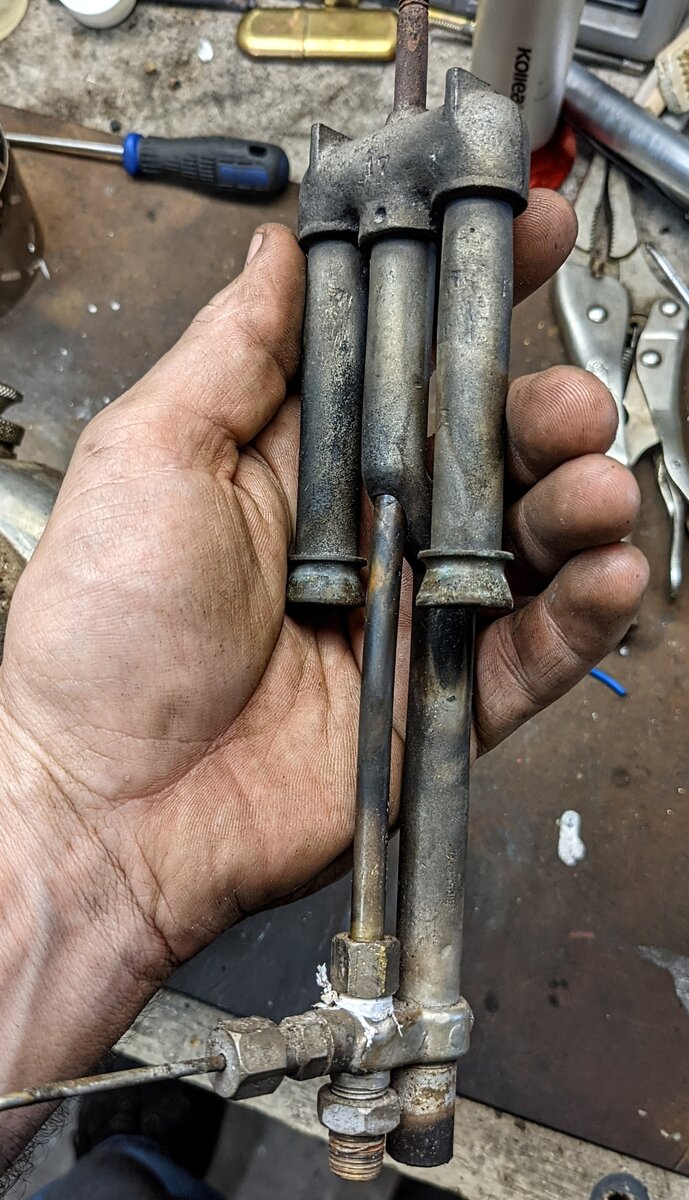

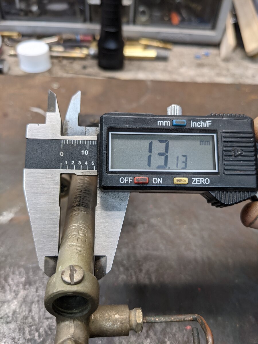

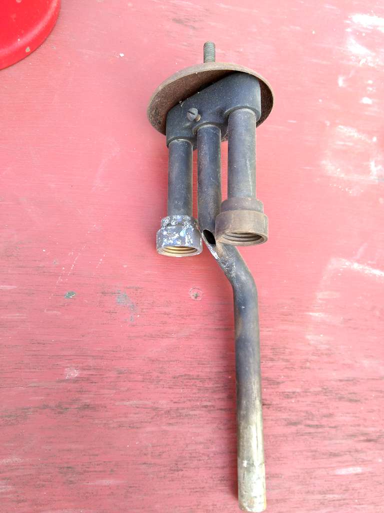

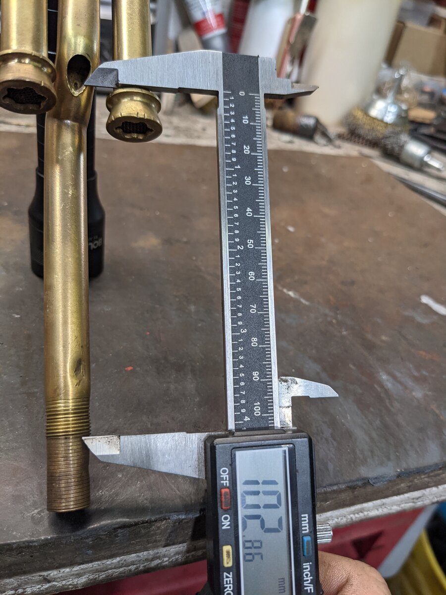

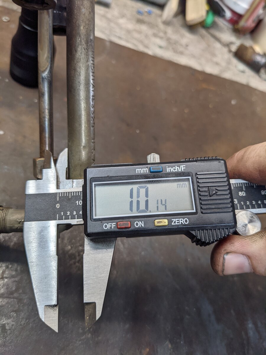

Erik I wasn't sure how your wanted the generator to air tube measurement? I went from the center of the gen to the leading edge of the air tube. A couple photos are of a lamp burner and another a 220/220C but they are nearly identical from one to another air tube wise. I assume you wanted the measurements in metric? Anything else let me know.
