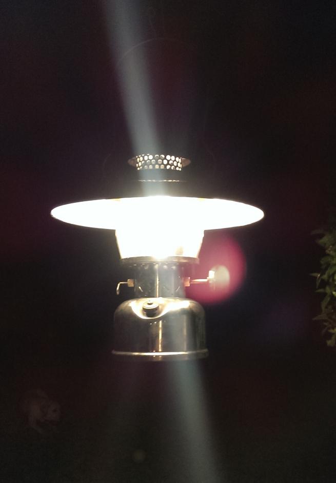

  4. phaedrus42
    phaedrus42 Subscriber
    2,056
    Playing ball with the puppy in the garden last night. 237 Empire with Optimus enamel reflector.

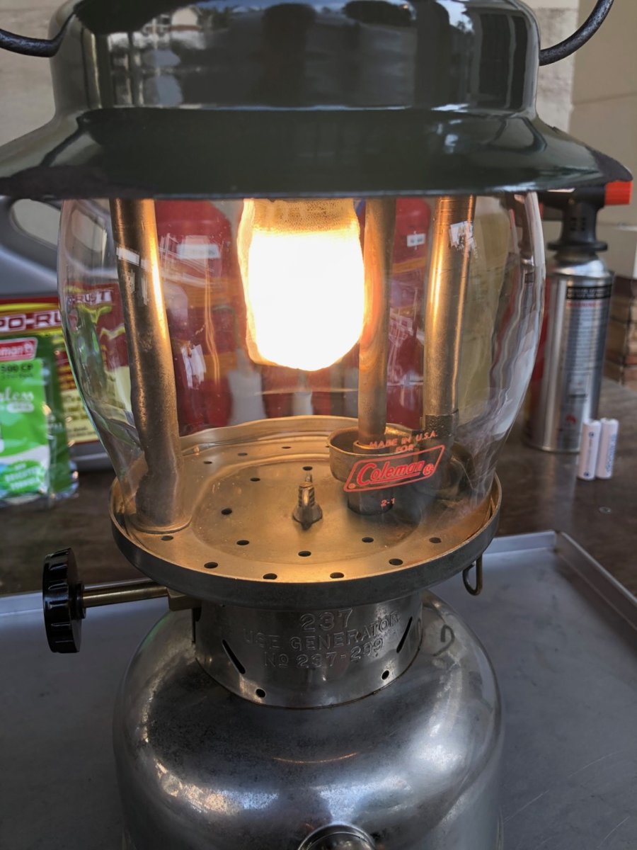

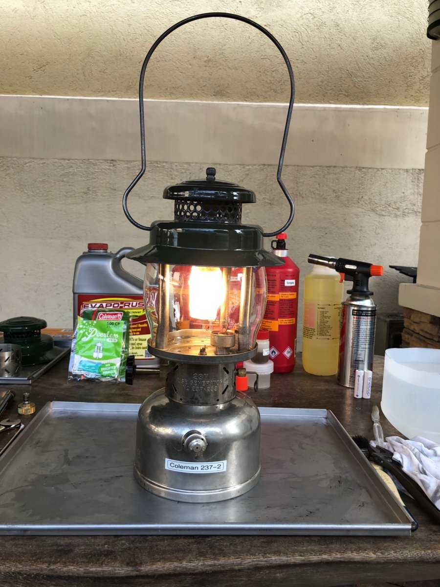

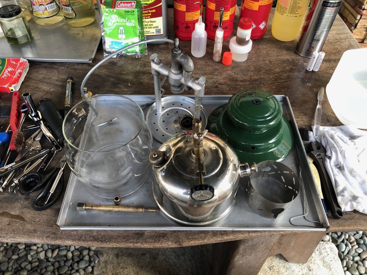

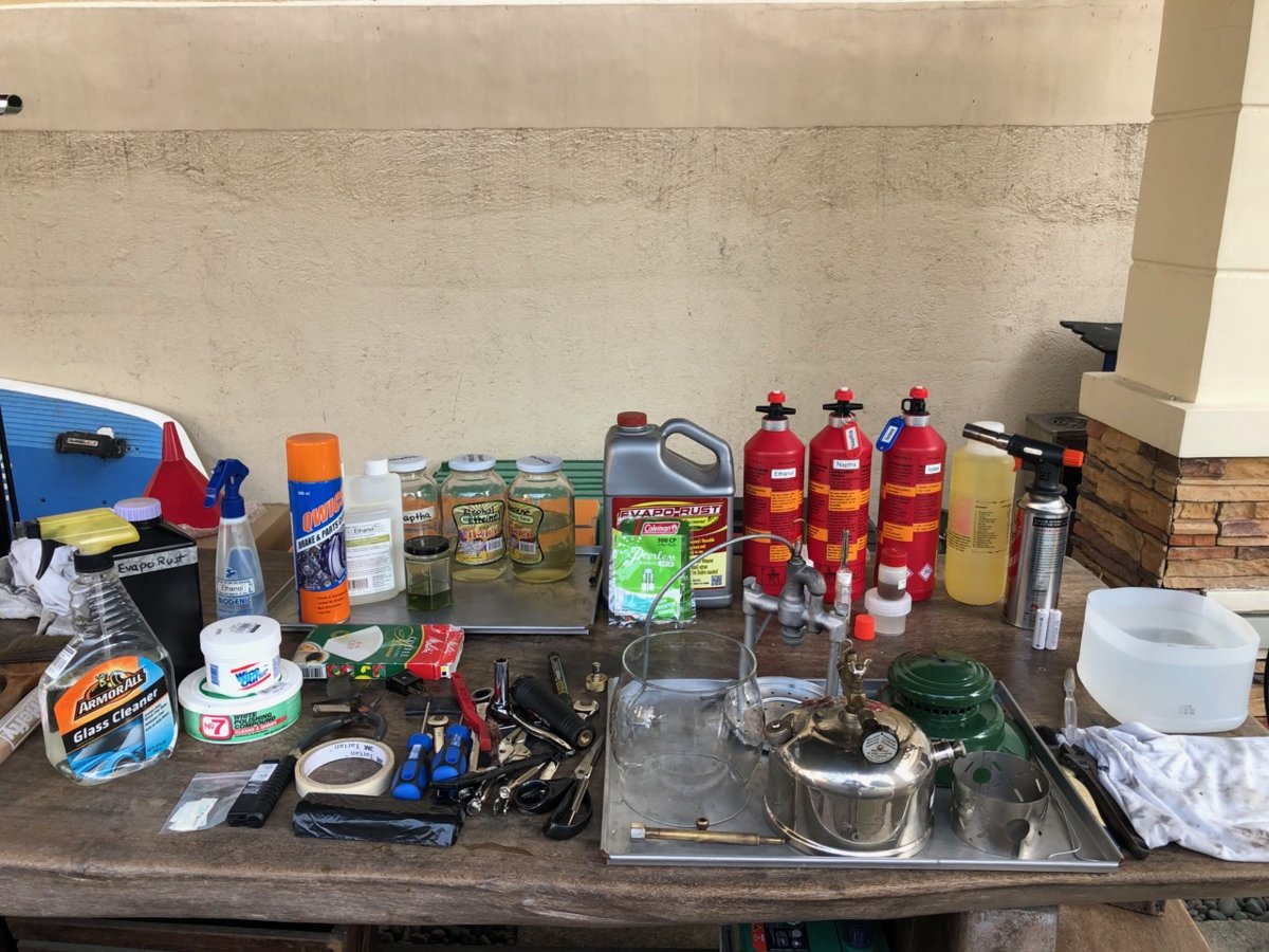

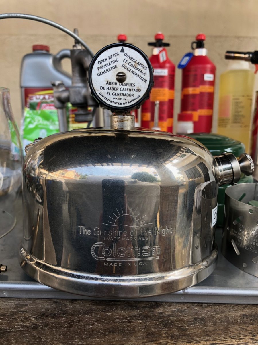

    I have successfully repaired 2 units of 237 in good working order. But later found out that one unit has a badly rusted fount which is now filled up with evaporust and waiting for assembly. IMG_2538.jpg IMG_2539.jpg
    Hi @AussiePete, here are pictures of the work in progress....

    Hi @toobs
    The 237 is looks good and is running well!
