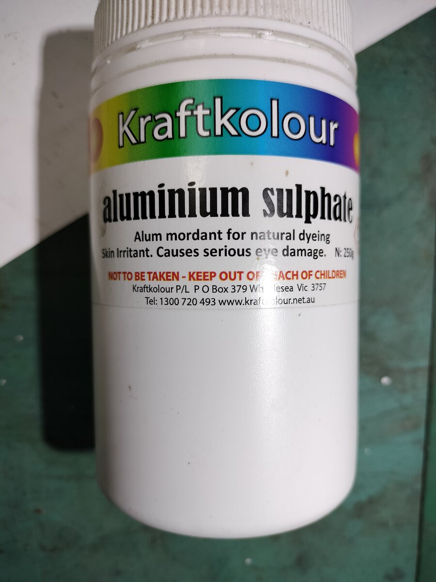

    Recently I needed to replace the vent stud on a late model Austramax Lantern. The stud had a broken sel-lock pin that had badly damaged the threads..
    I made a new stud and was drilling a 1/16" hole for the sel-lock pin when the drill snapped in the hole. I remembered this post and decided to give ALUM a try.
    I used Aluminium Sulphate at the rate of one table spoon to 100ml of water.

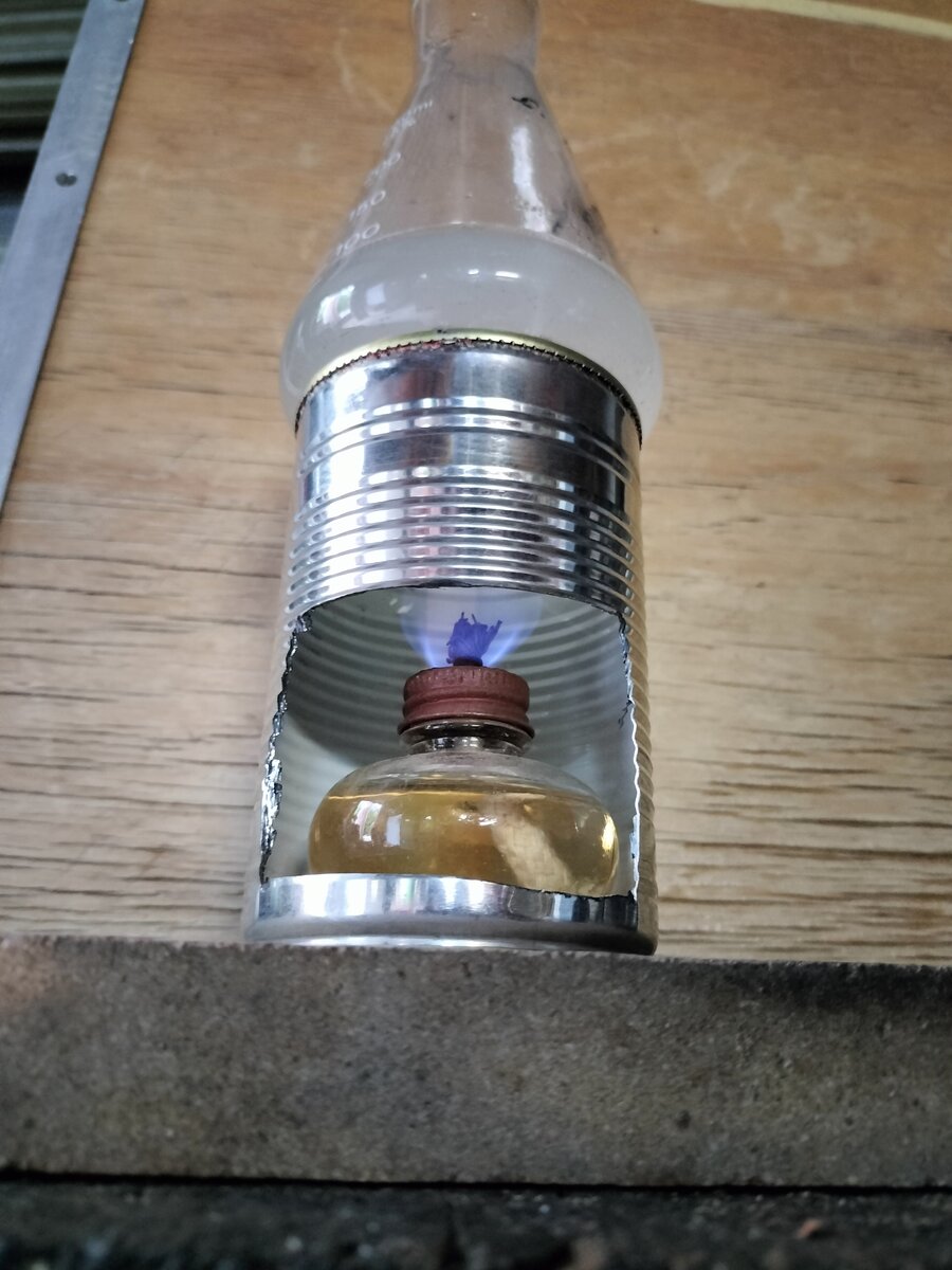

    I used an ethanol burner in a can to keep the liquid simmering.

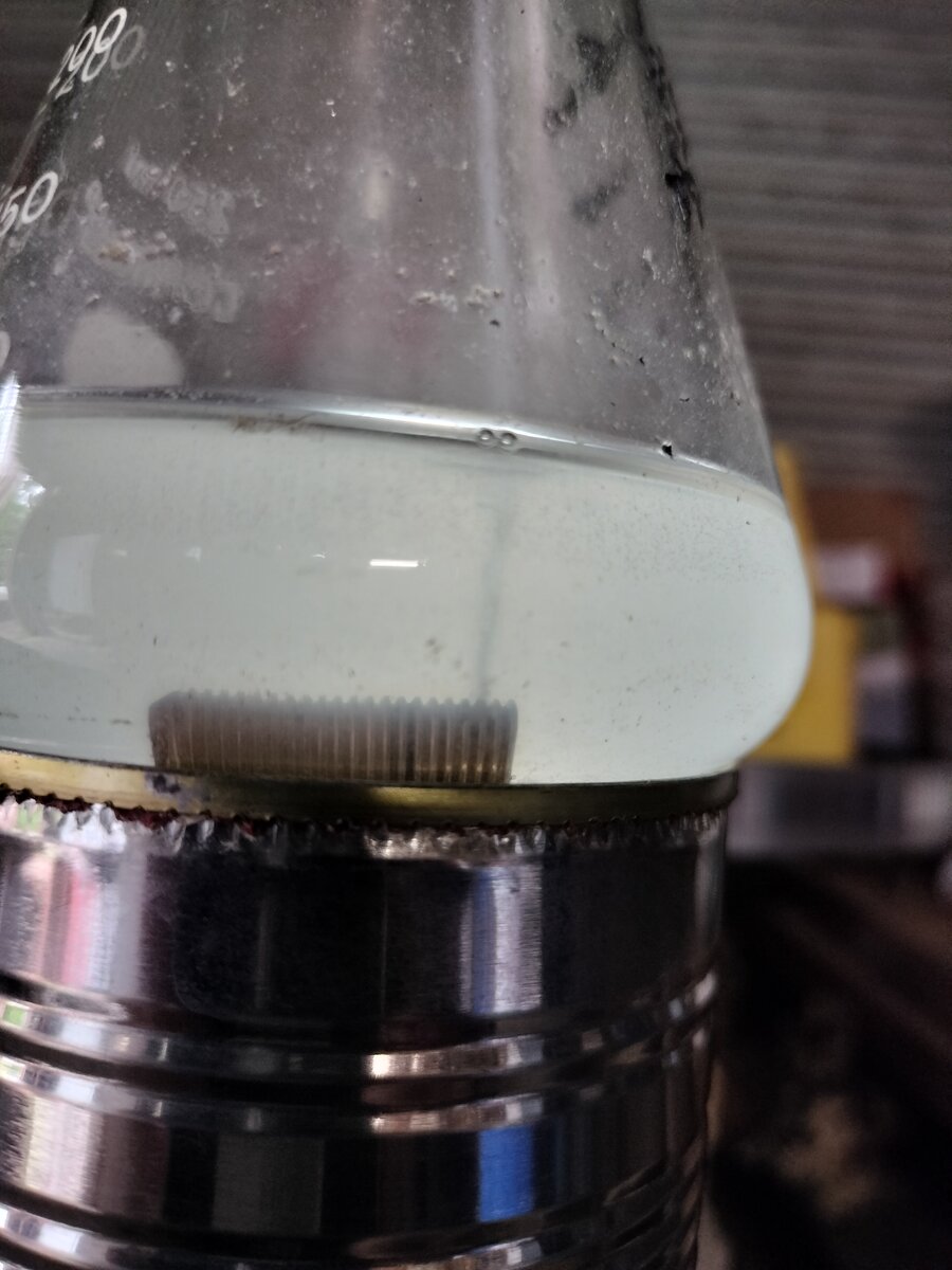

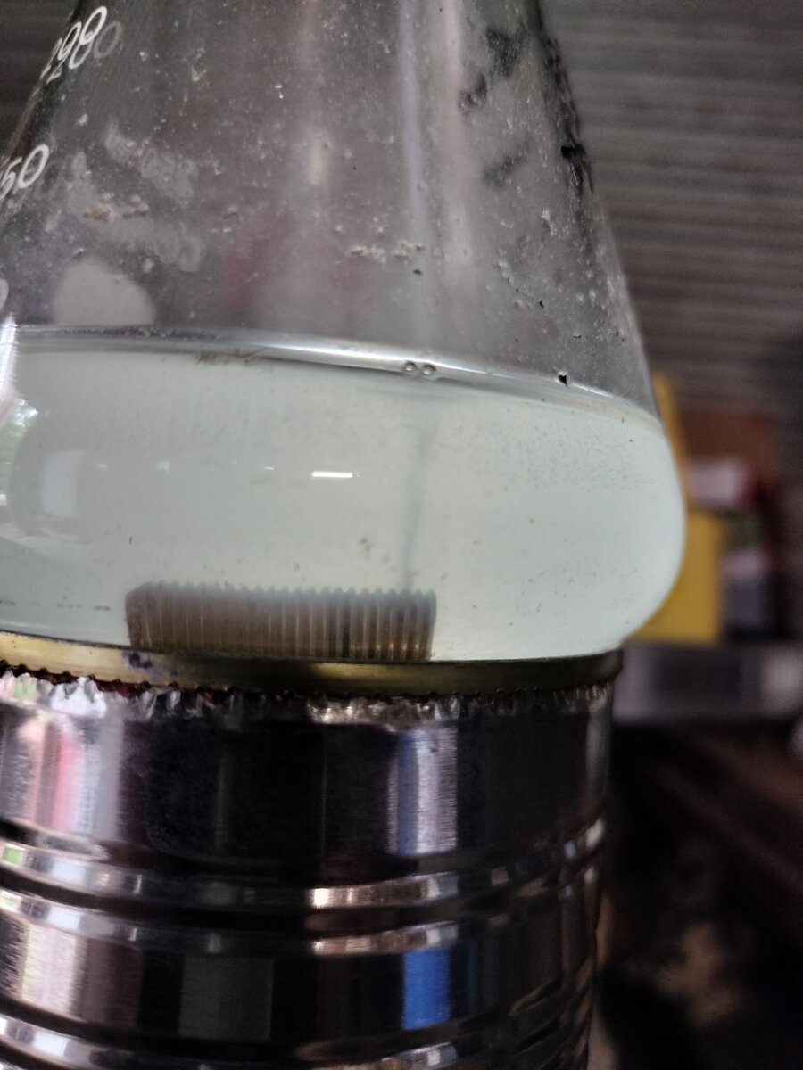

    Here you can see bubbles rising from the drill tip in the hole.

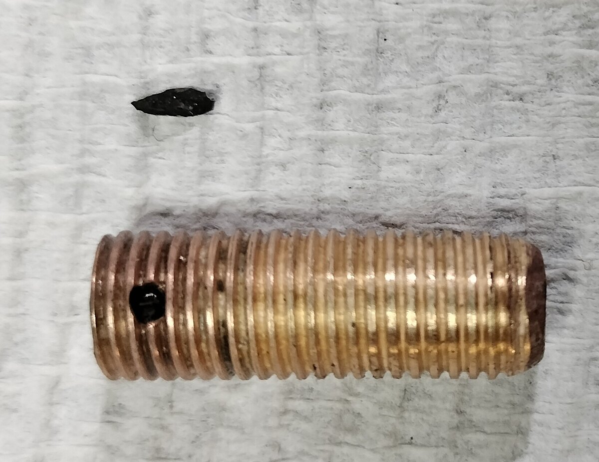

    After an hour simmering the corroded drill tip fell out. The brass was not affected.
    Success.
