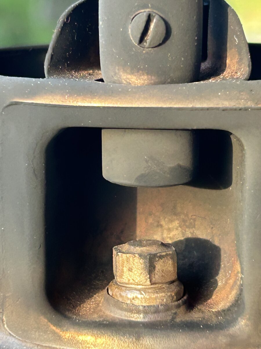

    I would like to see the J-tube with the small set screw.
  10. WimVe
    3,524
    Some pictures of the whole lantern may help also.

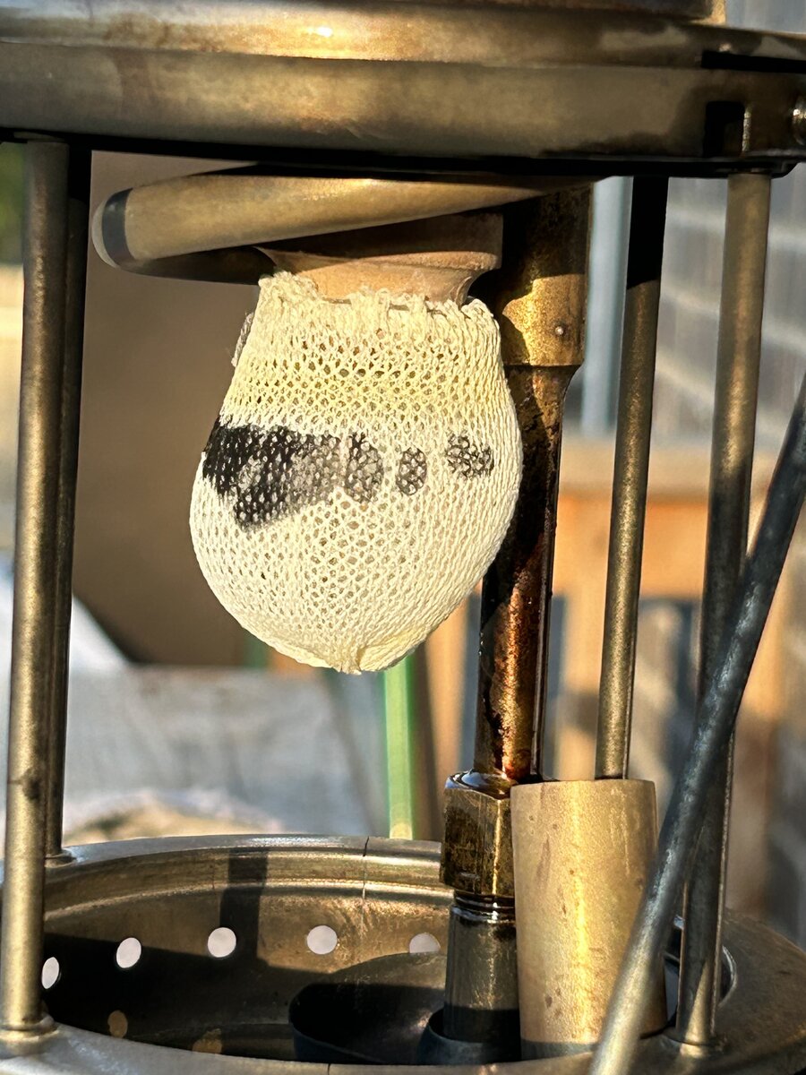

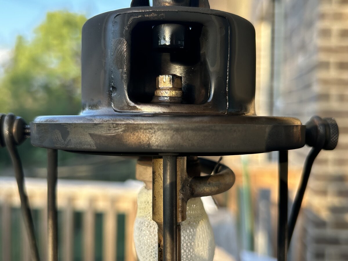

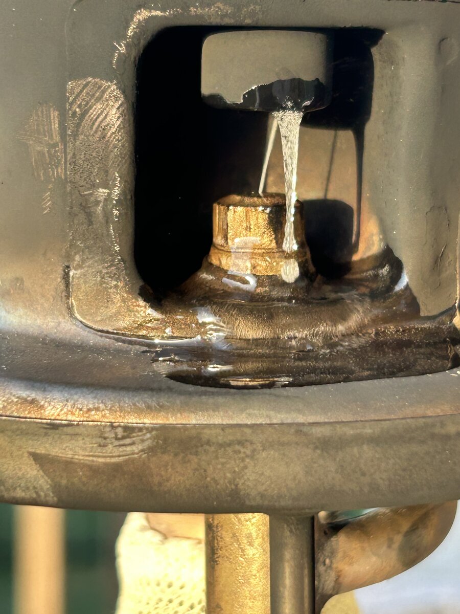

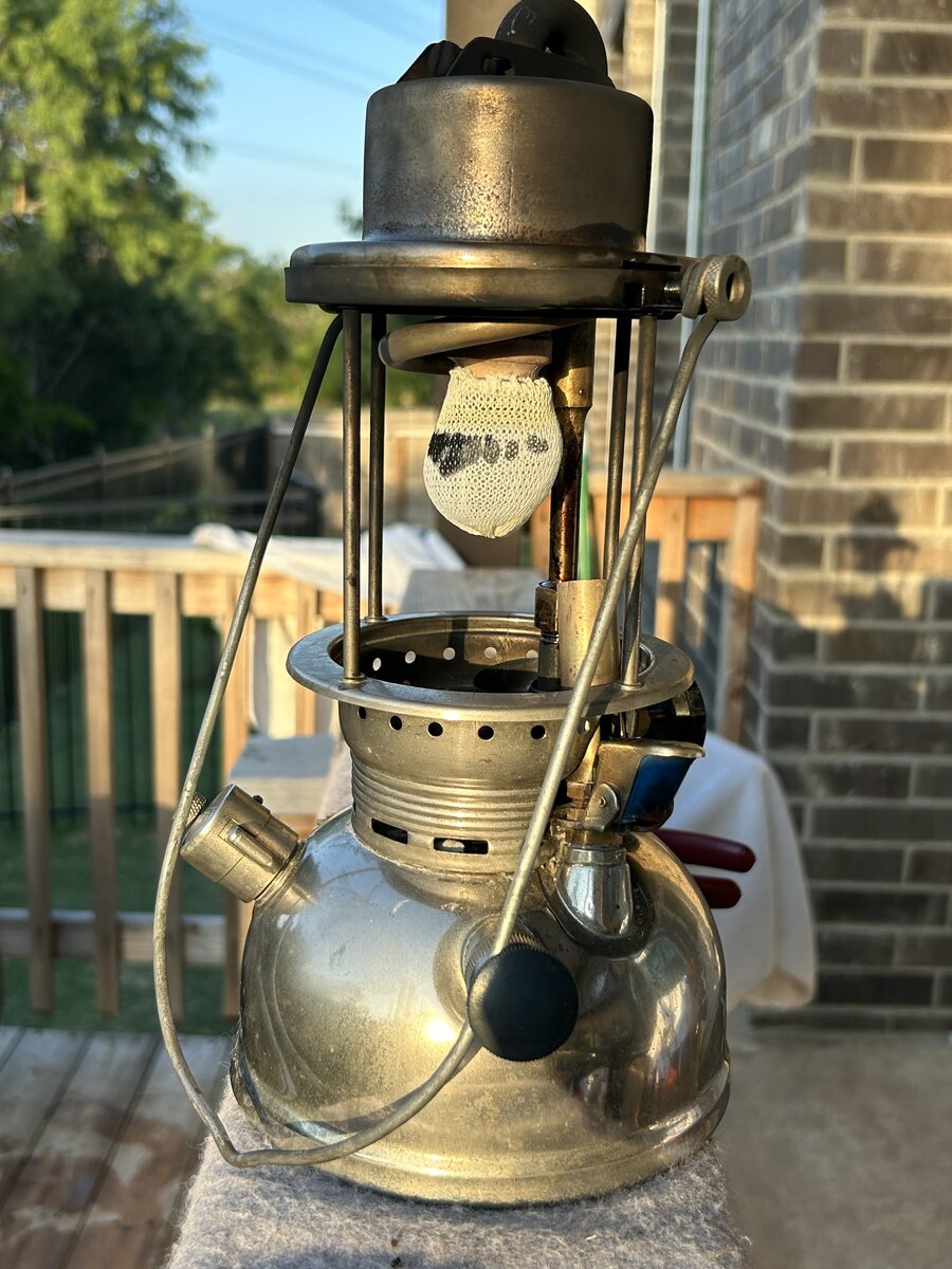

  11. hansblix1 United States
    Jun 2, 2024
    21

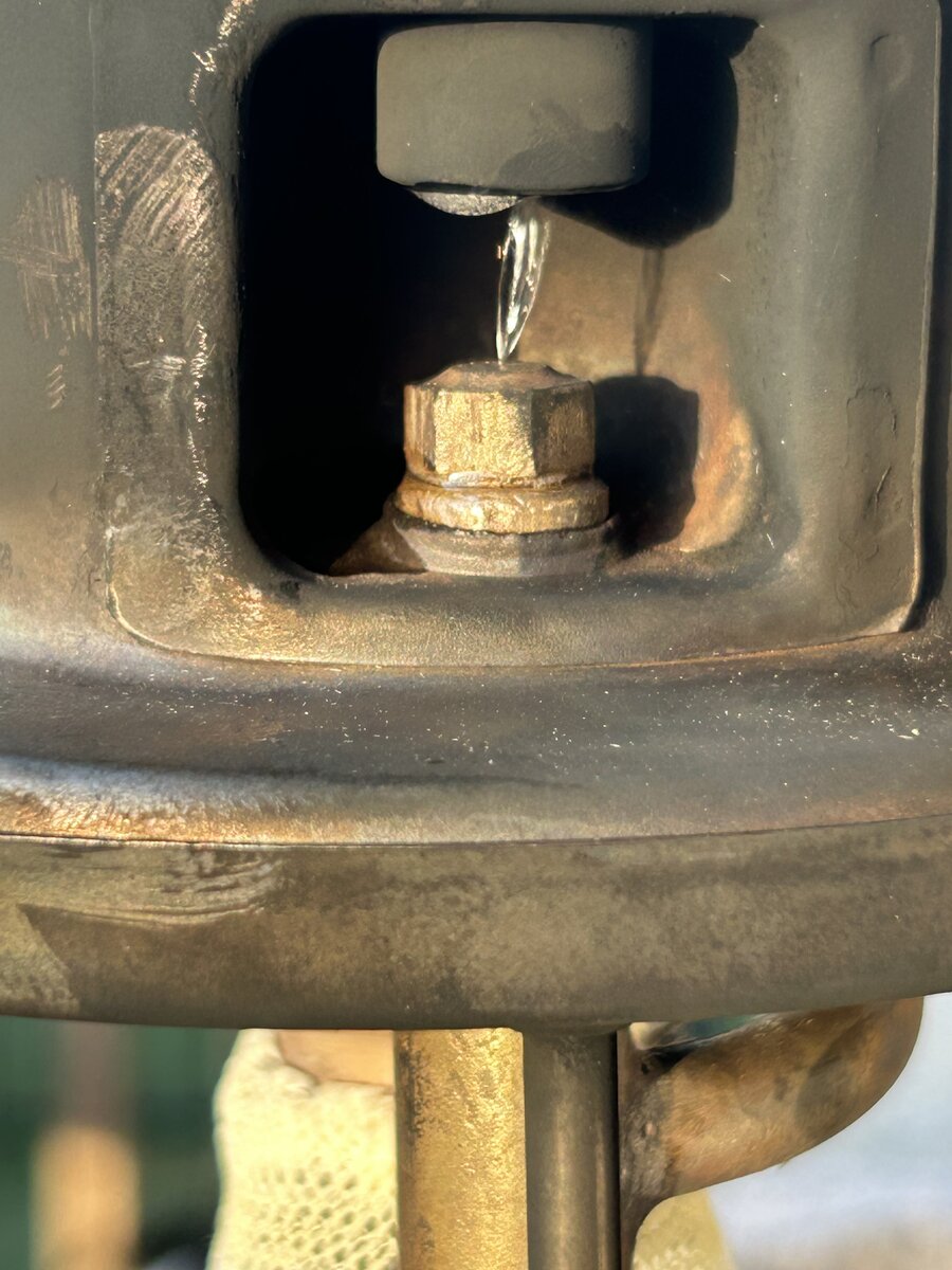

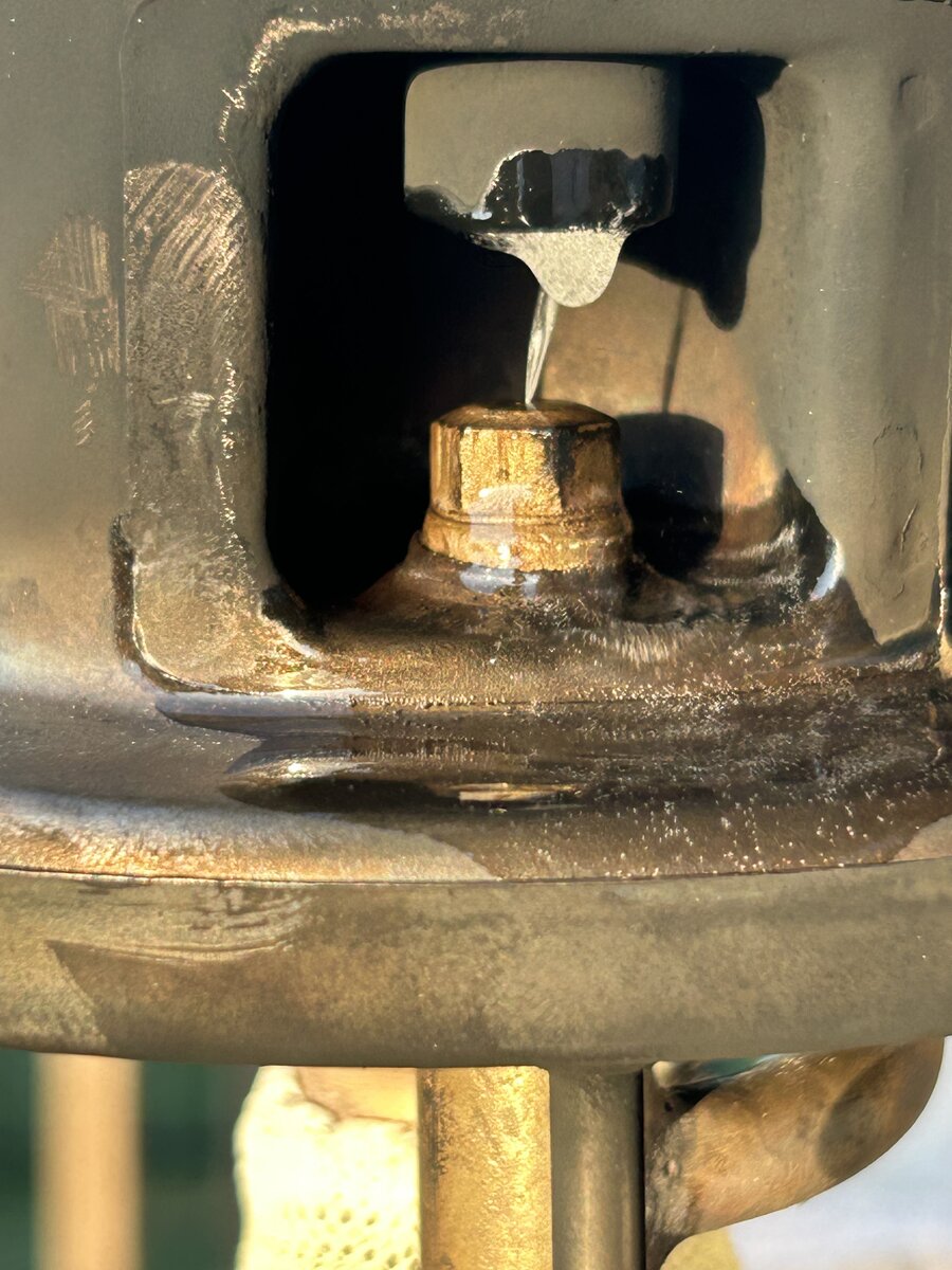

    Hello and thank you for responding - much appreciated. I've attached photos as requested.
    Please know the following:
    J-Tube (mixing chamber) distance has been at maximum, middle, and minimum distance, all with no change. The lantern burns bright white (as desired) without the outer ventilator attached, but burns red/orange/black with large flames when the outside ventilator is attached.
    The Mixing chamber screw for the paddle is vertical, as in photos.
    Changed the needle (new needle), and I have tried many different distances for the needle relative to the nozzle (jet).
    I have changed the nozzle/jet (new), I use Kerosene fuel, and Petromax Superior Quality 500 mantles.
    Of note - the fuel from the nozzle comes out at an angle (see photos), but the kerosene still arrives in the mixing chamber.
    I'm very happy the lantern burns as desired (even without the ventilator attached). This is my first full restoration of a Petromax, so my expectations are not high! :lol:
    Thank you again for your kind advice.
  12. Fireexit1 United Kingdom
    3,518
    Hi - how very odd. Well it does need to throw the fuel more or less directly upwards. I am wondering if the needle is not dropping fully away from the jet. Some of the aftermarket needles are longer than the originals. If the needle is not fully retracting from the jet then it may well throw things off course. Once the preheat is done it will be gas when it comes out, but lots of orange flames means liquid coming out normally.

  14. Fireexit1 United Kingdom
    3,518
    Well you can prove it is not the needle by running it without one. Another thought is that you may have a small crack on the generator that allows fuel to escape. Worth a careful look? Also maybe switch the jet back and see if it also goes sideways?
  15. Martin K.
    Martin K. Subscriber
    Sep 20, 2013
    1,147
    The fuel stream to me makes the impression that the jet is worn. Try to use a new one and a new needle which is properly rounded at the top. Some of the new needles are simply pinched off with pliers and have sharp burrs that destroy the nozzle.

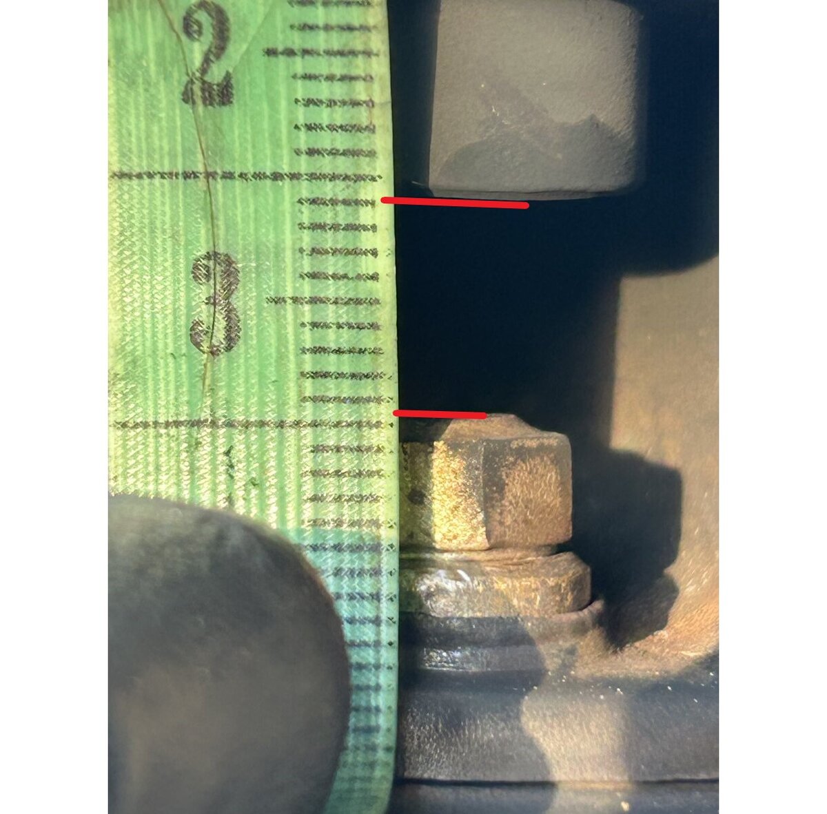

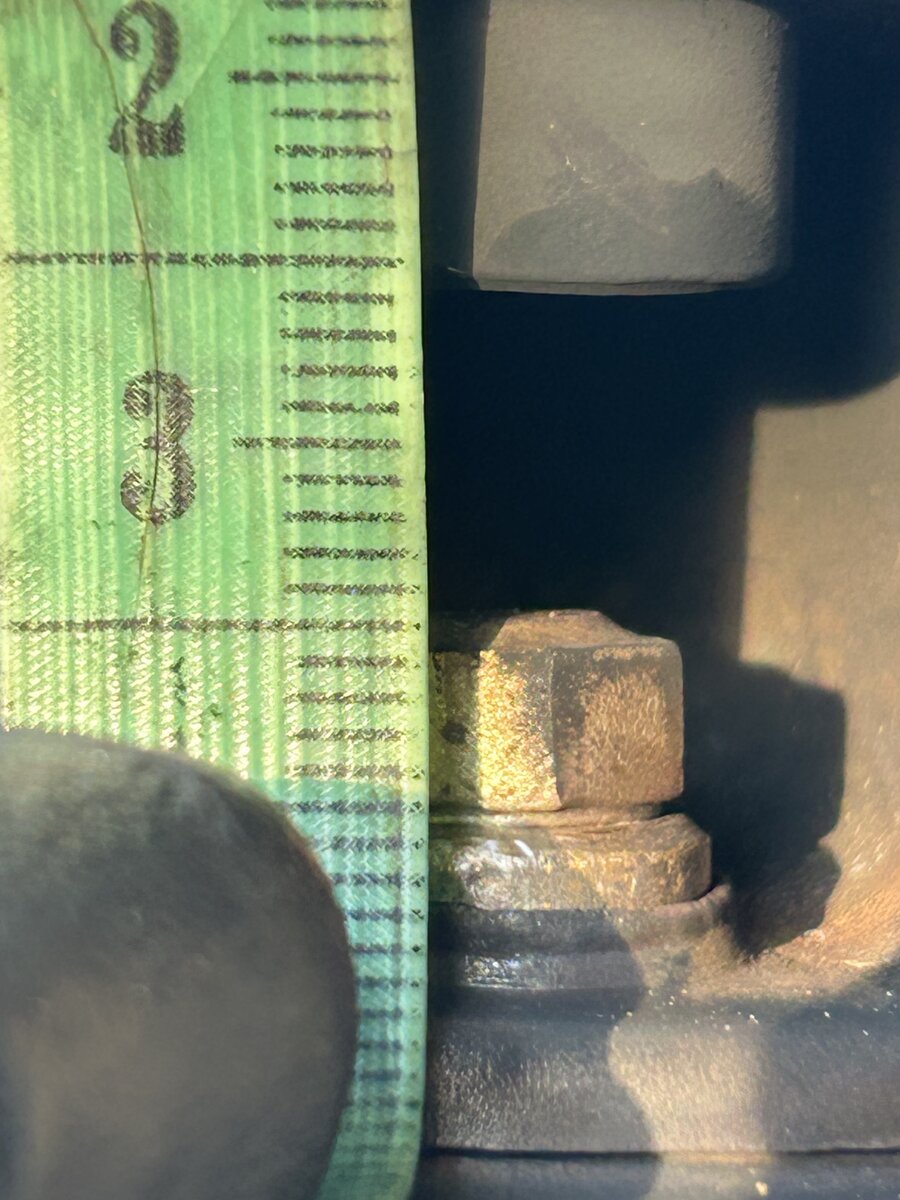

  16. Henry Plews
    3,034
    Was that before or after you took this image which clearly shows the air gap is only 8.5mm ?
    Cut a piece of card or use a half inch (=12.5mm) drill bit to measure the gap between the two points indicated.

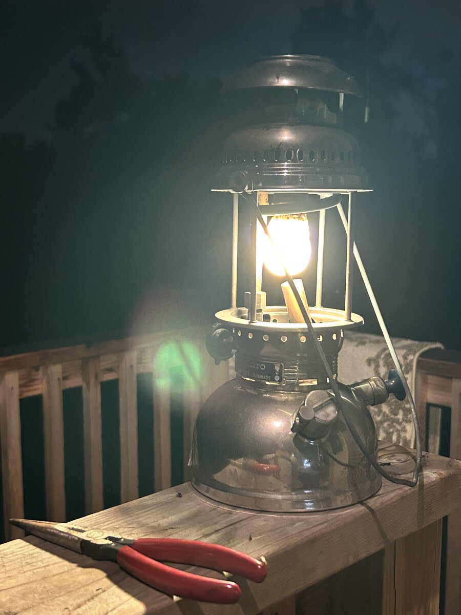

  18. hansblix1 United States
    Jun 2, 2024
    21
    Many many thanks to all of your kind support. Since the last post, I moved the mixing chamber/J tube back to 12mm, but all else unchanged (had a new needle, new jet already). I lighted the lantern this evening, burning bright white --> put the ventilator on. Burning bright white WITH the ventilator. Only other change is that there is absolutely NO WIND this evening whereas previous burns was in moderately windy whether.
    Again, I thank you all for your generous contributions. Feels great to finally burn this beautiful PMax 250 properly!
    Thanks!
  19. Fireexit1 United Kingdom
    3,518
    Kicking myself here for not realising you are missing the globe (glass) - this is important as you now know it stops the wind messing up a) the flame b) the pre-heat c) the airflow and lastly d) stops insects crashing into your mantle and breaking it.
    Now you know it works you should invest in one !
