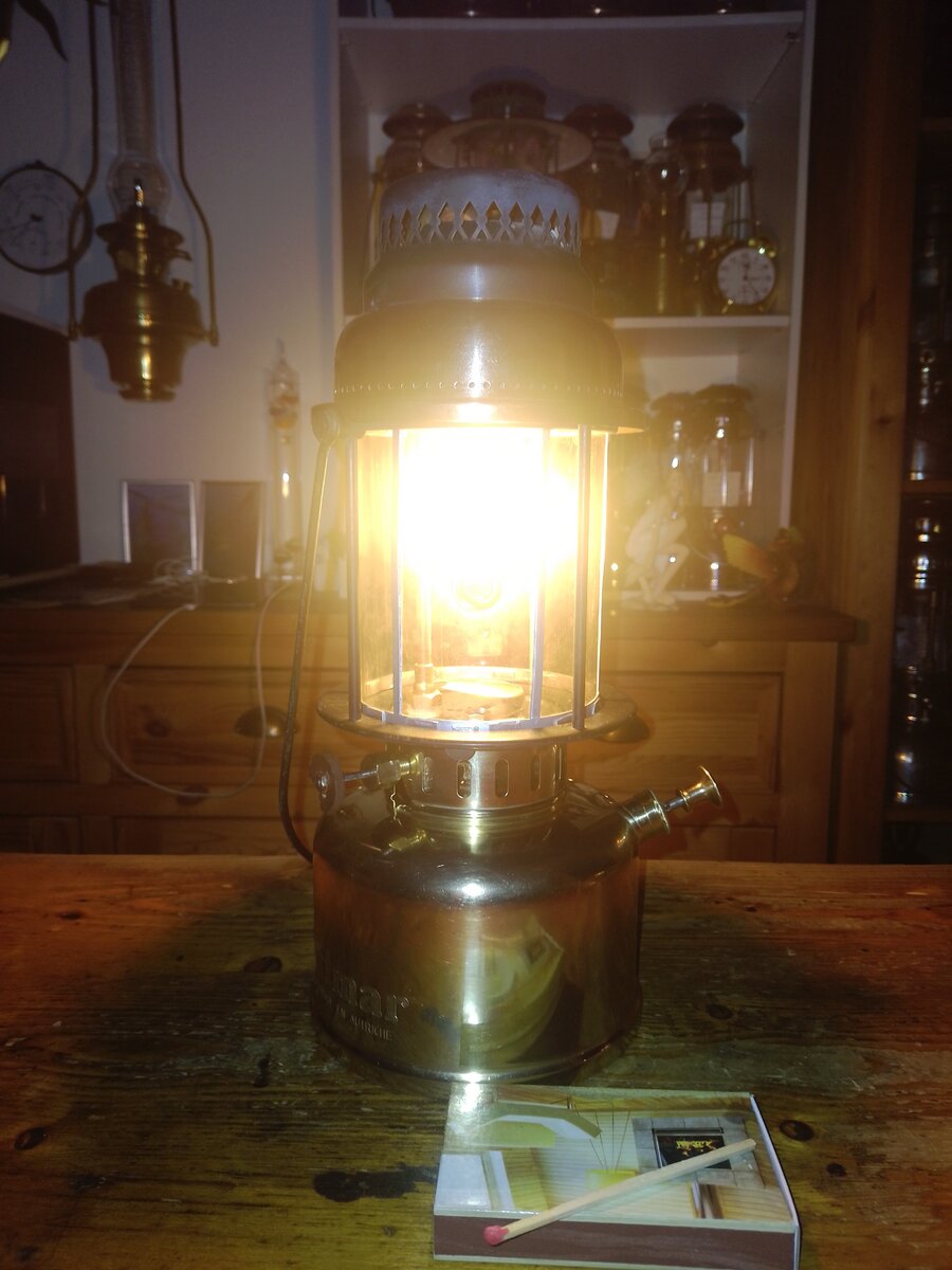

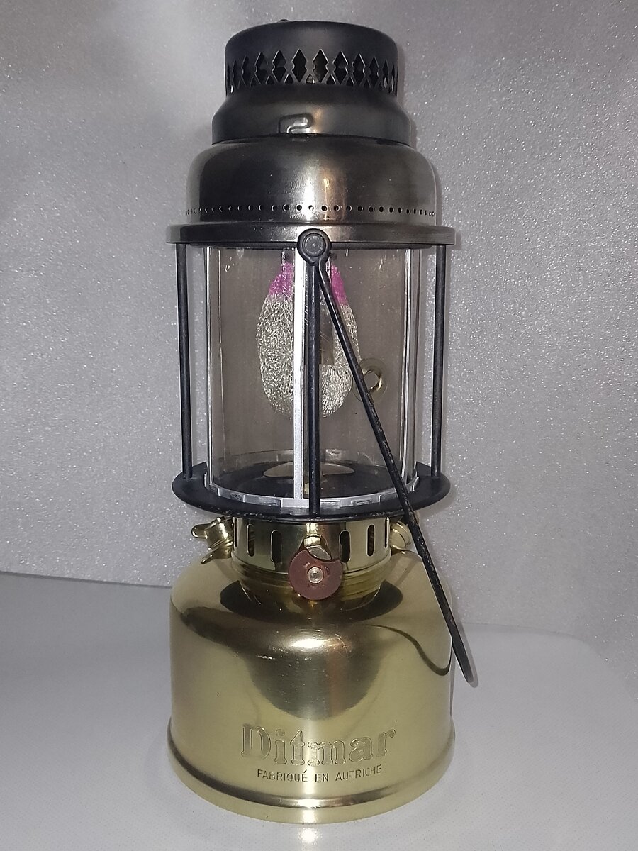

    Manufactured in December 1937 in Vienna/Austria.Even before the ban on the use of nickel in 1941,there were Ditmar pressure lamps in polished brass.

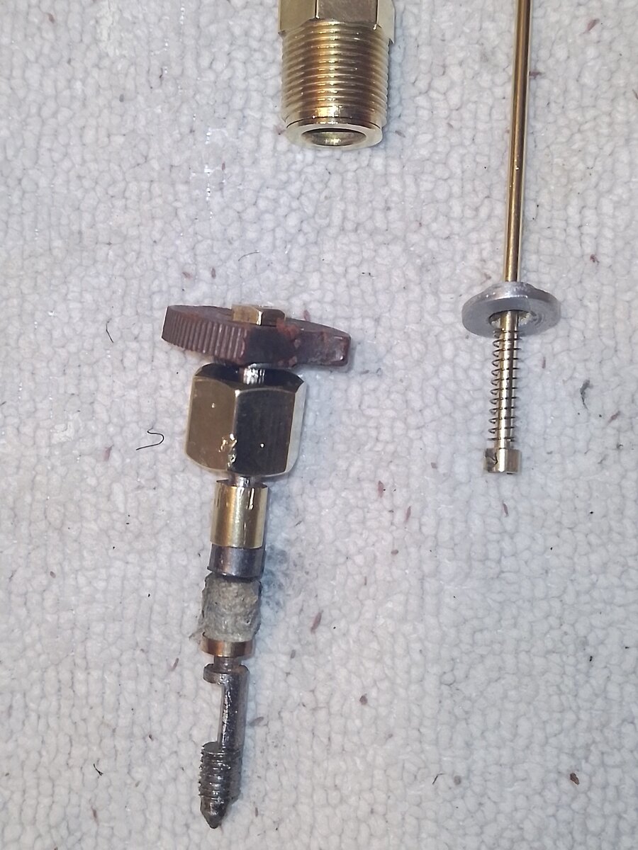

    The two hood parts and the mica glass were missing on this Ditmar 503.I borrowed the parts from a nickel-plated Ditmar 503 for the photo shoot and test run.

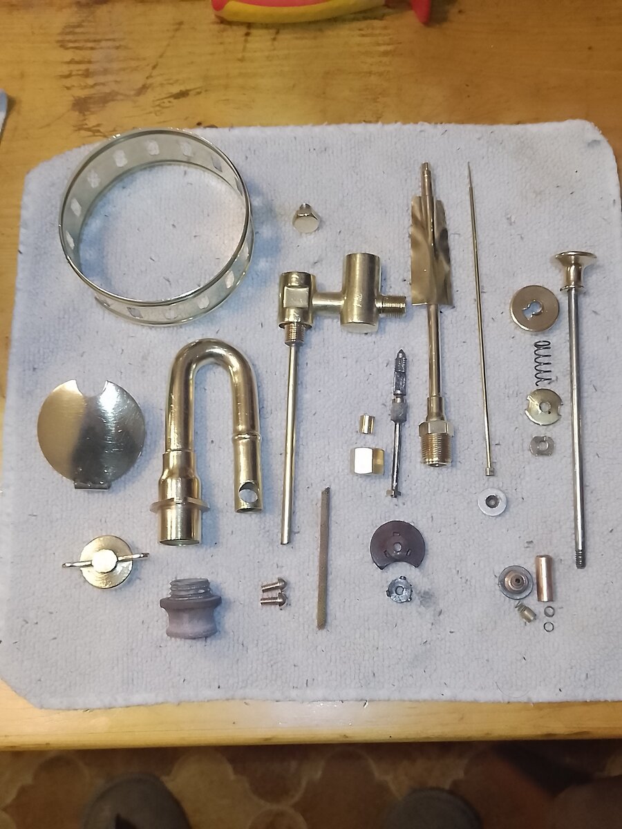

    The cleaning needle had broken off,so I soldered a Coleman part on with silver solder.The two springs for the pump valve and the lifting mechanism for the cleaning needle were broken and I replaced them with new springs.The positiv shut-off valve is worn on the sealing cone and does not close 100%.A previous owner painted the innercase and the carrying frame black. IMG_20231224_223127.jpg IMG_20231224_165347.jpg IMG_20231224_172441.jpg IMG_20231224_222339.jpg IMG_20231223_143430.jpg IMG_20231224_165407.jpg IMG_20231224_213803.jpg IMG_20231224_231608.jpg IMG_20231224_231548.jpg IMG_20231225_123935.jpg IMG_20231225_182657.jpg

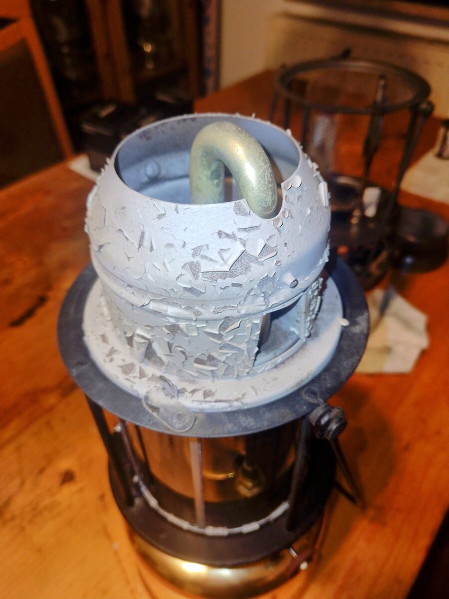

    As you can see,the black paint didn't hold up to the heat.the old petrol lamp has probably been used for decoration for many years without any function. IMG_20231225_215952~2.jpg

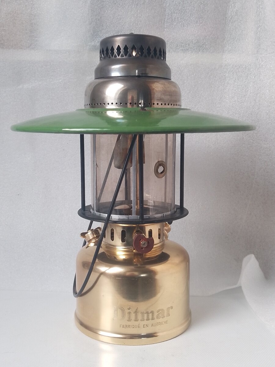

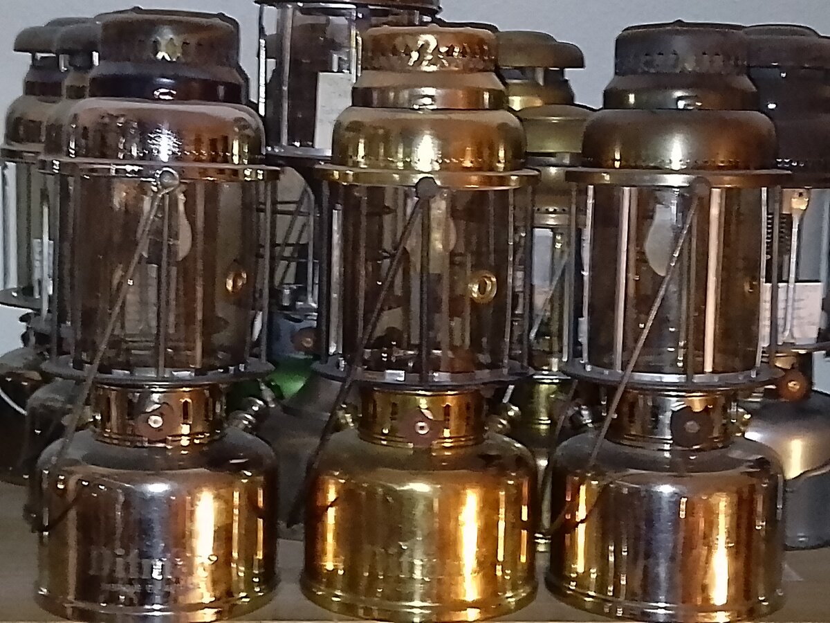

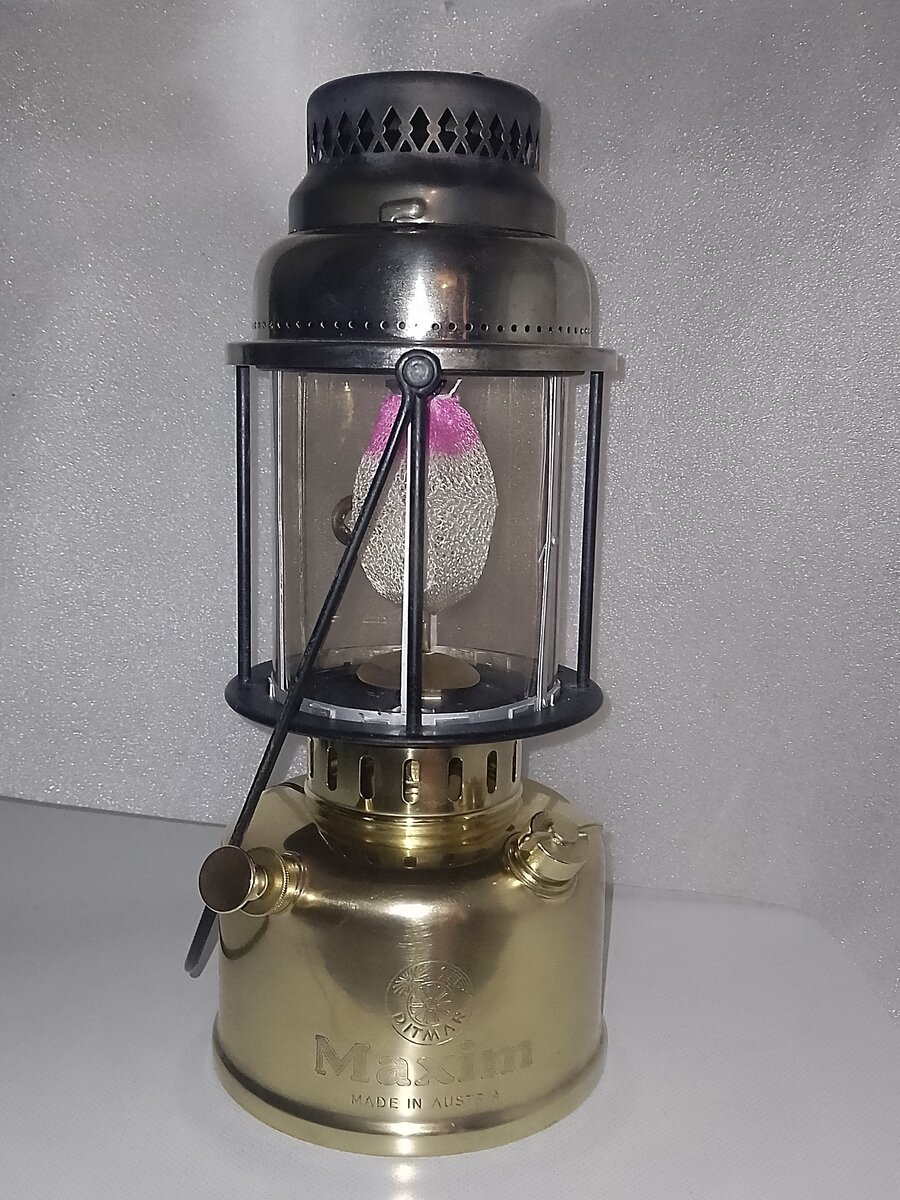

    The Ditmar 503 in polished brass ( on the middle ) is now complete.All three Ditmar 503 are ready for use.( gasoline or petrol )
    Years : 1934, 1937, 1933
