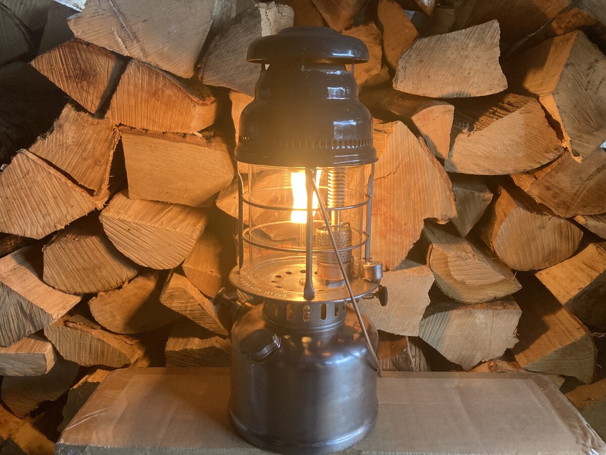

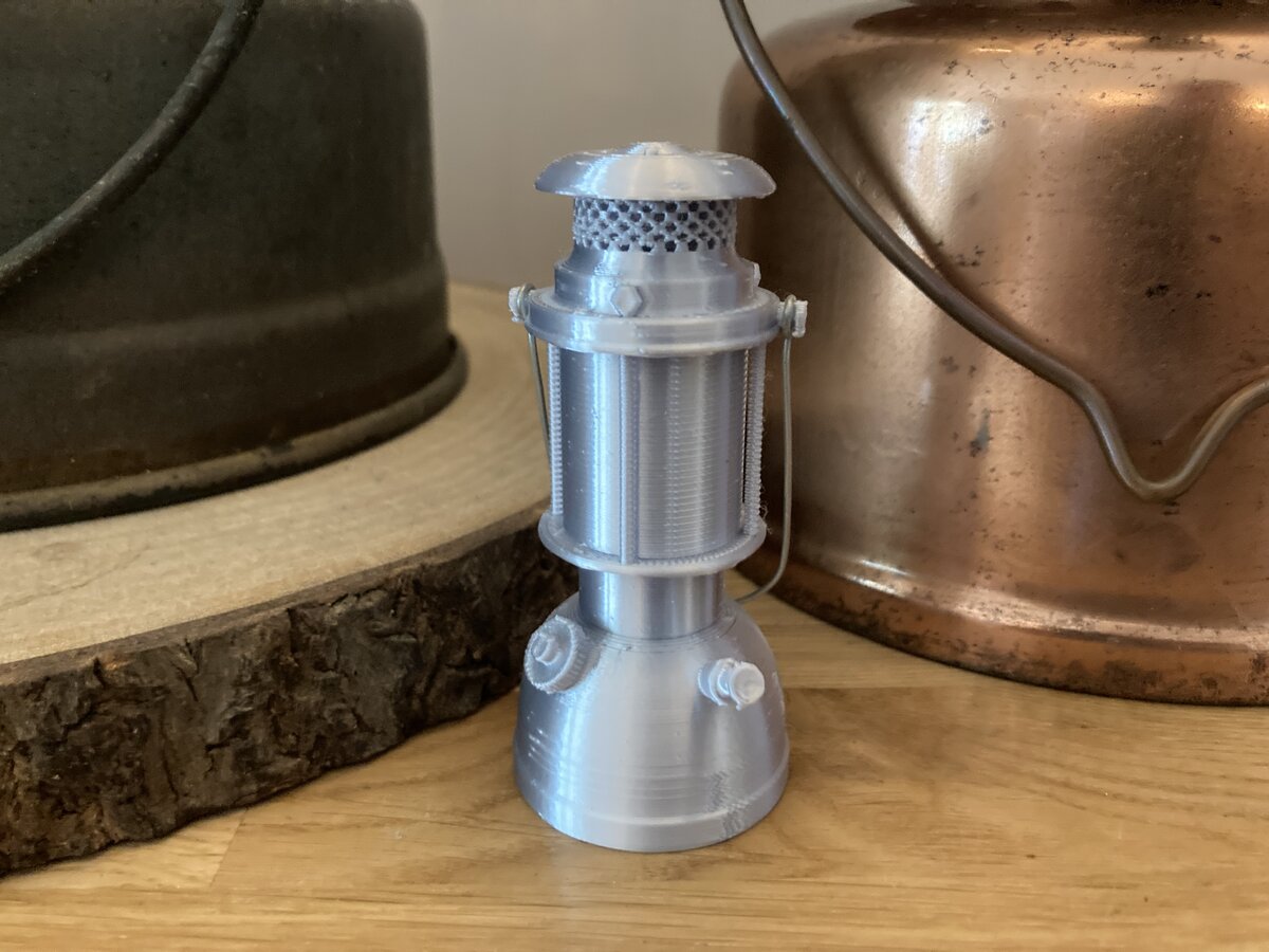

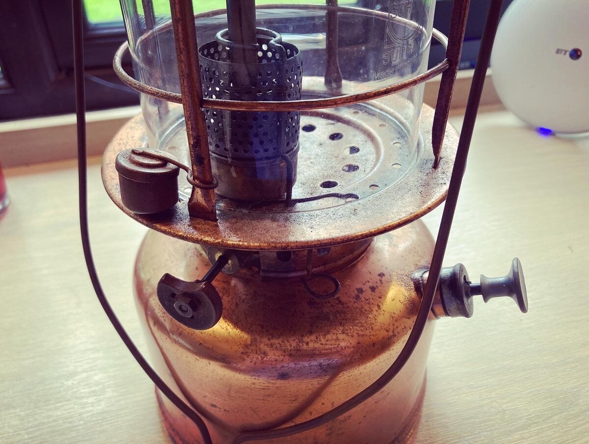

    I have a wish list of specific lamp models that I am looking out for to add to the collection and I’ve not added to it for months until a Tilley Pork Pie found me last week and today’s mail brought me one of my top picks. I found this Ditmar 506 in Germany on eBay and had to ship it to a forwarding company as the seller wouldn’t ship abroad. My last use of a forwarding company in Spain took months to deliver and both items arrived damaged. This 506 took about a week to arrive and is perfect thanks to some top packing by the seller. The 3D printed lamp was a nice bonus too!

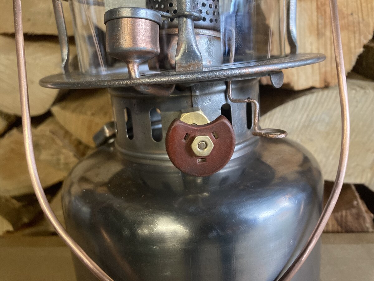

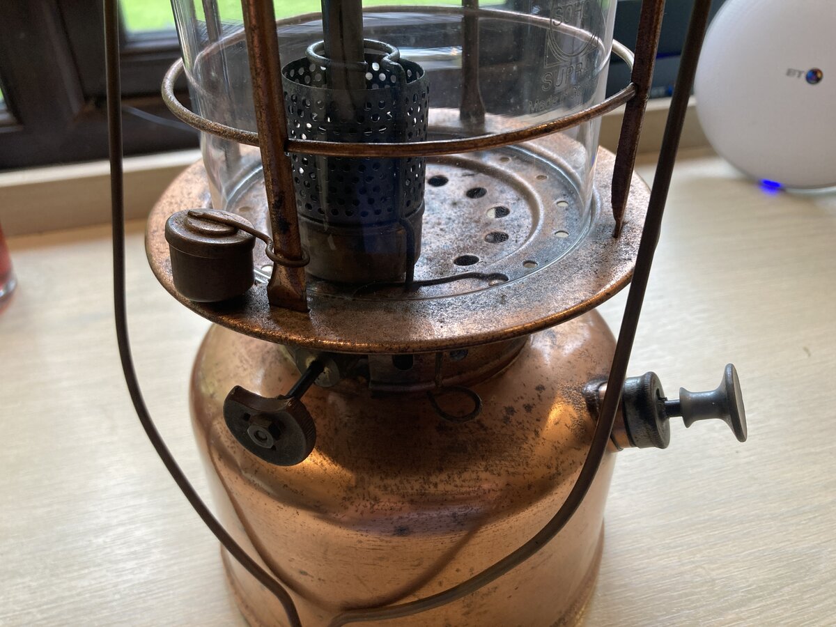

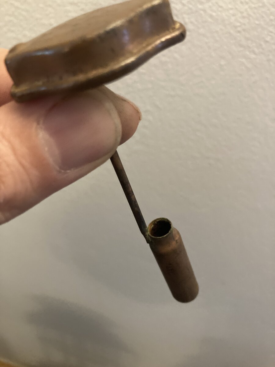

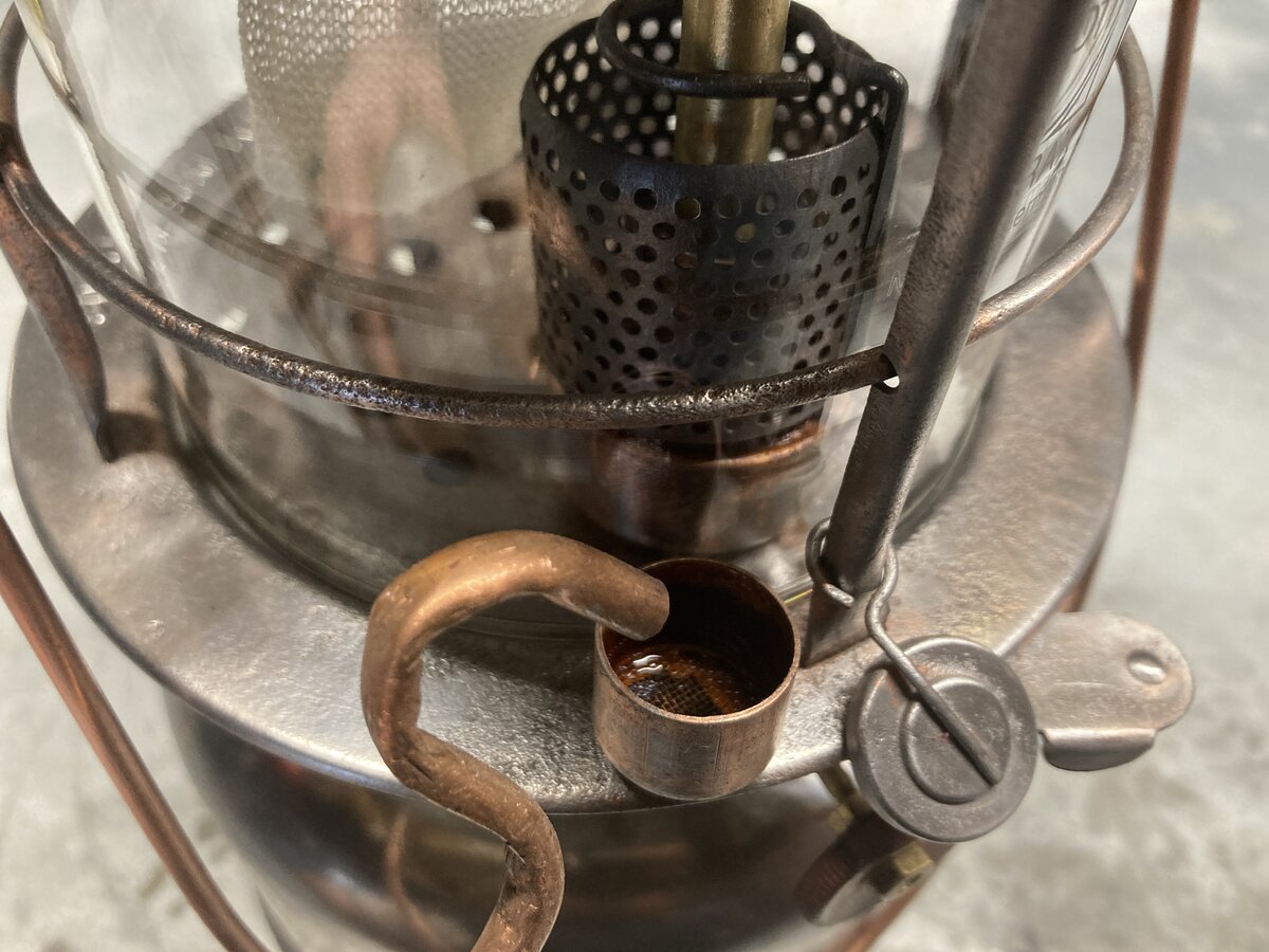

    Inspecting the lamp I can see similarities to the Mewa and BAT lamps I already own. It looks to be in great condition, the fount still holds pressure, the cleaning wire still works and the hood has a couple of spots of deterioration but for a runner it is in pretty good shape and I will leave it original initially at least. It is the filler cap and preheater that have me intrigued on this lamp though. The filler cap has a small vessel attached to the underside of the cap that I can only think would be for extracting a small amount of fuel from the fount. I assume that the only reason that would be done is to supply fuel to the preheater. As this lamp runs on paraffin as far as I am aware, I am intrigued as to the light up procedure as I have only ever preheated with alcohol, always assuming paraffin wasn’t volatile enough. I really like the attached preheater funnel cup!
    Looking forward to getting to work on this one. My workbench is looking really interesting again!

    Nice item, and should restore well enough. Be aware that the pump valve can be removed from the tube as usual with a right hand thread, but when you take the valve apart to service the pip it uses a left hand thread.
    And take care for the glass as it is a little taller than those of a Petromax, although the same diameter.
    Needles and jets for those are nearly impossible to come by.

    Btw. forgot to mention: the preheater works well on all kinds of fuel, including paraffin. However, with paraffin it will develop a terrible smell and some amount of soot on the vaporiser, which will disappear after a while of burning the lantern.

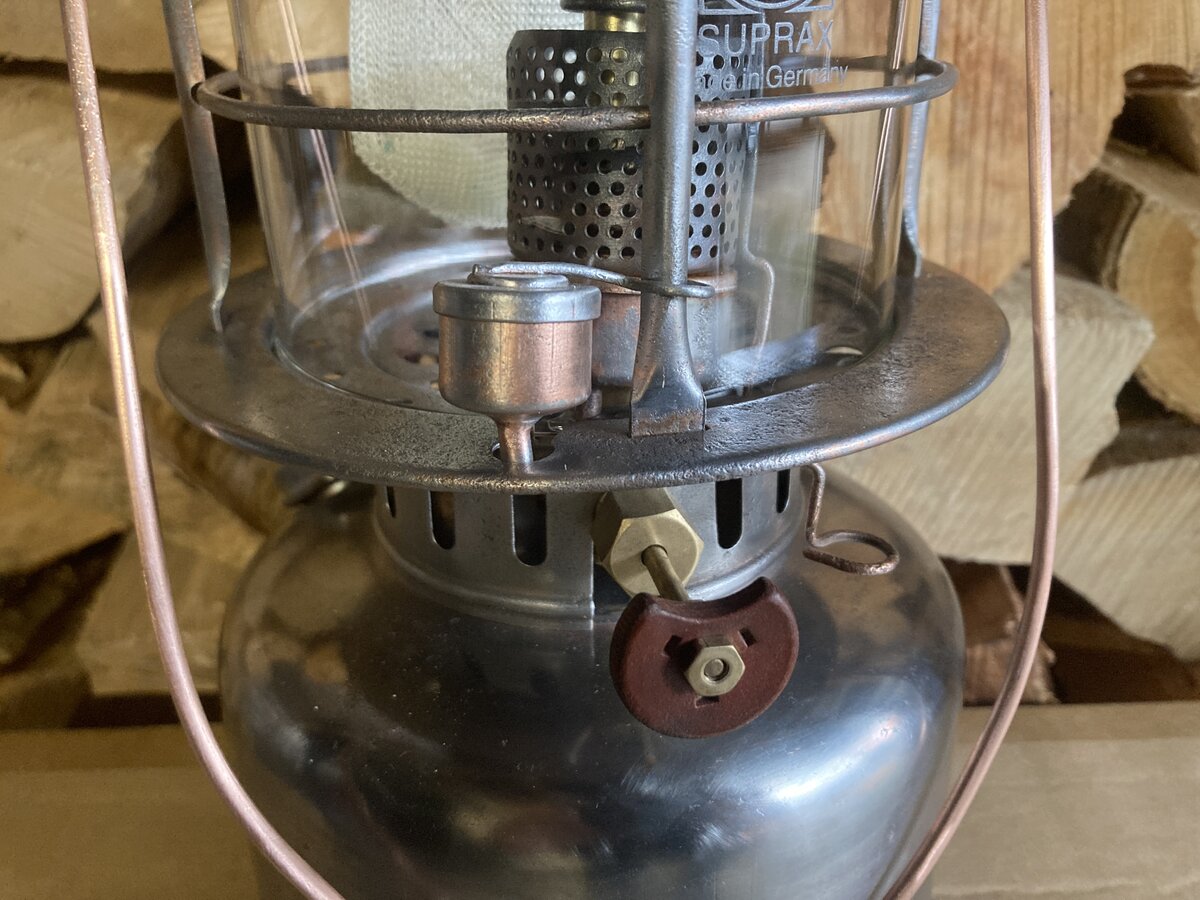

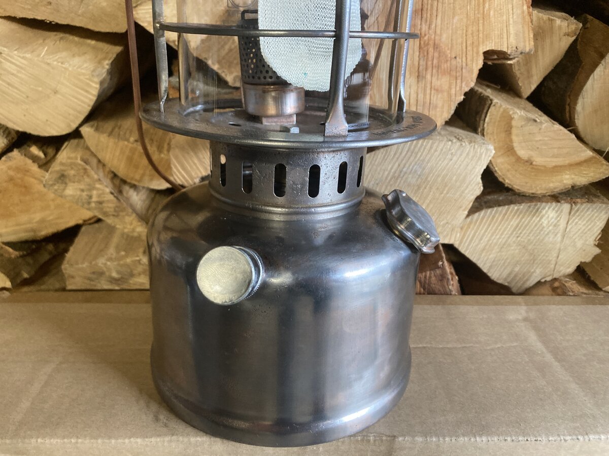

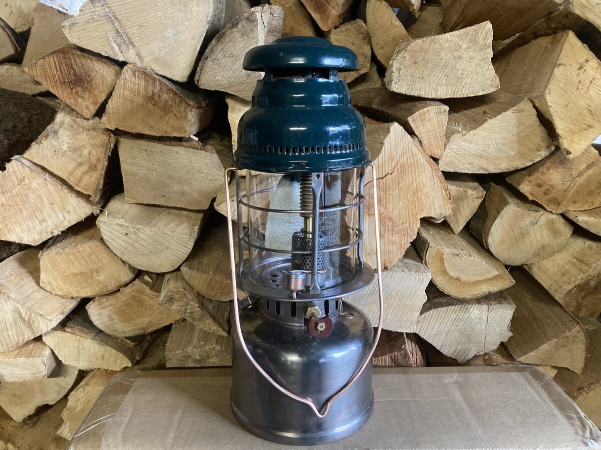

    Finally got around to stripping this down and was surprised that rather than a brass fount and cage, it is a steel fount and cage painted gold. I need to rethink the approach as it was just going to be a cleanup of the brass. Now I potentially need to repaint, though the paint doesn’t look to bad depending on how it cleans up. Although the lacquer finish is rather rough. Looking at the reference gallery, if it’s not supposed to be gold then grey seems like the most likely original, but I’m open to advice to get it back to original.

    The finish on my 506 is hot dip galvanised ie dipped in molten zinc just like a steel dustbin.
    If the paint job on your lamp is rough I suspect the original finish is still there under the paint.
    I would guess these were a wartime design with no frills whatsoever but still a really good lamp.
    If you imagine the ditmar 501 is a Rolls Royce then the 506 is like a trabant with a rolls Royce engine, it's crude, it rattles and shakes your bones but purrs so well you still love it.

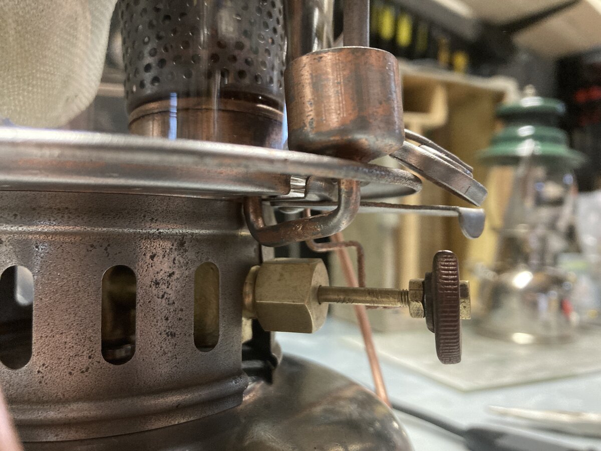

    I finally got there!

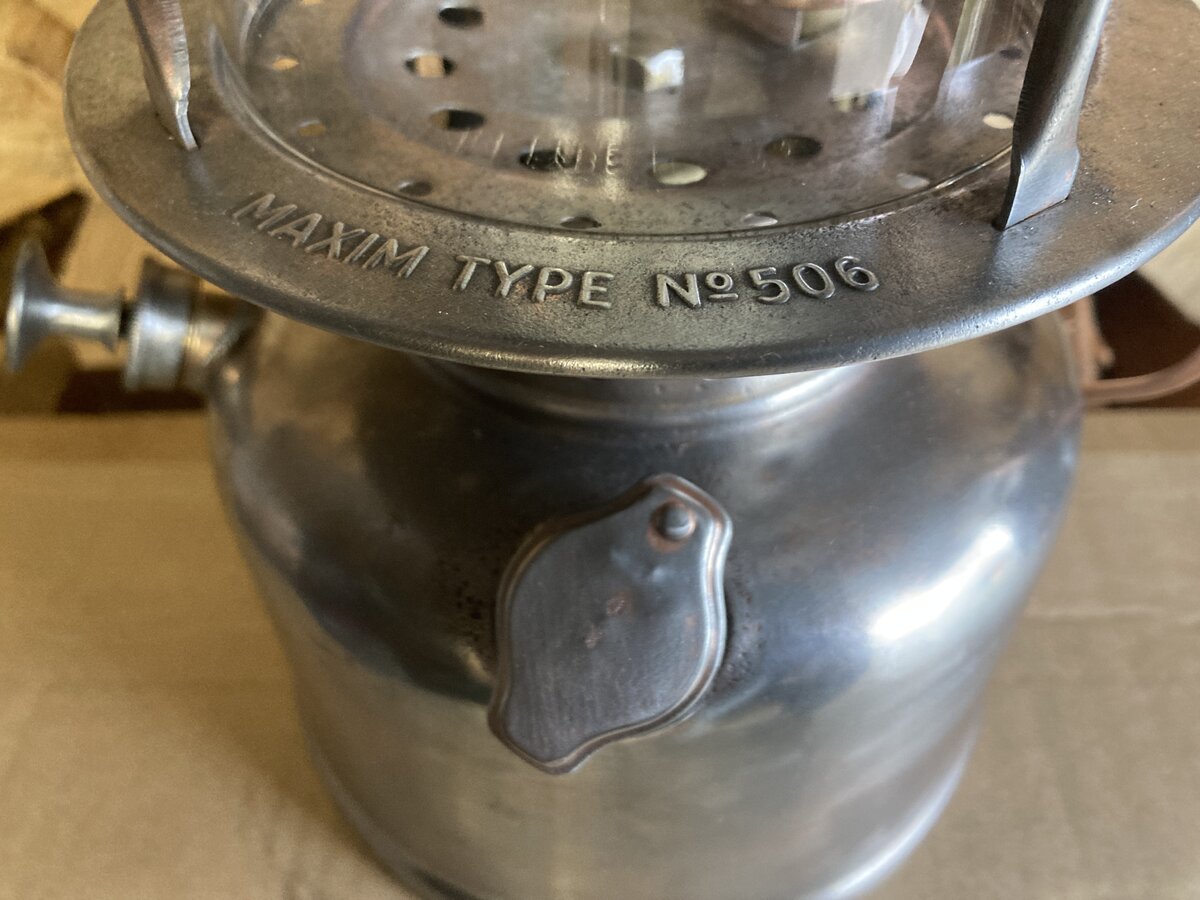

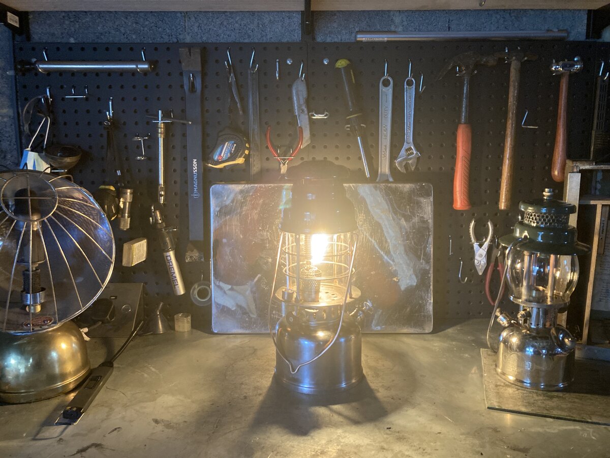

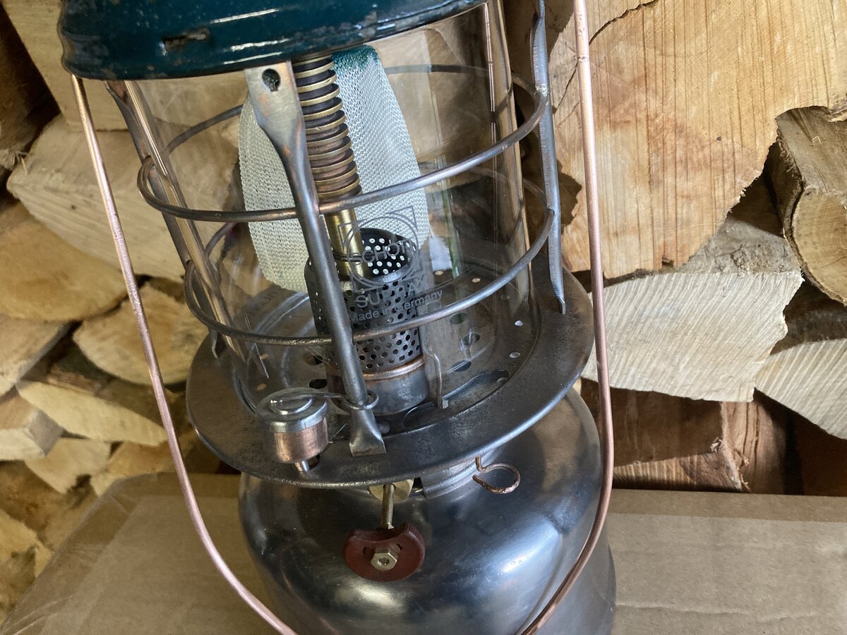

    This is one of the more difficult restorations I have done. The mechanics were straightforward enough but the finish was really difficult. It took a week on and off to get through the many many coats of runny lacquer, then the paint was so stubborn it was a combination of chemical and abrasive methods to get it back to original. It does appear to be a zinc finish but I’m honestly not certain. Ultimately though I think the final result was worth the effort.
    The preheat system on this is very cool. Love the little filler reservoir and the filler cap fuel cup.
    Finally a big thank you to @Reinhard who helped me out with spares after the original NRV crumbled in my hands.

    I wondered about some kind of plating too but it did seem so react to the paint stripper, just very slowly.
