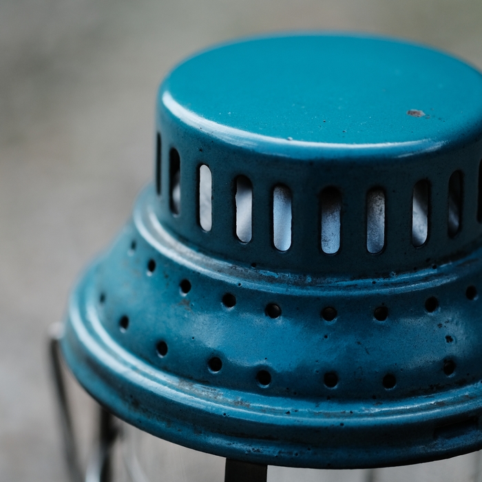

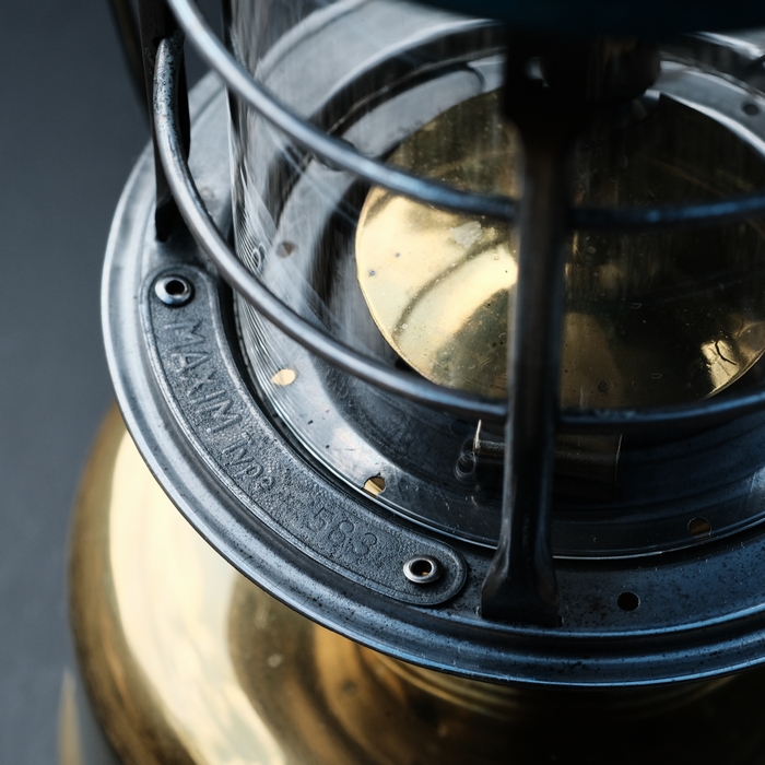

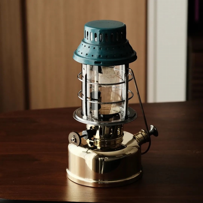

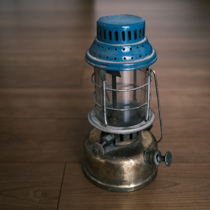

    I will keep a record of the difficulties I encountered during the repair and how I solved them so that they can be used as reference for future repair attempts.
    I wanted Ditmar581 and kept looking, and I came across 583.

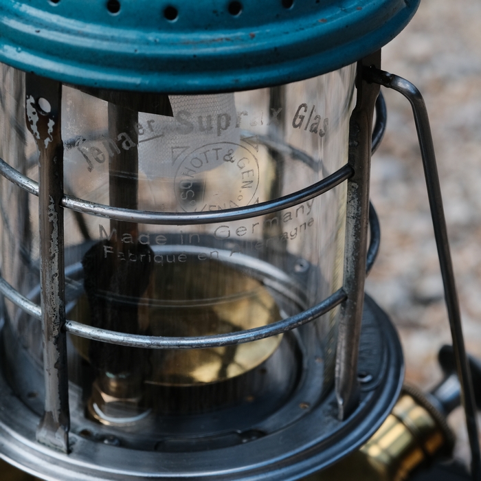

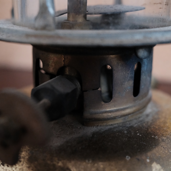

    When it first arrived from Germany, the distance ring was cracked and the needle was broken, but overall it was in good condition.
    It looked like it had been sleeping in a barn somewhere, and there were dead insects and spider shells inside the top bench.
    I am grateful to the original owner for keeping it in such good condition, and I have decided to restore it so that it can be used again.

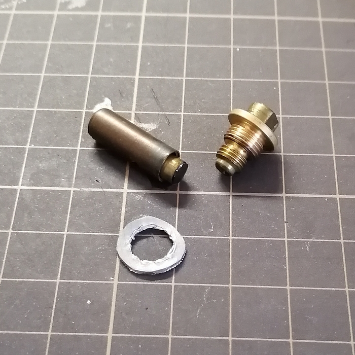

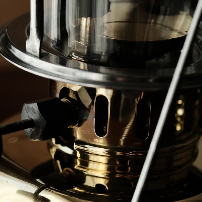

    To remove the NRV, I used a tool made by cutting a faucet type bit with a grinder.
    The NRV for vapalux can be used as a substitute for ditmar's NRV, but this individual's NRV was in good condition, so I only replaced the rubber.
    A lead packing is also included to prevent sticking.

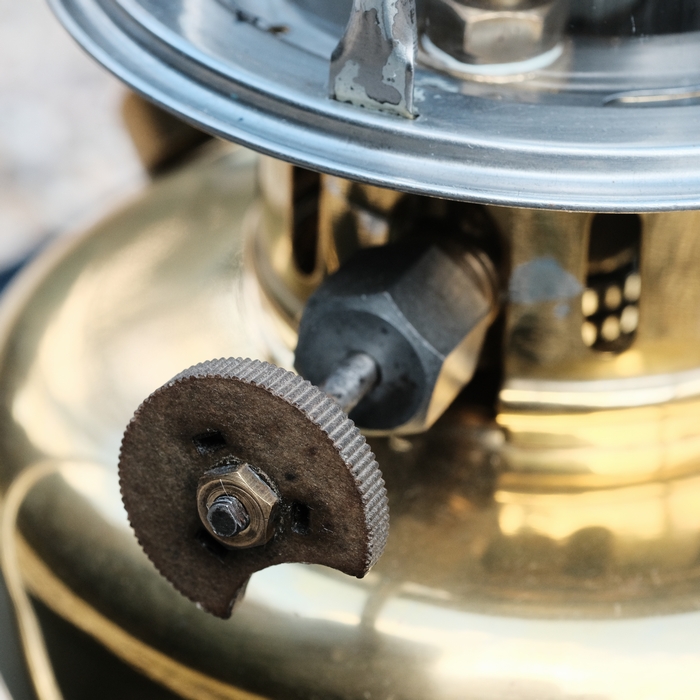

    I repaired a needle that had broken and was missing, but when I turned the wheel to check its operation, it bent several times.
    So, when I read the instruction manual uploaded to CPL, it stated that "the needle should only be operated while the lamp is operating = pressurized."
    Previously, operating the needle in hot conditions would shorten the life of the nipple, so operation checks were performed with the lamp not lit.
    However, I learned for the first time that in the case of a thin needle like this lantern, the fluid flow when the gas exits the nipple hole acts as a guide, preventing it from hitting the nipple wall and bending.
    And the repair is complete.

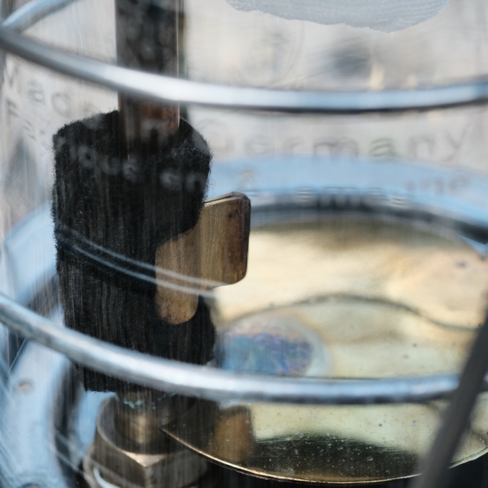

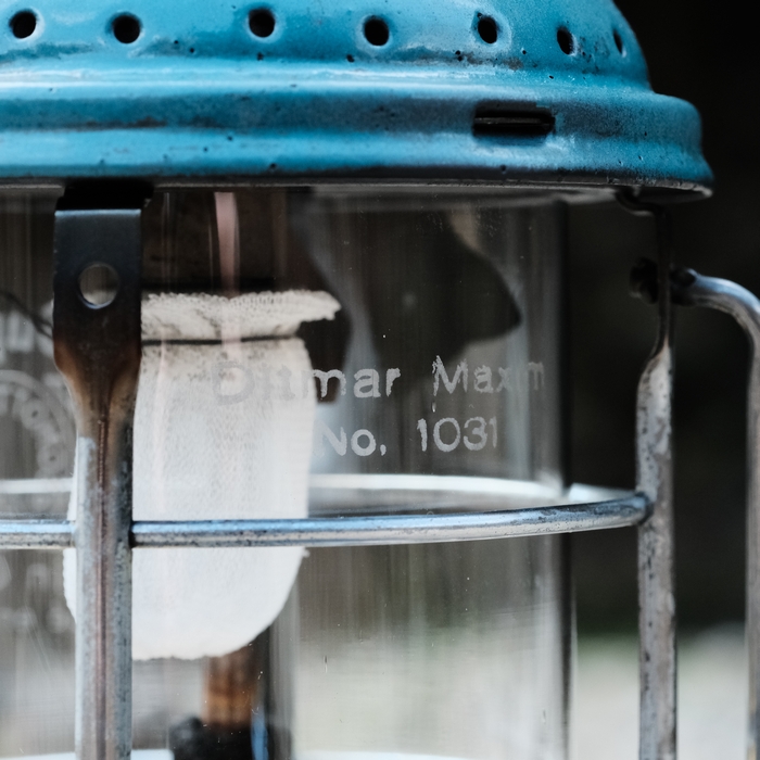

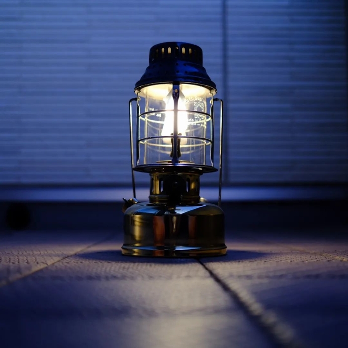

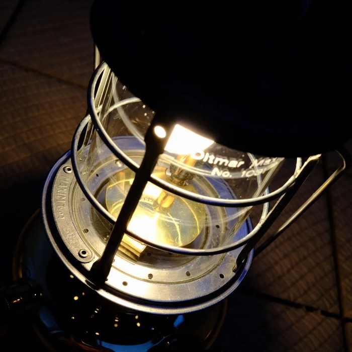

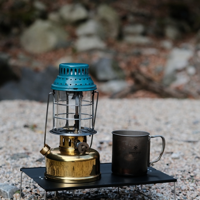

    When I attached a mantle for kerosene 150CP, it did not burn well, so I replaced it with a mantle for Coleman 229, and it burned very well.
    I connected the cracks with solder.
    For preheating, I attached carbon felt using a clip I made from brass.
    When lit, soak it with a small amount of alcohol and ignite it.

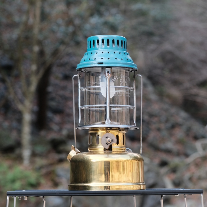

    A very small and cute lantern.
    Thank you for reading it until the very end.
