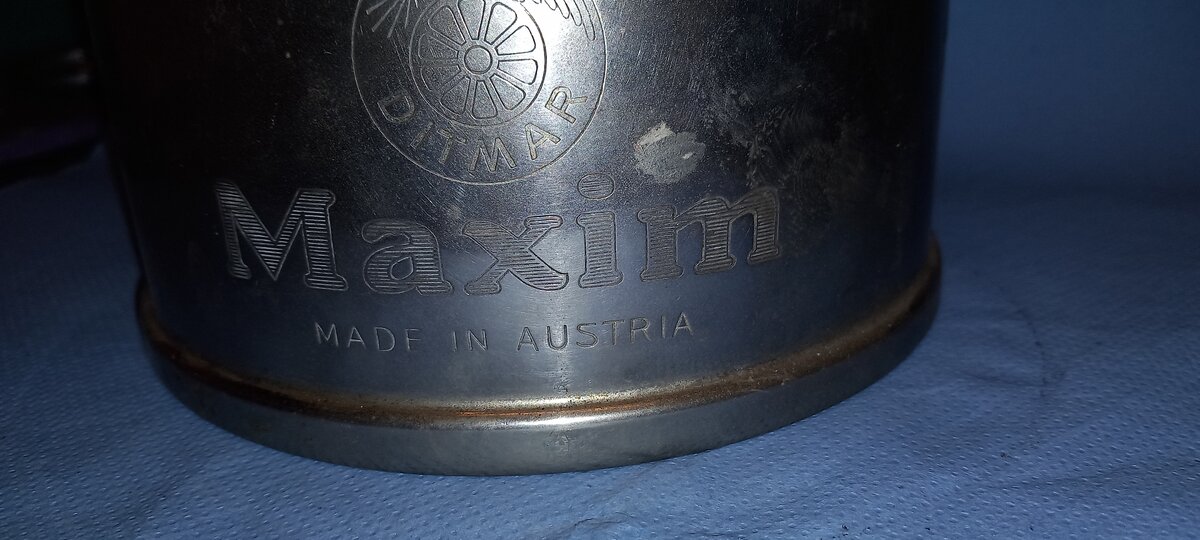

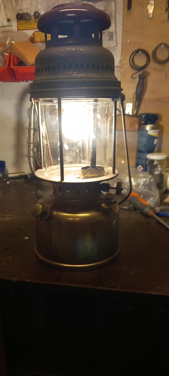

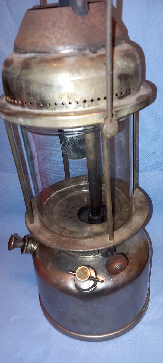

    Hello.
    I have a few questions about this lamp.
    What does the original hat look like for it?
    What time period was it produced? No number is indicated on the lamp.
    I have the original globe, but missing the hat, which
    enough is hard to find.
    Thanks in advance.
    Tom
    20231230_101834.jpg 20231222_121855.jpg 20231230_101902.jpg 20231230_101849.jpg 20231230_101929.jpg 20231230_102214.jpg 20231230_102239.jpg

    Hi @Tom Pedersen
    You will find pictures of that lantern here in the reference gallery (e. g. this one). The cap is missing very often as it is only held by a bayonet catch.
    The glass has the same diameter as for Petromax 300 - 500 CP, but is slightly higher, and nearly impossible to come by.

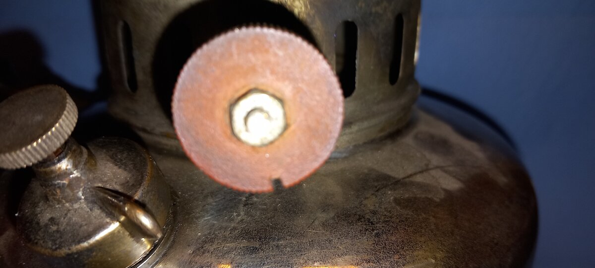

    The lantern should have a stamping on the tank bottom which indicates its manufacturing date (month/year). Due to the handwheel I'd guess that it is an early pre-war version.

    Hello. @Martin K.
    Thanks for the answer.

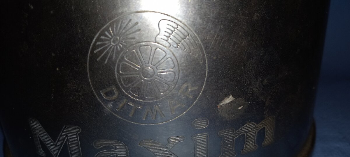

    I have the original globe with the DITMAR logo.
    If there is someone on the site who has a cap that fits the lamp, I would like to buy it. Possibly also a donor lamp.
    What CP is this lamp?
    Sincerely Tom

    You should take good care of that, and don't use the lantern as a workhorse (which it definitely could be if maintained well).
    These lanterns are rated 300 HK. You can find a document on that lantern here in the reference section.
