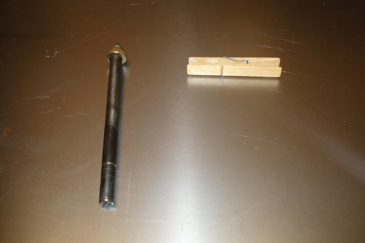

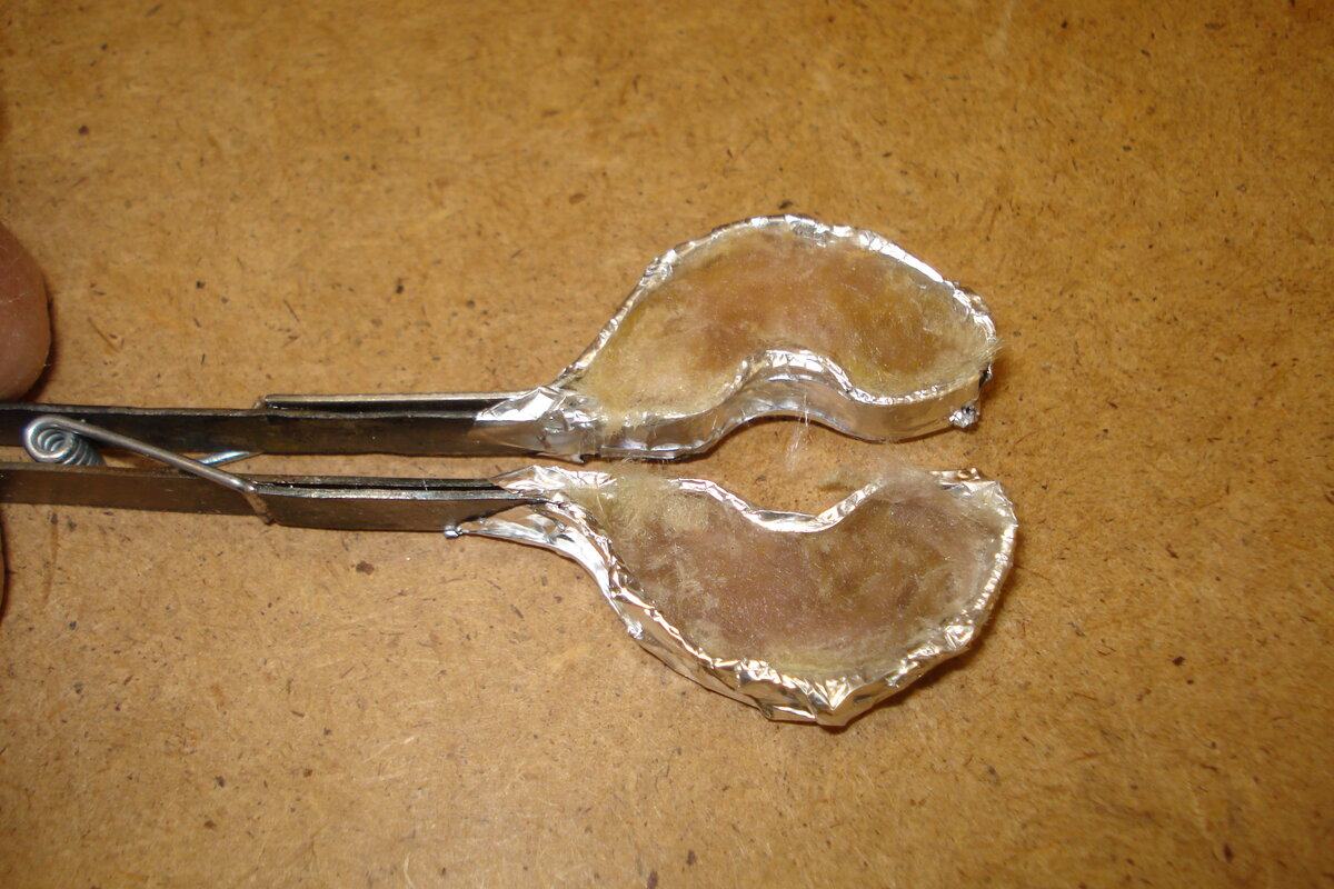

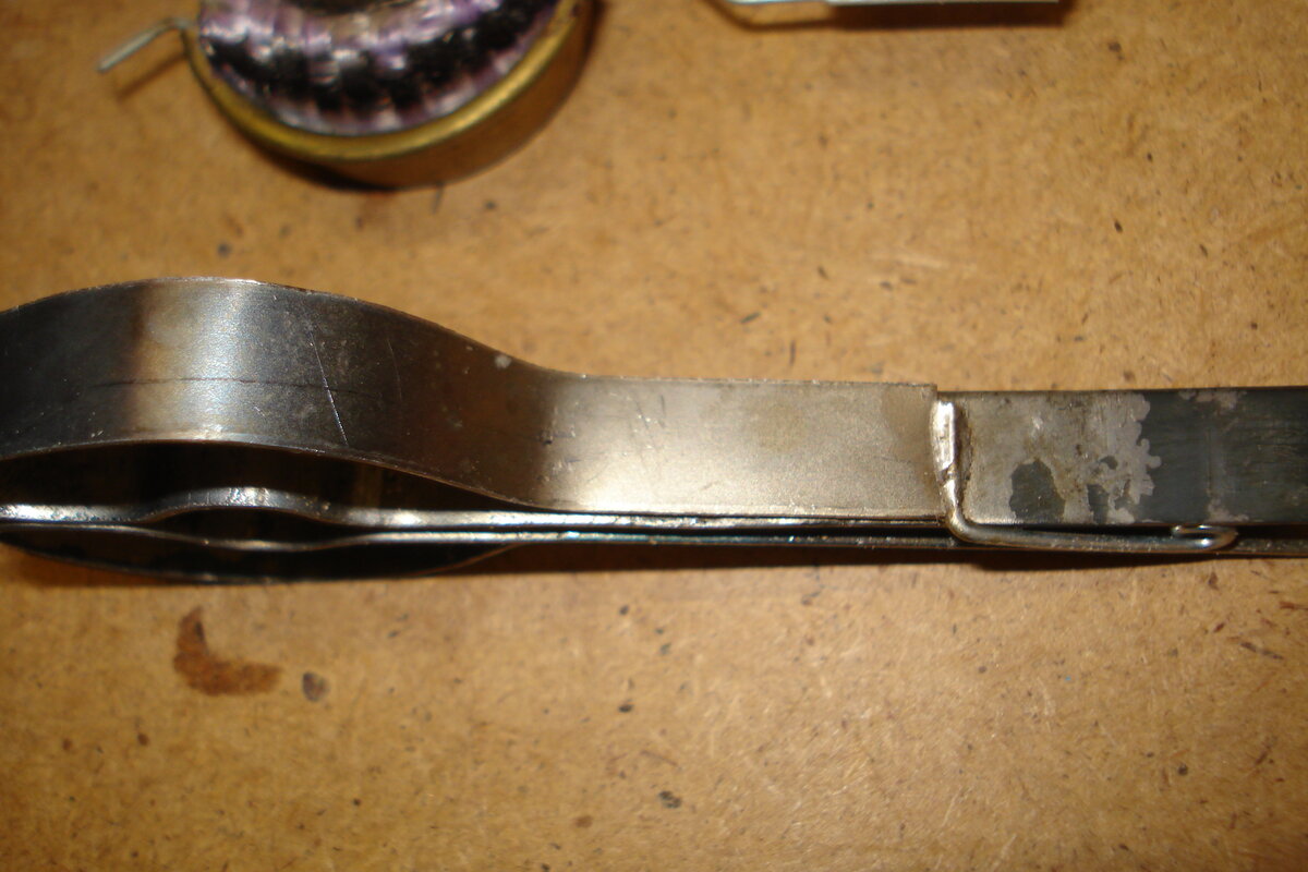

    I am down to my last pre-heater torch and decided to make one.

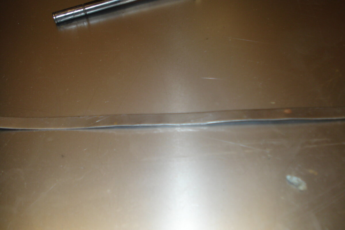

    This is how to do it using a strip of steel sheet and a clothes peg, and using a vaporiser (or similar diameter rod) for the template.

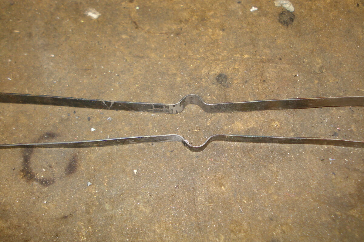

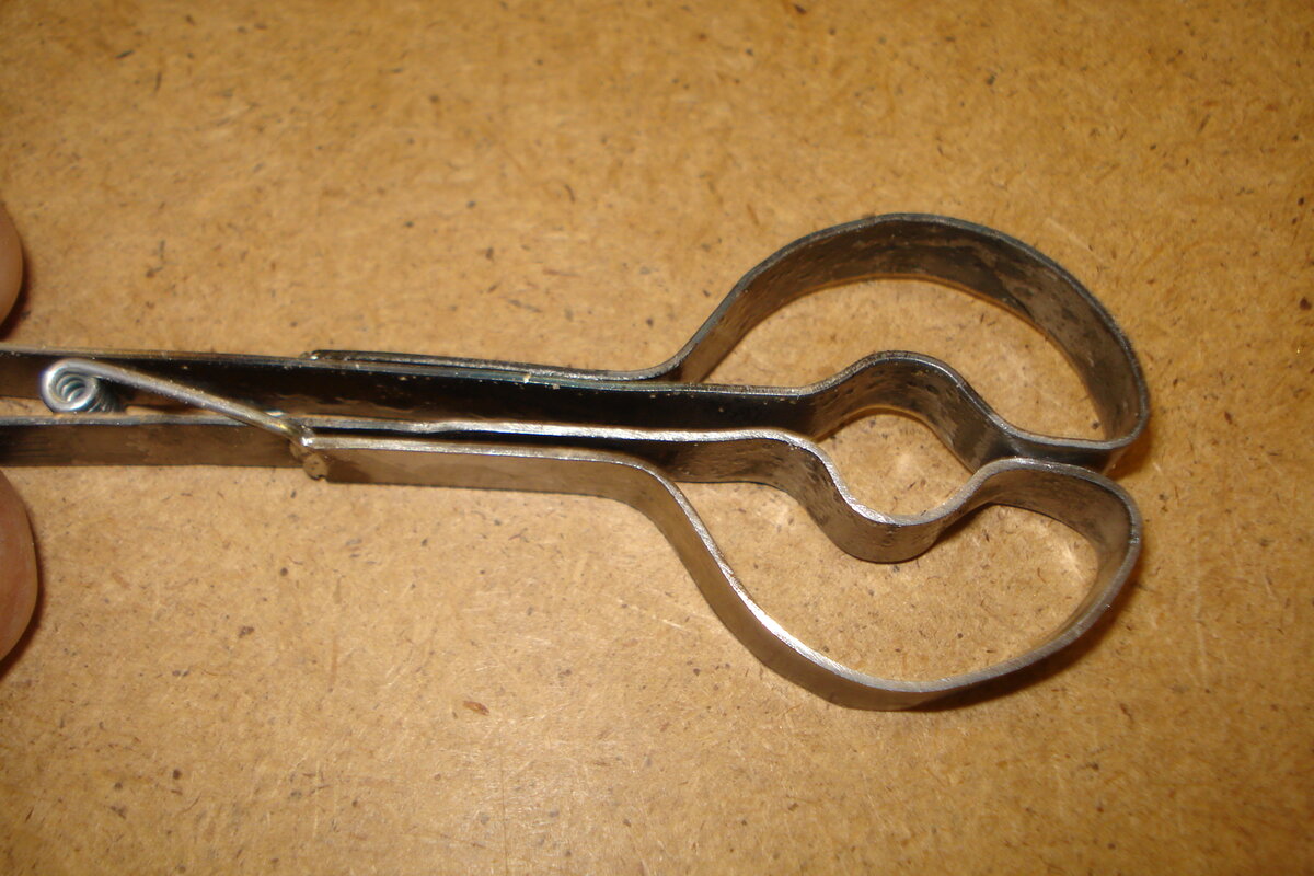

    First cut the strip, then cut in two and soften the centre portions with a torch and form two semi circles over the vaporiser.

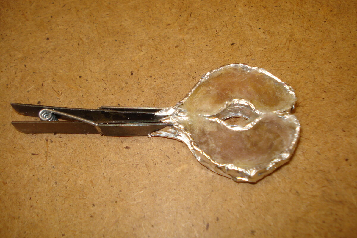

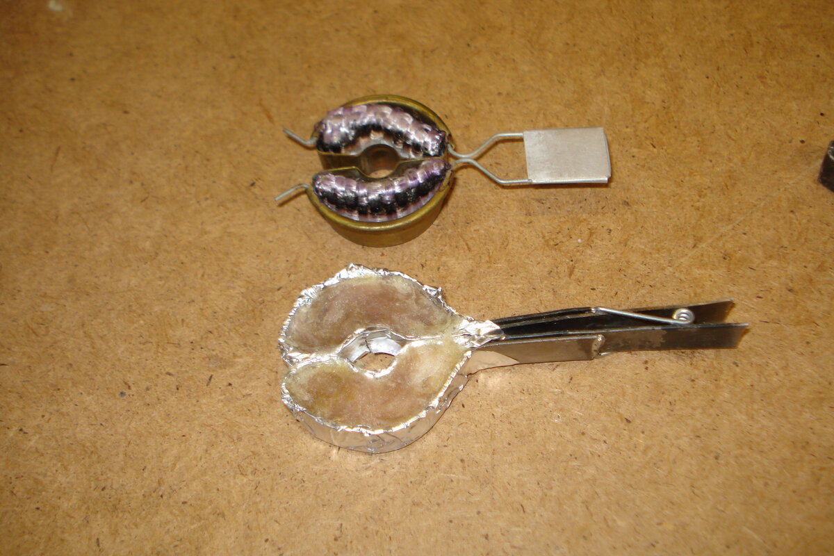

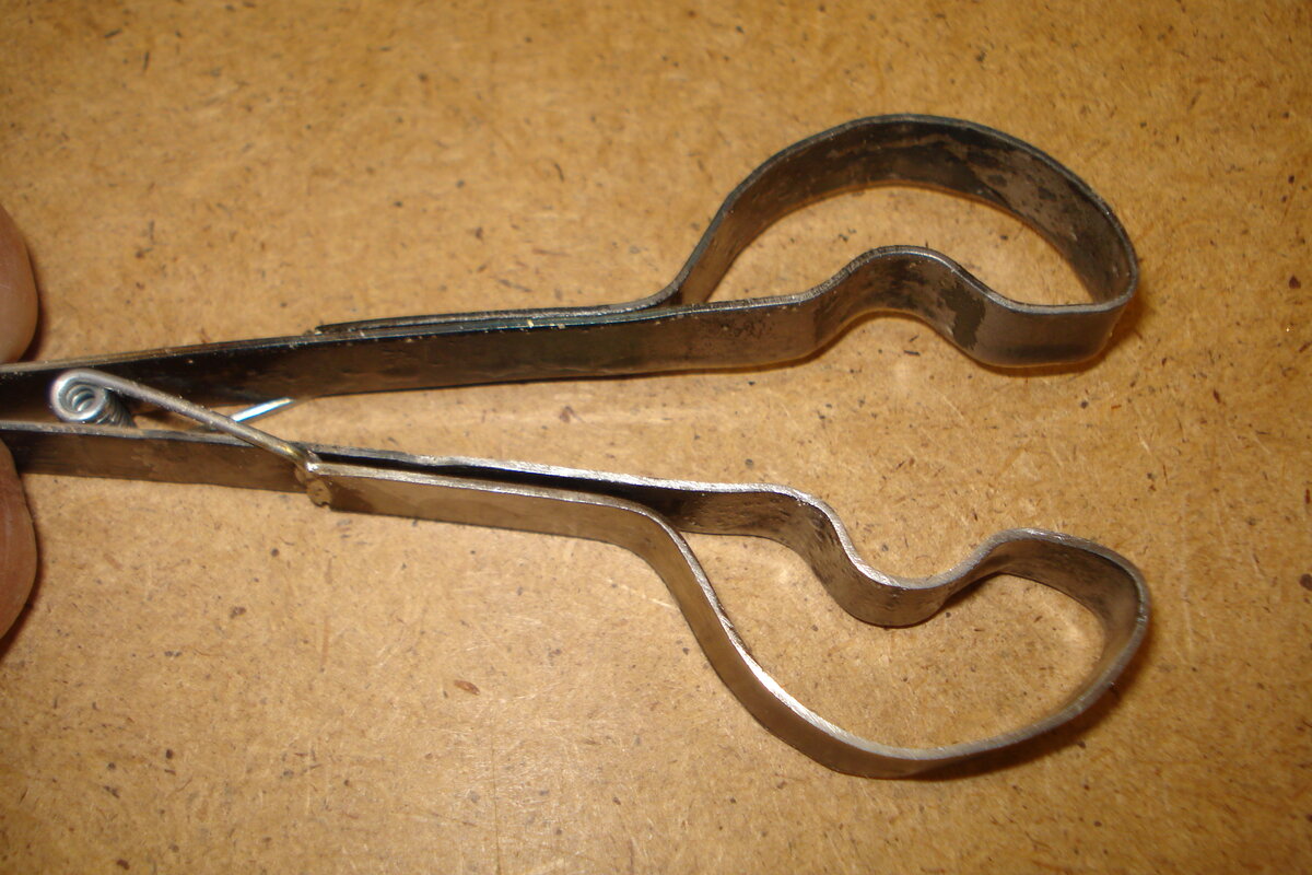

    Then bend bend each piece back over to make a loop roughly the same size a the original.

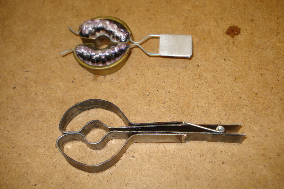

    Cut the ends to suit and then solder in place a clothes peg spring. Solder rather than braze to minimise the heat input and avoid softening the spring.

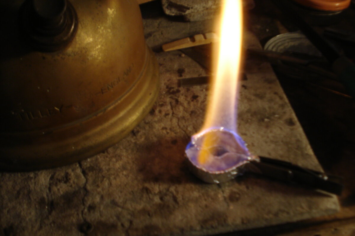

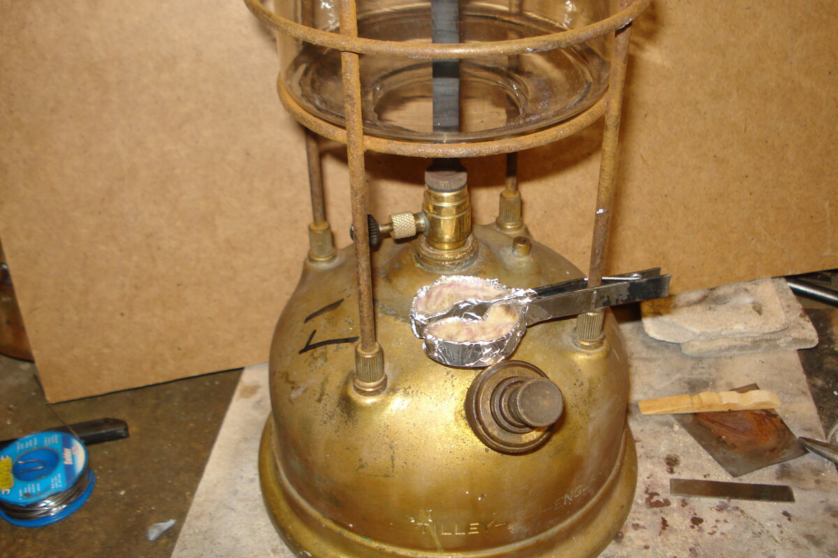

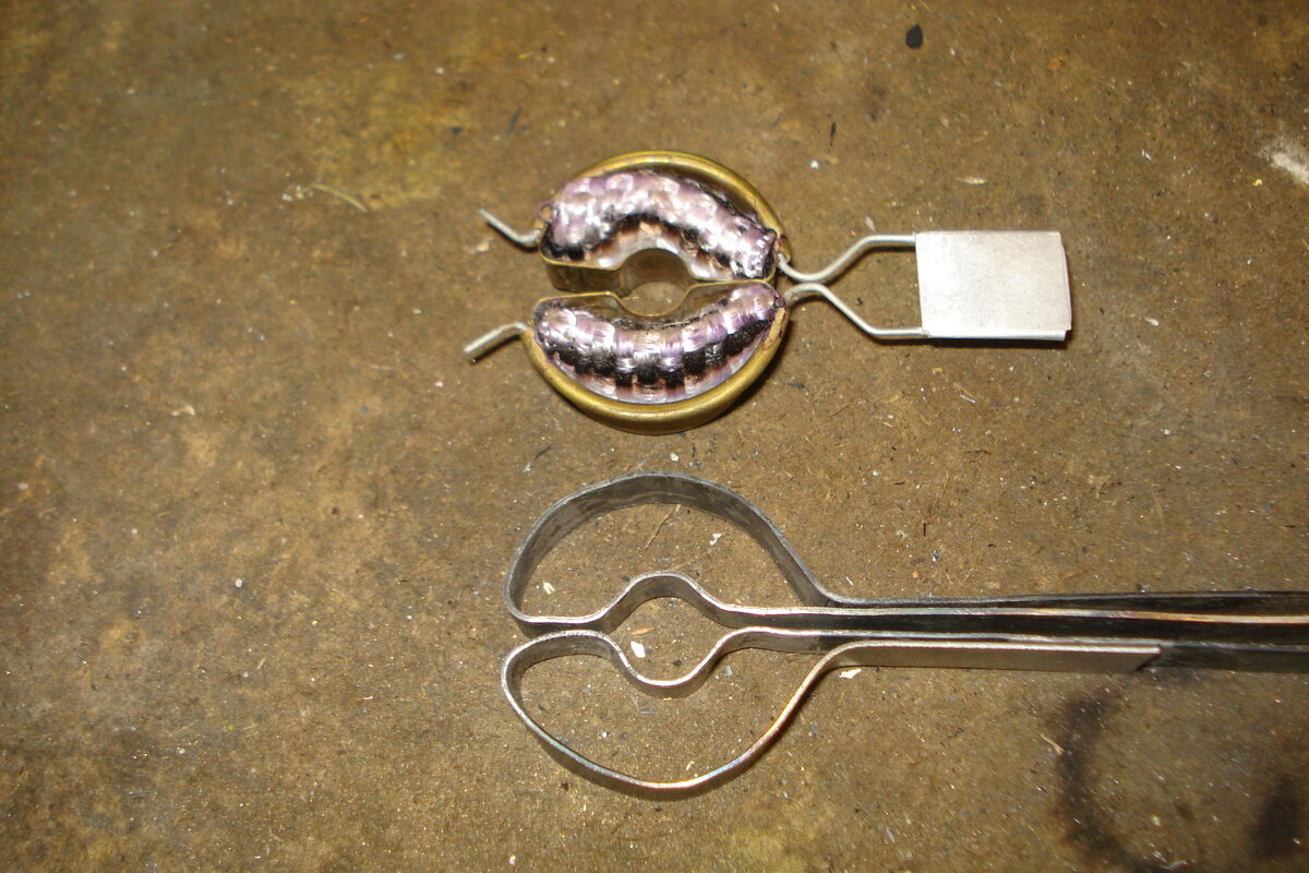

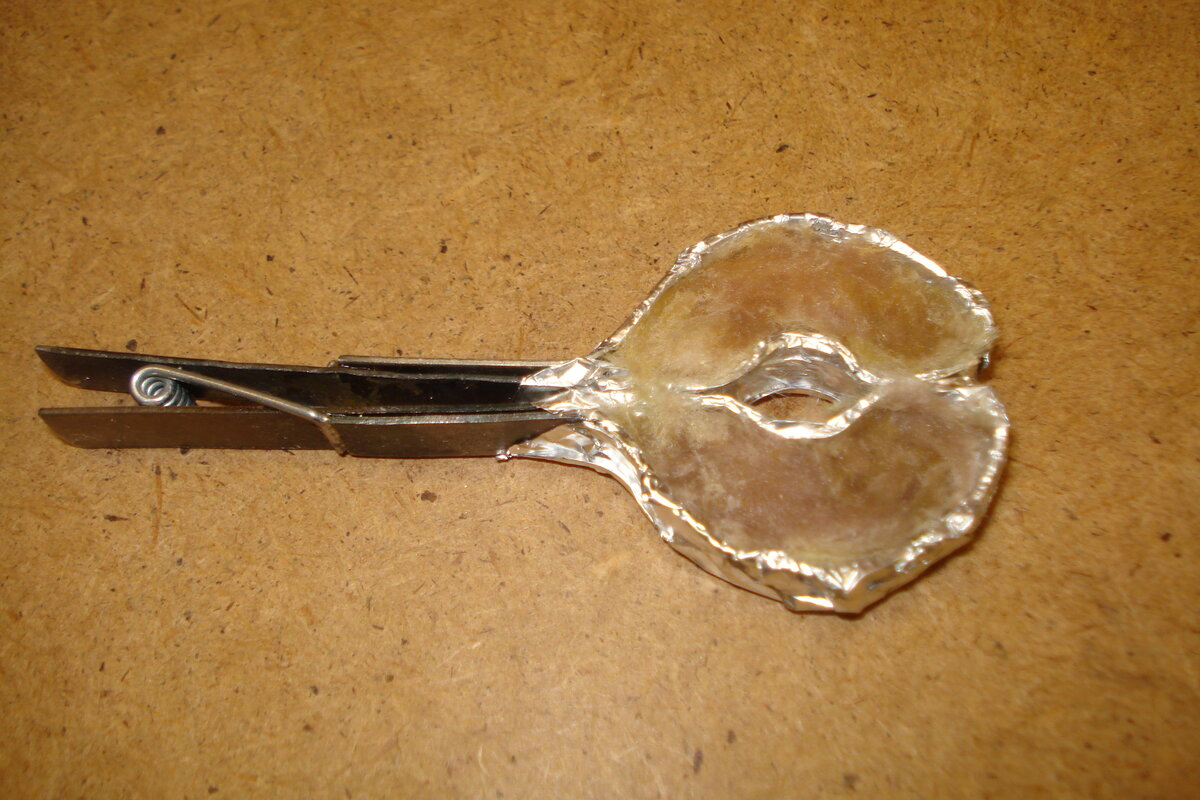

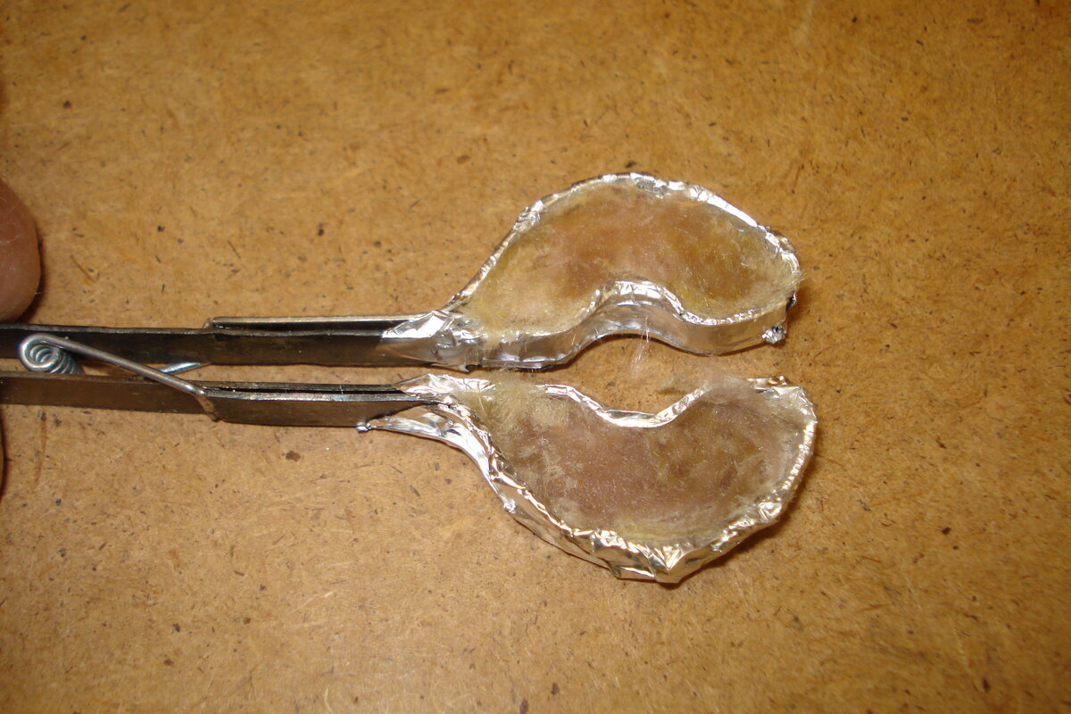

    The meths 'containers' are formed inside the loops using thick aluminium foil and filled with glass wool (and meths).

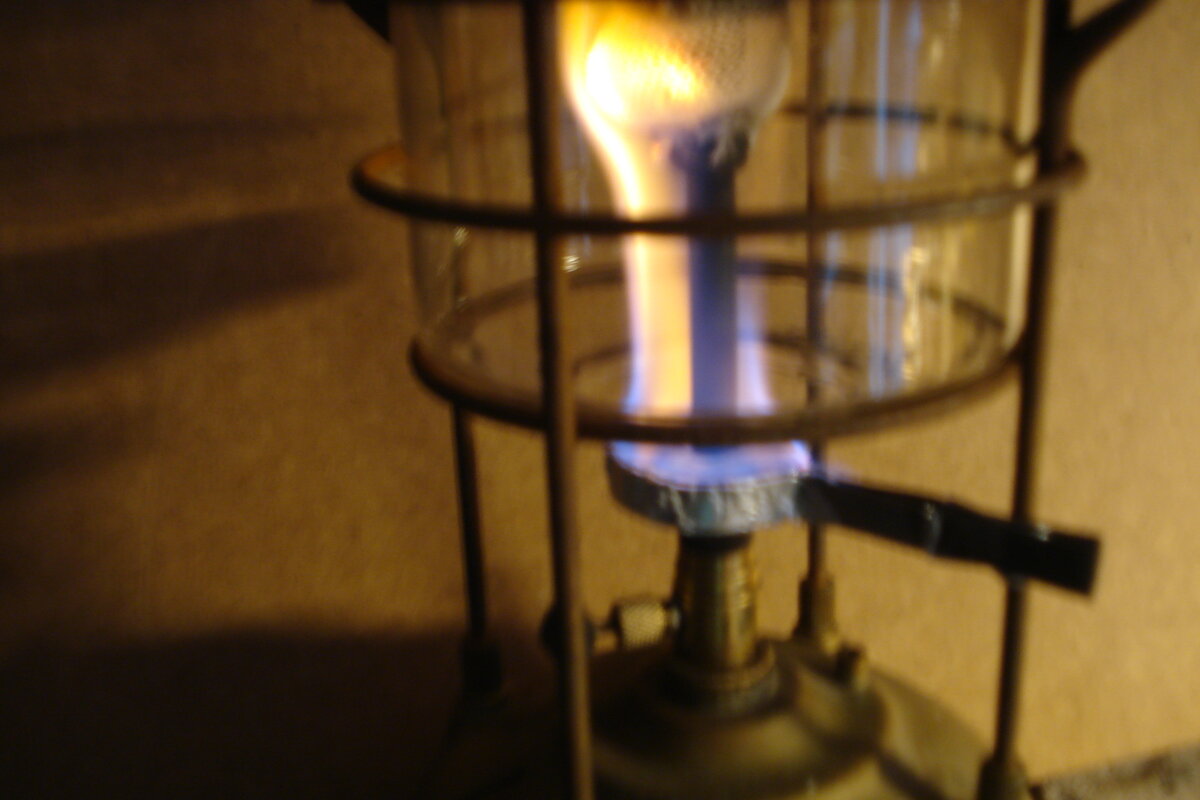

    Works well with no drips
    and clips onto a leg when not in use.

    Hello Twoberth, grear poste, I bought a tilley, but it came without pre-heater, so I'll make one like yours, but could you please send me the dimensions of the steel strip, ans also more or less the external diameter of the "circle' of the burners ? Sorry, English is not my first language...
    And also, what do you put in the pre-heater ? Wool ? Pieces of cloth ?
    Thanks

    Your questions are already answered above:
    Regarding the dimensions just read the first post:
    The outer diameter is not that important, just leave 1 - 1.5 cm around the inner diameter. You can estimate that from the pictures.
  17. podbros
    4,036
    Hi Simon
    Use a fire resistant type of wool, not sheep wool
    Something like what is used for a door sealer on a wood burning stove? :thumbup:
    edit: looks like twoberth has used fibreglass insulation wool or similar?

    Dimensions of strip and external diameter is not critical. I think my strip was 15mm x 1 mm and bent into the shape of a circle about 40mm.
  20. WimVe
    3,531
    Just an idea: if you can form and weld the strips together, also create a metal bottom in it. Then it is sturdier then using alu foil.
