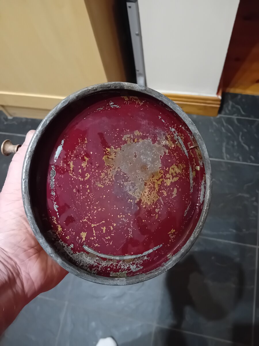

    Anyone know what could have caused this scoring on the bottom of this 300x.....could it possibly be caused by some type of floor stand or maybe a wall bracket....
    It's very central and deeply scored,...looks like from repeatedly placing it on something.
    That been said, the fettle is coming along nicely. ( for a first fettle ). Thanks for the idea Fireexit1
    Awaiting a glass and a preheater wick from Base-camp...
  10. ColinG United Kingdom
    4,816
    I wonder if it could be a line where the solder was flowed around the base plate when it was sealed. Perhaps the solder takes the paint differently and it scraped off?
  11. Fireexit1 United Kingdom
    3,538
    Yes - I have the same - and halfway up the bottom rim on the sides. The rest is probably "fair wear and tear" :lol:
  12. Paul Burnell
    Paul Burnell Spain Subscriber
    May 12, 2023
    182
    Ireland
    That sounds very plausible Coling since Fireexit has the same ring on his. Thanks guys, it had me scratching my head.

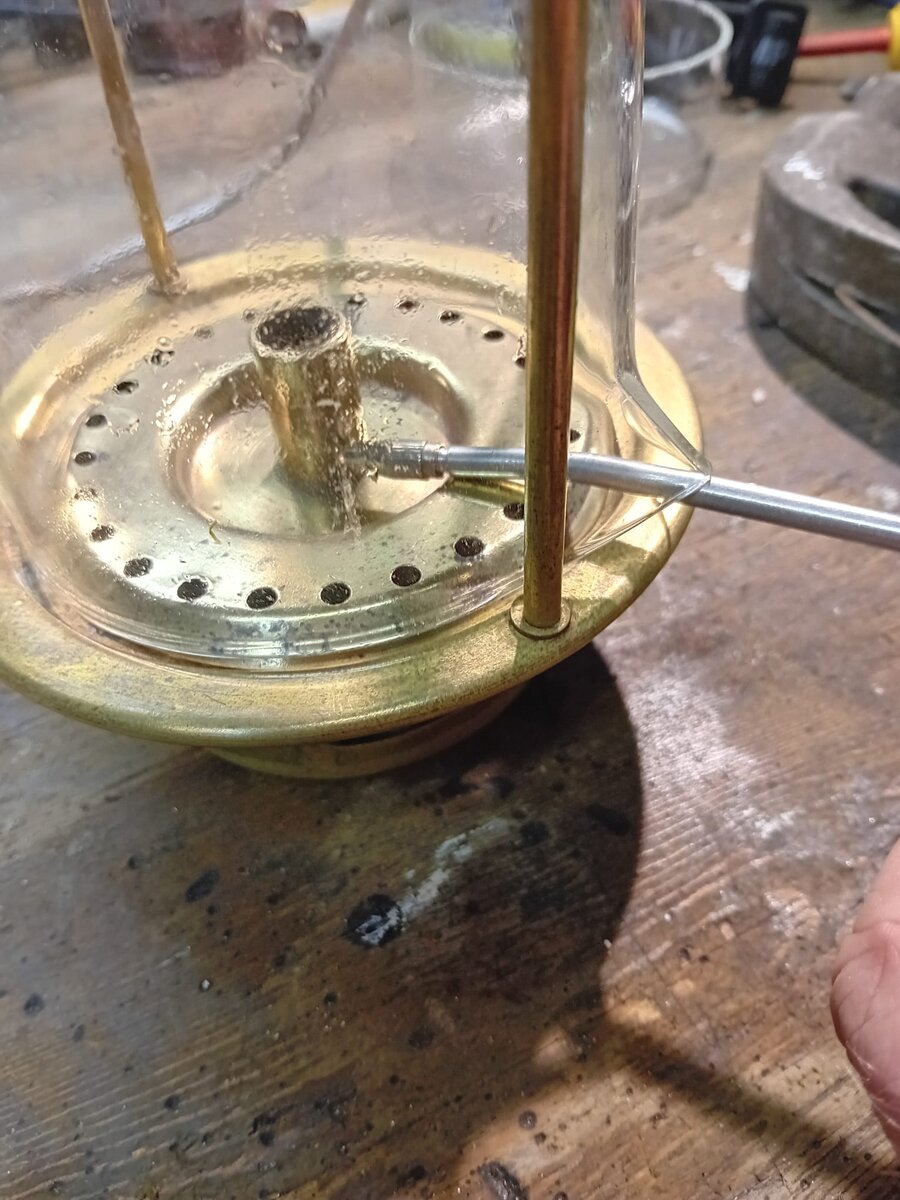

    Well I had to have a go at the glass cutting ( Coffee pot ).....and it worked a treat. The proper one is in transit but here is the project so far .... WhatsApp Image 2023-10-11 at 19.27.58.jpeg WhatsApp Image 2023-10-11 at 19.28.13.jpeg WhatsApp Image 2023-10-01 at 13.52.59(1).jpeg Untitled.jpg

    How I cut the glass...... not shown is the mask, goggles and right hand glove !
    WhatsApp Image 2023-10-11 at 19.42.10.jpeg WhatsApp Image 2023-10-11 at 19.41.32.jpeg WhatsApp Image 2023-10-11 at 19.40.57.jpeg WhatsApp Image 2023-10-11 at 19.40.40.jpeg

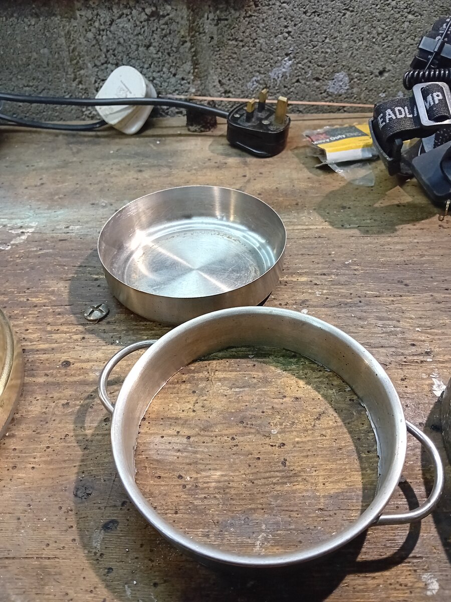

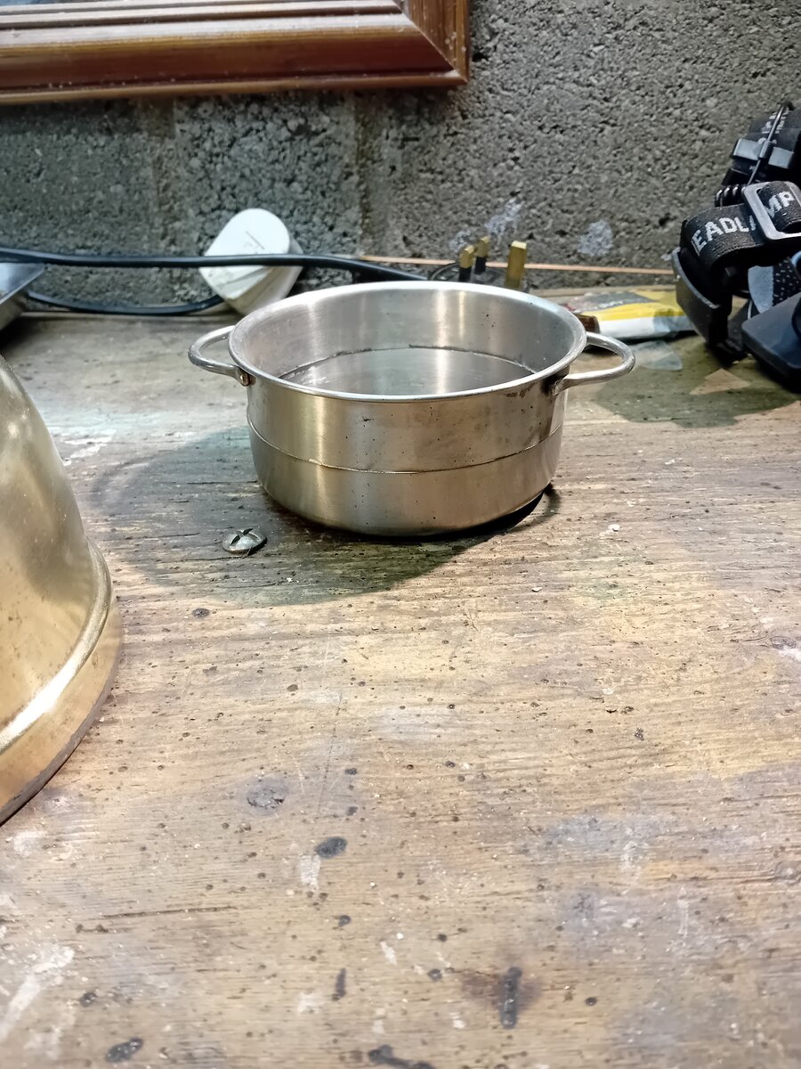

    Yeah Podbros, it worked a treat.... and the coffee pot only cost
    6 euro ... sweet.
    I still have the proper one enroute... e30.... so the added cost of the enamel cover would have just been p 20231008_191911.jpg rohibitive so I made the cover myself from a small stainless steel pot.
