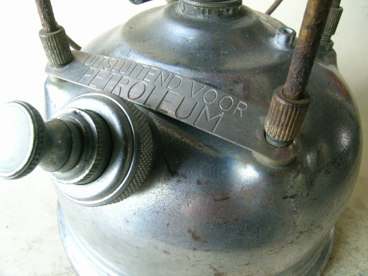

    Luckily, no harm could come off it, as the petrol-designed lamps simply could not digest the less volatile Kerosene. It could have been the other way around, as there are Tilley X246's to be found in the Netherlands with a very distinctive and durable instruction in metal, not to use petrol in these lamps proclaiming"exlusively for paraffin".
    It suggests that the Dutch at that time - early 50's - were familiar with lamps that would use petrol, perhaps the result of dumping many petrol-fuelled lamps by the Americans for a structurally robbed and wrecked country draped mostly in darkness right after the war.
