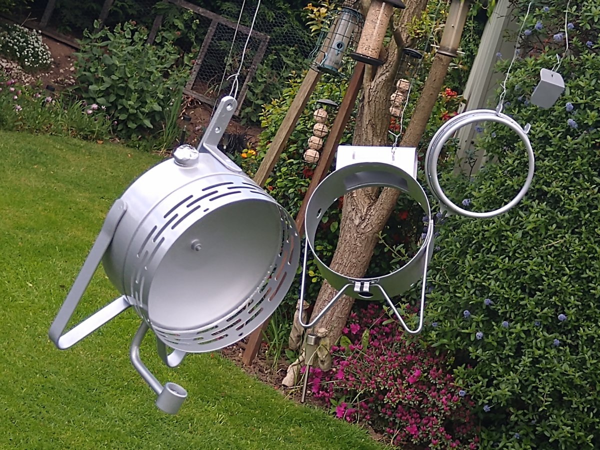

    3 coats of primer, 3 coats of silver (VHT for the chimney) finished off with VHT clear lacquer..all hanging on the washing line.
    Lock down does have its benefits..
    I'm going to leave it a day before re-assembly..Keep telling myself 'I must wait! lol..in my enthusiasm I tend to rush putting them back together and mark something..

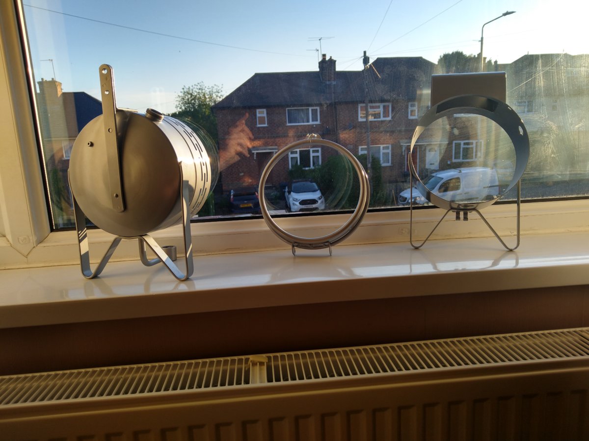

  8. paparazi
    Oct 23, 2016
    434
    Nottingham UK
    Lol..yeah..now getting the last half hour on the front room window ledge..the sun has disappeared from the garden...

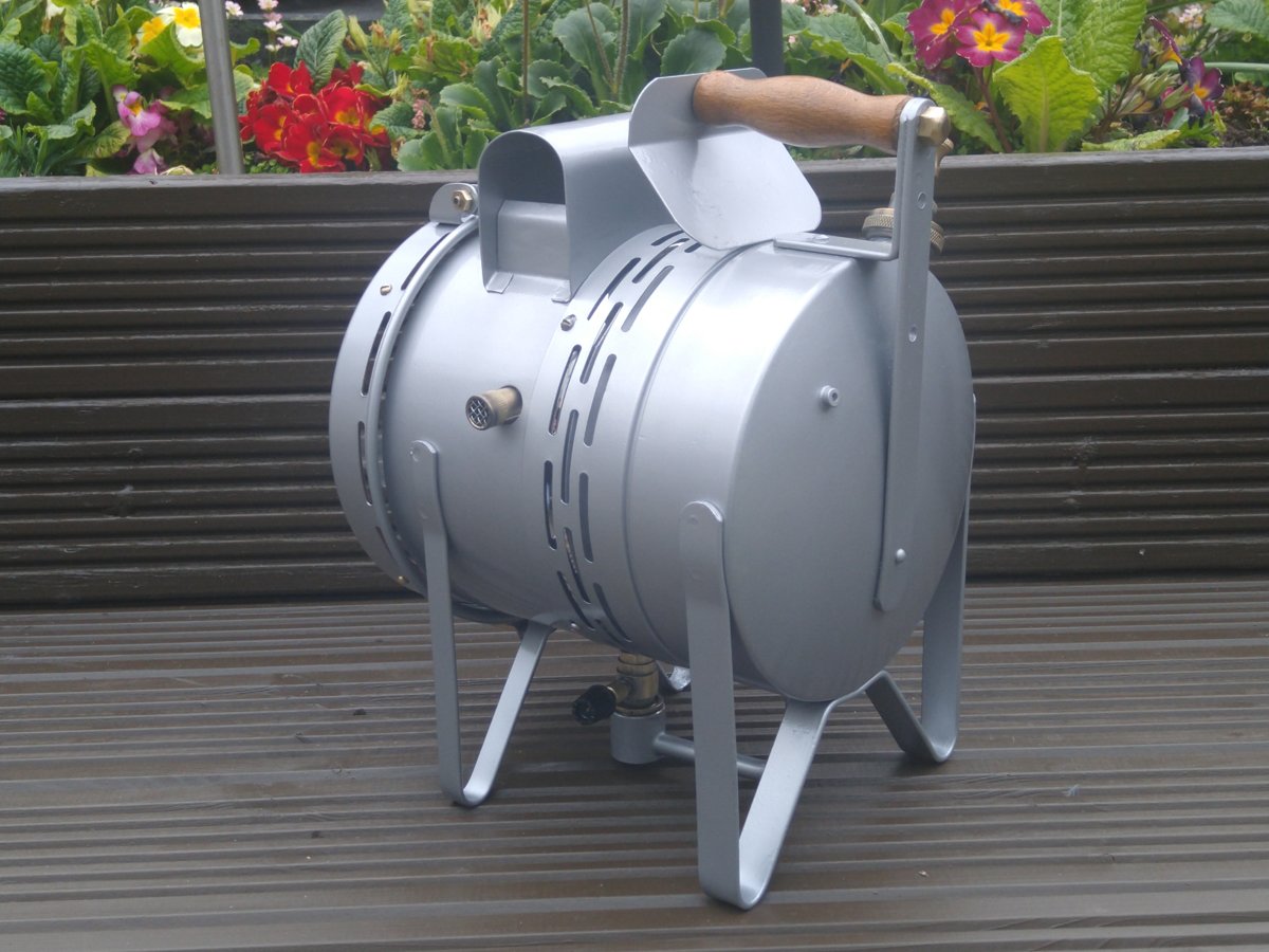

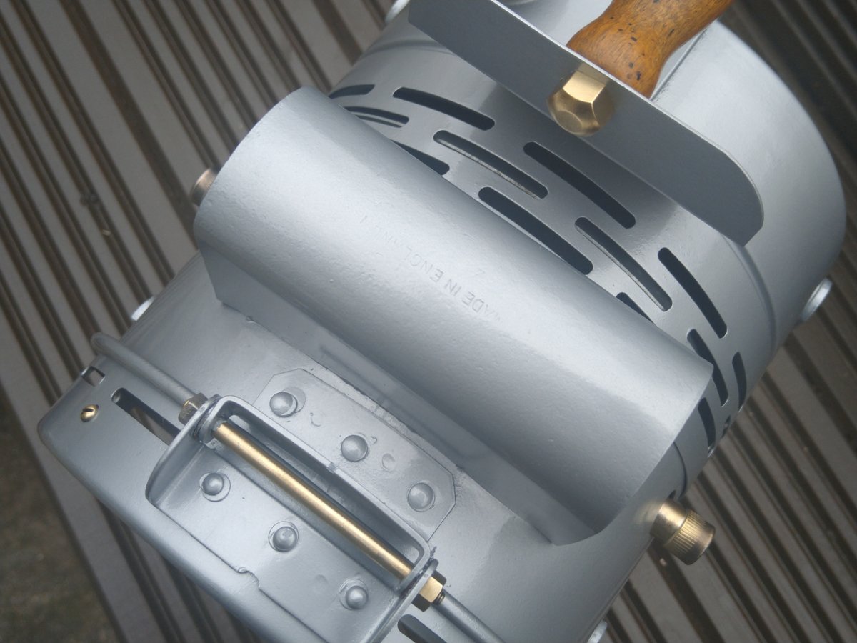

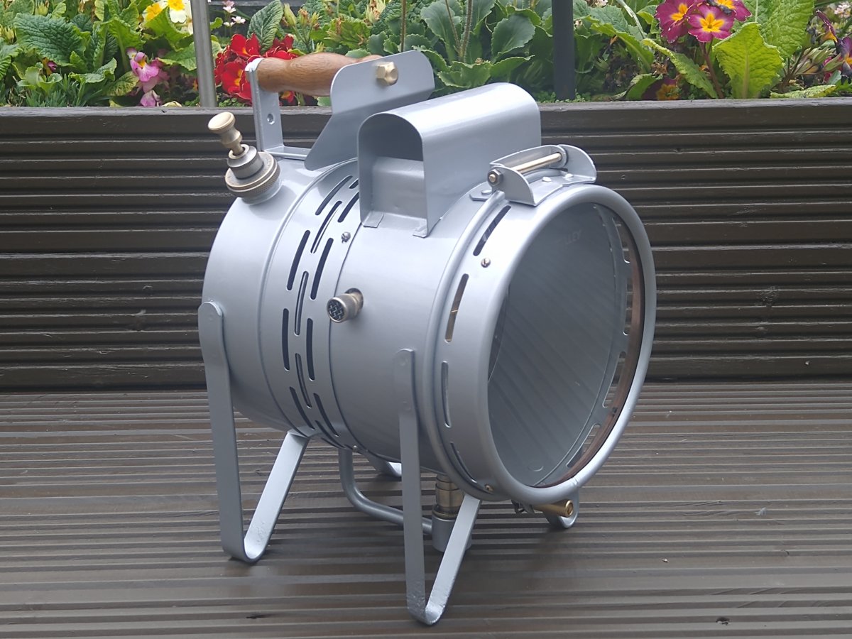

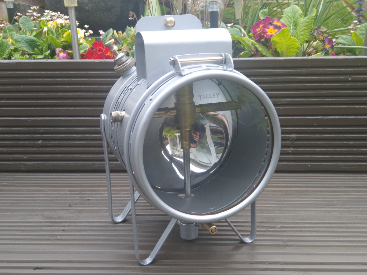

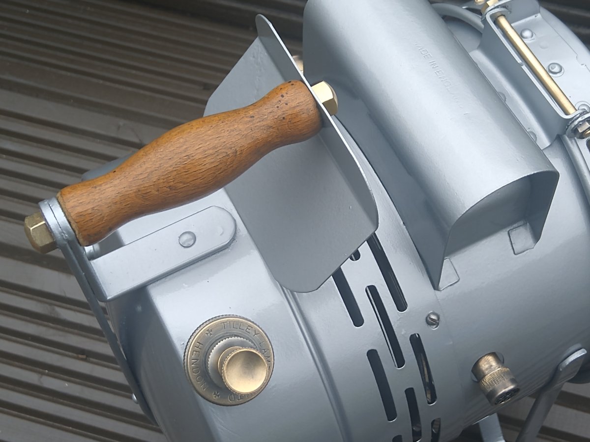

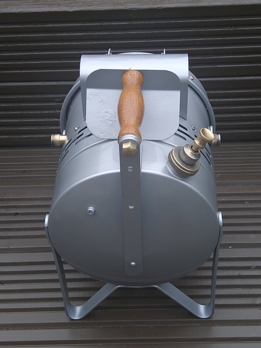

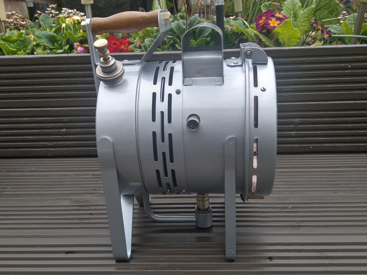

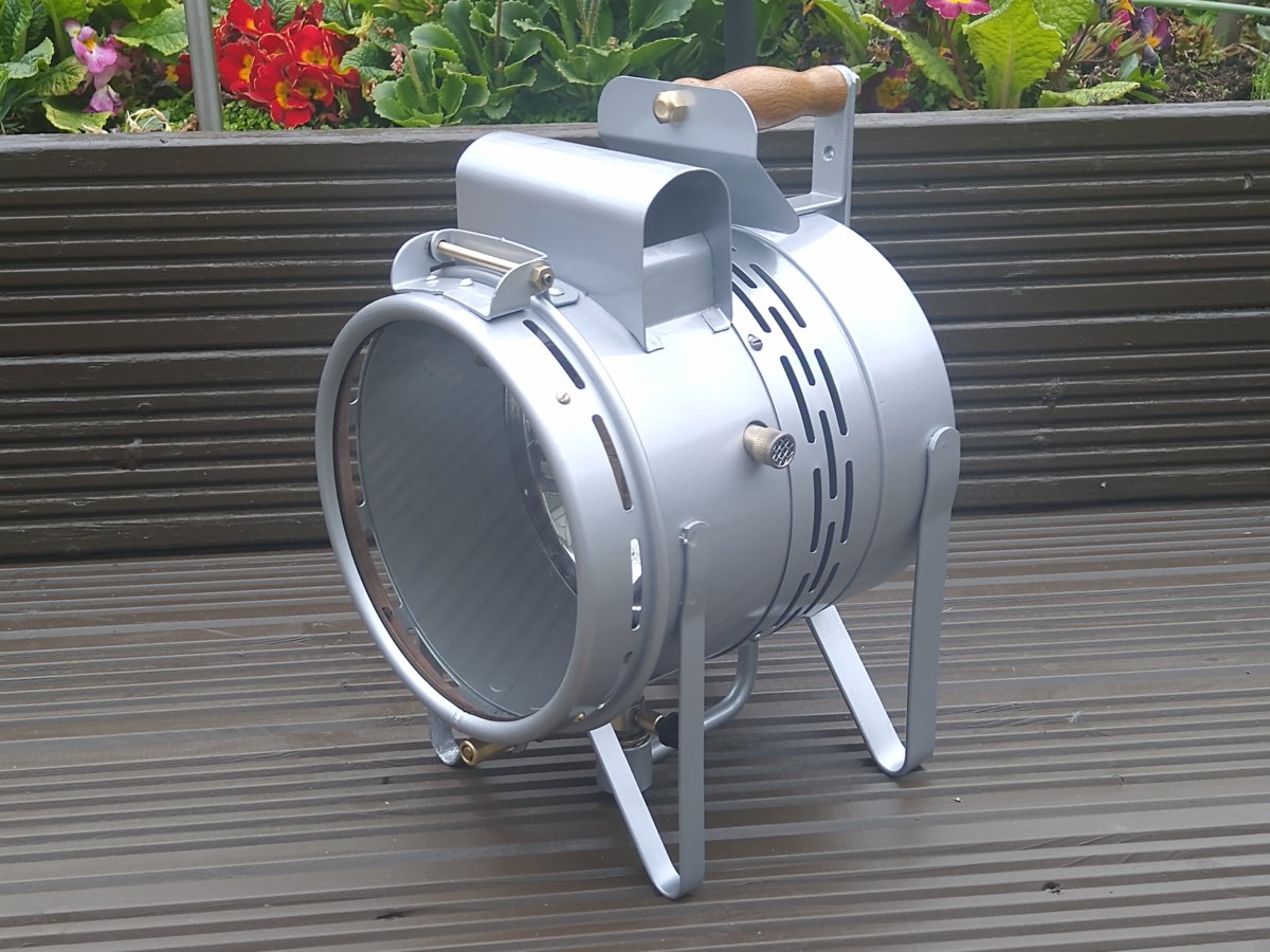

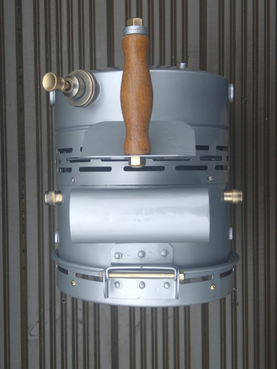

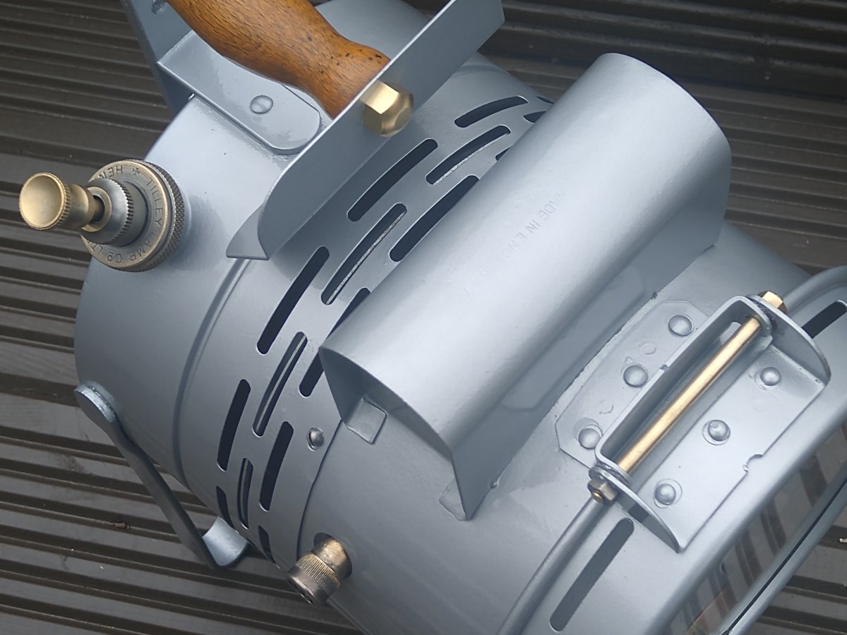

    IMG_20200503_114236827.jpg IMG_20200503_114303389.jpg IMG_20200503_114333927.jpg IMG_20200503_114351943.jpg IMG_20200503_114447084.jpg IMG_20200503_114459478.jpg IMG_20200503_114559124.jpg IMG_20200503_114624562.jpg IMG_20200503_114648707.jpg IMG_20200503_114833768_HDR.jpg IMG_20200503_114853731_HDR.jpg IMG_20200503_114918041.jpg IMG_20200503_114930782.jpg

    All the parts had another 4 hours on the radiator this morning..
    If anyone else is doing similar to an AL21? A couple of things I learnt when re-assembling (4 leg version) is to leave the 4 body screws loose and place the unit on a flat surface, twist the body until all four feet touch without rocking. Also, it is much easier putting in the reflector from the rear of the front section before mating the two halves together.
    Martin
