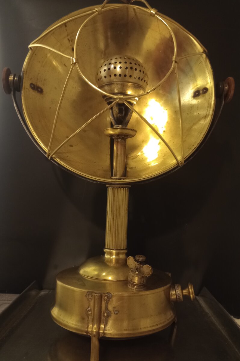

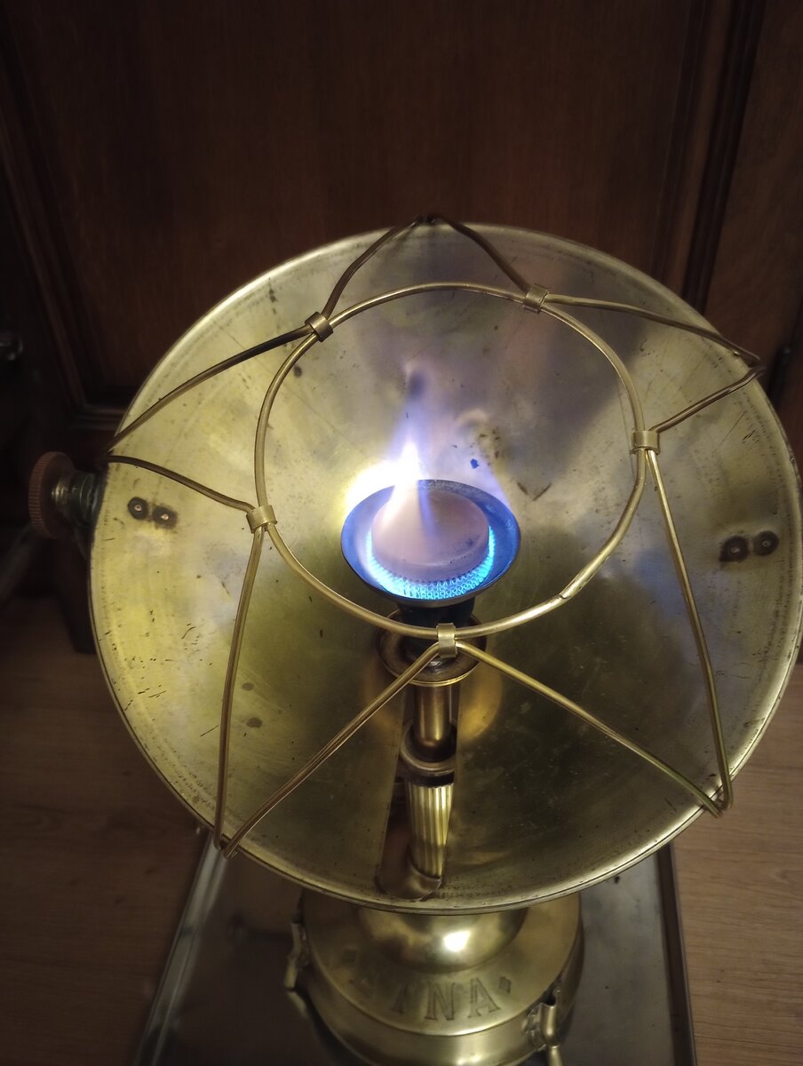

    French radiator/furnace Etna made by Intens. IMG_20231206_154541339~2.jpg

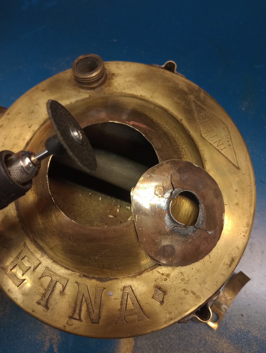

    I had some problems getting it up and running, as there was some unpleasant damage to the tank during the soldering portions. IMG_20231113_190409066.jpg
    I described it here.Repair of a broken Etna French stove/heater tank.
    When I dealt with the repair of the tank, I plated it as a stove and conducted a combustion test.
    IMG_20231118_130706350.jpg The tank held the pressure well, so I decided to make up the missing parts to make it work as a heater.

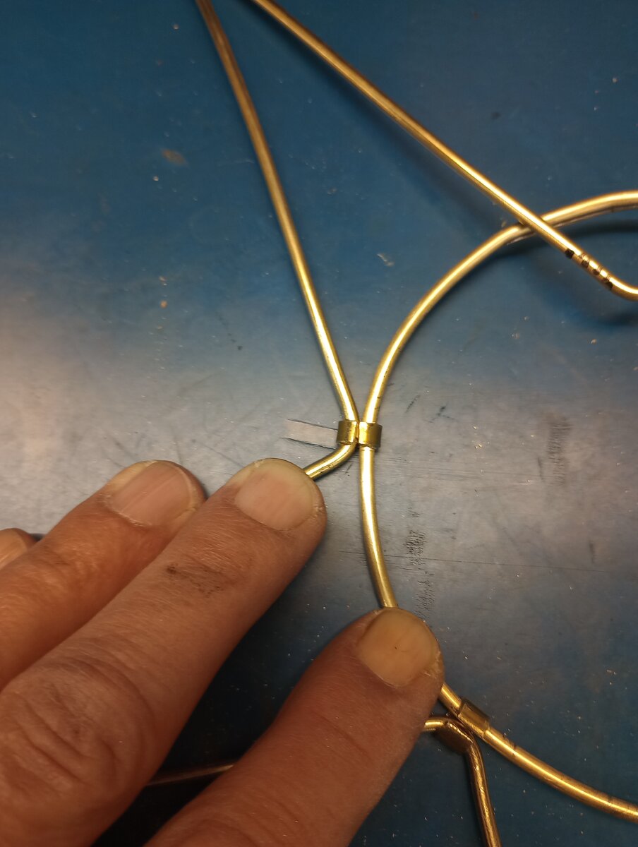

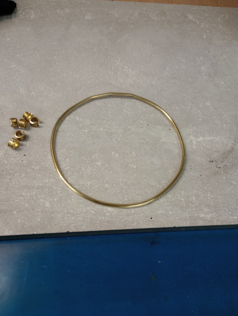

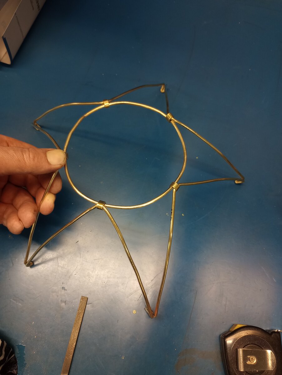

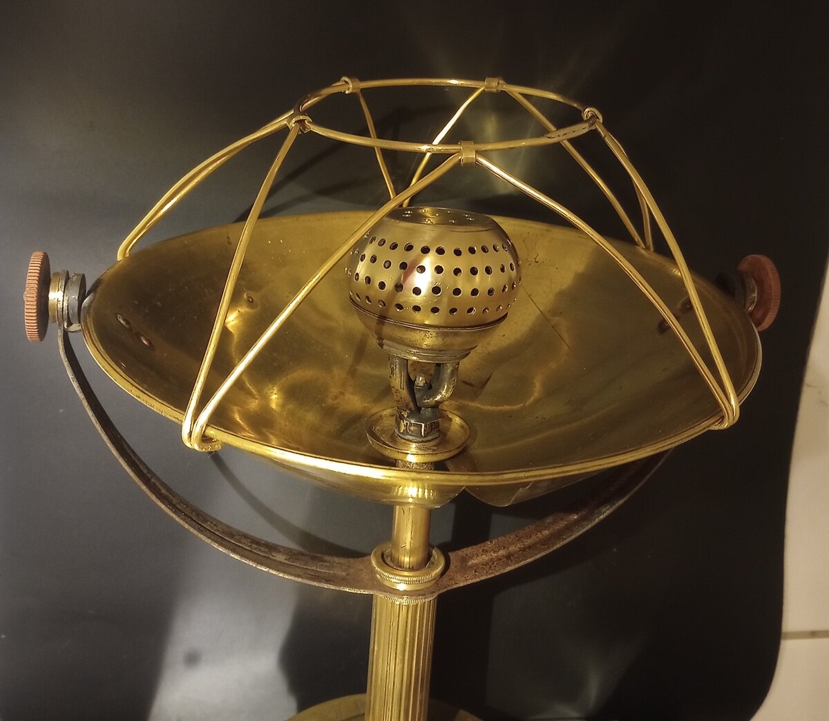

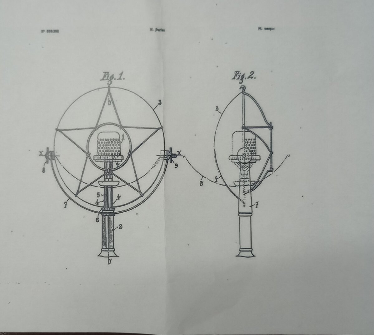

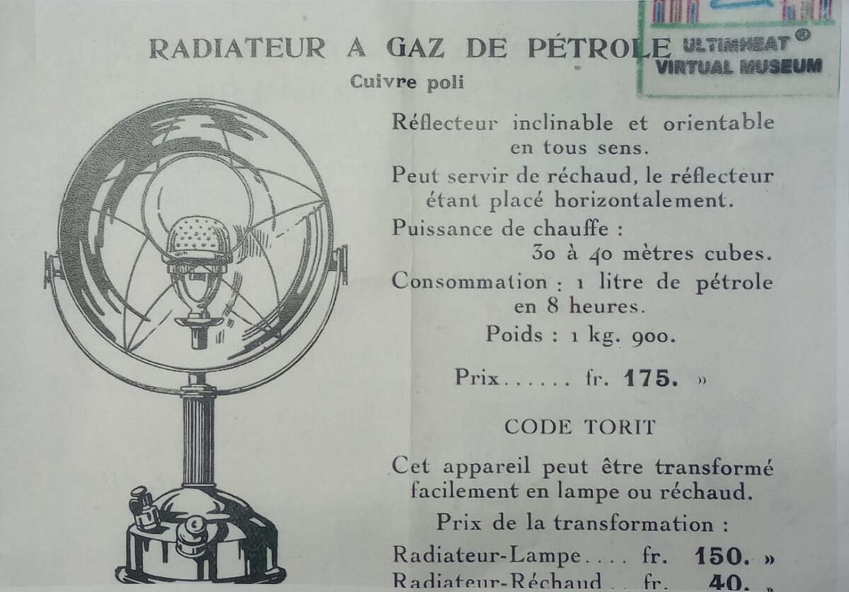

    In the diagram , which I found here the guard is in the shape of a star, so I made something similar from brass spring wire with a thickness of 4mm.
    IMG_20231206_132542708~2.jpg IMG_20231206_132516207~2.jpg IMG_20231204_125950480.jpg IMG_20231205_075402233.jpg IMG_20231205_093933242.jpg IMG_20231205_130330050.jpg IMG_20231206_154145350~2.jpg

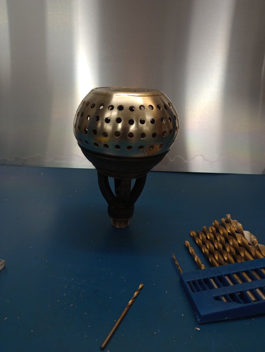

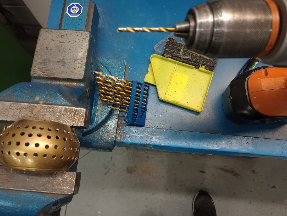

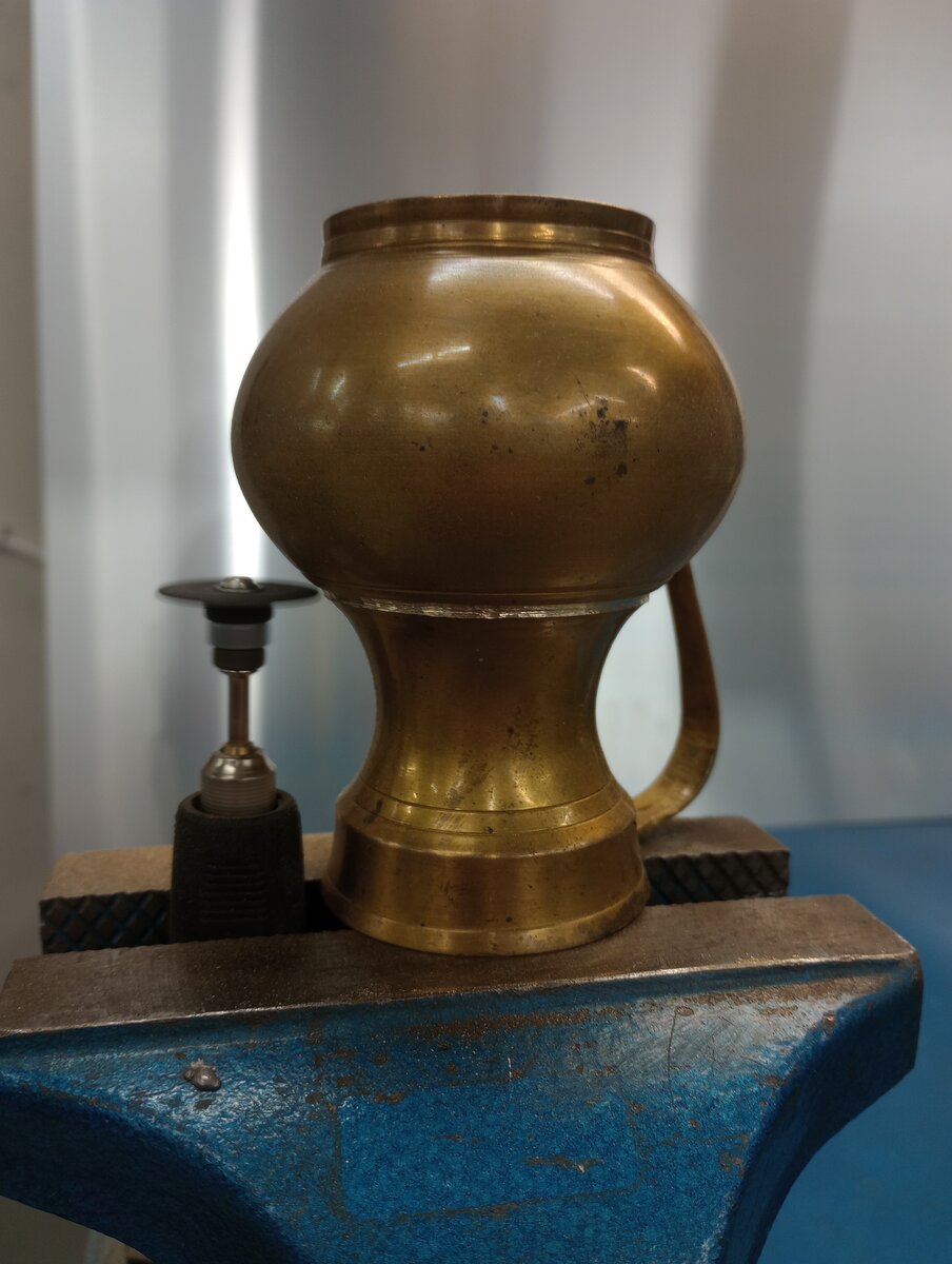

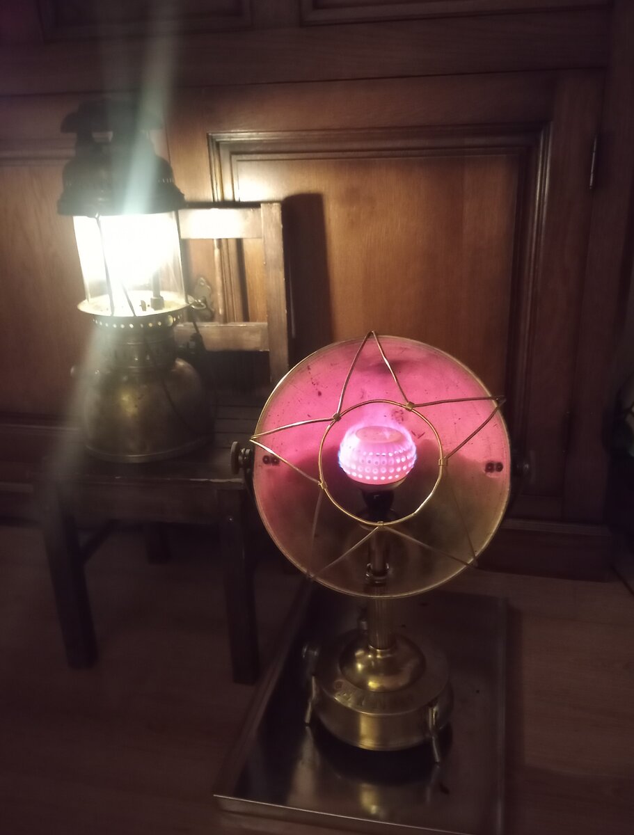

    Then from a brass jug I made a dome for the burner.

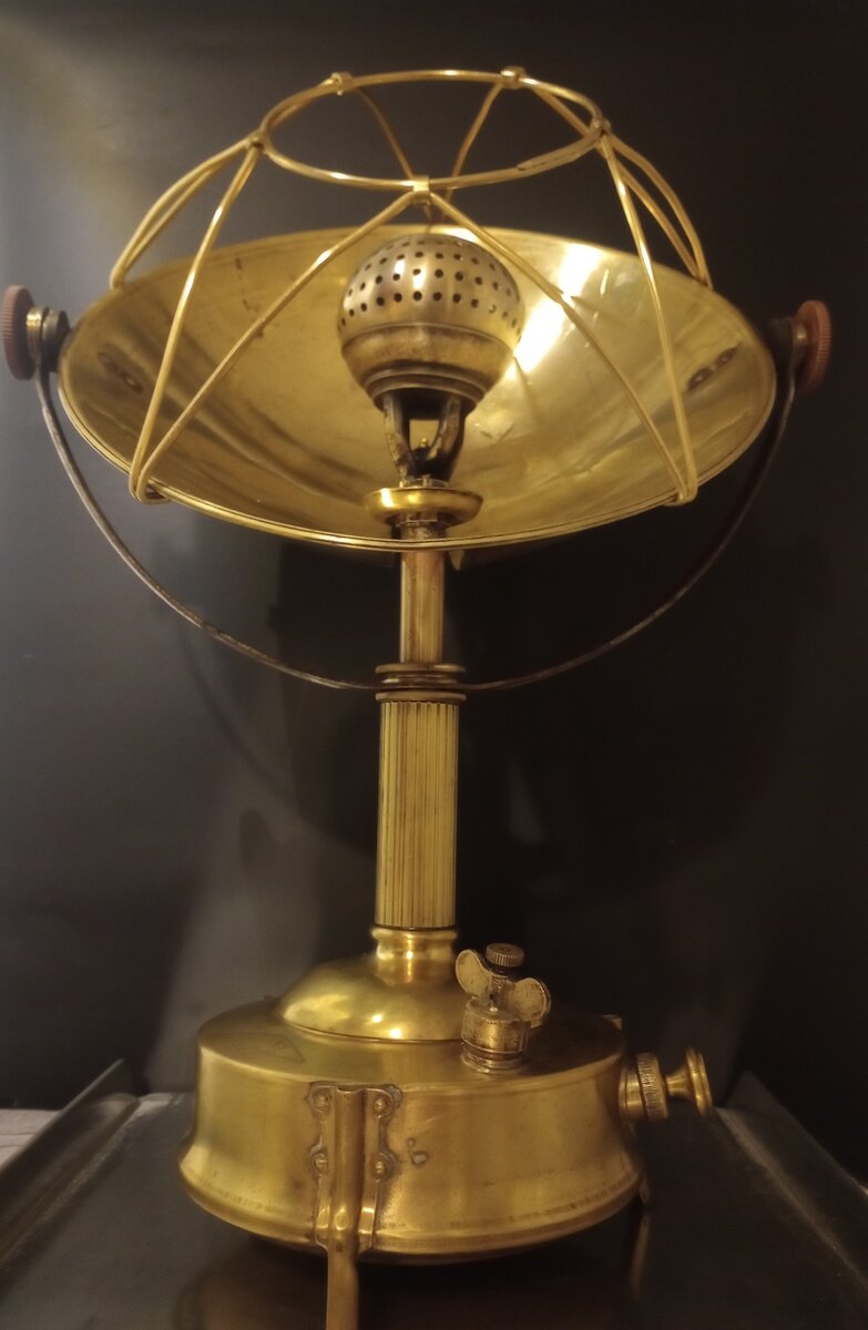

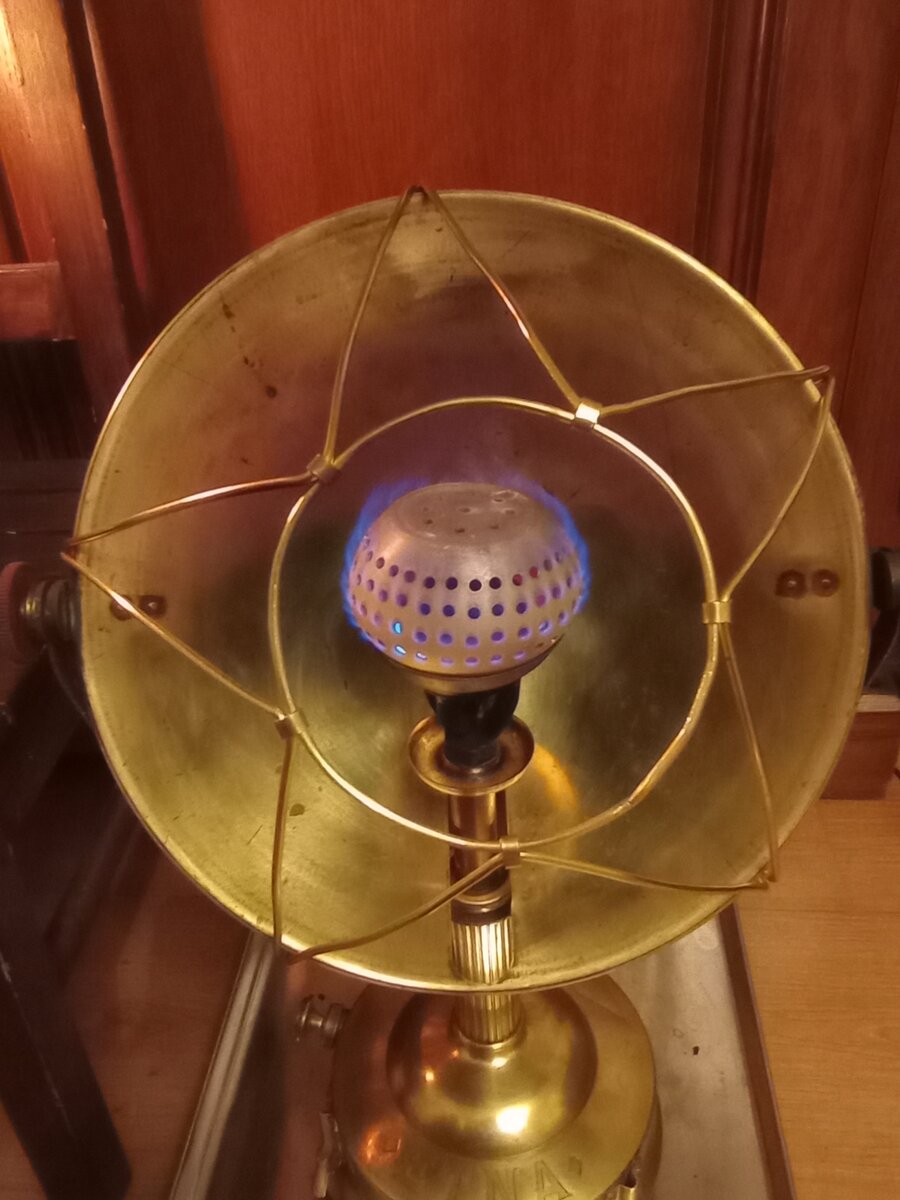

    IMG_20231128_182500489.jpg IMG_20231129_163901978.jpg IMG_20231129_170911981.jpg Once I had everything put together, I could fire it up and enjoy the pleasant warmth.
    IMG_20231206_154503549~2.jpg IMG_20231206_154541339~2.jpg IMG_20231206_193930585.jpg IMG_20231206_194255109.jpg IMG_20231206_194653056~2.jpg
